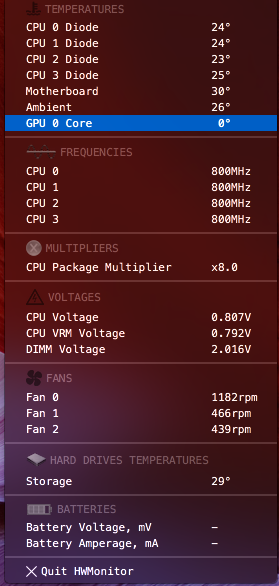

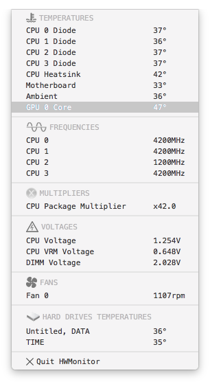

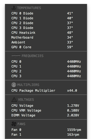

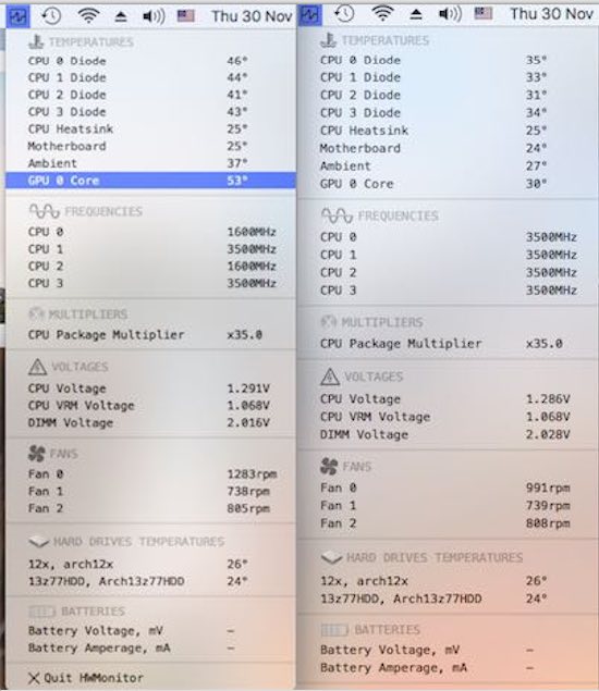

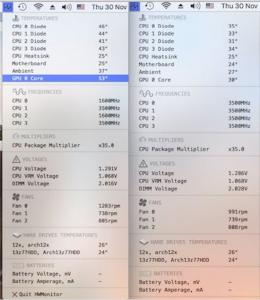

Really high DIMM (RAM) Voltage, you have 2.x volt :)  My DDR3 setup BIOS 1,5 (shown as 1,58 volt in UEFI System Info).
Does your BIOS ( most have such System Info about volatge cpu + dimm in UEFI/BIOS) alaso 2,x+ volts?
With my old MB , DDR2 i also had 2,1 Volt but doesnt DDR3 need much less?
Everyone who posted screenshots above show DIMM voltage over 2v. Looks like a bug.
