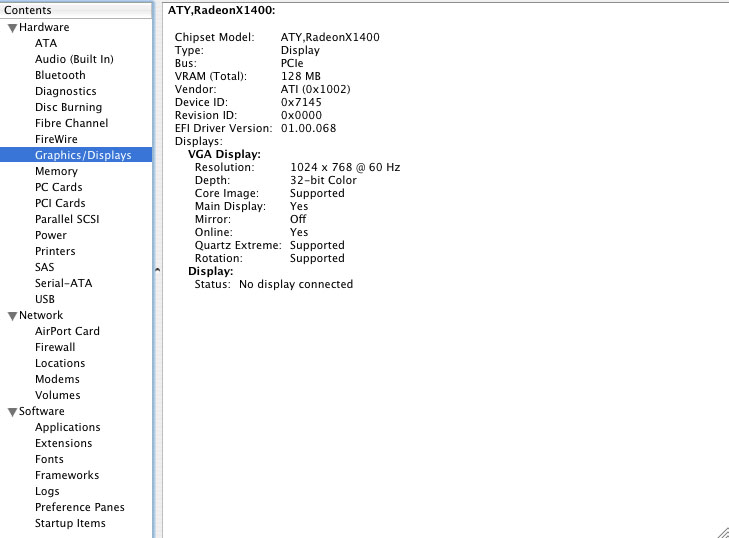

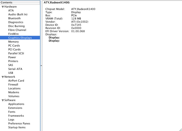

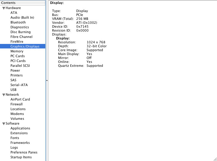

I ve been experimenting with TheMaxx32000's ATIinject settings (this thread.)
Interesting to mention that it works different on every boot. Every second boot it detects a "CRT" monitor on port0 (instead of "LCD"), and on the other occasion it detects "NONE" on port0.
Even if i try to inject the 'display-type' key to "LCD", it detects one of the two mentioned ones.
This seem to prove that there is no implementation for LVDS type of connection in the Caretta driver.
So, the only chance to make X1400 work on internal lcd would be if the Wormy driver would be backward compatible for the x1400. By now it seems its not really. It freezed the machine after droppin some white lines on the screen :dev:
Really sad they left out LVDS from Caretta. There is no more any mouse tearing after Caretta is loaded! I saw it on VNC.
I used VINE as server, and UltraVNC as client.

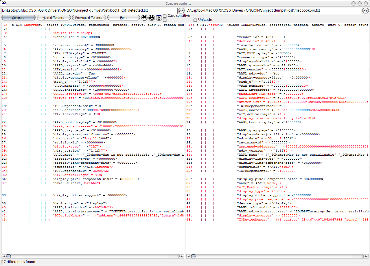

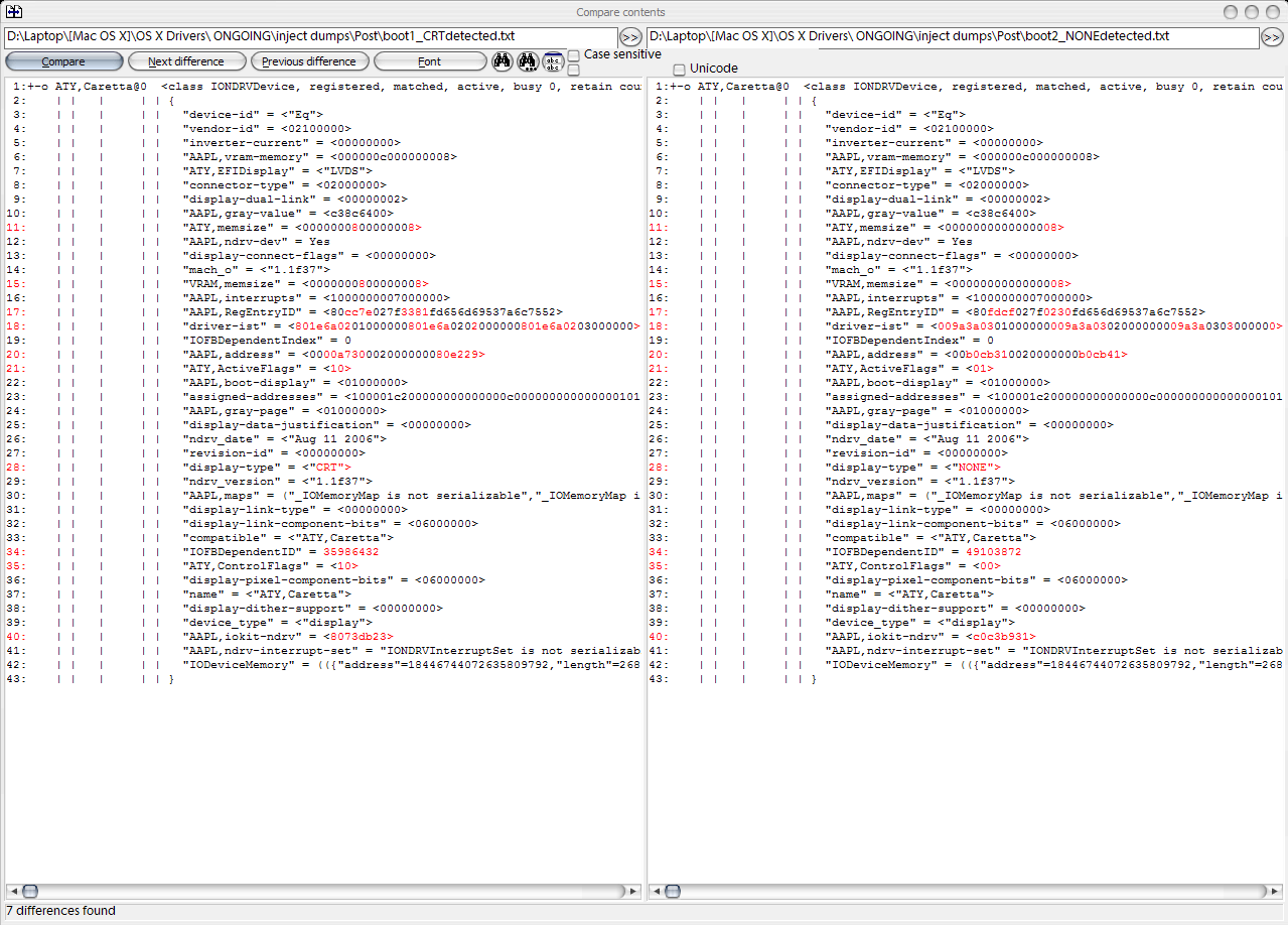

picture 1: only ATIRadeonX1000.kext loaded
picture 2: ATIinject Caretta loaded boot1
picture 3: ATIinject Caretta loaded boot2
picture 4: boot1 VS boot2
picture 5: boot1 VS macbookpro
VNC was working on both booting situations (CRT or NONE detected)
I was able to choose any resolution up to (~2500x1400) when CRT was detected. +Detect Display button showed up, but didnt do anything..
In the other case i was able to choose only (800x600@60Hz and 1024x768@60Hz).
Used versions:
IONDRVSupport 1.4.4, 1.4.3 (same results)
ATY_Caretta 1.4.40
ATIRadeonX1000 1.4.40
boot1_CRTdetected.txt
boot2_NONEdetected.txt
macbookpro.txt
ATIinject_Info.plist.txt
Edited by Bandes
