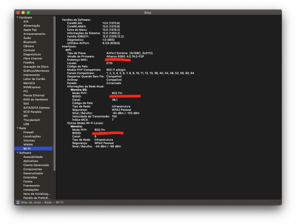

your log with *efi is good. i want to know com.apple.driver.AirPort.Atheros40 (WiFi 5Ghz).
i first see Atheros40 5ghz. is it actually working?

Here I use Atheros wi-fi (TP-link WDN4800) in the 5Ghz network, and this in the Mojave 10.14.1 beta with the kext of the High Sierra 10.13.6

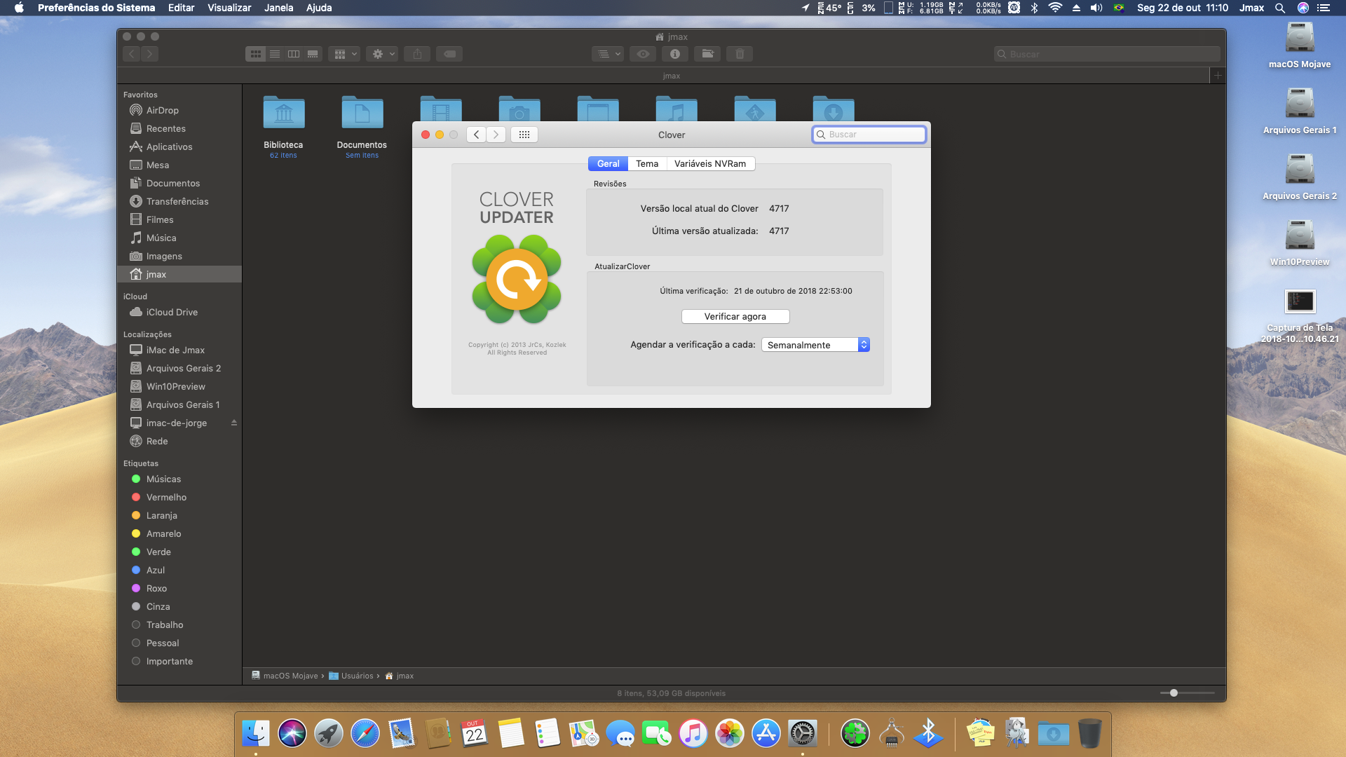

And about NVRAM test6, here everything ok, I have two systems with native NVRAM and only tested on one so far

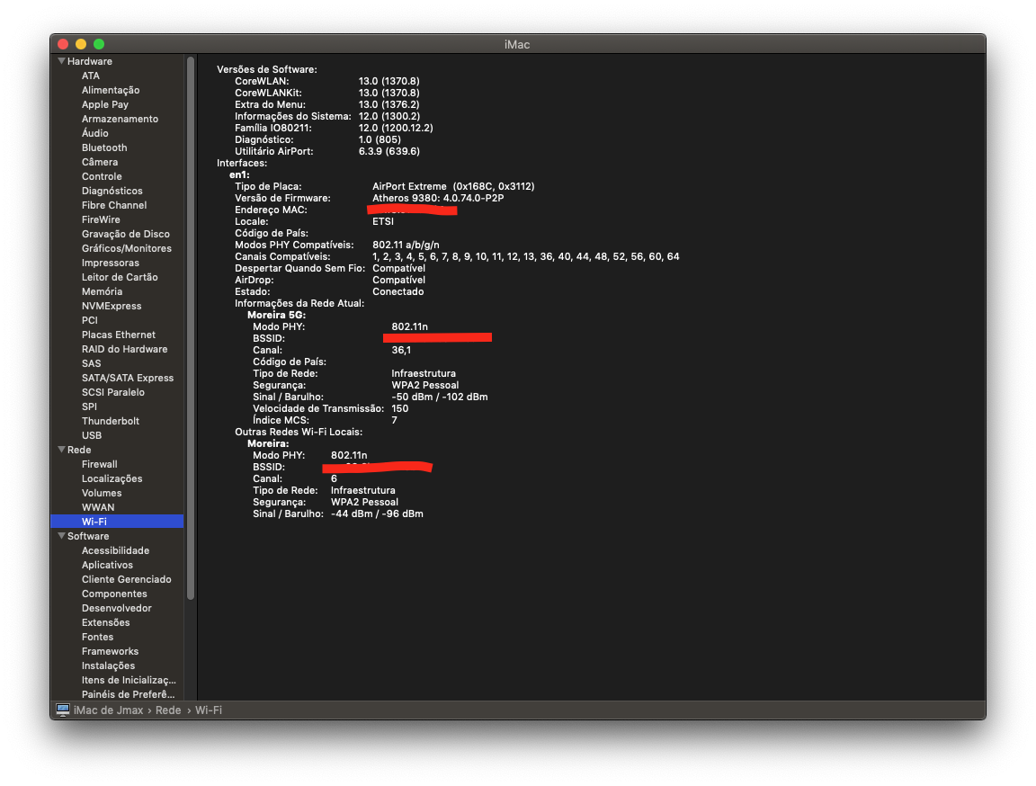

1220637873_CapturadeTela2018-10-22s10_46_21.thumb.png.c009dd15ff078de6af365299cdd41c37.png

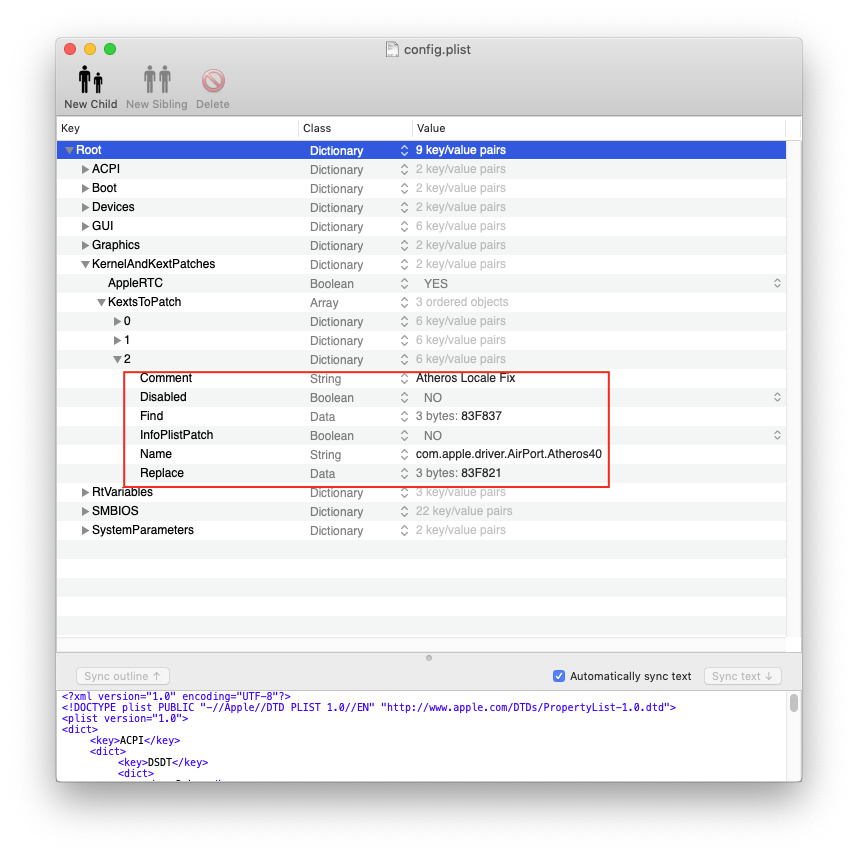

thank you for testing. did you have 5ghz patch? i want to know 5ghz patch. because i have to arrange patch since snow leopard to mojave

This patch only:
