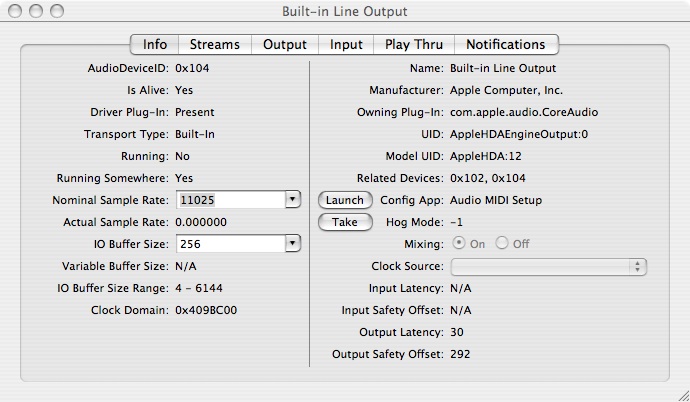

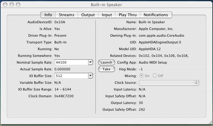

Taruga Posted September 2, 2007 Author Share Posted September 2, 2007 For those testing with my patcher or kext´s that have output devices, but sound doesn´t come out try this: Run the attached file HALLab, select your output device and push the 'Info' button. Play some mp3 in iTunes for ex. and check if while switching play and pause in iTunes, the 'Running Somewhere' in HALLab changes from 'yes' while playing to 'No' when you push the pause button in iTunes. Also, take both HALLab screenshots like I did to compare info. Archive13.zip (beta test for alc861, Asus F3JC for ex) Archive.zip (beta test for alc262) Both .kext´s are for testing with this method, they will not give sound on most cases. If HALLab doensn´t run on your system, try HALLab2 Thanks Link to comment Share on other sites More sharing options...

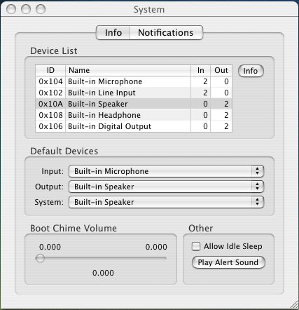

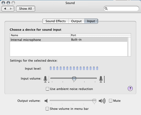

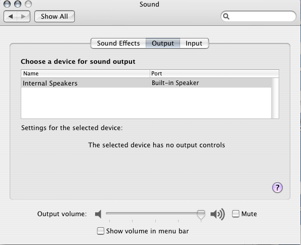

pto2k Posted September 3, 2007 Share Posted September 3, 2007 Can you send me some screenshots of both audio outputs and inputs ?If it´s coded to 0x10ec0862 it will not work with a binary patched for 0x10ec0861. Try this, lets see if it works...ps - Most notebooks are really crazy regarding sound, they don´t follow some standards. So, good luck hi, i seem have the same audio in my Lenovo f40. the screen shot is taken after installed your files, no volume control and there is no sound. please have a look. thanks ! Link to comment Share on other sites More sharing options...

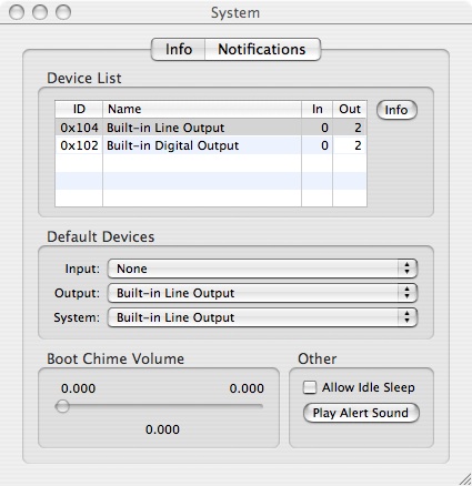

maxoid Posted September 3, 2007 Share Posted September 3, 2007 Taruga, Thanks a lot once again for your efforts and hard work. My sound is AD1986A (Vendor Id: 0x11d41986, Subsystem Id: 0x10431153, Revision Id: 0x100500) HDA_patcher gives me 2 output devices: 'Built-in Line Output' and 'Built-in Digital Output'. No volume controls and no sound. 'Running Somewhere' is always 'Yes' (doesn't matter if you play something in iTunes or stop/pause it) in HALLab2 (HALLab doesn't run). Here are the screenshots: Link to comment Share on other sites More sharing options...
Taruga Posted September 3, 2007 Author Share Posted September 3, 2007 Taruga, Thanks a lot once again for your efforts and hard work. My sound is AD1986A (Vendor Id: 0x11d41986, Subsystem Id: 0x10431153, Revision Id: 0x100500) HDA_patcher gives me 2 output devices: 'Built-in Line Output' and 'Built-in Digital Output'. No volume controls and no sound. 'Running Somewhere' is always 'Yes' (doesn't matter if you play something in iTunes or stop/pause it) in HALLab2 (HALLab doesn't run). Here are the screenshots: AD1986A users, I think only AppleHDAPatcher v1.13 worked for you guys. Link to comment Share on other sites More sharing options...

avon Posted September 3, 2007 Share Posted September 3, 2007 Can you send me some screenshots of both audio outputs and inputs ?If it´s coded to 0x10ec0862 it will not work with a binary patched for 0x10ec0861. Try this, lets see if it works...ps - Most notebooks are really crazy regarding sound, they don´t follow some standards. So, good luck Taruga, thanks for the prompt reply! I haven't got a chance to try out the new patcher yet, will do it tonight. But pto2k reported his testing results above. I digged a little deeper, and find this alc862 can be recognized by default linux snd_hda_intel driver. Volume control is there, but no sound output (I tried ubuntu 7.10 and Knoppix 5.1.1) So you might be right that Lenovo use some kind of unstandard wiring for this chip, at least in their 3000 Nxx series. Alsa project developer has already figured out this problem. By applying patch_realtek.c(use guest login to download) to alsa driver(top-right corner) source code, Ubuntu 7.04 could recognize the chip correctly and produce sound, although perfect control is not achieved yet. (Follow steps described here, also the ubuntu driver testing page for my Lenovo 300 N100 0768 A78) At the bugtrack page, where you downloaded patch_realtek.c file, there are discussions about progression on different subsystems of alc862. Several people using exactly the same subsystem ID as mine "0x17aa8e2d", has reported success. A user called zeus77 even pasted his latest partially working codec profile (by cat /proc/asound/card0/codec#0, see attachment). I feel we are very close to success now. I wish I could help to interpret the code, but it's way beyond my perception. So what I can do is cross my fingers and wait for your good news. Cheers! alc862_VID_0x10ec0862_Subsys_0x17aa8e2d.txt Link to comment Share on other sites More sharing options...

maxoid Posted September 4, 2007 Share Posted September 4, 2007 AD1986A users, I think only AppleHDAPatcher v1.13 worked for you guys. Taruga, unfotunately version 1.13 gives the same results on my AD1986a (Asus A8Jc notebook) - 2 devices: LineOut and SPDIF, No volume controls, No sound. 'Running somewhere' in HALLab2 is permanently 'Yes' after I start playing something (initialy it's 'No') , pausing/stopping playback doesn't change its value. Is there anything I can do to help fixing it? Thanks a lot in advance. Best regards, MaX Link to comment Share on other sites More sharing options...

Taruga Posted September 4, 2007 Author Share Posted September 4, 2007 Taruga, unfotunately version 1.13 gives the same results on my AD1986a (Asus A8Jc notebook) - 2 devices: LineOut and SPDIF, No volume controls, No sound. 'Running somewhere' in HALLab2 is permanently 'Yes' after I start playing something (initialy it's 'No') , pausing/stopping playback doesn't change its value.Is there anything I can do to help fixing it?Thanks a lot in advance.Best regards,MaXArgh! Notebooks are a pain in the ass, I can only fix that if I can finish my own driver.I have sigmtel 9220. I have sound output on wrong jack (i.e line out). and no front pannel speakers or mic. Can you help me. My mother board is intel 945gntlOk, I answered your pm without reading this post, thanks for reporting. I will fix it, in the next v1.17 AppleHDA Patcher version Link to comment Share on other sites More sharing options...
