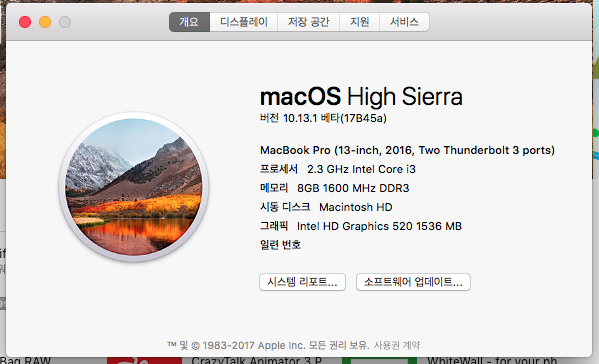

Guest ricoc90 Posted October 23, 2017 Share Posted October 23, 2017 New seed: 17B45a Link to comment Share on other sites More sharing options...
Badruzeus Posted October 23, 2017 Share Posted October 23, 2017 New seed: 17B45a Hi, plz confirm us; is it just an update from 17B42a or a full installer? Thanks Link to comment Share on other sites More sharing options...
Guest ricoc90 Posted October 23, 2017 Share Posted October 23, 2017 Hi, plz confirm us; is it just an update from 17B42a or a full installer? Thanks AppStore update Link to comment Share on other sites More sharing options...
Sherlocks Posted October 23, 2017 Share Posted October 23, 2017 update is no problem. EDIT1. apfs updated. EDIT2. Itunes crash still happen. apfs.efi.zip 4 Link to comment Share on other sites More sharing options...

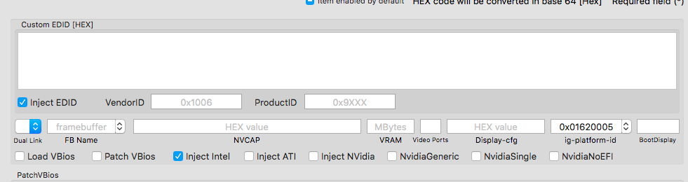

Sherlocks Posted October 23, 2017 Share Posted October 23, 2017 https://drive.google.com/file/d/0B-v6U5cirK6TeEVCUnltNGhlSms/view?usp=sharing Here you go hopefully I did it right great. try latest clover version r4259 https://sourceforge.net/projects/cloverefiboot/?source=navbar and remove this in your config.plist <key>ig-platform-id</key> <string>0x01620005</string> or if you use clover configurator, remove 0x01620005, then save. then, please report whether boot or not with graphic like same before. no need any files, just only report. thanks EDIT1. your system has eficheck. i recommend that you use EFICheckDisabler to avoid firmware check in macOS http://www.insanelymac.com/forum/topic/328829-eficheckdisabler/ Link to comment Share on other sites More sharing options...

bbmatias3 Posted October 23, 2017 Share Posted October 23, 2017 great. try latest clover version r4259 https://sourceforge.net/projects/cloverefiboot/?source=navbar and remove this in your config.plist <key>ig-platform-id</key> <string>0x01620005</string> or if you use clover configurator, remove 0x01620005, then save. 스크린샷 2017-10-24 오전 3.38.42.png then, please report whether boot or not with graphic like same before. no need any files, just only report. thanks EDIT1. your system has eficheck. i recommend that you use EFICheckDisabler to avoid firmware check in macOS http://www.insanelymac.com/forum/topic/328829-eficheckdisabler/ Okay thanks!!! What desktop do you have?! I also have installed in a dell optiplex i7 3770 intel 4000 literally just plug and play for graphics I just hit both options in clover For the one I sent you it was a asus mobo it was a bit trickier And I think I did have to put the graphics I’d to get full acceleration I’ll double check your request and report back Link to comment Share on other sites More sharing options...
bbmatias3 Posted October 23, 2017 Share Posted October 23, 2017 great. try latest clover version r4259 https://sourceforge.net/projects/cloverefiboot/?source=navbar and remove this in your config.plist <key>ig-platform-id</key> <string>0x01620005</string> or if you use clover configurator, remove 0x01620005, then save. 스크린샷 2017-10-24 오전 3.38.42.png then, please report whether boot or not with graphic like same before. no need any files, just only report. thanks EDIT1. your system has eficheck. i recommend that you use EFICheckDisabler to avoid firmware check in macOS http://www.insanelymac.com/forum/topic/328829-eficheckdisabler/ I booted without selecting anything in graphic settings in clover it boots but no acceleration I noted changing 0x01620005 to 0x00000000 and both get full acceleration Link to comment Share on other sites More sharing options...

Sherlocks Posted October 23, 2017 Share Posted October 23, 2017 I booted without selecting anything in graphic settings in clover it boots but no acceleration I noted changing 0x01620005 to 0x00000000 and both get full acceleration Without inject-intel, you can't get graphics. Try. 1. Check Graphic-intel inject 2. Remove ig-platform-id(i mentioned above, latest clover already has your framebufferid) And report. Thanks 나의 LG-F800S 의 Tapatalk에서 보냄 I had a miserable time updating to 17B45a. The problem was all due to Clover. Clover will not properly inject those kexts in Clover/kexts/10.13. I had to move (not copy) them to Clover/kexts/Other. I still have my custom kexts there and I cannot boot with my custom kexts in the 10.13 folder. For what it's worth, I was able to boot from my USB installer (thank goodness) which has Clover version 4220 even though the custom kexts are located in the Clover/kexts/10.13 folder. But when I tried to copy the Boot64 and Clover64 efi files to my EFI directory on my system drive, it didn't help. However, because I could boot up, I was able to move my custom kexts to the Other folder and get my laptop to boot without the USB installer. It wasn't pretty but everything is working now.What is your clover version? 나의 LG-F800S 의 Tapatalk에서 보냄 Link to comment Share on other sites More sharing options...
bbmatias3 Posted October 23, 2017 Share Posted October 23, 2017 Without inject-intel, you can't get graphics. Try. 1. Check Graphic-intel inject 2. Remove ig-platform-id(i mentioned above, latest clover already has your framebufferid) And report. Thanks 나의 LG-F800S 의 Tapatalk에서 보냄 What is your clover version? 나의 LG-F800S 의 Tapatalk에서 보냄 If I don’t injection intel graphics work but no acceleration And I removed that number before it booted so no need to have the platform I’d like how I do Link to comment Share on other sites More sharing options...
Sherlocks Posted October 23, 2017 Share Posted October 23, 2017 If I don’t injection intel graphics work but no acceleration And I removed that number before it booted so no need to have the platform I’d like how I do Did you try to use latest clover?I just want to test graphic work. Just check inject intel and no ig-platform-id whether boot with acceleration. Sorry for my bad english. 나의 LG-F800S 의 Tapatalk에서 보냄 Link to comment Share on other sites More sharing options...
bbmatias3 Posted October 23, 2017 Share Posted October 23, 2017 Did you try to use latest clover? I just want to test graphic work. Just check inject intel and no ig-platform-id whether boot with acceleration. Sorry for my bad english. 나의 LG-F800S 의 Tapatalk에서 보냄 I did not try latest clover Well I get full acceleration meaning graphical works should be ok I did inject intel without platform I’d and it worked (with acceleration) Link to comment Share on other sites More sharing options...

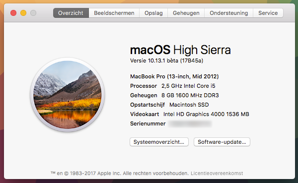

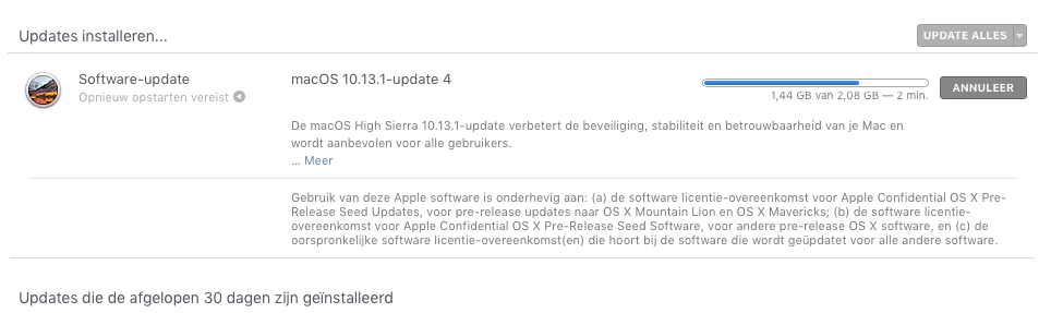

Badruzeus Posted October 24, 2017 Share Posted October 24, 2017 @Sherlocks, any new Platform Data under 10.13.1 Beta 4 (17B45a), maybe? Not sure why, on 2nd stage after 1st reboot for completing update process (macOS Install Data) I get this error: FYi, I'm using MBP10,1 SMBios, running MAS update from 17B42a (HFS+) with Legacy Clover r4243 upto r4262 (/kexts/Other/FakeSMC && ApplePS2~). Thanks #EDIT: already tried again twice, but gives same result. Link to comment Share on other sites More sharing options...
chris1111 Posted October 24, 2017 Share Posted October 24, 2017 @Sherlocks, any new Platform Data under 10.13.1 Beta 4 (17B45a), maybe? Not sure why, on 2nd stage after 1st reboot for completing update process (macOS Install Data) I get this error: FYi, I'm using MBP10,1 SMBios, running MAS update from 17B42a (HFS+) with Legacy Clover r4243 upto r4262 (/kexts/Other/FakeSMC && ApplePS2~). Thanks #EDIT: already tried again twice, but gives same result. are you remove Web Drivers before Update because the web drivers can only harm you places of you help on a Maj System I'm not saying that this comes from that but let's say that can not help 1 Link to comment Share on other sites More sharing options...
Badruzeus Posted October 24, 2017 Share Posted October 24, 2017 are you remove Web Drivers before Update because the web drivers can only harm you places of you help on a Maj System I'm not saying that this comes from that but let's say that can not help Oh yes, I did't uninstall them yet.. let me try again. Thanks @chris1111 1 Link to comment Share on other sites More sharing options...

Sherlocks Posted October 24, 2017 Share Posted October 24, 2017 I did not try latest clover Well I get full acceleration meaning graphical works should be ok I did inject intel without platform I’d and it worked (with acceleration) Good. Confirmed clover is no problem. Thank you for testing. @Sherlocks, any new Platform Data under 10.13.1 Beta 4 (17B45a), maybe? Not sure why, on 2nd stage after 1st reboot for completing update process (macOS Install Data) I get this error: FYi, I'm using MBP10,1 SMBios, running MAS update from 17B42a (HFS+) with Legacy Clover r4243 upto r4262 (/kexts/Other/FakeSMC && ApplePS2~). Thanks #EDIT: already tried again twice, but gives same result. I first see. I don't have any issue when update beta4. I just directly updated beta4 from appstore Did you try to clear nvram? 나의 LG-F800S 의 Tapatalk에서 보냄 r4529Seems you have to report this problem to slice with preboot.log 나의 LG-F800S 의 Tapatalk에서 보냄 1 Link to comment Share on other sites More sharing options...
