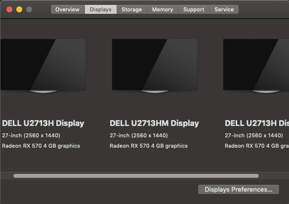

I tried a Saphire Radeon RX 570 with a single DVI (plus hdmi, display port) and also an Asus Radeon 570 with two DVI ports.
All of the DVI ports worked for me.
I'm now running 10.14.6 with (3) 2660 X 1440 Dell monitors using two DVI ports and one Display Port -> DVI (with the Club3D adapter you mentioned). The DVI ports gave me zero trouble!  Thanks for the Cllub3d recommendation!!

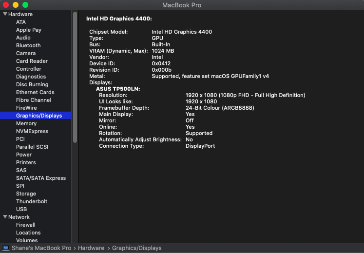

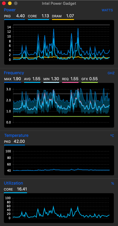

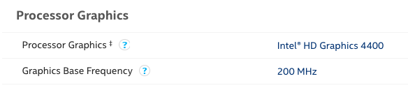

I'm not sure if this is the correct place to post this but i thought it was a CLOVER issue or CLOVER config error on my end but Slice pointed me here.
In my laptop i have HD4400 iGPU and according to intel its base frequency should be 200MHz but when running in macOS my iGPU is idling at 550MHZ (0.55).
I am assuming this is not an issue? but surely this will drain my battery faster than it should.
Any help would be appreciated.

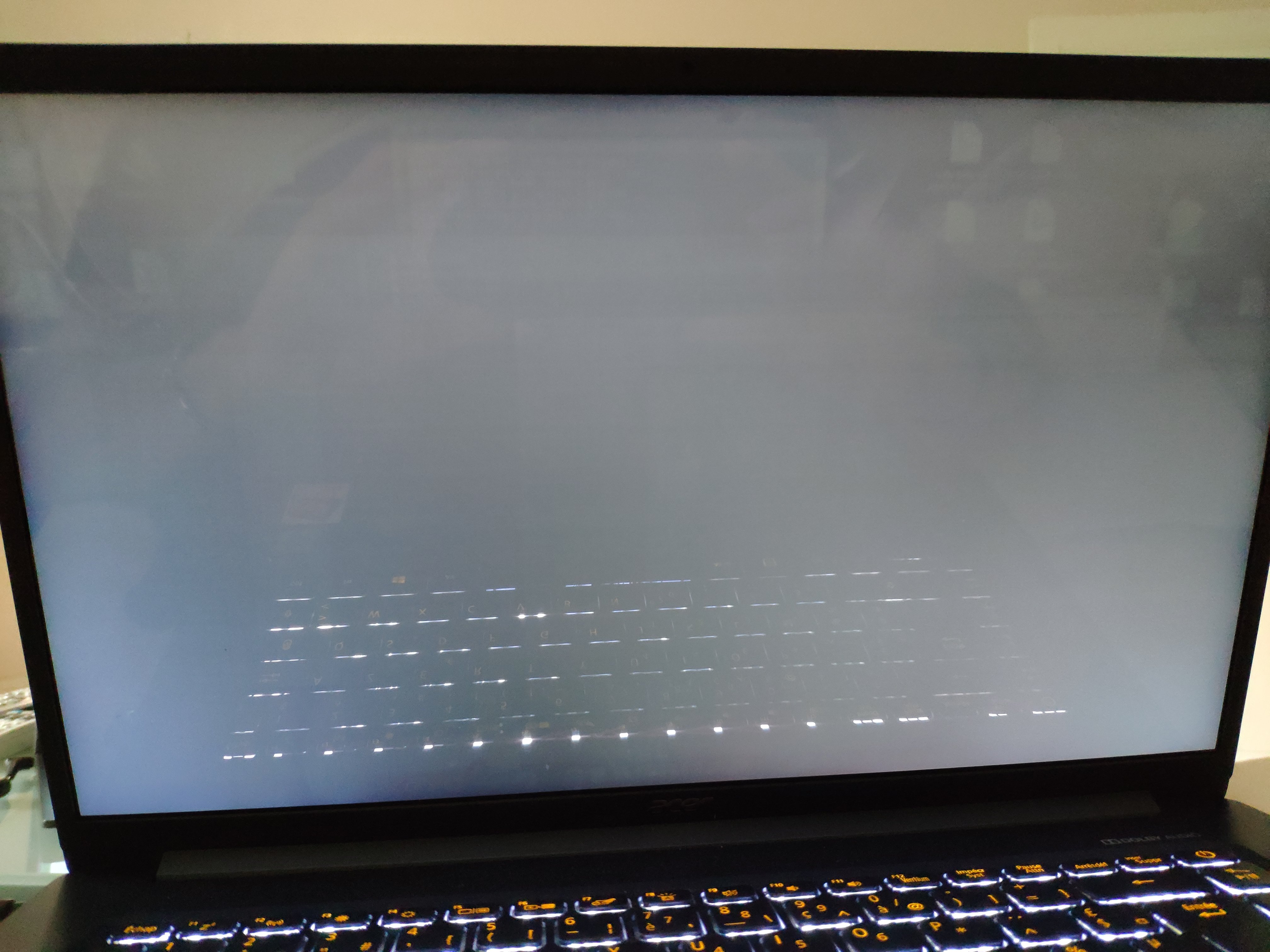

Hi everyone !
I am almost done with an Acer SF515-77 laptop (8565u/uhd620).
Everything is working except I got a blackscreen with backlight after sleep (a dark grey screen, sometimes i almost see like an faded image in dark grey of my desktop). So sleep is not possible image.gif.617b358b43d7e7f12cc60adca35b699a.gif But external screen is OK so my laptop is still working perfectly ... but not usable as a laptop !
I tried a lot of things, including FixEdid to create a customized Edid in Overrides with different screen type (A5,B5) etc ..
I tried to inject EDID and/or Intel with clover too at boot, different config for HDMI in config.plist (but except the black screen at wake up it is working perfectly including external hdmi with audio in 4K)
I tried different values for darkwake too, different smbios type (14 and 15) ... Still no luck
All kext are in /L/E including whatevergreen and lilu. May be it is a framebuffer/whatevergreen configuration problem ?
Here is my clover folder, ioregistry and last system log after sleep.
Thanks for your help !!!!!

33 minutes ago, Andrey1970 said:
First of all you shall delete the PNLF device from DSDT. You should not have added it there.
You were right I add a PNLF in DTST, I think from the brightness patch.
But no luck again.
With clover I got very low brightness after boot, and dark screen after sleep
With PNLF ssdt I got middle birghtness after boot, no more brightness slider in prefs, and dark grey screen after sleep...
By the way what is the difference between PNLFCFL and PNLF SSDT ?
Can you make a miracle ? I am ready to try again and again, this problem is such a hassle  :-)
Edited by Henri75
But no luck again.

Ok so I added PNLF and Intelbacklight and maxbacklight.
Here are the boot logs
By the way previously I said after sleep the screen is very dark grey. Attached is a picture, it looks like if screen is frozen or crashed. Macos is working, I have sound, I can see previous desktop image before sleep but it is washed out and greyed out, and not updated anymore (frozen). External hdmi works perfectly.
bdmesg.log
bdmesg.log
Afterthought : my problems looks like a ghost image in the video fgx after sleep, and not a black screen. In this pic I saw a previous desktop (look at icons on the top right). Earlier tonight it was the apple boot logo :(

On 10/3/2019 at 7:07 PM, Sherlocks said:
remove PNLF ssdt.
then use clover intelbacklight option.
then upload clover log.
나의 SM-N960N 의 Tapatalk에서 보냄
Hi Sherlocks, any idea to solve my grey/ghosted screen after sleep ?
I am stuck for a while with that problem :(
CLOVER.zip
Any suggestions?
4 hours ago, SavageAUS said:
Any suggestions?
You can first try remove Whatevergreen.kext,, just use FakePCIID.kext+ FakePCIIDintelHDGrahics.kext from rehabman. Then set fakeID GPU to 0x014128086.
Let's see about your min freq of GPU. If it still same, then the problem is commonly from the macOS, not about WEG
