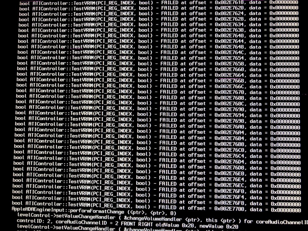

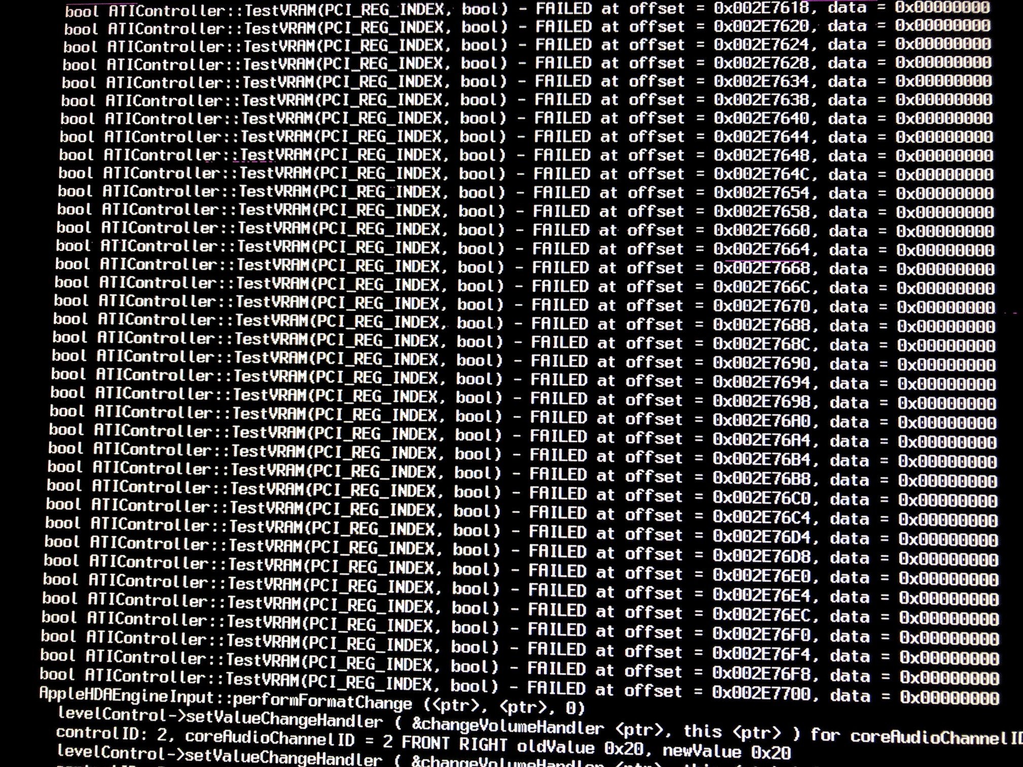

Have mouse lag problem with reference Vega64 + Mojave. Mouse cursor freezes for a ~0.1 second every 3 seconds. Mojave versions tried are 10.14.3 and 10.14.5 (x299, with KGP's config). If i'm using VesaGraphicsFixup instead of Whatevergreen, problem is gone - cursor runs smoothly (but VesaGraphicsFixup have another problems with 10.14.5). Is there are any chances to fix this ? Thanks.
Only thing that VegaGraphicsFixup does is mangle the board-id that apple graphics device policy looks for, which prevents it from loading. This same effect can be achieved by WEG alone by just adding the bootarg
agdpmod=pikera
agdpmod=pikera
ok, but after upgrading to 10.14.5 i have a problem with VegaGraphicsFixup. Approximately one of ten boots video driver didn't start, i see hundreds of errors in log (screenshot attached). I needed VegaGraphicsFixup because i have two 5k monitors attached.

my both monitors detected without a problem and works. WAG works but with mouse lagging. VegaGraphicsFixup works fine but sometimes i see TestVRAM failures at boot.

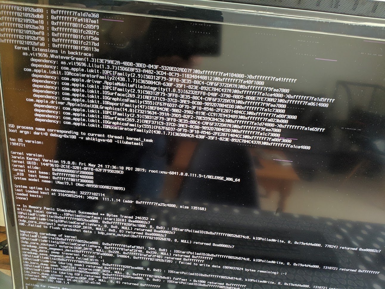

I can't use WEG 1.3.0 under Catalina Beta. Ever with -wegbeta or -lilubetaall. (i7 9700K config). There is a solution?
Please
EDIT: this afternoon, 1.3.0 won't compile (Xcode 10.2 under Mojave): Kernel version error "Catalina"

Replace with newest (build from sources) debug Lilu.kext in WEG folder, then build WEG.

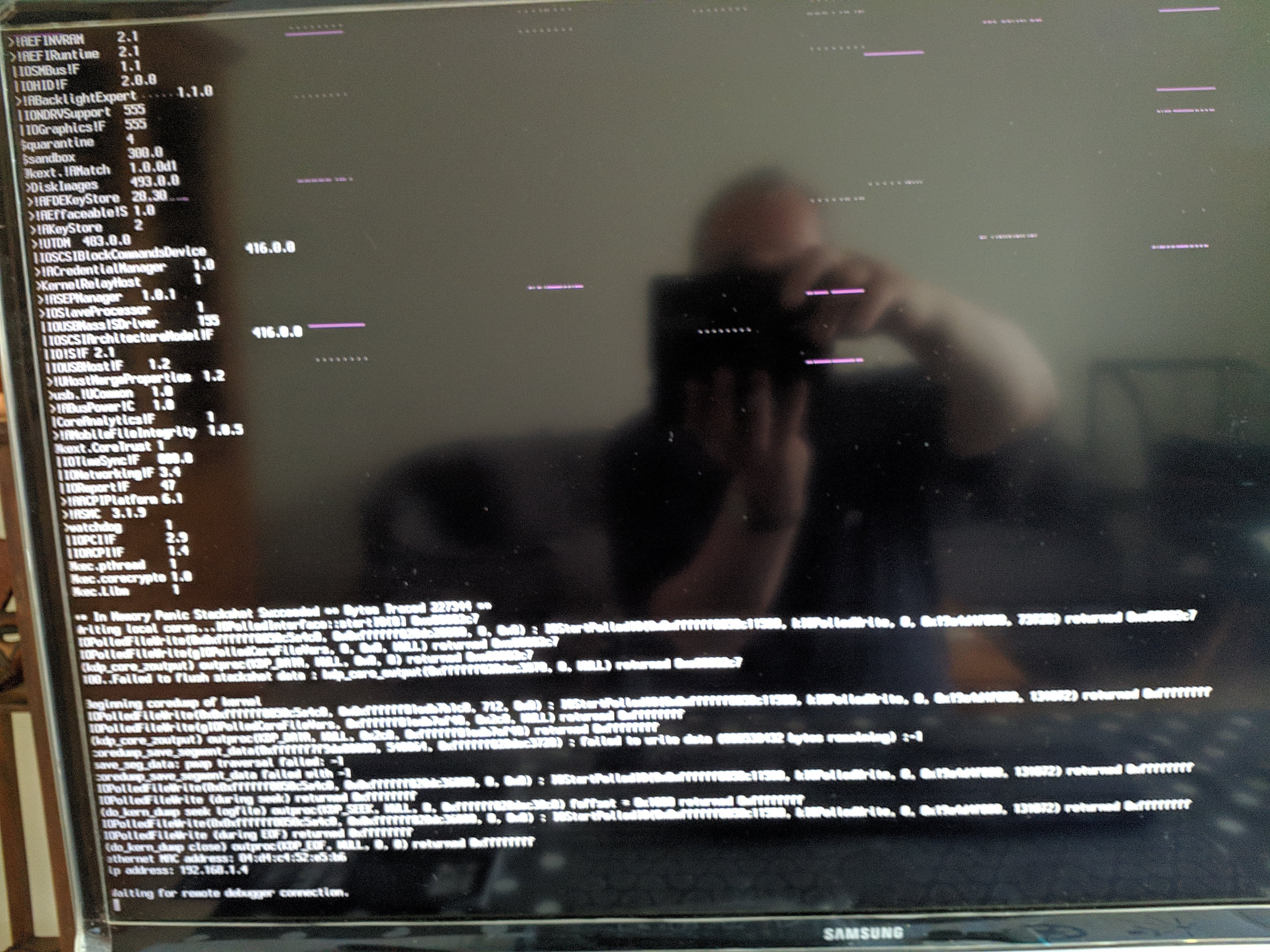

Always kexts panic instead of Desktop. I've to block this kext to launch correctly

5 hours ago, vandroiy2012 said:
The panic report is much more earlier. I can't see what is the problem.
You should build WEG with latest Debug Lilu.kext in WEG folder sources.
Hi
Need help please!
I've issue with latest WEG 1.3.0 on my config i7 9700K - RX 580. See image in attachment
Catalina start only if I block WEG with Clover
Any solutions
