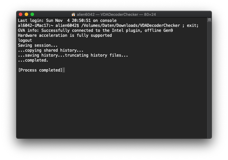

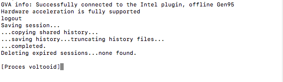

Link number one explains the usage of QuickSync which works, but it doesn't solve the DRM issue.
Link number two states also the obious, that's why my Skylake box is running as an iMac17,1 only using the HD530 Graphics and my Kabylake box uses iMac18,3 with the Vega56 as primary and the HD630 as a connectorless device in the background.
The VDADecoderChecker shows "Hardware acceleration is fully supported" on both machines.
Both links help with the QuickSync issue and the running of free iTunes-Trailers, plus a couple of other neat specialties.
But it doesn't really solve the DRM issue, which I thought could be mitigated with the shikigva entry.

Just checked it to make sure:
Skylake with HD530 doesn't need it.
Kabylake with Vega56 and connectorless HD630 need it definitely to get the graphics working fluently on two 4k-displays.
The test file (1.m4v) plays the sound, but not the video in Quicktime Player.

I choose my SMBIOS settings also in regards to the hardware and the iMac18,3 fits great with the Kabylake and the AMD graphics.
If I would deactivate the IGPU to come nearer to your setup, I will lose the Quicksync function, wouldn't I?
@Andrey1970
Why's that?
It works as charm and get's me the correct results:
