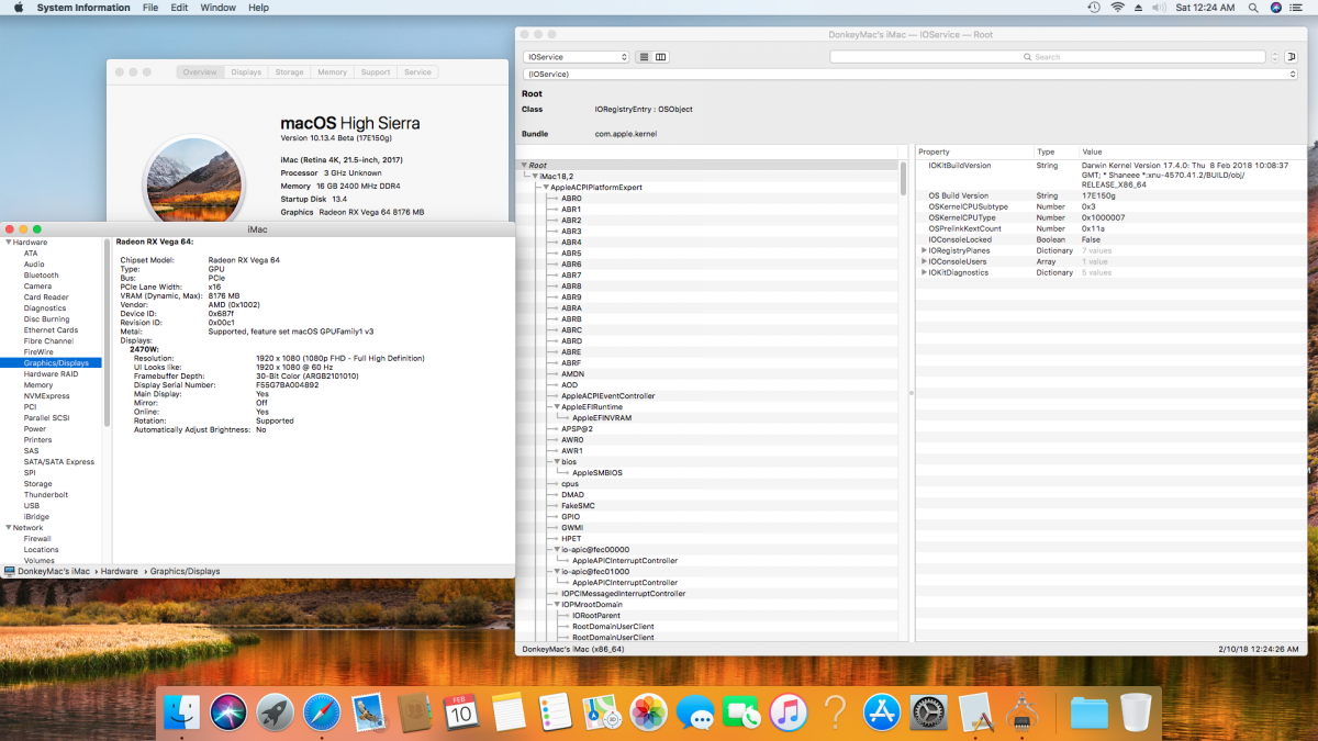

I reinstalled Pre kernel and immutable and was finally able to get it booted and now have WiFi and IOReg shows Shaneee kernel 17.4.   Safari works and everything else.

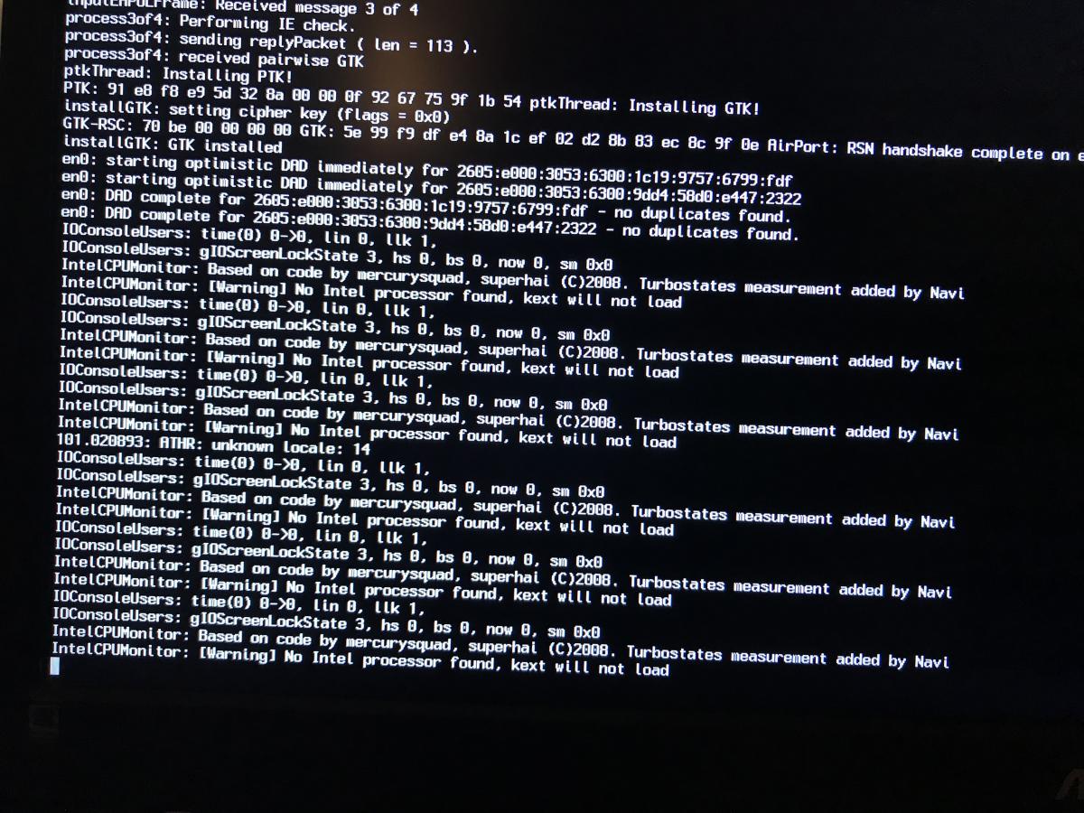

Thanks for this new kernel/prelinkedkernel/System.kext, but it can not boot to desktop due to error of IntelCPUMonitor in both FX-6300 & Ryzen 1700X hackintosh.
Roll-back to previous prelinkedkernel can boot to desktop, but only Google Chrome working properly
How to fix it ?

We need to find the IntelCPUMonitorkext fix, when you used the files I sent you did it boot most of the way and end up with gIOscreenlock and IntelCPUMonitorkext error?    It seems to pass everything else but gets hung up at this point.
Maybe @Slice would know about the IntelCPUMonitor issue and if there is a way to disable it in Clover?    It could be Apple security measures for the Spectre and Meltdown bugs which re aimed at Intel CPUs which apple uses exclusively for OS.

I will try removing lily, Voodoohda and fakesmckext in clover other folder, If IntelCPUMonitor is in S/L/E then it is hidden in other kexts as its not openly present.
Possible it's a plugin inside FakeSMC.
Its not a problem for 13.3 so I'm guessing its a part of 13.4 and it only happens using the original relinked kernel.    If I use praline kernel from a Bronya build it boots fine with no error but there is no wifi, its odd.
