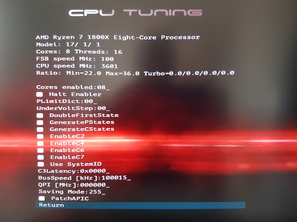

riden666, please delete flag bus ratio ! And here result .
boot-args=npci=0x3000 kext-dev-mode=1 ncl=262144 busratio=36
hw.tbfrequency: 1000000000
hw.cpufrequency_max: 3601000000
hw.cpufrequency_min: 3601000000
hw.cpufrequency: 3601000000
hw.busfrequency_max: 100000000
hw.busfrequency_min: 100000000
hw.busfrequency: 100000000
machdep.tsc.frequency: 3600565200
0:100  0:100  MemLog inited, TSC freq: 3600565200
0:100  0:000  CPU was calibrated without ACPI PM Timer: Intel ICH device was not found., use RTC
0:100  0:000
0:100  0:000  Now is 15.7.2017,  21:22:36 (GMT)
0:100  0:000  Starting Clover revision: 4114 on American Megatrends EFI
0:100  0:000  Build with: [Args: -D NO_GRUB_DRIVERS_EMBEDDED | -D NO_GRUB_DRIVERS_EMBEDDED -D USE_LOW_EBDA -a X64 -b RELEASE -t XCODE5 -n 5 | OS: 10.12.5 | XCODE: 8.3.3]
0:100  0:000  SelfDevicePath=PciRoot(0x0)\Pci(0x1,0x3)\Pci(0x0,0x1)\Sata(0x1,0xFFFF,0x0)\HD(1,GPT,FF3EF174-38AA-44B7-A131-898CFDE5166D,0x28,0x64000) @DAF31998
0:100  0:000  SelfDirPath = \EFI\BOOT
0:103  0:003  === [ Get Smbios ] ========================================
0:103  0:000  Type 16 Index = 0
0:103  0:000  Total Memory Slots Count = 4
0:103  0:000  Type 17 Index = 0
0:103  0:000  Table has error information, checking
0:103  0:000  Found memory information in table 18/1, type=0x3, operation=0x2 syndrome=0x0
0:103  0:000  ...memory OK
0:103  0:000  SmbiosTable.Type17->Speed = 3066MHz
0:103  0:000  SmbiosTable.Type17->Size = 0MB
0:103  0:000  SmbiosTable.Type17->Bank/Device = CHANNEL A DIMM 0
0:103  0:000  SmbiosTable.Type17->Vendor = Unknown
0:103  0:000  SmbiosTable.Type17->SerialNumber = Unknown
0:103  0:000  SmbiosTable.Type17->PartNumber = Unknown
0:103  0:000  Type 17 Index = 1
0:103  0:000  Found memory information in table 18/2, type=0x3, operation=0x2 syndrome=0x0
0:103  0:000  SmbiosTable.Type17->Size = 8192MB
0:103  0:000  SmbiosTable.Type17->Bank/Device = CHANNEL A DIMM 1
0:103  0:000  SmbiosTable.Type17->SerialNumber = 00000000
0:103  0:000  SmbiosTable.Type17->PartNumber = CMK16GX4M2B3200C16
0:103  0:000  Type 17 Index = 2
0:103  0:000  Found memory information in table 18/3, type=0x3, operation=0x2 syndrome=0x0
0:103  0:000  SmbiosTable.Type17->Bank/Device = CHANNEL B DIMM 0
0:103  0:000  Type 17 Index = 3
0:103  0:000  Found memory information in table 18/4, type=0x3, operation=0x2 syndrome=0x0
0:103  0:000  SmbiosTable.Type17->Bank/Device = CHANNEL B DIMM 1
0:103  0:000  Boot status=0
0:103  0:000  Running on: 'MS-7A37' with board 'B350M MORTAR (MS-7A37)'
0:103  0:000  === [ GetCPUProperties ] ==================================
0:103  0:000  CPU Vendor = 68747541 Model=800F11
0:103  0:000   The CPU supported SSE4.1
0:103  0:000  	Looking to disable C1E if is already enabled by the BIOS:
0:103  0:000  BrandString = AMD Ryzen 7 1800X Eight-Core Processor
0:103  0:000  CurrentSpeed: 3600
0:103  0:000  maxratio 72
0:103  0:000  cpudid_zen 8
0:103  0:000  FSBFrequency = 50 MHz, DMI FSBFrequency = 100 MHz, Corrected FSBFrequency = 100 MHz
0:103  0:000  MaxDiv/MinDiv: 36.0/22
0:103  0:000  Turbo: 0/0/0/0
0:103  0:000  Features: 0x178BFBFF
0:103  0:000  Threads: 16
0:103  0:000  Cores: 8
0:103  0:000  FSB: 100 MHz
0:103  0:000  CPU: 3600 MHz
0:103  0:000  TSC: 3600 MHz
0:103  0:000  PIS: 100 MHz
0:103  0:000  ExternalClock: 25 MHz

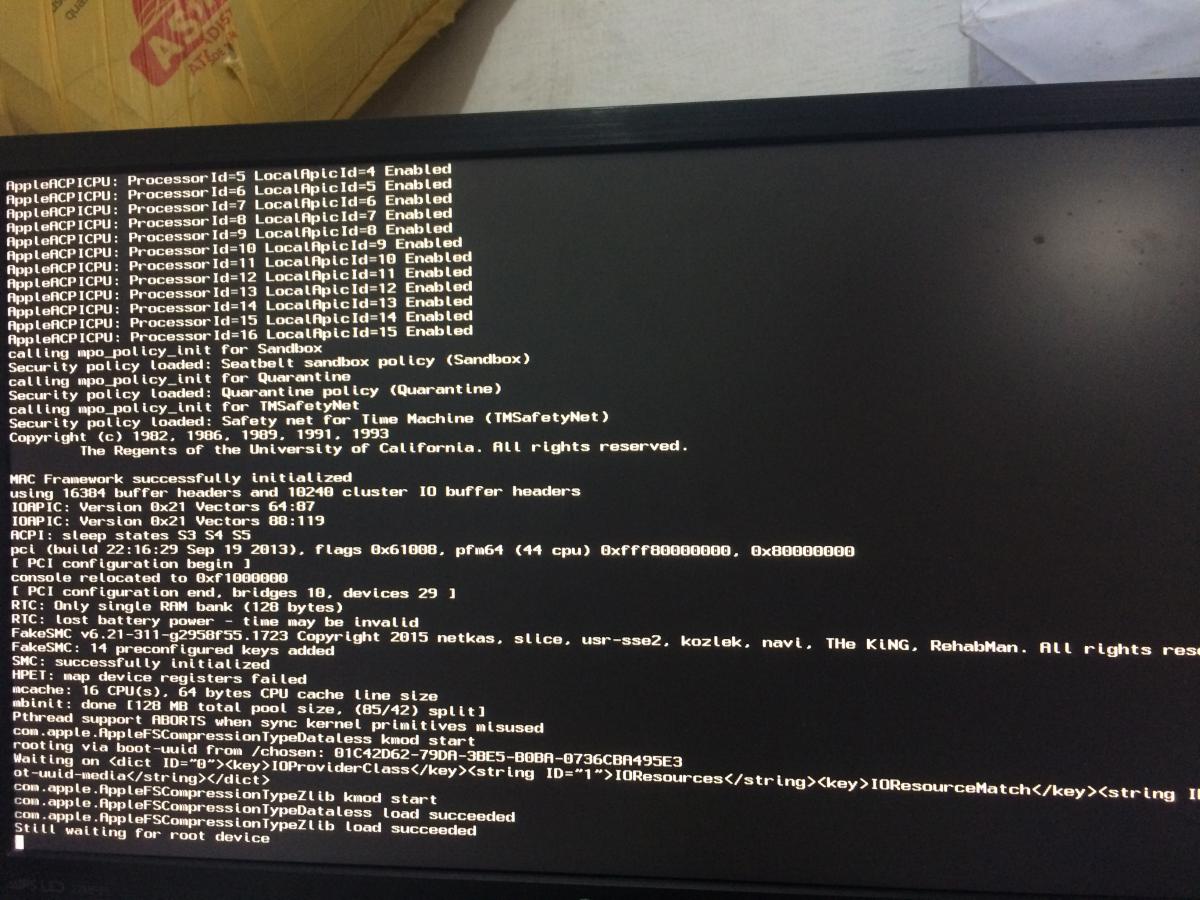

Clover_4114 can boot 10.10.5 to desktop, but too fast timer and very poor performance & sound output were found.
No such a bug for 10.9.5 with newest kernel dated on 2017-07-01.
Clover_4101 can not boot 10.10.5 to desktop, but it worked at 10.9.5 with good sound output in my Ryzen 1700X hackintosh after removal of one kext in /S/L/E.

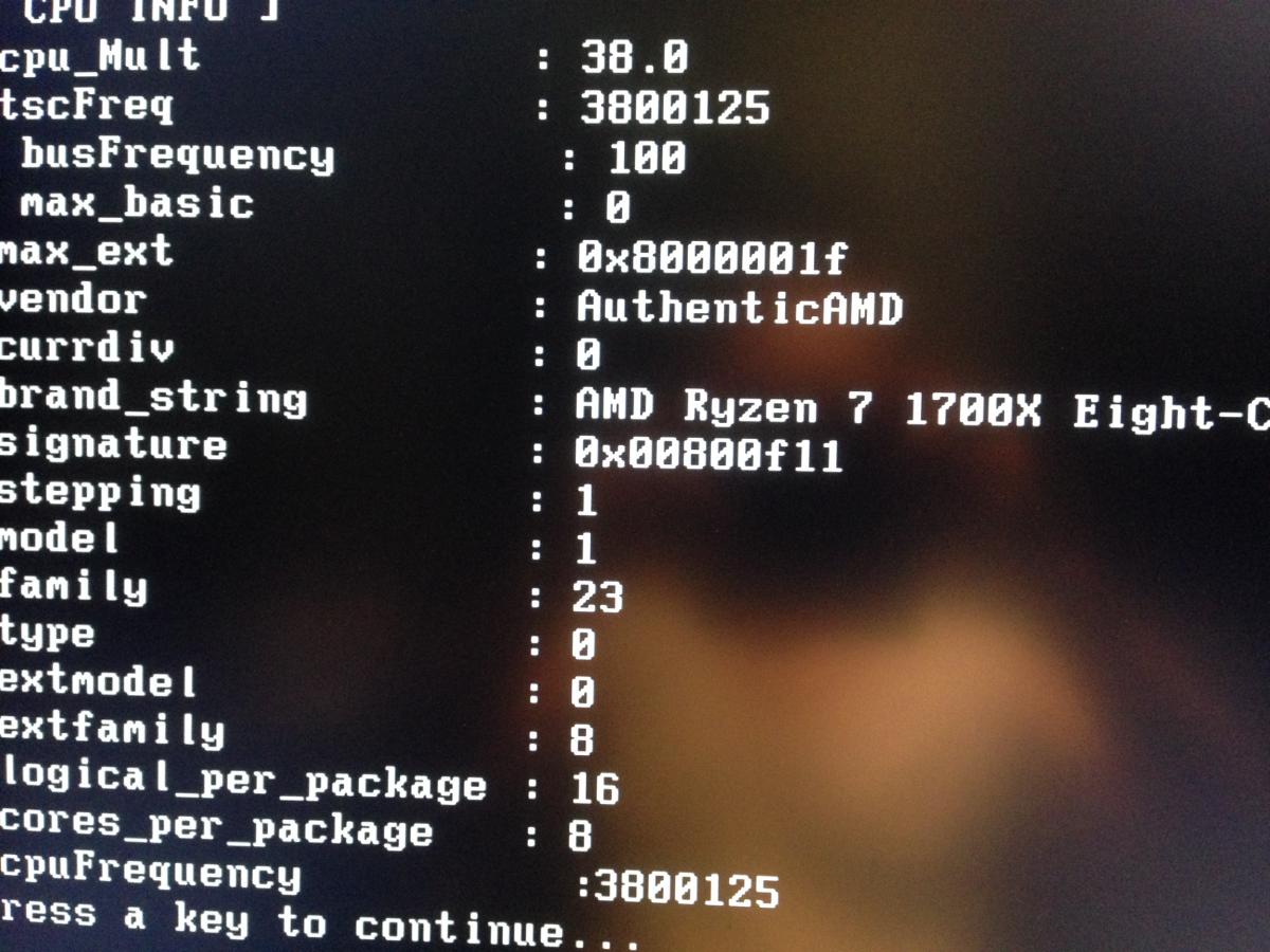

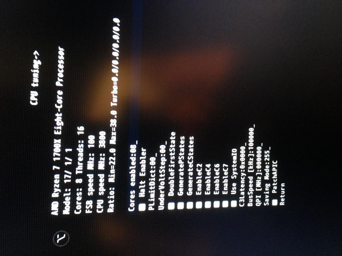

Thanks for this new files.
Kernel_10.9.5 worked perfectly and no difference from previous kernel dated on 2017-07-01.
Boot_Chameleon_Ryzen_rc1 can detect correct CPU parameters & boot to desktop at 10.9.5, 10.10.5, and 10.11.5 with matched Ryzen kernels in my Phenom II x6 1405T hackintosh, but got black screen and reboot at 10.11.6 or 10.10.5 with flags (fsb=200 busratio=15) without matched Ryzen's kernels.
It also worked in Ryzen 1700X hackintosh at 10.9.5 to 10.12.6 without boot flags and its bug is unable to reboot which was fixed by previous Bronya 2892 version.
The disadvantage of Bronya 2892 version is boot flags (fsb=100 busratio) is essential and without these flags always got black screen then reboot.
Clover_4101_fix_rc7 can boot 10.9.5 & 10.12.6 correctly, but 10.10.5 still got too fast timer and very poor performance as previous version. Unable to boot 10.11.6 to desktop yet !
Hope these information may give you some good idea to fix these bug or disadvantage as soon as possible !
10.12.5
Sound is OK.
hw.busfrequency_max: 400000000
hw.busfrequency_min: 400000000
hw.busfrequency: 400000000
machdep.tsc.frequency: 3600594361

Hi !
Here 3 files !
Clover release 4101 , boot_chameleon, and kernel_maverick_10.9.5 !
Please try without flags "fsb=nn and busratio=nn" .
If no works , use flag for test .
And here results an pictures !
I will not make clover and kernel for new ver system , example 10.10.5 or 10.11 ... if you not will test  ...
Hi Bronya, this clover is for Sierra test too?     Or is it for Mavericks, Yosemite, El Cap test?
What flag are you referring to for testing when things don't work?
Currently when I use the above cloverx64.efi to boot 10.12.5 I need to use -v in order to reach the desktop, without it the system just hangs part way through. Also I need to include busratio=37 or else the clock and all animations run way too fast and also Sierra will not load the Nvidia drivers at all (I don't use nvda_drv=1 but my previous cloverx64.efi didn't need it). I have forgotten which kernel version I am using, it has been a few weeks since I got my system installed and working but rc4 sounds familliar, is there anything within the files installed with the kernel to indicate which version it is?
Thanks for this new 10.10.5 kernel which works with normal timer & Cinebench R15 performance by Bronya 2892 boot or Bronya 4101 Clover EFI !
Comparison to 10.9.5 kernel in Ryzen 1700X hackintosh there is significant slower to shutdown at 10.10.5.
Not sure it's due to kernel or Mac OS X version.
