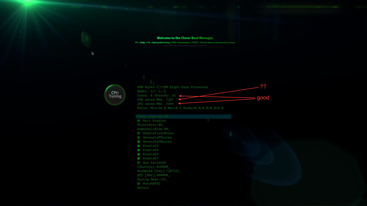

Bronya Posted June 29, 2017 Share Posted June 29, 2017 Hi ! Try this boot for Clover ! Fixed for all Cpu's ! But i need know that how shows Multiplier in Ryzen in menu Clover ! Because i added Min and Max Ratio from manuals fam_17h ! And i added Cores / 2 ! For source , need wait ... Clover_EFI_4092_ALL.zip 2 Link to comment https://www.insanelymac.com/forum/topic/324831-release-open-source-clover-fork-with-ryzen-support/#findComment-2453760 Share on other sites More sharing options...
shawnanastasio Posted June 29, 2017 Author Share Posted June 29, 2017 I have added Min/Max Ratio to my Open Source fork as well. I've uploaded it here as well as the original post. This should resolve all clock speed issues. CLOVERX64.efi 2 Link to comment https://www.insanelymac.com/forum/topic/324831-release-open-source-clover-fork-with-ryzen-support/#findComment-2453795 Share on other sites More sharing options...

gills83 Posted June 29, 2017 Share Posted June 29, 2017 Hi ! Try this boot for Clover ! Fixed for all Cpu's ! But i need know that how shows Multiplier in Ryzen in menu Clover ! Because i added Min and Max Ratio from manuals fam_17h ! And i added Cores / 2 ! For source , need wait ... Clover_EFI_4092_ALL.zip wooh !! 8/16 !! 0:100 0:000 Running on: 'System Product Name' with board 'PRIME B350M-A' 0:100 0:000 === [ GetCPUProperties ] ================================== 0:100 0:000 CPU Vendor = 68747541 Model=800F11 0:100 0:000 The CPU supported SSE4.1 0:100 0:000 Looking to disable C1E if is already enabled by the BIOS: 0:100 0:000 BrandString = AMD Ryzen 7 1700 Eight-Core Processor 0:100 0:000 CurrentSpeed: 3650 0:100 0:000 FSBFrequency = 25 MHz, DMI FSBFrequency = 100 MHz, Corrected FSBFrequency = 100 MHz 0:100 0:000 MaxDiv/MinDiv: 0.5/34 0:100 0:000 Turbo: 0/0/0/0 0:100 0:000 Features: 0x178BFBFF 0:100 0:000 Threads: 16 0:100 0:000 Cores: 8 0:100 0:000 FSB: 25 MHz 0:100 0:000 CPU: 0 MHz 0:100 0:000 TSC: 3650 MHz 0:100 0:000 PIS: 100 MHz but problem speed kernel cinebench 15 1650 => 1403 (1647 Win10) 1 Link to comment https://www.insanelymac.com/forum/topic/324831-release-open-source-clover-fork-with-ryzen-support/#findComment-2453841 Share on other sites More sharing options...
