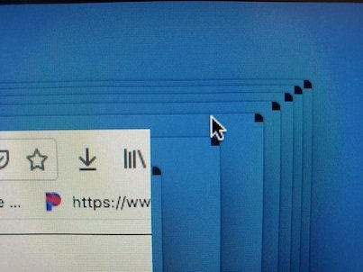

Hey Folks, I could use some help. Drivers appear to be installed and running but when I drag a window across the screen its not refreshing cleanly.
I have a Mac Pro5,1 running macOS 10.13.6 (17G12034), NVIDIA GeForce GTX 1080 Ti NVIDIA Driver (.135). The card is correctly recognised by the machine. The driver shows as active in the NVIDIA Driver Manager.
