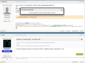

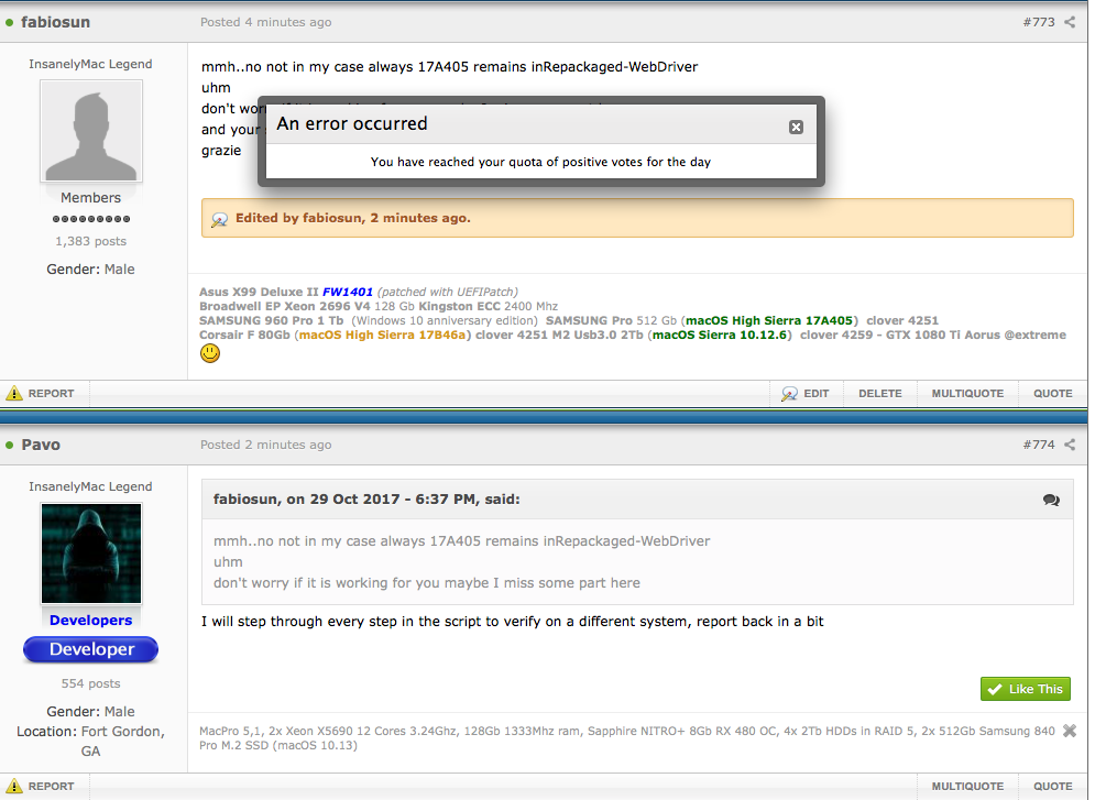

Guest Posted October 29, 2017 Share Posted October 29, 2017 (edited) mmh..no not in my case always 17A405 remains inRepackaged-WebDriver uhm don't worry if it is working for you maybe I miss some part here and your script is so polish and visible to learn many things grazie Edited October 29, 2017 by Guest Link to comment Share on other sites More sharing options...
Pavo Posted October 29, 2017 Share Posted October 29, 2017 mmh..no not in my case always 17A405 remains inRepackaged-WebDriver uhm don't worry if it is working for you maybe I miss some part here I will step through every step in the script to verify on a different system, report back in a bit Link to comment Share on other sites More sharing options...

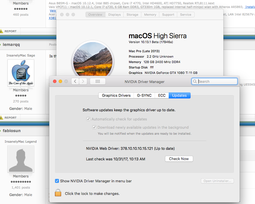

Asgorath Posted November 1, 2017 Share Posted November 1, 2017 https://images.nvidia.com/mac/pkg/378/WebDriver-378.10.10.10.20.107.pkg It's out now for macOS 10.13.1, update macOS first then update this Make sure you've updated to the 121 driver for 10.13 (17A405) before you run the Software Update to 10.13.1, as the 121 driver fixes the panic/reboot loop issue found in the earlier 10.13 drivers. Alternatively, you can just delete the NVDAStartupWeb.kext from /Library/Extensions. 1 Link to comment Share on other sites More sharing options...
Guest Posted November 1, 2017 Share Posted November 1, 2017 or you can also use gengik84 kext to boot in vesa and this is working well for newer card Make sure you've updated to the 121 driver for 10.13 (17A405) before you run the Software Update to 10.13.1, as the 121 driver fixes the panic/reboot loop issue found in the earlier 10.13 drivers. Alternatively, you can just delete the NVDAStartupWeb.kext from /Library/Extensions. Link to comment Share on other sites More sharing options...

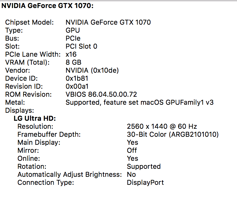

captain-j Posted November 1, 2017 Share Posted November 1, 2017 30bit/10bit color works now! Using latest web drivers 378.10.10.10.20.107 and 10.13.1 (final release). 1 Link to comment Share on other sites More sharing options...
Cyberdevs Posted November 1, 2017 Share Posted November 1, 2017 30bit/10bit color works now! Using latest web drivers 378.10.10.10.20.107 and 10.13.1 (final release). Screen Shot 2017-11-01 at 6.29.08 pm.png Is it working by default or we still need to use the 3rd party software to change the color depth? Link to comment Share on other sites More sharing options...

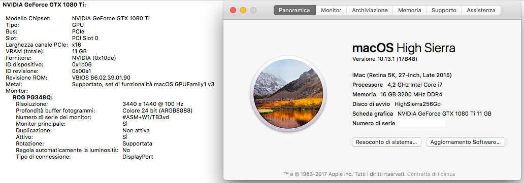

Guest Posted November 1, 2017 Share Posted November 1, 2017 default here you see it in display 30 bit instead 24bit grazie Nvidia Is it working by default or we still need to use the 3rd party software to change the color depth? Link to comment Share on other sites More sharing options...
