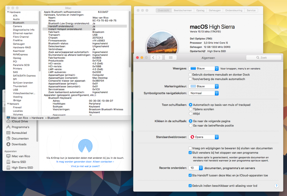

Guest ricoc90 Posted August 3, 2017 Share Posted August 3, 2017 I have the Archer T6E wifi card (Brcm4360, 14e4,43a0 using the-darkvoid patch to make it work) and the Asus BT400 USB Bluetooth dongle (using Rehabman's patch to enable Handoff), which works pretty well in Sierra. In High Sierra however the WiFi Works OOB (no need for the-darkvoid patch), but it's using AirPortBrcmNIC-MFG.kext instead of AirPortBrcm4360.kext and Handoff isn't working. Any intel on that? Update: Removed AirPortBrcmNIC-MFG.kext and replaced IO80211Family.kext with the one from Sierra and handoff works now under High Sierra too But this isn't really update-proof, so if anyone knows a better solution then please tell me Link to comment Share on other sites More sharing options...

Sherlocks Posted August 4, 2017 Share Posted August 4, 2017 Update: Removed AirPortBrcmNIC-MFG.kext and replaced IO80211Family.kext with the one from Sierra and handoff works now under High Sierra too But this isn't really update-proof, so if anyone knows a better solution then please tell me Schermafbeelding 2017-08-03 om 16.12.07.png Good info.Actually handoff patch is same like 10.12 on 10.13. We need to find more bcm patch for handoff. Hmm.. 나의 LG-F800S 의 Tapatalk에서 보냄 Link to comment Share on other sites More sharing options...
Guest ricoc90 Posted August 4, 2017 Share Posted August 4, 2017 Good info. Actually handoff patch is same like 10.12 on 10.13. We need to find more bcm patch for handoff. Hmm.. 나의 LG-F800S 의 Tapatalk에서 보냄 ReHabMan's Handoff patch in IOBluetoothFamily.kext is indeed the same Find: <4885ff74 47488b07> Replace: <41be0f00 0000eb44> Within Sierra the-darkvoid patch is AirPortBrcm4360.kext Find: 81f952aa 00007529 Replace: 81f952aa 00006690 But in High Sierra BCM4360 isn't used by AirPortBrcm4360.kext, but AirPortBrcmNIC-MFG.kext. In Sierra I had to use the-darkvoid patch otherwise my WiFi would not work (no hardware found) In High Sierra the WiFi works OOB on AirPortBrcmNIC-MFG.kext, but handoff does not work then Link to comment Share on other sites More sharing options...

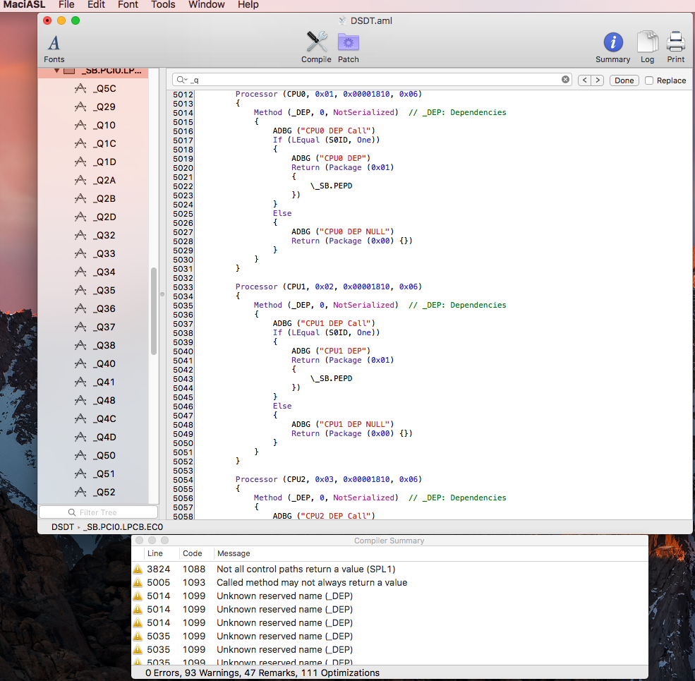

camillionario Posted August 4, 2017 Share Posted August 4, 2017 hi Camillionario what line you insert on dsdt ok,,, For some reason these lines did not appear in DSDT edited before this one. Method Q15 and Q16 are the ones that report the change of state of the cover, so I solved the problem by adding these missing lines in DSDT Method (_Q15, 0, NotSerialized) // _Qxx: EC Query { Store (0x15, P80H) Notify (PS2M, 0x0E) Store (One, LIDS ()) ^^^GFX0.GLID (LIDS ()) Notify (LID0, 0x80) } Method (_Q16, 0, NotSerialized) // _Qxx: EC Query { Store (0x16, P80H) Notify (PS2M, 0x0D) Store (Zero, LIDS ()) ^^^GFX0.GLID (LIDS ()) Notify (LID0, 0x80) } If (LEqual (ECON, One)) { If (LOr (LEqual (Arg0, 0x03), LEqual (Arg0, 0x04))) { Store (\_SB.PCI0.LPCB.EC0.LSTE, LIDS ()) If (IGDS) { If (LEqual (LIDS (), Zero)) { Store (0x80000000, \_SB.PCI0.GFX0.CLID) } If (LEqual (LIDS (), One)) { Store (0x80000003, \_SB.PCI0.GFX0.CLID) } } } Product of an erroneous compilation with MaciasL ACPI 6.1 being correct ACPI 4.0 With this, solve the problem. Thanks Piker 2 Link to comment Share on other sites More sharing options...

vrondena Posted August 5, 2017 Share Posted August 5, 2017 ok,,, For some reason these lines did not appear in DSDT edited before this one. Method Q15 and Q16 are the ones that report the change of state of the cover, so I solved the problem by adding these missing lines in DSDT Method (_Q15, 0, NotSerialized) // _Qxx: EC Query { Store (0x15, P80H) Notify (PS2M, 0x0E) Store (One, LIDS ()) ^^^GFX0.GLID (LIDS ()) Notify (LID0, 0x80) } Method (_Q16, 0, NotSerialized) // _Qxx: EC Query { Store (0x16, P80H) Notify (PS2M, 0x0D) Store (Zero, LIDS ()) ^^^GFX0.GLID (LIDS ()) Notify (LID0, 0x80) } If (LEqual (ECON, One)) { If (LOr (LEqual (Arg0, 0x03), LEqual (Arg0, 0x04))) { Store (\_SB.PCI0.LPCB.EC0.LSTE, LIDS ()) If (IGDS) { If (LEqual (LIDS (), Zero)) { Store (0x80000000, \_SB.PCI0.GFX0.CLID) } If (LEqual (LIDS (), One)) { Store (0x80000003, \_SB.PCI0.GFX0.CLID) } } } Product of an erroneous compilation with MaciasL ACPI 6.1 being correct ACPI 4.0 With this, solve the problem. Thanks Piker i do not have method q15 e q16 on my dsdt. how compile if is possible DSDT.aml.zip Link to comment Share on other sites More sharing options...
camillionario Posted August 5, 2017 Share Posted August 5, 2017 i do not have method q15 e q16 on my dsdt. how compile if is possible In your DSDT Q52 Q53. This might not work if Sleep / Hibernation Wake does not work, or CPU power Management is not implemented.Try DSDT attached. DSDT.aml.7z Link to comment Share on other sites More sharing options...
vrondena Posted August 5, 2017 Share Posted August 5, 2017 In your DSDT Q52 Q53. This might not work if Sleep / Hibernation Wake does not work, or CPU power Management is not implemented.Try DSDT attached. DSDT.aml.7z sorry but if compile your dsdt with MaciasL ACPI 6.1 I have 2 error on ACPI 4.0 67 error. ps for implemented correct pow man ? Link to comment Share on other sites More sharing options...
camillionario Posted August 5, 2017 Share Posted August 5, 2017 Compiled and without errors for me Link to comment Share on other sites More sharing options...
vrondena Posted August 5, 2017 Share Posted August 5, 2017 Compiled and without errors for me Captura de pantalla 2017-08-05 a las 18.34.00.png on sierra and high Sierra i have same error if compile .this is my original dsdt (2 error) clover DSDT.aml.zip Link to comment Share on other sites More sharing options...
