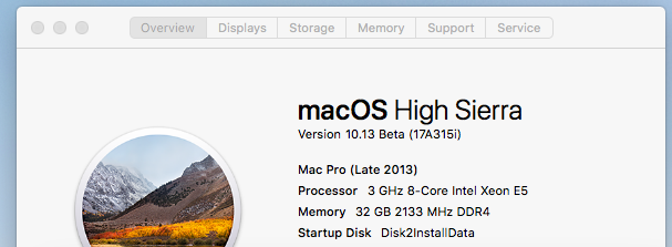

nmano Posted July 30, 2017 Share Posted July 30, 2017 Unknown CPU Fixed About this Mac unknown cpu error fixed. Thius patched worked Haswell-E CPU and Broadwell CPU 1-Enable in config xcpm_bootstrap_Broadwell or Haswell 2-Enable in config xcpm_cpuid_set_infoBroadwell or Haswell 3-FakeCPUID is Broadwell 0x040674 4.CPU Type is Broadwell 0x0a02 5-FakeCPUID is Haswell 0x0306F2 6.CPU Type is Haswell 0x0a01 XCPM Brodwell and Haswell.zip Link to comment Share on other sites More sharing options...

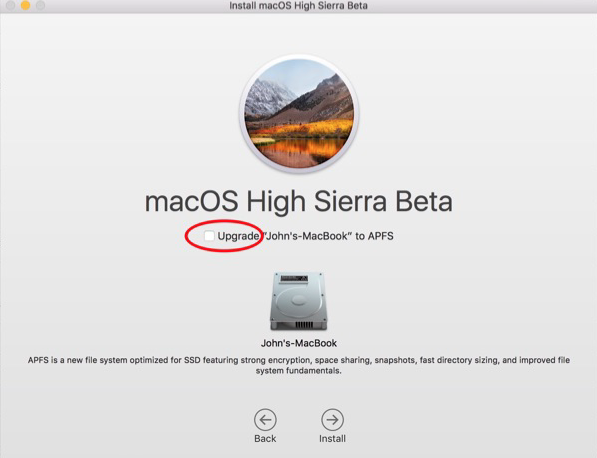

Matgen84 Posted July 30, 2017 Share Posted July 30, 2017 LOL you can format what ever you want but Developer Beta 4 converts everything to APFS On my config, since Beta 1, there is no convert automatically to Apfs during installation. For Beta 4, Apple say "HDD Macs only can't be converted" in this seed release. Until first Beta, macOS Installer indicates the upgrade on some system: just deselect. LOL Apple make change? Did you do Beta 4 clean install? 1 Link to comment Share on other sites More sharing options...

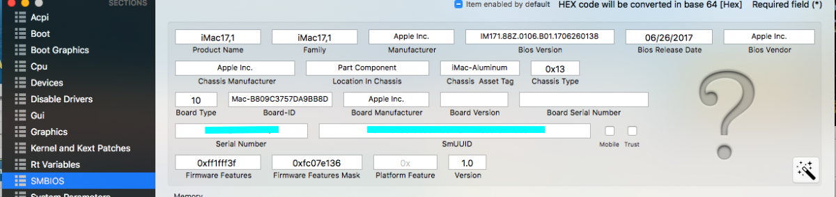

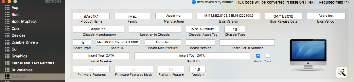

camillionario Posted July 30, 2017 Share Posted July 30, 2017 I have tried to install High Sierra in HDD without changing anything in smbios (Configuration suggested by Clover) and the installation DP4 automatically changes APFS.If you change Bios Version FF and FFM, the installation is done in HFS +.I had to format HDD a few times without being aware of it, until I made the changes. APFS HFS+ Update from DP1 to DP4 1 Link to comment Share on other sites More sharing options...
