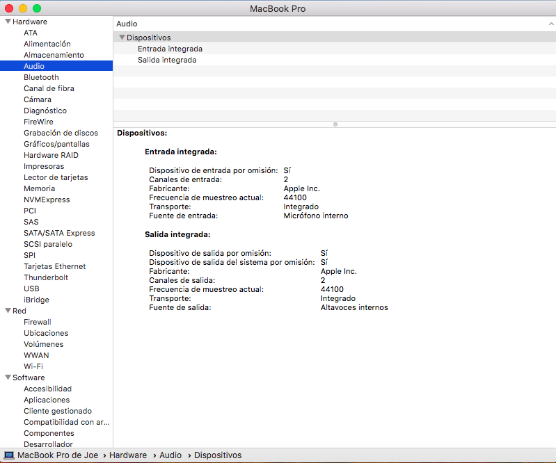

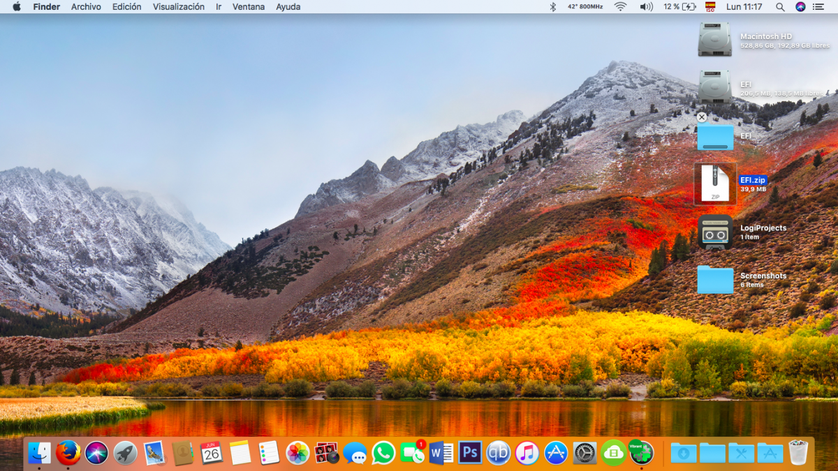

kosakgroove Posted June 26, 2017 Share Posted June 26, 2017 Hi guys! I come here appealing to the developers of AppleALC, my Internal Speakers and Internal Microphone were working great with Sierra and with High Sierra DP1 , but since I updated to DP2 i have no sound anymore, I use this layoutid "layout-id", Buffer (0x04) { 0x1D, 0x00, 0x00, 0x00 }, I am using the latest AppleALC and the flags -alcbeta and -lilubeta, as you can see here in my EFI folder I would really like some help... My ASUS X550LDV uses ALC233 and as I said something changed in DP2 that broke the audio.. Thanks in advance EFI.zip Here is my ioreg in case it is of help MacBook Pro de Joe.zip Link to comment Share on other sites More sharing options...

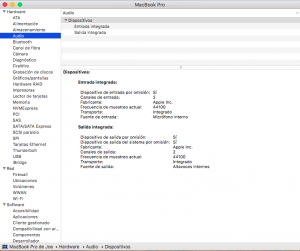

SavageAUS Posted June 26, 2017 Share Posted June 26, 2017 Hi guys! I come here appealing to the developers of AppleALC, my Internal Speakers and Internal Microphone were working great with Sierra and with High Sierra DP1 , but since I updated to DP2 i have no sound anymore, I use this layoutid "layout-id", Buffer (0x04) { 0x1D, 0x00, 0x00, 0x00 },I am using the latest AppleALC and the flags -alcbeta and -lilubeta, as you can see here in my EFI folder I would really like some help... My ASUS X550LDV uses ALC233 and as I said something changed in DP2 that broke the audio.. Thanks in advance Captura de pantalla 2017-06-26 a las 11.16.57.png Captura de pantalla 2017-06-26 a las 11.21.23.png EFI.zip Here is my ioreg in case it is of help MacBook Pro de Joe.zip My haswell laptop has alc3236 which at first i thought was alc233 not that it should matter as long as your using the correct layout and using layout 4 as you are my audio works using the beta flags. Have you tried a different layout? Also without downloading your EFI folder do you have latest lilu.kext? Also how did you get battery icon in HS? Mine works but I have to manually check the box every boot. Sent from my SM-G930F using Tapatalk 1 Link to comment Share on other sites More sharing options...

Cyberdevs Posted June 26, 2017 Share Posted June 26, 2017 Well the sound is back. I neglected to add a tiny - before the alcbeta and lilubeta. Thanks a lot for the support guys. Clumsy me 3 Link to comment Share on other sites More sharing options...
kosakgroove Posted June 26, 2017 Share Posted June 26, 2017 Tried layout id 4 as suggested as well as 3 but they don't seem to work... I wonder what is wrong About the battery icon i don't know, it has been 100% reliable from Mavericks to High Sierra DP1 Link to comment Share on other sites More sharing options...

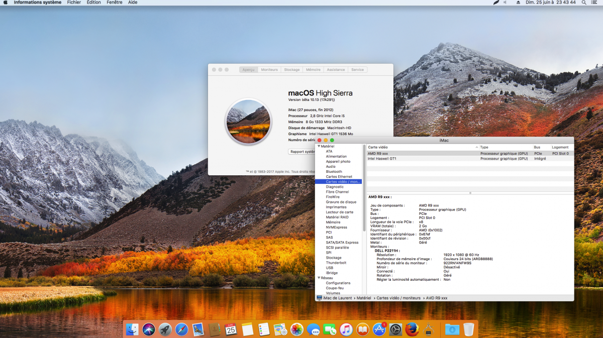

Loloflat6 Posted June 26, 2017 Share Posted June 26, 2017 I followed this post carefully from the beginning.I created a usb installer with create instal media for 10,13, betaI used clover 4097After the complete installation, I upgraded via appstore to 10,13, beta 2All is ok and my msi rx 460 works fine(Thanks for all the tips I can read here) Link to comment Share on other sites More sharing options...

ITzTravelInTime Posted June 26, 2017 Share Posted June 26, 2017 I followed this post carefully from the beginning. I created a usb installer with create instal media for 10,13, beta I used clover 4097 After the complete installation, I upgraded via appstore to 10,13, beta 2 All is ok and my msi rx 460 works fine (Thanks for all the tips I can read here) wich fixes did you use to get the rx 460 to be properly detected and working? how do you get the haswell gt1 recognized? Link to comment Share on other sites More sharing options...

Loloflat6 Posted June 27, 2017 Share Posted June 27, 2017 wich fixes did you use to get the rx 460 to be properly detected and working? how do you get the haswell gt1 recognized? No fixes : Just set bios IGP (not PEG) DVi or DP connected at the rx 460 on my first monitor Dvi connected at the mobo on my second monitor Not like in Sierra both monitors are initiated at the same time I can boot without wire connected at the mobo if i prefere to use only my first monitor. For my CPU G1840 celeron i use : <key>KernelAndKextPatches</key> <dict> <key>FakeCPUID</key> <string>0x0306A0</string> .../... <key>Devices</key> <dict> <key>FakeID</key> <dict> <key>IntelGFX</key> <string>0x04128086</string> ... <key>Graphics</key> <dict> <key>Inject</key> <dict> <key>Intel</key> <true/> </dict> <key>ig-platform-id</key> <string>0x0a260006</string> Piker-Alpha ssdt.PRGen.sh Patched DSDT Lilu kext Intelgraphicsfixup Kext FakeCPUID kext FakeGPUsensor kext In High Sierra all is ok with 1536 mo vram size. Link to comment Share on other sites More sharing options...
