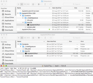

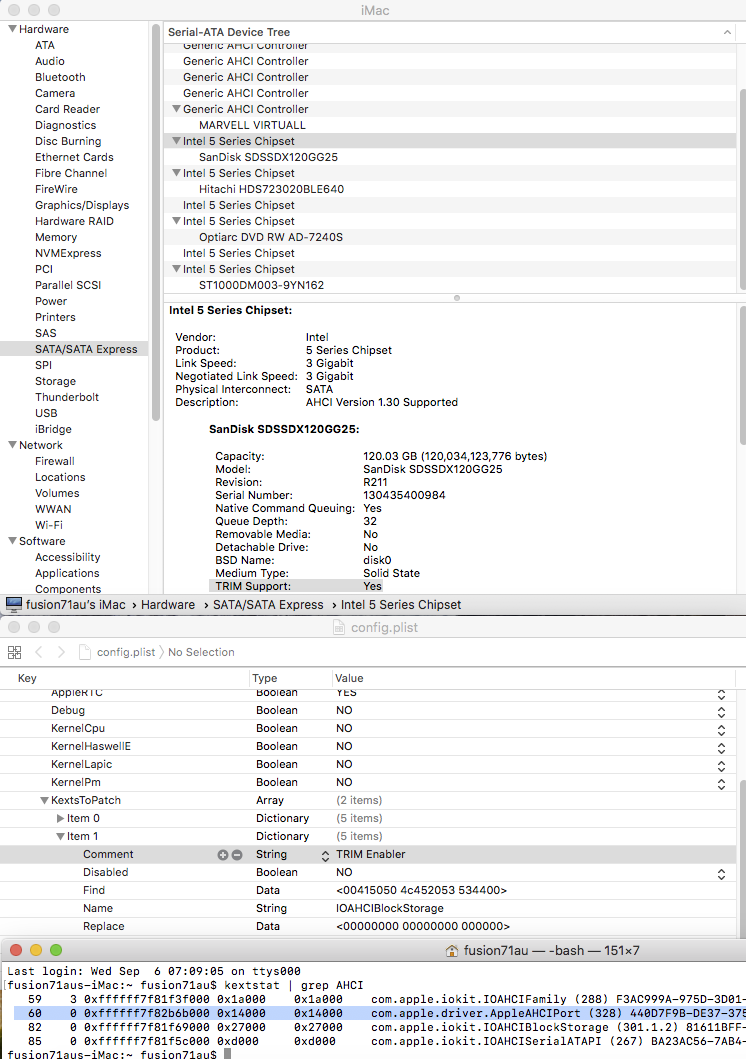

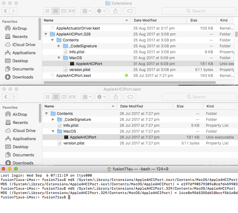

fusion71au Posted September 5, 2017 Share Posted September 5, 2017 fusion71au, on 30 Aug 2017 - 12:51 AM, said: Thank. I try but don't work... Edit: Asmedia1061-Asmedia1062 with with AHCIPortInjector.kext. Since beta 7 and of course with Beta 8, I can no longer use the hot-plugging of internal hard drives. I can't insert HDD when High Sierra is running. Does anyone even have same problem? Hot-pluggging HDD work like a charm under Sierra. According to kextstat, the kexts loading on my system related to AHCI are fusion71aus-iMac:~ fusion71au$ kextstat | grep AHCI 64 3 0xffffff7f81f3f000 0x1a000 0x1a000 com.apple.iokit.IOAHCIFamily (288) F3AC999A-975D-3D01-82D4-8ACCB4A885B1 <5 4 3 1> 65 0 0xffffff7f82b6b000 0x14000 0x14000 com.apple.driver.AppleAHCIPort (328) 440D7F9B-DE37-375D-AFE0-EABC372B001E <64 12 5 4 3 1> 78 0 0xffffff7f81f69000 0x27000 0x27000 com.apple.iokit.IOAHCIBlockStorage (301.1.2) 81611BFF-AE58-3937-A337-1731E734B3C2 <64 27 6 5 4 3 1> 85 0 0xffffff7f81f5c000 0xd000 0xd000 com.apple.iokit.IOAHCISerialATAPI (267) BA23AC56-7AB4-3898-A468-B18B1550E039 <64 28 5 4 3 1> Maybe try downgrading both AppleAHCIPort and IOAHCIFamily kexts to versions before DB7 (after making backups of current kexts). Attached are AHCI kexts from High Sierra PB1_17A291m. Note IOAHCIBlockStorage and IOAHCISerialATAPI are Plugin kexts inside IOAHCIFamily.kext. Don't forget to set correct kext permissions and rebuild caches (sudo touch /System/Library/Extensions && sudo kextcache -u /). Can check kexts are loadable with kextutil -tn command eg fusion71aus-iMac:~ fusion71au$ sudo kextutil -tn /System/Library/Extensions/AppleAHCIPort.kext Password: /System/Library/Extensions/AppleAHCIPort.kext appears to be loadable (including linkage for on-disk libraries). Good Luck! AHCI kexts from PB1_17A291m.zip 2 Link to comment Share on other sites More sharing options...
Matgen84 Posted September 5, 2017 Share Posted September 5, 2017 According to kextstat, the kexts loading on my system related to AHCI are fusion71aus-iMac:~ fusion71au$ kextstat | grep AHCI 64 3 0xffffff7f81f3f000 0x1a000 0x1a000 com.apple.iokit.IOAHCIFamily (288) F3AC999A-975D-3D01-82D4-8ACCB4A885B1 <5 4 3 1> 65 0 0xffffff7f82b6b000 0x14000 0x14000 com.apple.driver.AppleAHCIPort (328) 440D7F9B-DE37-375D-AFE0-EABC372B001E <64 12 5 4 3 1> 78 0 0xffffff7f81f69000 0x27000 0x27000 com.apple.iokit.IOAHCIBlockStorage (301.1.2) 81611BFF-AE58-3937-A337-1731E734B3C2 <64 27 6 5 4 3 1> 85 0 0xffffff7f81f5c000 0xd000 0xd000 com.apple.iokit.IOAHCISerialATAPI (267) BA23AC56-7AB4-3898-A468-B18B1550E039 <64 28 5 4 3 1> Maybe try downgrading both AppleAHCIPort and IOAHCIFamily kexts to versions before DB7 (after making backups of current kexts). Attached are AHCI kexts from High Sierra PB1_17A291m. Note IOAHCIBlockStorage and IOAHCISerialATAPI are Plugin kexts inside IOAHCIFamily.kext. Don't forget to set correct kext permissions and rebuild caches (sudo touch /System/Library/Extensions && sudo kextcache -u /). Can check kexts are loadable with kextutil -tn command eg fusion71aus-iMac:~ fusion71au$ sudo kextutil -tn /System/Library/Extensions/AppleAHCIPort.kext Password: /System/Library/Extensions/AppleAHCIPort.kext appears to be loadable (including linkage for on-disk libraries). Good Luck! Thanks. I try this. I've forgotten: I use under Sierra and High Sierra, AHCIPortInjector.kext (Fabio version 2016) in EFI/CLOVER/KEXT and I can Hot-Plugging. It does the job now only in Sierra. Update: with only AppleAHCIPort version 328 instead of version 329 in S/L/E and AHCIPortInjector.kext (Fabio version 2016) in EFI/CLOVER/KEXT Hot-Plug work again under High Sierra. I don't know why? these two versions, both of which date back to 2016, appear to be identical. Should I do the same manipulation for the release? 1 Link to comment Share on other sites More sharing options...

erice Posted September 5, 2017 Share Posted September 5, 2017 According to kextstat, the kexts loading on my system related to AHCI are fusion71aus-iMac:~ fusion71au$ kextstat | grep AHCI 64 3 0xffffff7f81f3f000 0x1a000 0x1a000 com.apple.iokit.IOAHCIFamily (288) F3AC999A-975D-3D01-82D4-8ACCB4A885B1 <5 4 3 1> 65 0 0xffffff7f82b6b000 0x14000 0x14000 com.apple.driver.AppleAHCIPort (328) 440D7F9B-DE37-375D-AFE0-EABC372B001E <64 12 5 4 3 1> 78 0 0xffffff7f81f69000 0x27000 0x27000 com.apple.iokit.IOAHCIBlockStorage (301.1.2) 81611BFF-AE58-3937-A337-1731E734B3C2 <64 27 6 5 4 3 1> 85 0 0xffffff7f81f5c000 0xd000 0xd000 com.apple.iokit.IOAHCISerialATAPI (267) BA23AC56-7AB4-3898-A468-B18B1550E039 <64 28 5 4 3 1> Maybe try downgrading both AppleAHCIPort and IOAHCIFamily kexts to versions before DB7 (after making backups of current kexts). Attached are AHCI kexts from High Sierra PB1_17A291m. Note IOAHCIBlockStorage and IOAHCISerialATAPI are Plugin kexts inside IOAHCIFamily.kext. Don't forget to set correct kext permissions and rebuild caches (sudo touch /System/Library/Extensions && sudo kextcache -u /). Can check kexts are loadable with kextutil -tn command eg fusion71aus-iMac:~ fusion71au$ sudo kextutil -tn /System/Library/Extensions/AppleAHCIPort.kext Password: /System/Library/Extensions/AppleAHCIPort.kext appears to be loadable (including linkage for on-disk libraries). Good Luck! Thanks first of all to the suggestion. The hot plug now works; but trim activation no longer works. ??? Thanks first of all to the suggestion. The hot plug now works; but trim activation no longer works. ??? AppleDataSetManagement.kext Dependency Resolution Failures: Kexts already loaded for these libraries have no OSBundleCompatibleVersion: com.apple.iokit.IOAHCIBlockStorage 1 Link to comment Share on other sites More sharing options...
fusion71au Posted September 5, 2017 Share Posted September 5, 2017 Update: with only AppleAHCIPort version 328 instead of version 329 in S/L/E and AHCIPortInjector.kext (Fabio version 2016) in EFI/CLOVER/KEXT Hot-Plug work again under High Sierra. I don't know why? these two versions, both of which date back to 2016, appear to be identical. Should I do the same manipulation for the release? When you compare the MD5 values of the binaries inside AppleAHCIPort kexts v328 vs v329, you will find that they are different... We will have to wait for the final release before knowing if regressing the kext still works . It seems v329 is still buggy on quite a few older hardwares eg Disks not recognised on ICH10 chipset Certain disks not recognised/fail to be initialised on my 5 series motherboard whereas other disks recognised OK, even using the same or different port. Your own experience with hot plugging drives on Asmedia 1061. Thanks first of all to the suggestion. The hot plug now works; but trim activation no longer works. Downgrade only AppleAHCIPort v329 to v328 (restore original IOAHCIFamily with IOAHCIBlockStorage kext in /S/L/E, repair permissions & rebuild kext cache etc) Enable Trim with Clover KextsToPatch.... <key>KextsToPatch</key> <array> <dict> <key>Comment</key> <string>TRIM Enabler</string> <key>Disabled</key> <false/> <key>Find</key> <data> AEFQUExFIFNTRAA= </data> <key>Name</key> <string>IOAHCIBlockStorage</string> <key>Replace</key> <data> AAAAAAAAAAAAAAA= </data> </dict> 3 Link to comment Share on other sites More sharing options...
