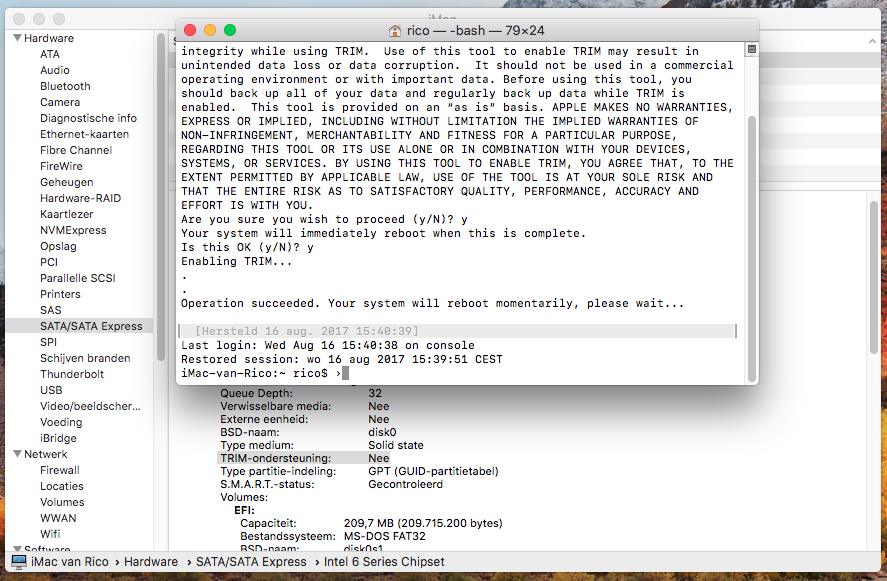

Guest ricoc90 Posted August 16, 2017 Share Posted August 16, 2017 Anyone else having issues enabling TRIM in DP6? sudo trimforce enable reports that the operation succeeded, but after a reboot system profiler reports that it's not. Link to comment Share on other sites More sharing options...
MacPeet Posted August 16, 2017 Share Posted August 16, 2017 The "sudo trimforce enable" method no longer works. The old method with Clover works: <key>KextsToPatch</key><array> <dict> <key>Find</key> <data> QVBQTEUgU1NE </data> <key>Name</key> <string>IOAHCIBlockStorage</string> <key>Replace</key> <data> AAAAAAAAAAAA </data> </dict> </array> Link to comment Share on other sites More sharing options...

Guest ricoc90 Posted August 16, 2017 Share Posted August 16, 2017 The "sudo trimforce enable" method no longer works. The old method with Clover works: <key>KextsToPatch</key><array> <dict> <key>Find</key> <data> QVBQTEUgU1NE </data> <key>Name</key> <string>IOAHCIBlockStorage</string> <key>Replace</key> <data> AAAAAAAAAAAA </data> </dict> </array> Thanks dude, it works indeed Link to comment Share on other sites More sharing options...
FredWst Posted August 16, 2017 Share Posted August 16, 2017 Anyone else having issues enabling TRIM in DP6? sudo trimforce enable reports that the operation succeeded, but after a reboot system profiler reports that it's not. Schermafbeelding 2017-08-16 om 15.41.20.png Doesn't work on real MacBookPro 6,1. Fred Link to comment Share on other sites More sharing options...
MacPeet Posted August 16, 2017 Share Posted August 16, 2017 No chance on real Mac with the beta, without extra boot loader (clover). Only for Hackintosh with Clover possible, the patch from post # 2770. Life is hard. Link to comment Share on other sites More sharing options...

Pavo Posted August 16, 2017 Share Posted August 16, 2017 Doesn't work on real MacBookPro 6,1. Fred The latest TRIM Enabler app works on 10.13 beta 6 on real macs. 2 Link to comment Share on other sites More sharing options...

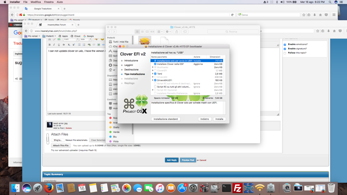

vrondena Posted August 16, 2017 Share Posted August 16, 2017 hello,I can not update clover on usb, i have the version 4128 . if i install 4173 or other version ........where i am wrong thank you Link to comment Share on other sites More sharing options...

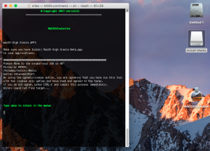

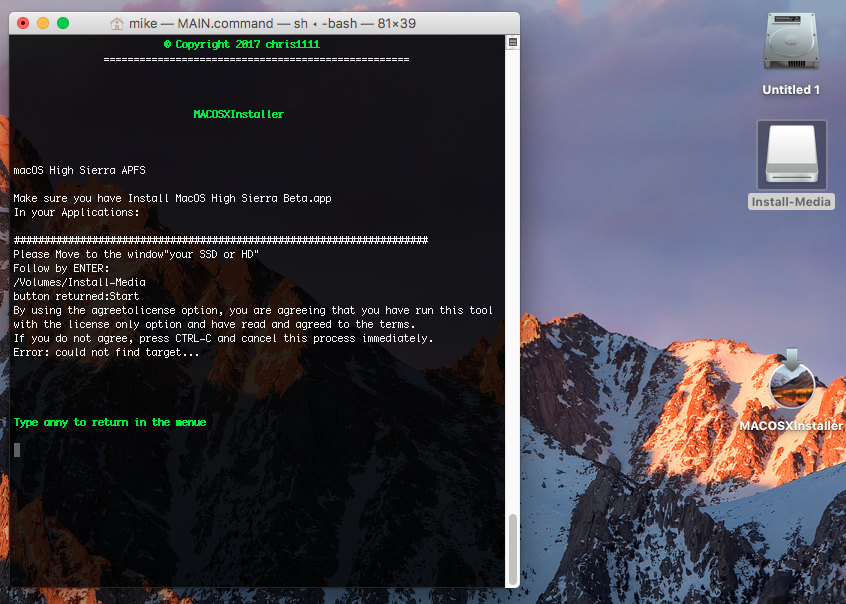

MICKHAEL Posted August 16, 2017 Share Posted August 16, 2017 Thanks @Sherlocks Clover r4175 works on many SMBIOS for me now Great Patch hello. some ideas? Link to comment Share on other sites More sharing options...
chris1111 Posted August 16, 2017 Share Posted August 16, 2017 hello. some ideas? hello. some ideas? This is not for simple USB installer its for Deploy in a Drive , HD or SSD Internal or external so used it in the Right way please Also I am not give a support for that here PM me for this or Email me in git Thanks Link to comment Share on other sites More sharing options...

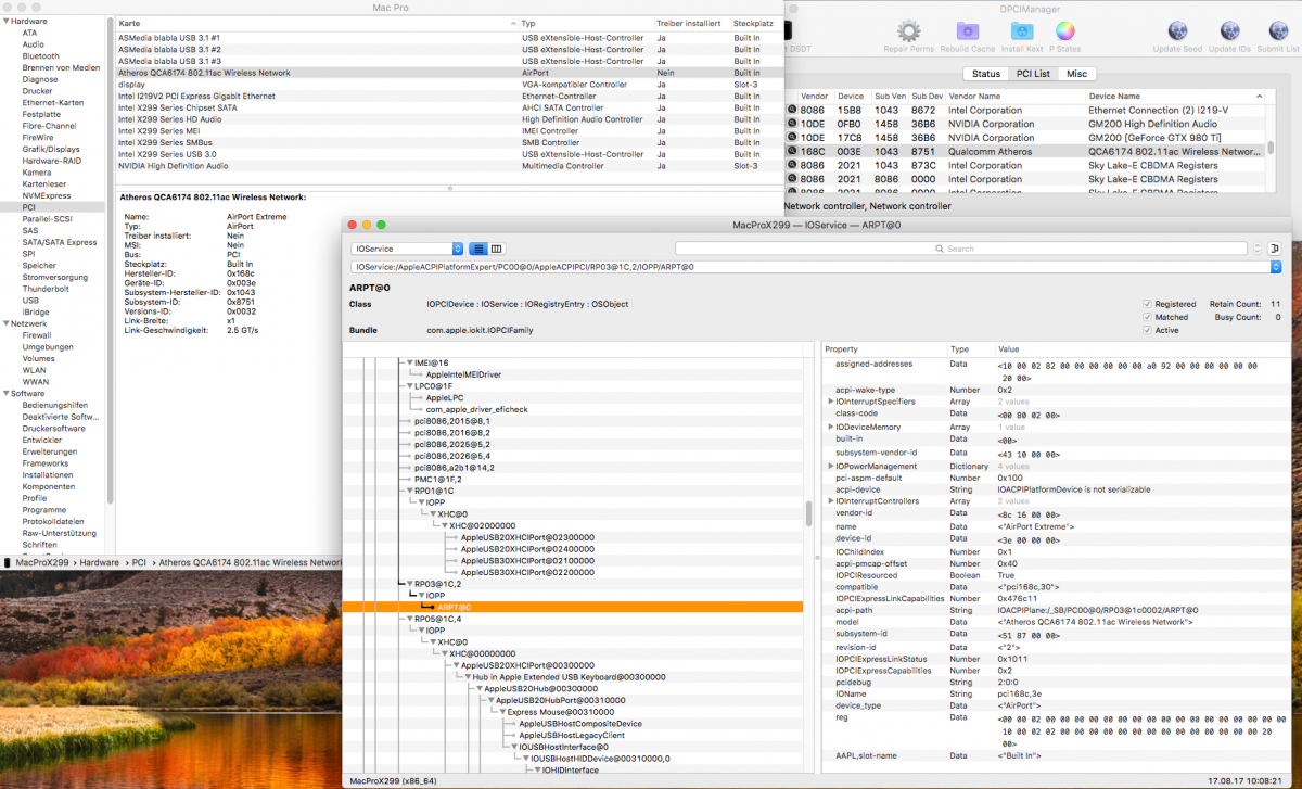

apfelnico Posted August 17, 2017 Share Posted August 17, 2017 @KGP-X99 Clover Configurator, Version 4.48.0 @all Wifi does not work, does anyone have an idea? (X299 ASUS PRIME DELUXE) Link to comment Share on other sites More sharing options...

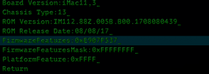

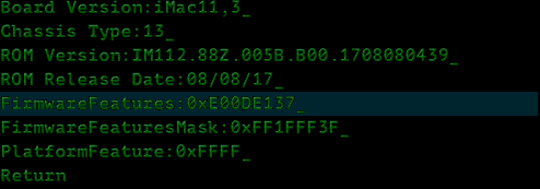

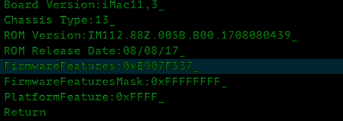

fusion71au Posted August 17, 2017 Share Posted August 17, 2017 its useful information. i will consider more cases compared user's previous FFM FF value. thank you for your time. Hi @Sherlocks, FYI The default FF (0xE907F537) & FFM (0xFFFFFFFF) used by Clover for SMBIOS iMac11,3 no longer work for DB6 ---> error occurred while verifying firmware - see post#2719 System details: GA-P55a-UD3 with legacy BIOS/Intel i5-750/ATI HD5770 Clover legacy r4173, latest DB6 apfs.efi in /EFI/CLOVER/drivers64 SMBIOS iMac11,3, no FF/FFM/PF or Board-ID/BIOS ver/date set in config.plist After adding FF=0xE00DE137 and FFM=0xFF1FFF3F to my config.plist, install proceeded without firmware verification error. Okay great. Where you take ff value? 나의 LG-F800S 의 Tapatalk에서 보냄 I just used the same FF & FFM from iMac13,1 from your post#2600 and it worked . 1 Link to comment Share on other sites More sharing options...
Sherlocks Posted August 17, 2017 Share Posted August 17, 2017 Hi @Sherlocks, FYI The default FF (0xE907F537) & FFM (0xFFFFFFFF) used by Clover for SMBIOS iMac11,3 no longer work for DB6 ---> error occurred while verifying firmware - see post#2719 System details: GA-P55a-UD3 with legacy BIOS/Intel i5-750/ATI HD5770 Clover legacy r4173, latest DB6 apfs.efi in /EFI/CLOVER/drivers64 SMBIOS iMac11,3, no FF/FFM/PF or Board-ID/BIOS ver/date set in config.plist FF 0xE907F537.png After adding FF=0xE00DE137 and FFM=0xFF1FFF3F to my config.plist, install proceeded without firmware verification error. FF 0xE00DE137.png Okay great. Where you take ff value? EDIT1. okay 나의 LG-F800S 의 Tapatalk에서 보냄 Link to comment Share on other sites More sharing options...
