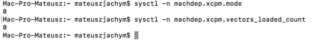

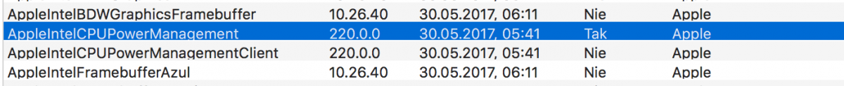

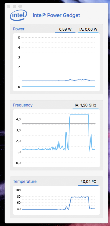

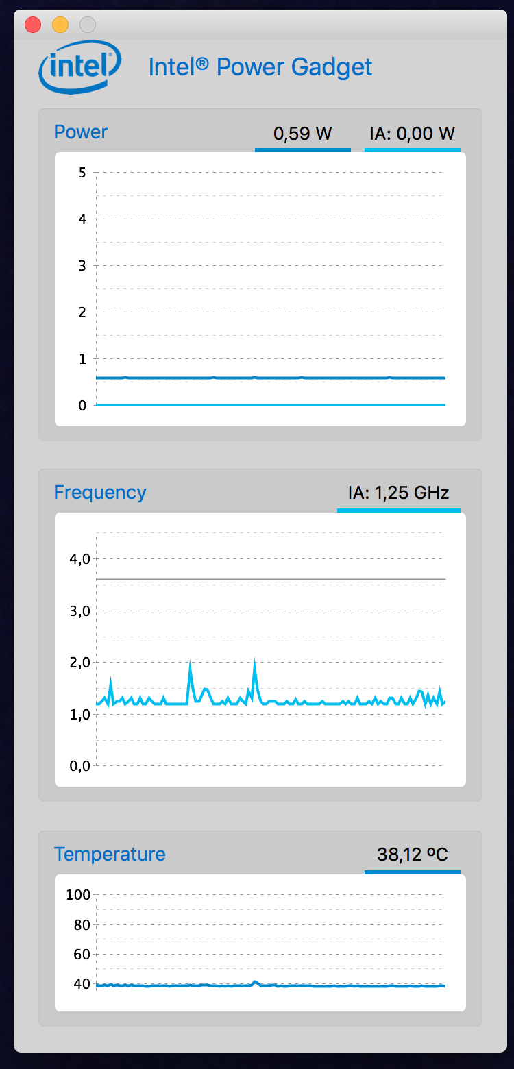

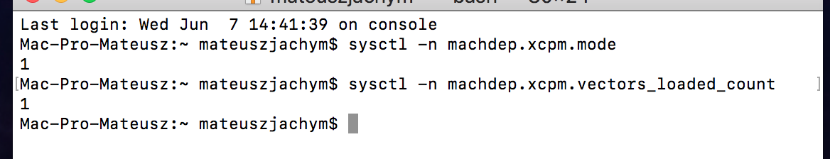

Everything is working very good, stable. Cpu is working very good on idle mode and in benchmark mode post-916820-0-08732800-1496836074_thumb.png post-916820-0-98970100-1496836094_thumb.png
Biut XCMP not working
But X86PlatformPlugin is loading together with AICP post-916820-0-66137500-1496836220_thumb.pngpost-916820-0-57484600-1496836255_thumb.png

ThankYou for your help
edit:
I made change in patch:
89d804c4 3c227722 > 89d804c3 3c227722  (C3) and XCMP working :) post-916820-0-05718400-1496838904_thumb.png

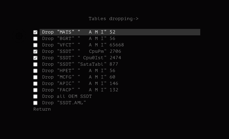

Did someone managed to solve AppleACPI error on Haswell with Z87? Still not able to boot. :(
You can try to drop MATS, that solves the panic for me.
For those who can't bypass the Firmware check, open the InstallESD.dmg @Sierra and install the Core.pkg from the Packages folder to your desired drive on a free partition, after it is done copy the boot.efi from BaseSystem.dmg /System/Library/CoreServices to the drive you've installed HighSierra to /System/Library/CoreServices and reboot. After successful start you can install your preferred language.
  • Like 4
Wow, thanks a lot!
It's working for me on my i7-4790 and I'm currently installing it on a AFPS drive. Will update when it was successful  :)
EDIT: Installation successful, boot from AFPS successful, no ACPI panic.

PMheart Can you convert this patch for 6850k for New Sierra?
10.12 Broadwell-E CPUID Patch
83C0E9 > 83C0E1
10.12 xcpm_bootstrap
83C3C483 FB22 > 83C3BC83 FB22
(wrsmr fix to get CPU max) © okrasit
89D8C1E0 08B99901 > B8003000 00B99901
And for NVM disk external icon fix
external for 12.3
4885C074 07808B08 01000010 > 90909090 90808B08 01000010
Everything is working very good, stable. Cpu is working very good on idle mode and in benchmark mode attachicon.gifZrzut ekranu 2017-06-07 o 13.57.37.png attachicon.gifZrzut ekranu 2017-06-07 o 13.58.45.png
But X86PlatformPlugin is loading together with AICP attachicon.gifZrzut ekranu 2017-06-07 o 13.55.22.pngattachicon.gifZrzut ekranu 2017-06-07 o 13.55.11.png
edit:
89d804c4 3c227722 > 89d804c3 3c227722  (C3) and XCMP working :) attachicon.gifZrzut ekranu 2017-06-07 o 14.46.28.png
Hi, according to your edit, your XCPM should be fine now, and I won't help this. :)
