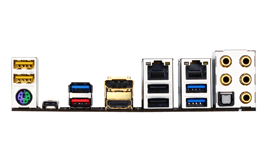

Looking at the MB manual - it appears I originally had the cable in a 2.0/3.0 jack - which is the 2nd USB port below the ethernet jack.
It's a bit confusing - since the manual shows there is a LAN1 and a LAN2 port, yet my MB only has a single Gig ethernet port.

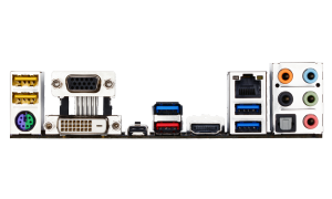

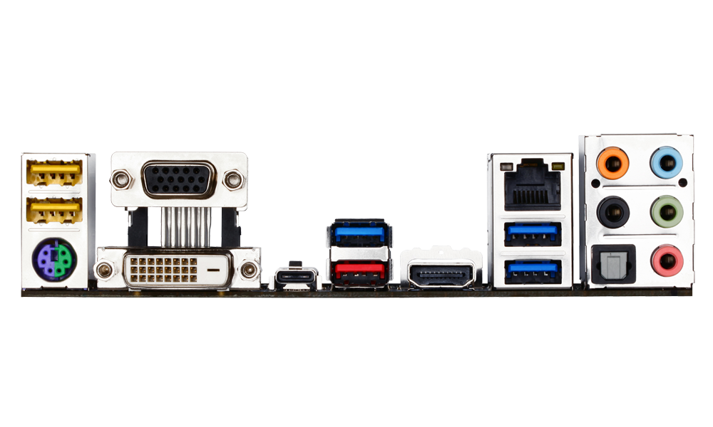

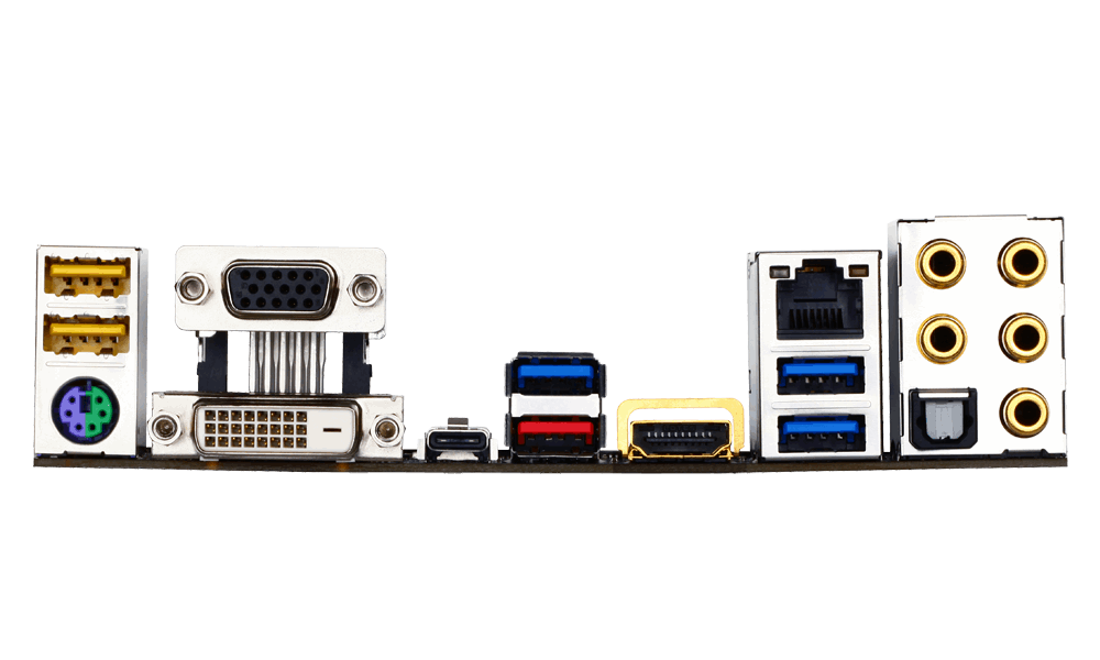

If you have only on LAN port then your mainboard is not GA-Z170X-Gaming 5, It might be Gaming 3, Z170MX-Gaming 5 or Z170N-Gaming 5. Check the layout of the ports on the back panel and see which one matches your mainboard or just open the case and see the model that is printed on the mainboard. AFAIK all reversions of the Z170X-Gaming 5 mainboards have two LAN ports.
