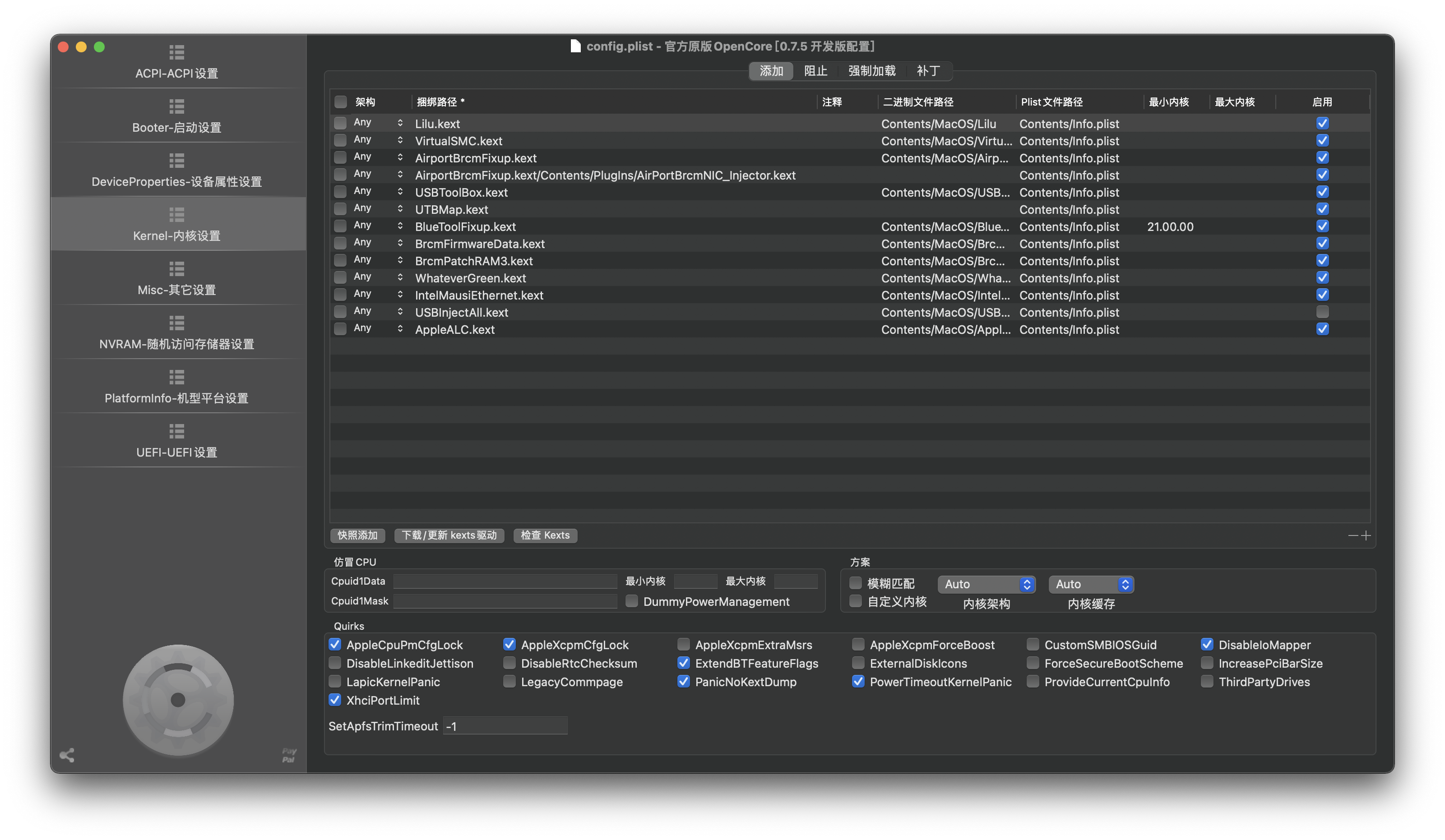

Thanks, @Donw35 and all others for the information in this thread!
With your config I got the long waiting upgrade from Majove to Monterey on my EliteDesk 800 G1 to work.
Compared to the config from 11/20/2021 I had to make some modifications for a nearly perfectly running system:
  •  Resoultion 2560x1440 needed some fixes for framebuffer values. The configuration from 11/20/2021 gave me a resolution 1920x1080, but not more. I played around with framebuffer values described in https://dortania.github.io/OpenCore-Post-Install/gpu-patching/intel-patching/vram.html - with success. After a hint from @Hervé I reduced the Intel HD configuration to just two entries, no entries for framebuffer sizes, which also gave me the wanted higher resolution.
  • Added BlueToolFixup.kext to make the USB Bluetooth dongle work
  • Upgraded kexts: IntelMausiEthernet.kext is now IntelMausi.kext, newest USBInjectAll.kext doesn't work, so I took yours
  • Upgraded to OpenCore v0.7.6 --> some fixes in config.plist
  • Set XhciPortLimit to false to make my external USB hub work
  • Activated OpenCore GUI (aka Opencanopy) and boot chime (see https://dortania.github.io/OpenCore-Post-Install/cosmetic/gui.html#setting-up-opencore-s-gui)
  • Set DisableLinkeditJettison to true, otherwise ocivalidate shows an error
config.plist

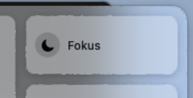

There remains one glitchy video effect I noticed and that I describe in another thread (cause this one was closed caused to my noob status).
It can be seen on the 3D borders of control center, dock, widgets, especially when hovering over the elements with the mouse. Looks like some kind of dithering from good-old-256-colors era.
Can soneone reproduce this effect on his/her HP Elitedesk with internal Intel HD graphics?

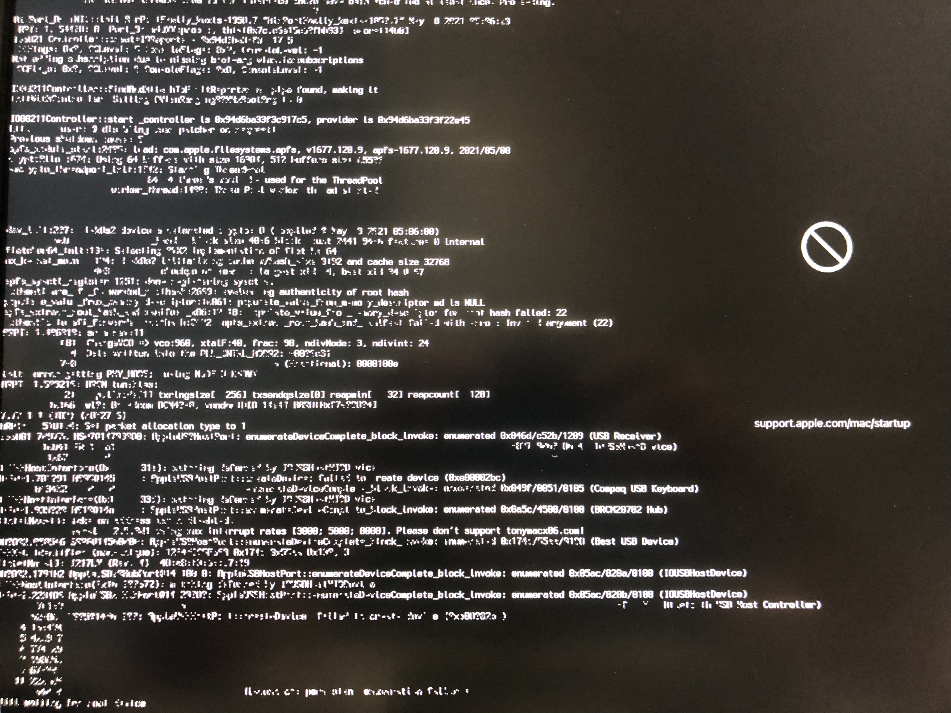

Hi. I tried this config with OpenCore 0.7.6 (as you mentioned). My screen stays black and I cannot boot.
The 0.7.5 from the original post works but sometimes I have complete freezes. I don't know what this is.
Activate verbose boot with "-v" in boot-args.
And: Use your own values in PlatformInfo->Gerneric. My values are of course removed.
As I mentioned: I had problems with the newest IntelMausiEthernet.kext.
