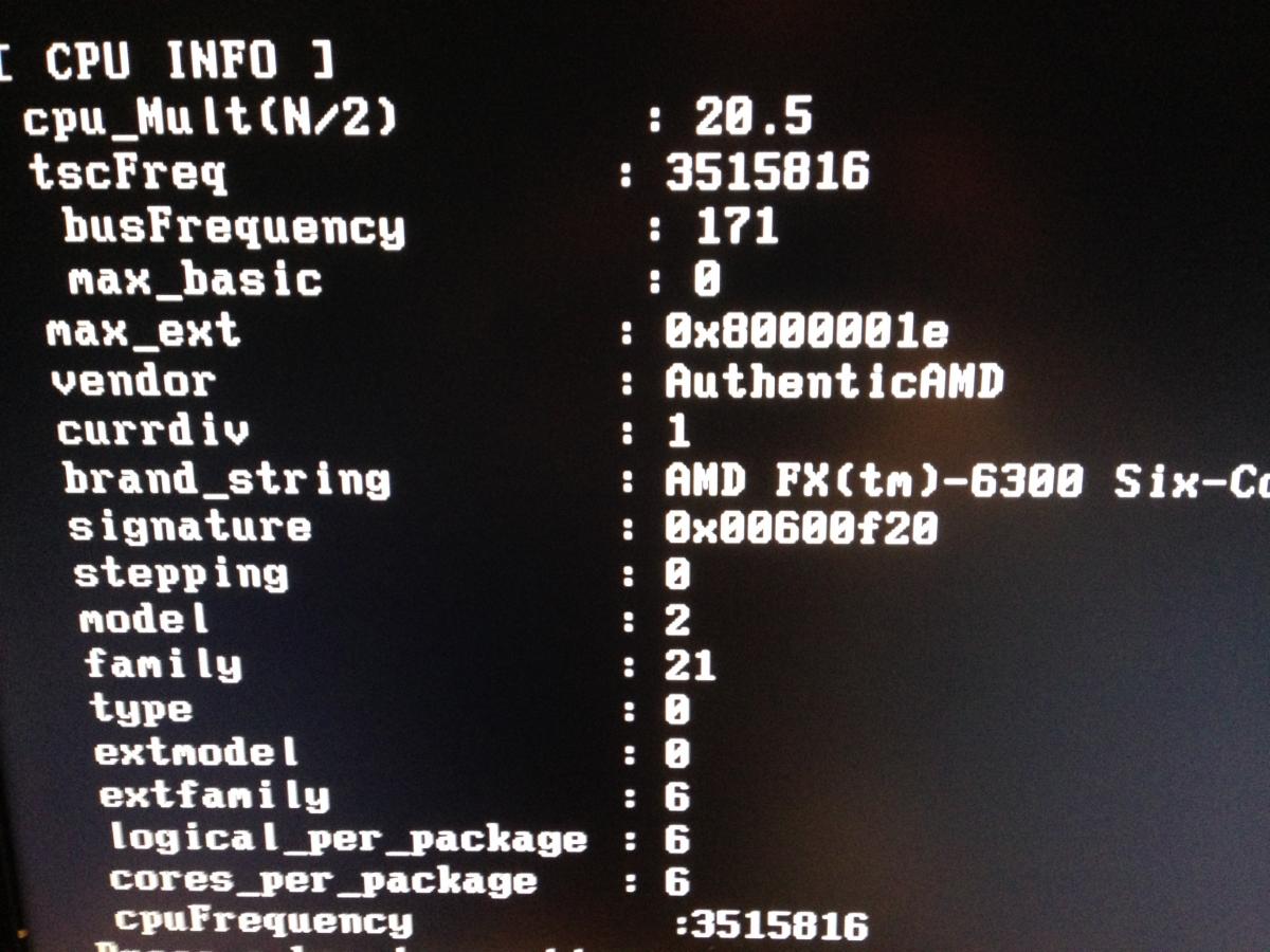

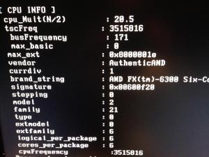

It detected incorrect CPU busratio=20.5 instead of correct value=20 in FX-6300 hackintosh, maybe that's the reason it freezed and can not boot to desktop.
But it can boot to desktop at 10.10.5 even with the same error.
At 10.9.5 it can boot to desktop, but too slow timer and very poor performance occurred again.

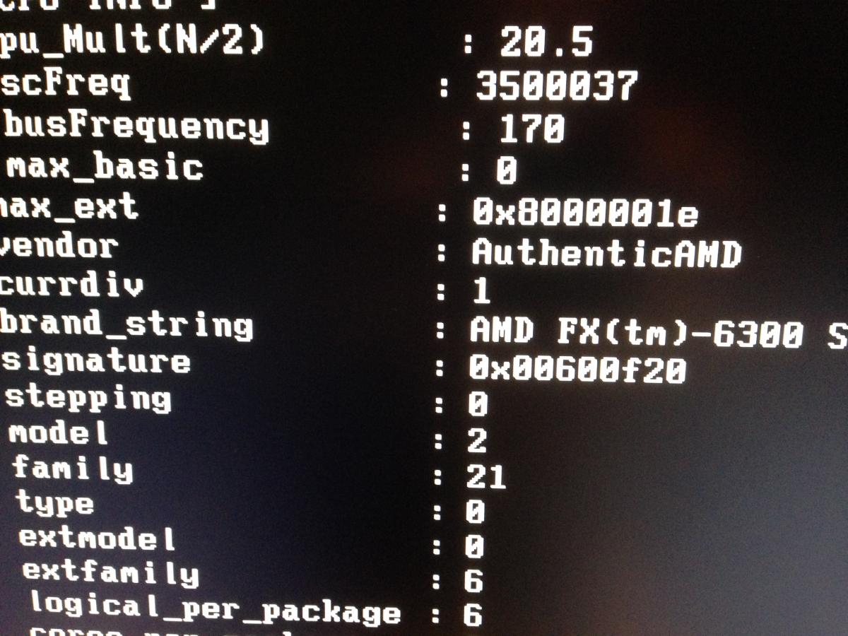

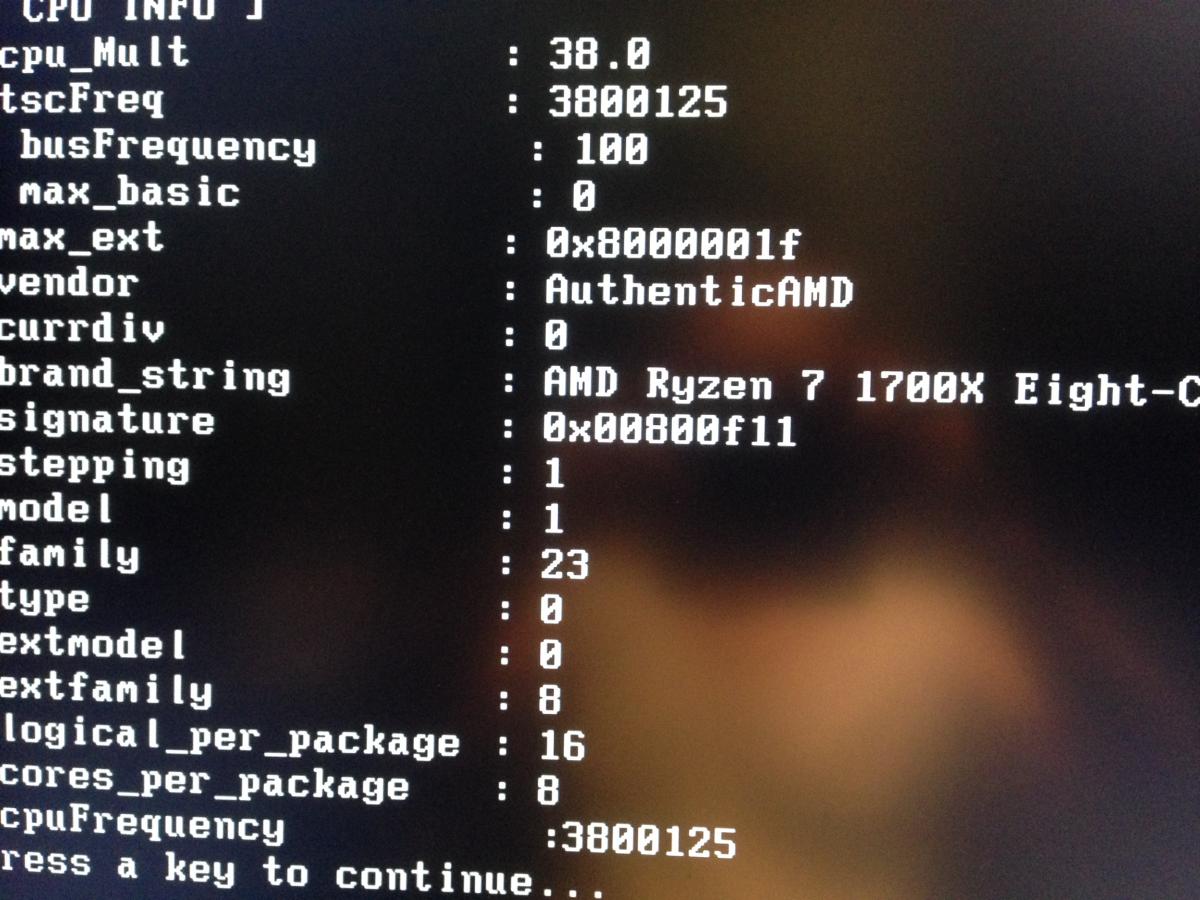

This rc2 boot worked for Ryzen 1700X hackintosh which can detect correct CPU parameters (1st photo),
but it always got wrong CPU parameters in FX-6300 hackintosh (2nd photo).
Can you fix it ?
Or it can be applied to Ryzen & A10 CPUs only ?

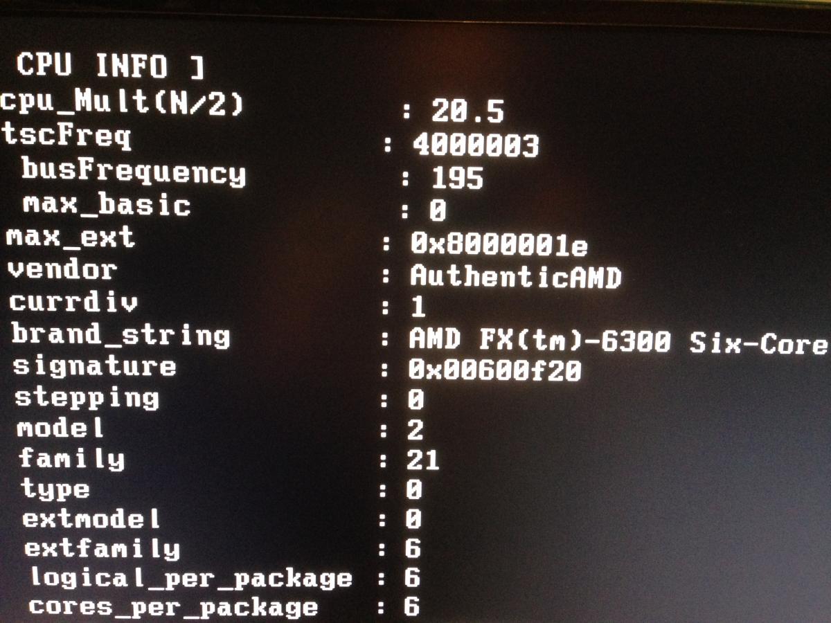

Please check bios !
For FX-6300 Six - really current 3500 mhz ! But why 4000 Mhz ?? And Why 195Mhz ??
And check Multiplier in bios !
Thank !

BIOS setting:
Overclock (200 x 20): 4.0GHz
Without OC it's 3500 Mhz (200 x17.5) this rc2 boot still got the same cpu_Mult(N/2) : 20.5 in the first line before booting in FX-6300 hackintosh.
BIOS setting:
Without OC it's 3500 Mhz (200 x17.5) this rc2 boot still got the same cpu_Mult(N/2) : 20.5 in the first line before booting.

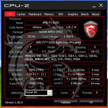

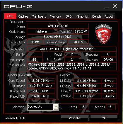

This in bios multiplier is auto ?
Hi !
I tried in bios : I use cpu-z_msi
1) if auto multiplier : SEE :
2) if install manual multiplier of 20 :
This FX is auto use multiplier .. )))
But i fixed boot chameleon ! Wait for boot chameleon and Clover !!!
Try boot (chameleon) and kernels Mav and Yos. .
attachicon.gifboot_kernel_ryzen_rc3.zip

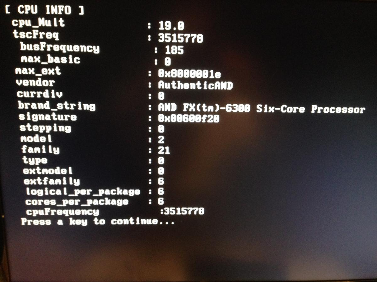

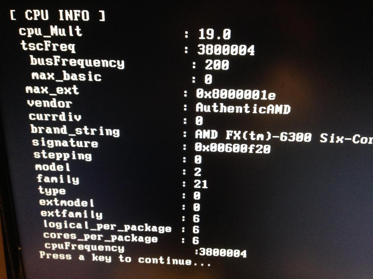

Thanks for this rc3 boot file which still got wrong parameter if BIOS is AUTO (1st photo).
It can detect correct CPU parameters if BIOS is MANUAL (2nd photo) and need flag "-f" to boot in FX-6300 hackintosh.
Both new kernels for 10.9.5 and 10.10.5 also worked in FX-6300 hackintosh.
