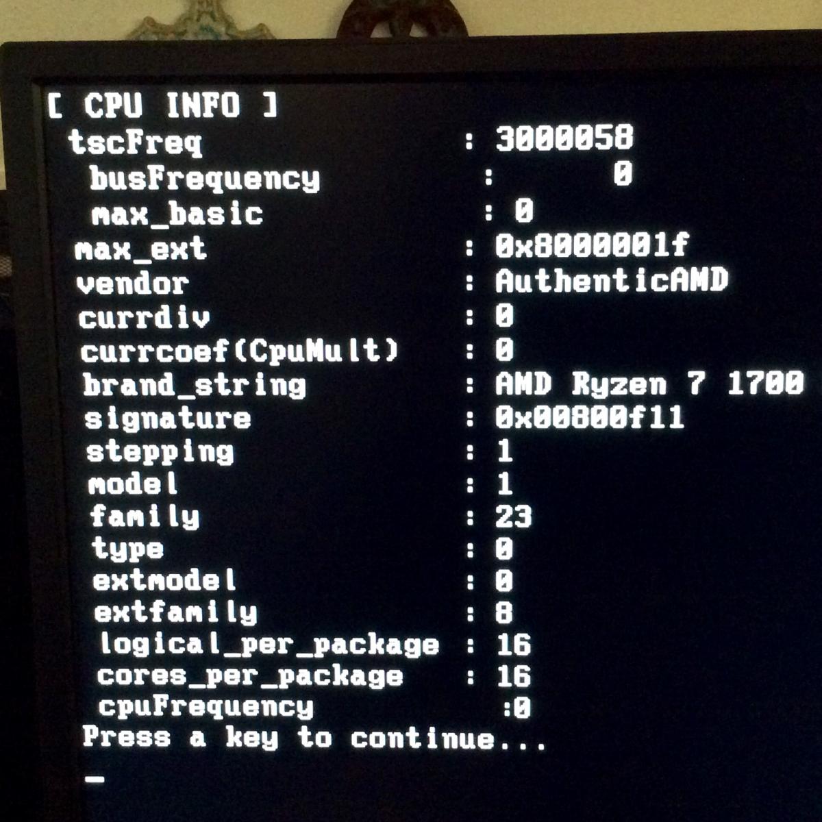

jsl Posted May 13, 2017 Share Posted May 13, 2017 (edited) My Ryzen is running very smoothly from 3.0 to 3.8 GHz. I was wondering if something in the kernels or boot was not accounting for the difference between the R7 1700 (65 watt) and R7 1700X (95 watt) configurations. I would think the 1700X would stomp me in benchmarks but it doesn't and the 1800X isn't too far ahead. Did you remove any of the power management kexts? The PMTelemetrykext? If so that may cause problems. My kernel.plist had kernelPM=yes, but I just disabled it and its working fine.. Have you tried kernelPM=yes? Here's my latest config. for Sierra 12.4. Serial number DXDXDXDXDX. Add a new one if you use the Symbio.plist. I manually add busratio=xx at boot depending on bios frequency setting 3.0-3.8Ghz. Thanks for your kind and prompt response and help. There was no PmTelemetry.kext in my /S/L/E since the beginning. I'll try KernelPM=Y &/or change SMBIOS from iMac14,2 to yours (MP6,1). [Edit] KernelPM=Y or change SMBIOS from iMac14,2 to MP6,1 did not work. Booting Log shown as below: [ KERNEL PATCHER START ] Will patch for 16.5.0 kernel version compatible. KernelBooter_kexts state: enabled! KernelPm state: enabled! KernelLapicError state: disabled! KernelLapicVersion state: disabled! KernelHaswell state: disabled! KernelcpuFamily state: disabled! KernelSSE3 state: disabled! - Searching for booter extensions pattern: Found Sierra (> = 10.12.4) EXT pattern: patched! 1 substitution(s) made. - Patching kernel power management... Kernel power management patch region not found! Kernel patcher: end! Applied your modules in /Extra & all kexts in /S/L/E always got automatic reboot. I think some of SATA/IDE kexts conflicted with my hardware in hackintosh. Last question: Is there any DSDT.aml or SSDT.aml in your hackintosh ? Can you confirm whether Kernel_Pm was enabled and patched something for your kernel ? Edited May 13, 2017 by jsl 1 Link to comment Share on other sites More sharing options...
Gigamaxx Posted May 13, 2017 Share Posted May 13, 2017 Thanks for your kind and prompt response and help. There was no PmTelemetry.kext in my /S/L/E since the beginning. I'll try KernelPM=Y &/or change SMBIOS from iMac14,2 to yours (MP6,1). [Edit] KernelPM=Y or change SMBIOS from iMac14,2 to MP6,1 did not work. Booting Log shown as below: [ KERNEL PATCHER START ] Will patch for 16.5.0 kernel version compatible. KernelBooter_kexts state: enabled! KernelPm state: enabled! KernelLapicError state: disabled! KernelLapicVersion state: disabled! KernelHaswell state: disabled! KernelcpuFamily state: disabled! KernelSSE3 state: disabled! - Searching for booter extensions pattern: Found Sierra (> = 10.12.4) EXT pattern: patched! 1 substitution(s) made. - Patching kernel power management... Kernel power management patch region not found! Kernel patcher: end! Applied your modules in /Extra & all kexts in /S/L/E always got automatic reboot. I think some of SATA/IDE kexts conflicted with my hardware in hackintosh. Last question: Is there any DSDT.aml or SSDT.aml in your hackintosh ? I have generated a couple of them but not added to Extras folder yet. The reboot may be the boot file, are you using the original boot file, that is what I've been using. I posted it a day or so ago. Download IOResgistry Explorer, and DCPIManager.google them they're free and post an IOReg. of your setup. DCPIManager can be useful to explore your hardware support and generate DSDTs. 1 Link to comment Share on other sites More sharing options...

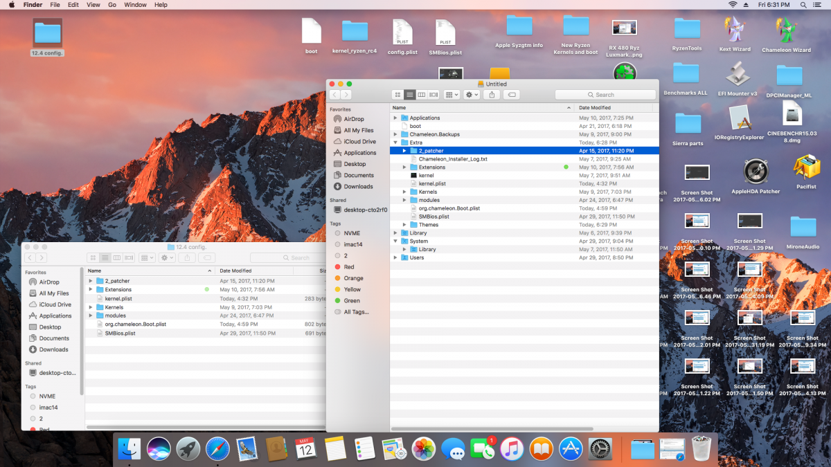

jsl Posted May 13, 2017 Share Posted May 13, 2017 (edited) I have generated a couple of them but not added to Extras folder yet. The reboot may be the boot file, are you using the original boot file, that is what I've been using. I posted it a day or so ago. Download IOResgistry Explorer, and DCPIManager.google them they're free and post an IOReg. of your setup. DCPIManager can be useful to explore your hardware support and generate DSDTs. I have tested by 3 different Boot files including the original one dated on 2017-04-12, 2017-04-27, and 2017-05-07. All got the same issues of power management. So your hardware is lucky and full compatible with Mac OS X without any patch of DSDT/SSDT.aml. I have tried to edit my DSDT & SSDTs in vain. I found there was one bug for Boot file dated on 2017-04-12 which can not patch kernel correctly even my kernel.plist set both KernelBooter_kexts and KernelPm are Yes: [ KERNEL PATCHER START ] - Loading : KernelBooter_kexts enabled! KernelPm disabled! KernelLapicError disabled! KernelLapicVersion disabled! KernelHasswell disabled! KernelcpuFamily disabled! KernelSSE3 disabled! [ 64-bit ] - Searching for booter extensions pattern Can't find Booter Extensions patch location. [ KERNEL PATCHER END ] Edited May 13, 2017 by jsl 1 Link to comment Share on other sites More sharing options...

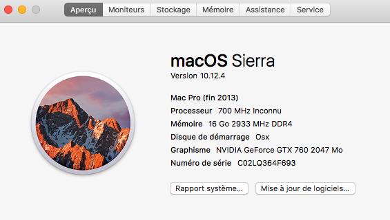

membrax Posted May 13, 2017 Share Posted May 13, 2017 Strange thing : my 1700 O/Cd @3.7 Ghz shows 700 Mhz in "about this mac", and performances are low (like 700 cb) i'm using latest kernel_auto + boot_beta, and boot args : "-v -f npci=0x3000 fsbratio=37" Link to comment Share on other sites More sharing options...
jsl Posted May 13, 2017 Share Posted May 13, 2017 Strange thing : my 1700 O/Cd @3.7 Ghz shows 700 Mhz in "about this mac", and performances are low (like 700 cb) i'm using latest kernel_auto + boot_beta, and boot args : "-v -f npci=0x3000 fsbratio=37" Correct boot argument should be "busratio=37" instead of "fsbratio=37" At correct boot menu of Bronya 2667 it should show 3700xxxxxx for your reference to keyin busratio=37 Also in BIOS setting : 100.000000 Mhz x 37 Do you have the same issues of power management as mine ? Please check Post#161 above Link to comment Share on other sites More sharing options...
membrax Posted May 13, 2017 Share Posted May 13, 2017 Normally thé kernel detects fsb & ratio, worked once. I'll try with correct bootarg thanks. Restart and shutdown works for me but hangs when waking from sleep. My alc1220 doesn't work. Maybe i should try Clover instead if Enoch. Link to comment Share on other sites More sharing options...
jsl Posted May 13, 2017 Share Posted May 13, 2017 Normally thé kernel detects fsb & ratio, worked once. I'll try with correct bootarg thanks. Restart and shutdown works for me but hangs when waking from sleep. My alc1220 doesn't work. Maybe i should try Clover instead if Enoch. Do you apply any DSDT &/or SSDT.aml in your /Extra ? Any specific kexts related to power management in /System/Library/Extensions like FakeSMC, NullCPUPowerManagement, or EvOreboot.kext ? Any special setting in BIOS ? because we both use ASUS X370 chipset MB. Link to comment Share on other sites More sharing options...
membrax Posted May 13, 2017 Share Posted May 13, 2017 Tryed with and w/o dsdt.aml. Using standard kext included in jay.'s script (not at home for now) I'll share my bios settings this evening Link to comment Share on other sites More sharing options...
Martimar Posted May 13, 2017 Share Posted May 13, 2017 Strange thing : my 1700 O/Cd @3.7 Ghz shows 700 Mhz in "about this mac", and performances are low (like 700 cb) i'm using latest kernel_auto + boot_beta, and boot args : "-v -f npci=0x3000 fsbratio=37" Try removing the busratio. The latest kernel doesnt need it. I dont use it and my 1800x runs great at 3.94GHz 1 Link to comment Share on other sites More sharing options...

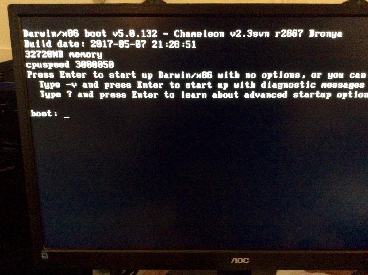

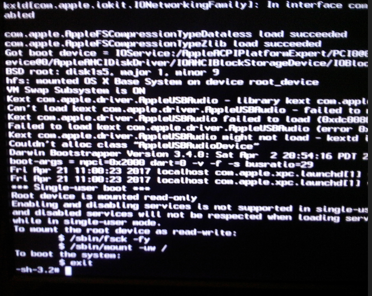

RusticPotato Posted May 16, 2017 Share Posted May 16, 2017 Been having some major issues with the graphics driver - lots of screen tearing & flickering, and the voodooHDA driver - Error no VoodooHDA Devices detected (usb audio works but is terrible). I have the Nvidia video web driver installed (version 378.5.05f02), chameleon boot args: nv_disable=1 GraphicsEnabler=Yes. If anyone could provide any solutions or guidance that would be awesome. Link to comment Share on other sites More sharing options...
gills83 Posted May 16, 2017 Share Posted May 16, 2017 Been having some major issues with the graphics driver - lots of screen tearing & flickering, and the voodooHDA driver - Error no VoodooHDA Devices detected (usb audio works but is terrible). I have the Nvidia video web driver installed (version 378.5.05f02), chameleon boot args: nv_disable=1 GraphicsEnabler=Yes. If anyone could provide any solutions or guidance that would be awesome. no use GraphicsEnabler=Yes use kernel_auto Darwin 16.5 Bronya's and flag nv_disable=1 PCIRootUID=1 -v -f -s and flag in bash 3.2: fsck -fy finish/ exit Link to comment Share on other sites More sharing options...
RusticPotato Posted May 16, 2017 Share Posted May 16, 2017 no use GraphicsEnabler=Yes use kernel_auto Darwin 16.5 Bronya's and flag nv_disable=1 PCIRootUID=1 -v -f -s and flag in bash 3.2: fsck -fy finish/ exit Wait so, 1. Update my kernel to 16.5 2. Remove GraphicsEnabler=Yes 3. set/add the flags: nv_disable=1 PCIRootUID=1 -v -f -s (fsck -fy ) finish/ exit Link to comment Share on other sites More sharing options...
gills83 Posted May 16, 2017 Share Posted May 16, 2017 Wait so, 1. Update my kernel to 16.5 2. Remove GraphicsEnabler=Yes 3. set/add the flags: nv_disable=1 PCIRootUID=1 -v -f -s (fsck -fy ) finish/ exit euh? flag: nv_disable=1 PCIRootUID=1 -v -f -s npci=0x2000 dart=0 (option msibase=0x90) and screen http://www.insanelymac.com/forum/topic/321626-ryzen-macos-1012x-sierra-kernel-researchdevelopment-thread/page-21?do=findComment&comment=2424882 1 Link to comment Share on other sites More sharing options...
RusticPotato Posted May 16, 2017 Share Posted May 16, 2017 Ohhhhhhhh, -f -s leads you to a prompt to put in fsck -fy. Ha! It's running the checks on the volume now. I've been using npci=0x3000 and it's been working, what's the difference going to npci=0x2000? Where is the kernel_auto flag set? Can you give an example? Link to comment Share on other sites More sharing options...

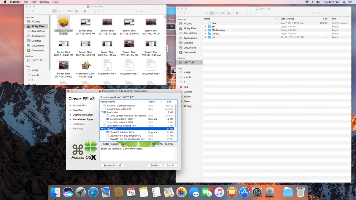

cyrhex Posted May 17, 2017 Share Posted May 17, 2017 i got working sleep/wake using kernel rc2 kernel by bronya using clover 4061 and using enoch 2878,,but using kernel rc4 with fakemsr it wont wake from sleeep,,, 1 Link to comment Share on other sites More sharing options...
