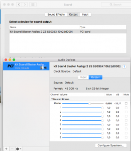

After trying with my gigabyte g1 sniper and creative onboard chip, which gives me two chanel output with a blistering bit rate of 32 normally I only get 24 bit not sure  how this came about but using chris voodoo had 889 which installs to the clover efi partition gave good two chanel results.
I also own an Asus 97A 892 sound, and wish to ask you about the kx audio driver
installed is the soundblaster live pci card using this card with the kx drivers (not your own version) I am only able to get 48 hz but no mention of the bit rate also that the black speaker out doesn't produce sound, I get front right front left, center and base. The card is 5.1 and I downloaded a five point one test video.
something I would like to ask and try to understand, the kx audio driver can the 48 hz be increased to say 96 or even 192?
how are the sound channels mapped out? and what of the bit rate ? I appreciate that macs natively put out 48 hz and that it is tied to the quicktime player?
would love to learn more about mapping the sound outputs and also why it is that we know that hackintosh can put out higher bit rates 16,24,32 so not sure why the limit on the kx audio drivers, interested to learn about it though
regards
osxone
Asus z97 A usb 3.1
gigabyte g1 sniper
creative soundblaster 5.1 pci card
the sound channels are mapped, you have to use the midi configuration app that you find built in mac os to set the speakers in 5.1 mode, for the frequency the code in the driver is designed to handle only 48 khz sample rates (the cards itself can go up in sample rate, for exapmle the live cards can go up to 96 khz, the audigy up to 192 khz), for the bitrate the sound blaster live cards are limited to 16 bits, to get the 32 bits you have to use an audigy card, you can also try my driver, it has some fixes for the audio quality, and also proper support for the newer mac os versions and a new naming system for the sound cards

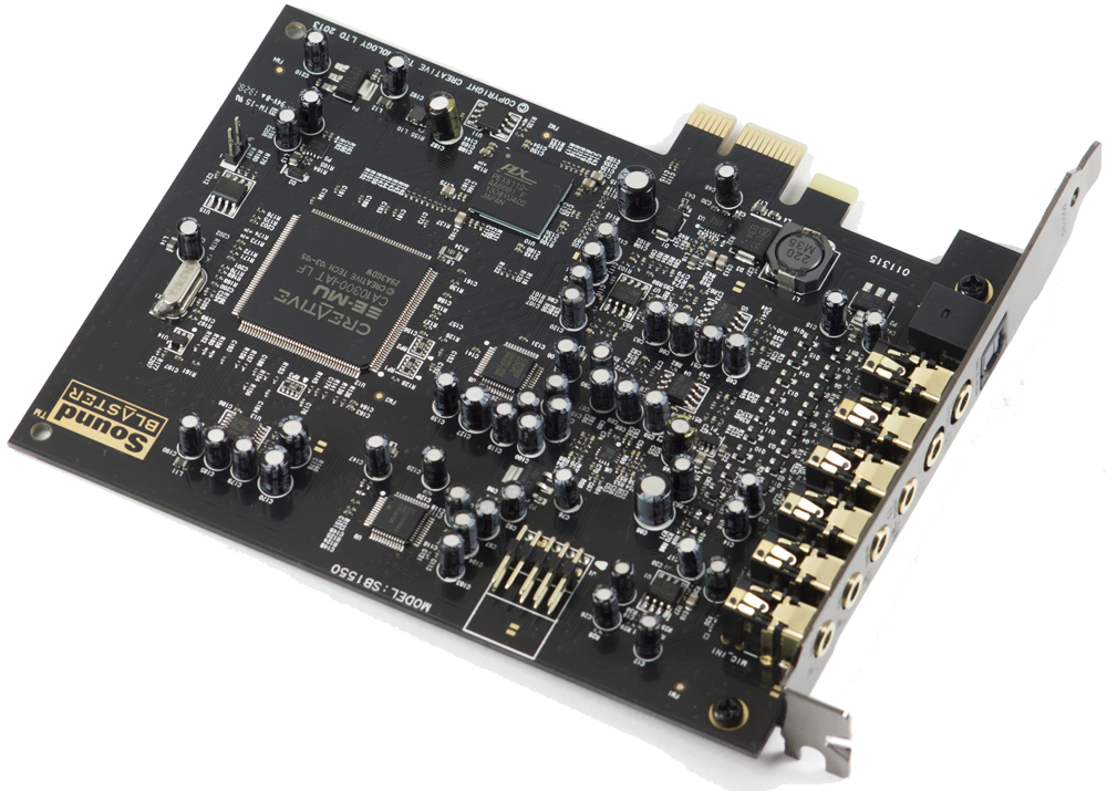

Are all audigy rx are sb1550? Is there anything I need to make sure before getting one?
the audigy rx is only sb1550, so you should get the card with this model number
and this is what the card can looks like:
