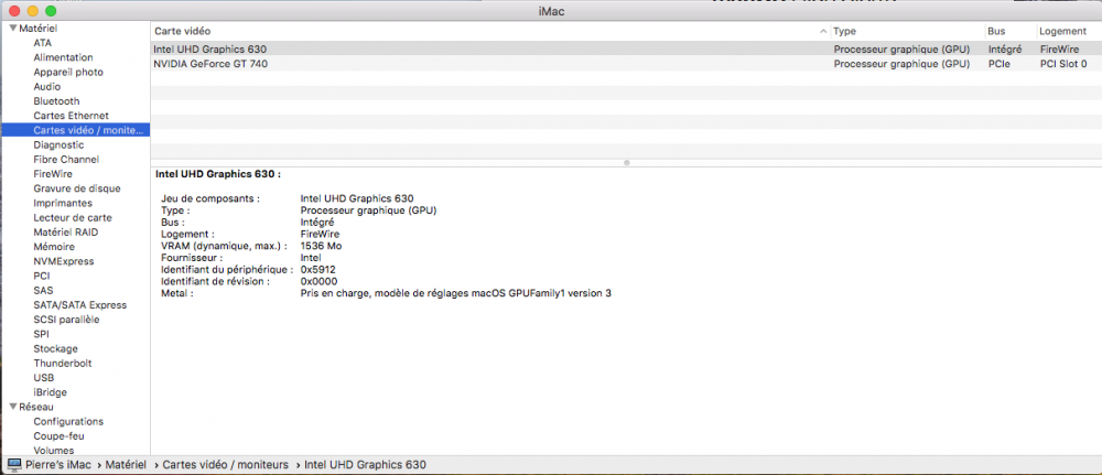

BackwardMac Posted June 12, 2018 Share Posted June 12, 2018 41 minutes ago, MaLd0n said: send me new SEND_ME after reboot with new folder CLOVER.zip Clover put all hardware to work, the problems is a fine tune, all hacks need many many patches, u can inject via ssdt, clover or edit dsdt Here it is Mald0n Thanks to working on it Send me Pierres-iMac.zip Link to comment Share on other sites More sharing options...

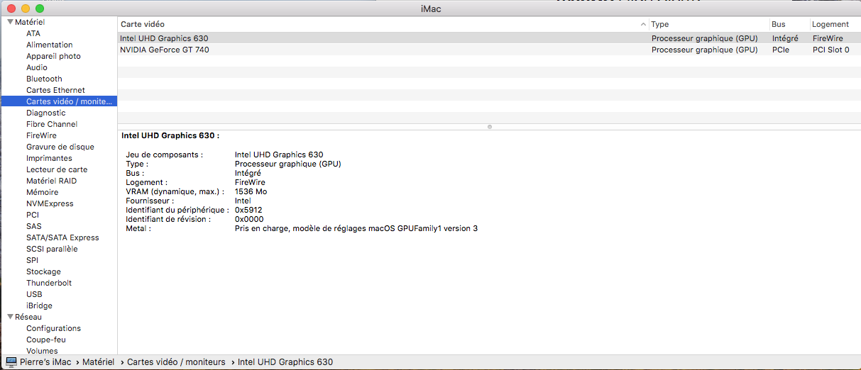

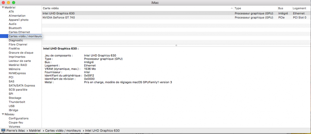

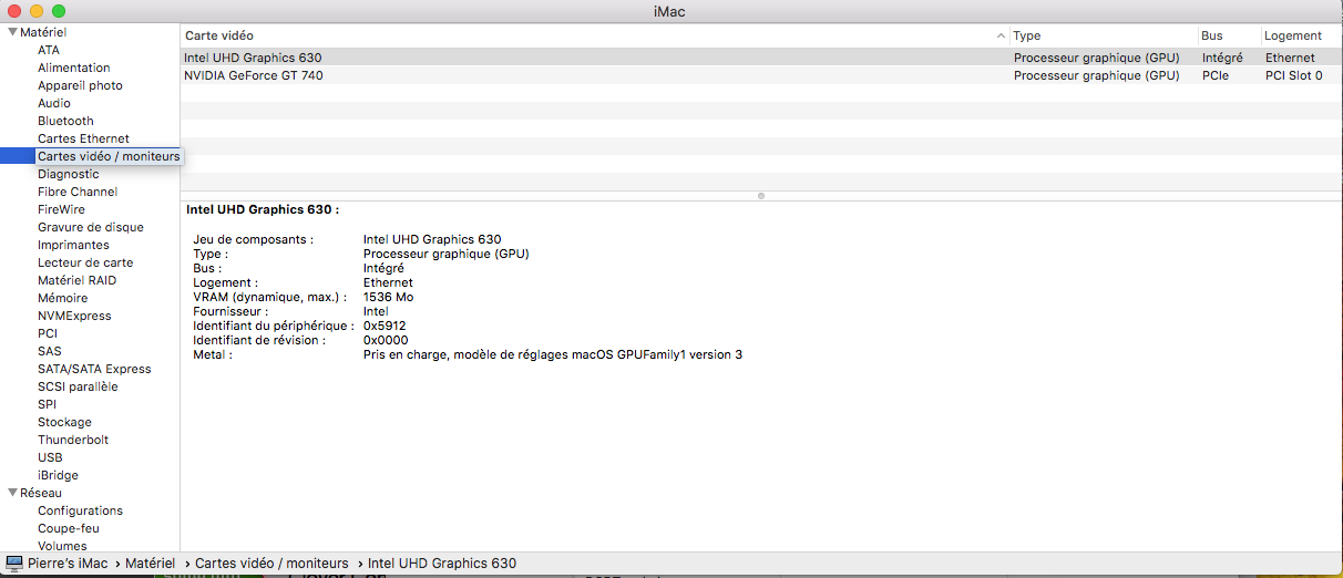

BackwardMac Posted June 13, 2018 Share Posted June 13, 2018 26 minutes ago, MaLd0n said: u dont need ssdt usb, just use flag, uia_exclude=HS01; etc test DSDT.aml.zip new SEND_ME after reboot After test with the new aml (I delete the SSDT USB I add before) Sleep/wake works as before, like a charme. Shutdown always restart, even if I sleep/wake the computer before, so it is worst. Graphics : This time the UHD 630 appear on ethernet slot in system profiler. Note : I can see during the verbose of the boot that there is less acpi error, no more PXSX for exemple. Note 2 : there is the same error during collect data in PCI system profiler. I wil give an other donation because you work really hard for me Send me Pierres-iMac.zip 2 Link to comment Share on other sites More sharing options...
MaLd0n Posted June 13, 2018 Author Share Posted June 13, 2018 1 hour ago, BackwardMac said: After test with the new aml (I delete the SSDT USB I add before) Sleep/wake works as before, like a charme. Shutdown always restart, even if I sleep/wake the computer before, so it is worst. Graphics : This time the UHD 630 appear on ethernet slot in system profiler. Note : I can see during the verbose of the boot that there is less acpi error, no more PXSX for exemple. Note 2 : there is the same error during collect data in PCI system profiler. I wil give an other donation because you work really hard for me Send me Pierres-iMac.zip FOR SHUTDOWN/RESTART PROBLEM, ENABLE erp OPTION IN BIOS check if work now, pout both files in clover/acpi/patched Arquivo Comprimido.zip new dump after reboot 1 Link to comment Share on other sites More sharing options...

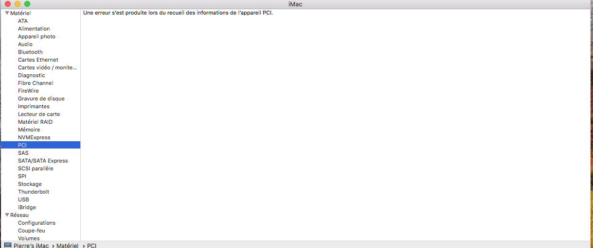

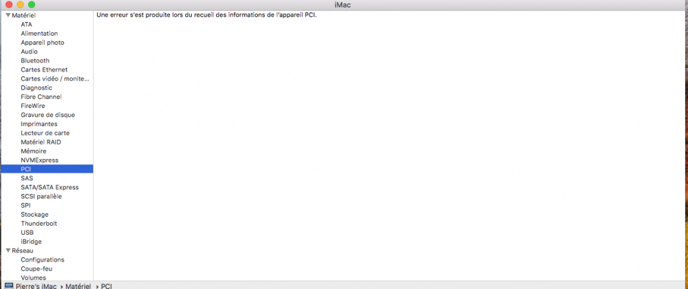

BackwardMac Posted June 13, 2018 Share Posted June 13, 2018 45 minutes ago, MaLd0n said: FOR SHUTDOWN/RESTART PROBLEM, ENABLE erp OPTION IN BIOS check if work now, pout both files in clover/acpi/patched Arquivo Comprimido.zip new dump after reboot OK so better and better.. Sleep/wake still working really well Shutdown now work well to (Can't believe I miss the ERP option in bios) Graphics UHD 630 appear as built which is nice But in PCI in system profiler there is still the same issue, unable to collect data... Do you thing you can help me to make the dual display possible (one screen on GT 740 and the other on the UHD 630) I would like to use the display port of the UHD 630 Whatever a BIG THANK YOU for your work your are brilliant!!! Send me Pierres-iMac.zip Link to comment Share on other sites More sharing options...

MaLd0n Posted June 13, 2018 Author Share Posted June 13, 2018 2 hours ago, BackwardMac said: OK so better and better.. Sleep/wake still working really well Shutdown now work well to (Can't believe I miss the ERP option in bios) Graphics UHD 630 appear as built which is nice But in PCI in system profiler there is still the same issue, unable to collect data... Do you thing you can help me to make the dual display possible (one screen on GT 740 and the other on the UHD 630) I would like to use the display port of the UHD 630 Whatever a BIG THANK YOU for your work your are brilliant!!! Send me Pierres-iMac.zip loos very good, next week i'll try solve pci devices bug in new mobo serie 300 Enjoy 1 1 Link to comment Share on other sites More sharing options...
BackwardMac Posted June 13, 2018 Share Posted June 13, 2018 3 minutes ago, MaLd0n said: loos very good, next week i'll try solve pci devices bug in new mobo serie 300 Enjoy You deserve some rest ;-) So I will keep an eye on it and on your work. Thanks again. Link to comment Share on other sites More sharing options...
