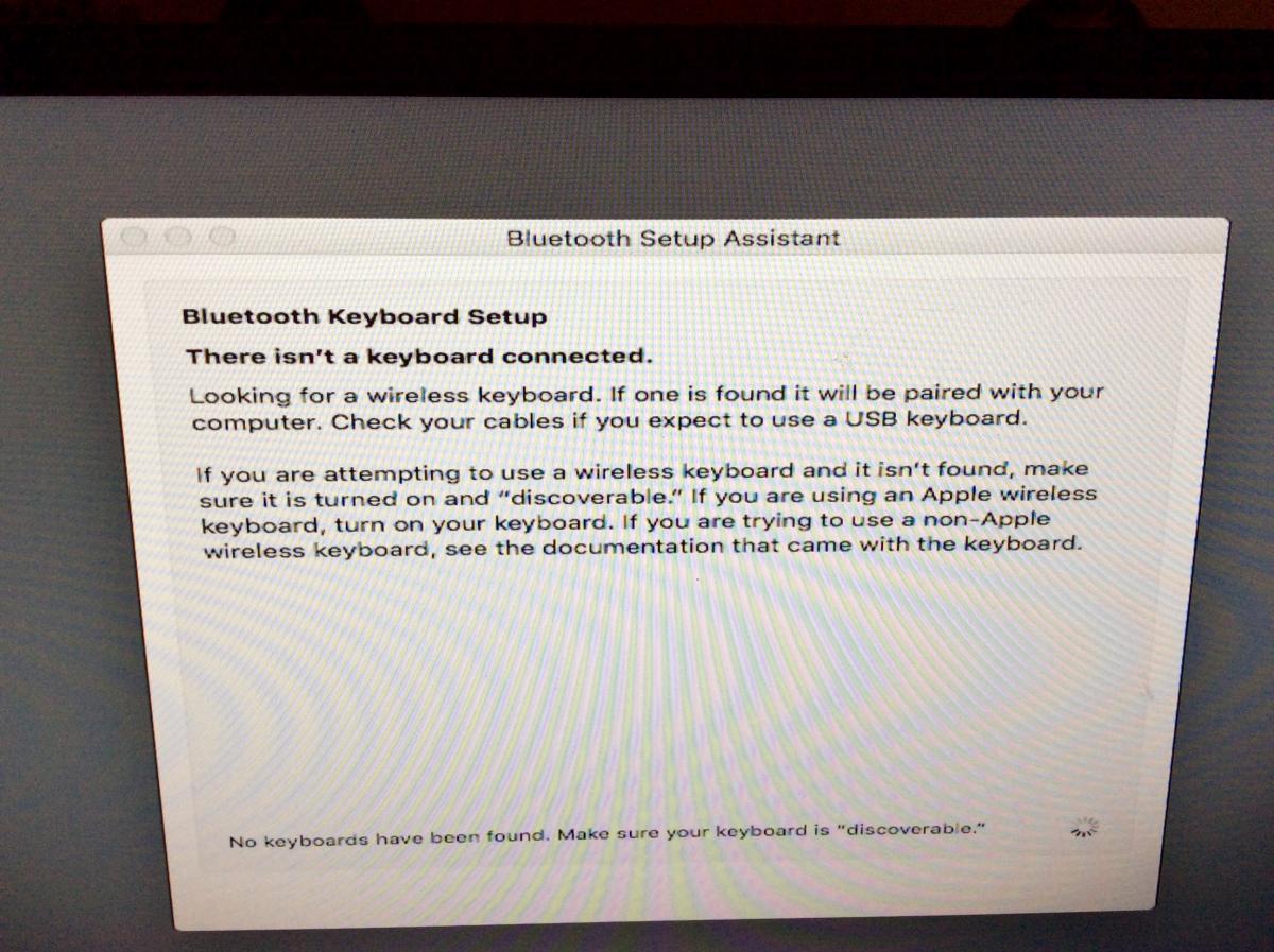

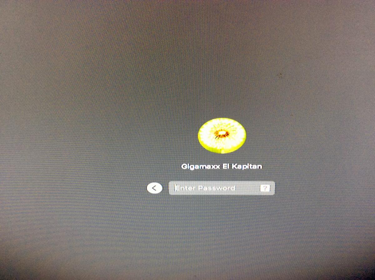

Uh, Oh my two keyboards aren't recognized! I finally get into ElCapitan and I can't get through the door. Any fix for this?
The is Shanee, that was the last hurdle. It booted pretty quick on my Ssd.
Spakk's USB Fix for El Capitan, http://www.insanelymac.com/forum/files/file/521-usb-fix-for-el-capitan/

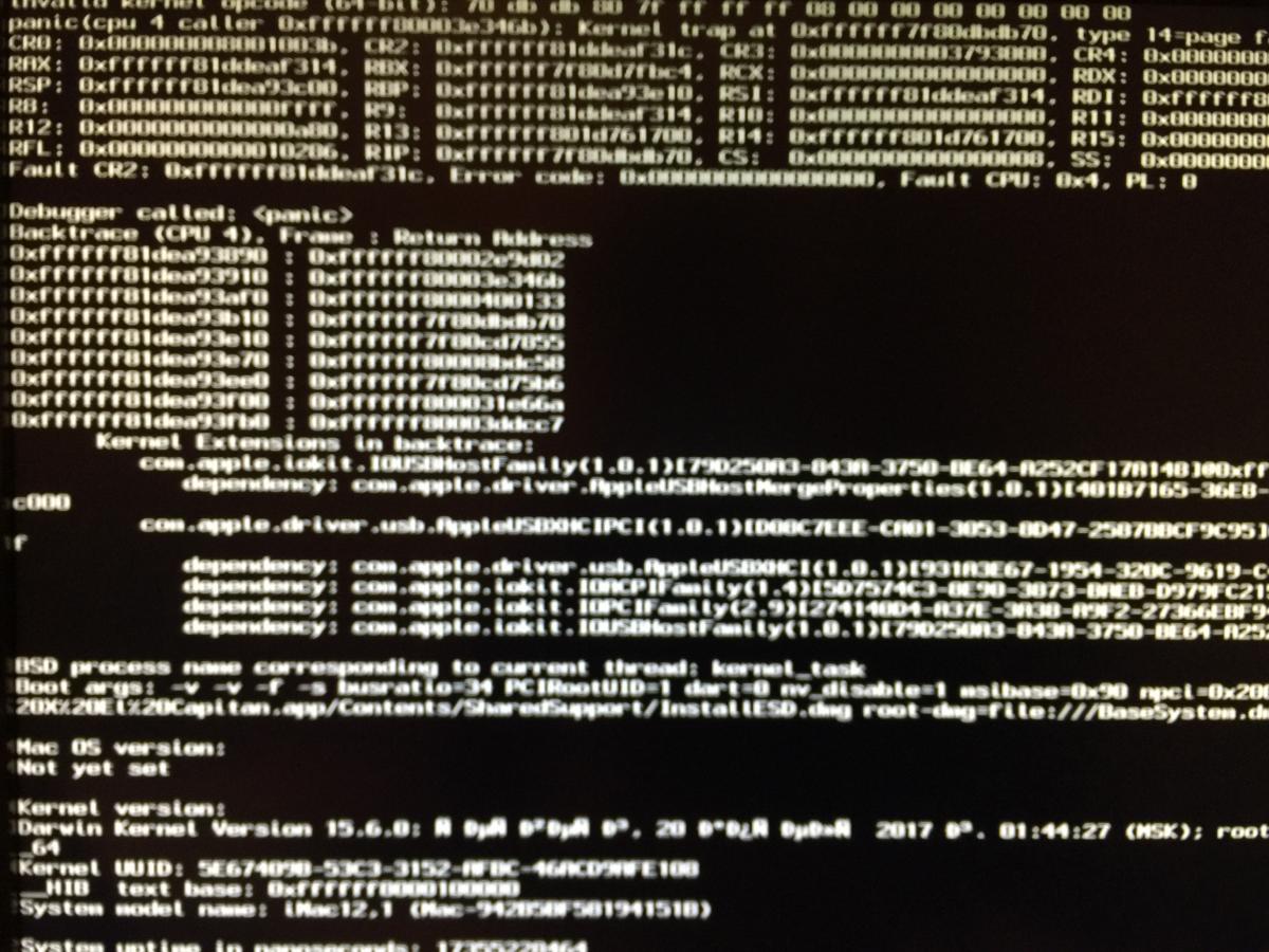

tried using only -v, same error.

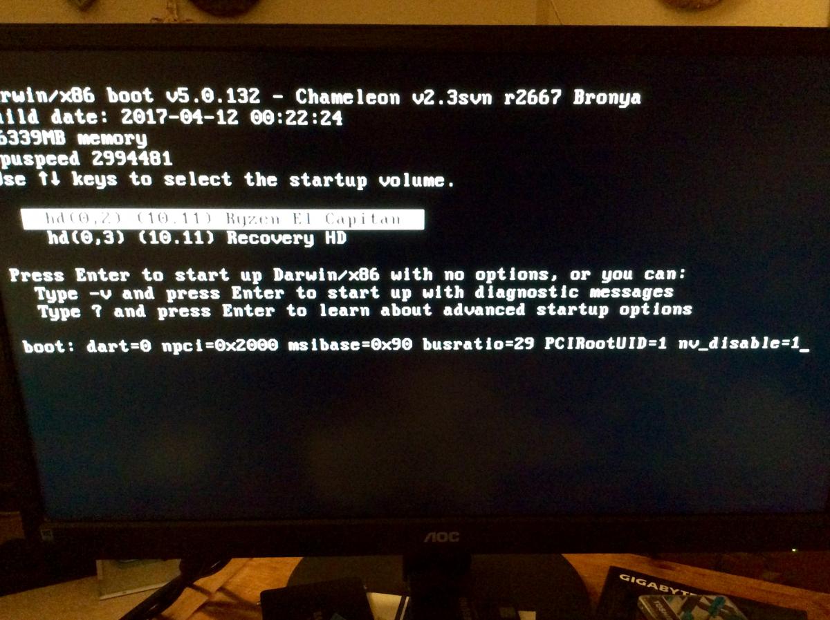

dart=0 ncpi=0x2000 msibase=0x90 busratio=29 ( enter your minimum MHz # 3200=32 etc. ) PCIRootUID=1 nv_disable=1. I was (am) able to get to password using only these flags. Without dart=0 it wouldn't work. I'll try to eliminate the msibase later during testing.

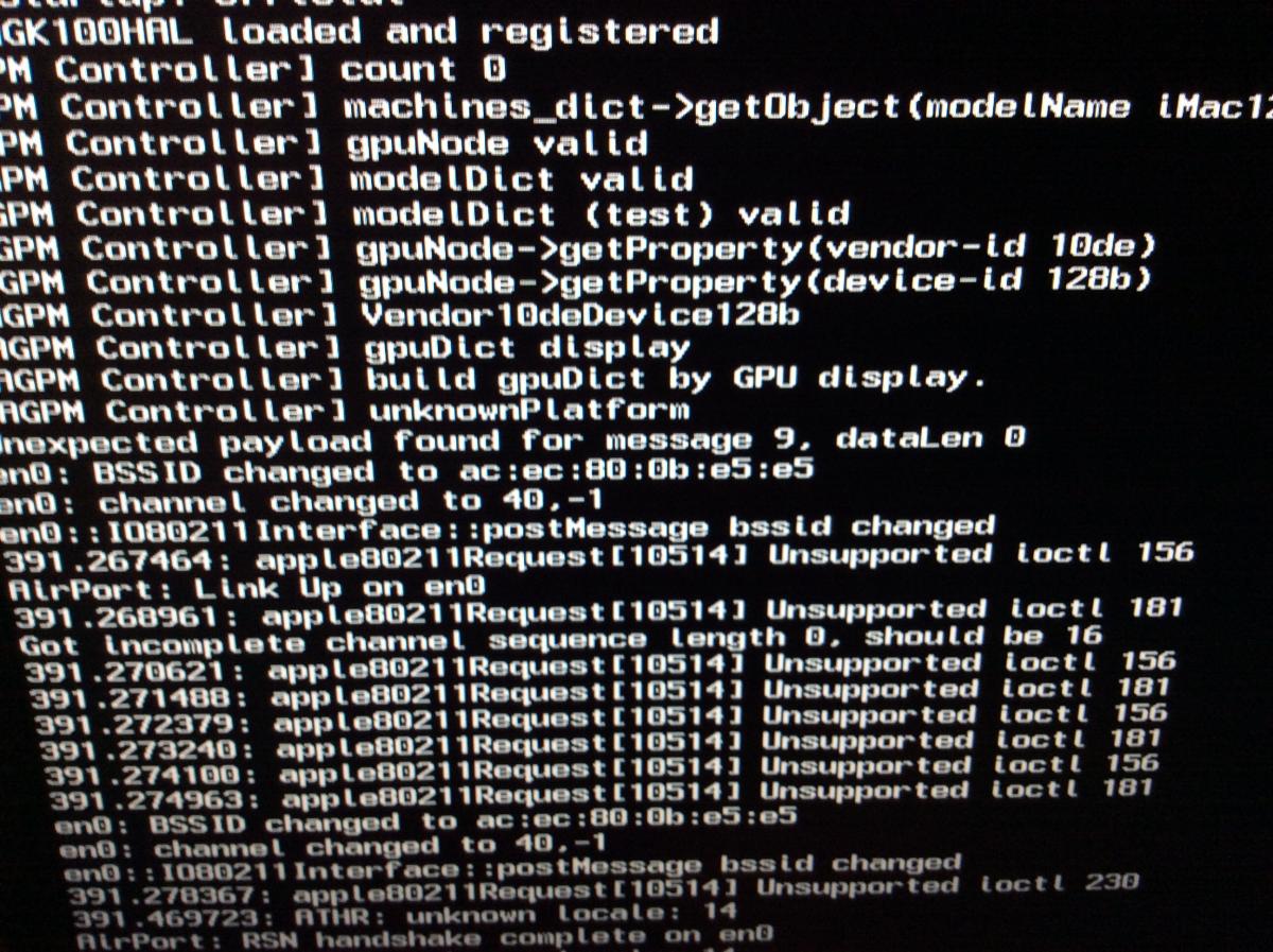

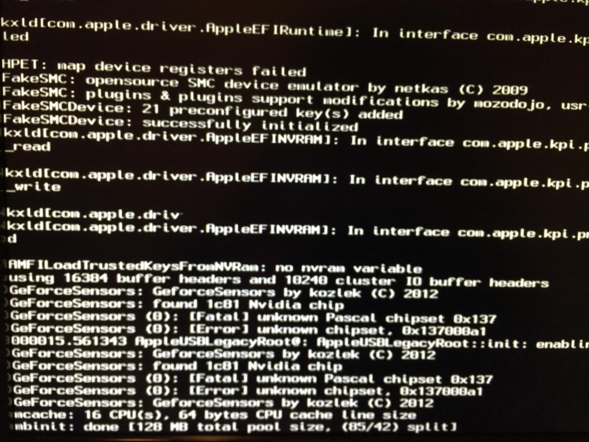

I was trying anything and everything I could think of. This chameleon bootloader is very new to me, I know the debug=0x144 is recommended for chameleon/Enoch but it was giving a debugger error. I tried debug=0x100 for clover and it went away, it is probably because it had no effect but it got me further in the boot process. The nvidia_disable=1 never used before last night it's like learning a new language, I'll get there. Thanks for the R9 270 link I'm not a big Nvidia fan but it's hard to find currently available supportable AMD cards for Sierra that don't require IGPU, IGFX, as primary display. There are a few inexpensive choices from Nvidia still left, when I started into Sierra in july and got the RX 460 working and then the RX 480 I was able to use the AMD 5450 natively but now it requires kext editing to work. This R7 265 is a great card when using clover it performs like my RX 460 in most benches so if I can get it to work that would be great for now.Thanks again for all your help, you folks made it possible for this to work for me. I will update my specs tonight in my signature and try to lay out all my parameters that I used for others to check if interested. <blockquote class='ipsBlockquote' data-author="Bronya" data-cid="2411319" data-time="1493059863">Bronya, on 24 Apr 2017 - 11:51 AM, said:Bronya, on 24 Apr 2017 - 11:51 AM, said:Bronya, on 24 Apr 2017 - 11:51 AM, said:Bronya, on 24 Apr 2017 - 11:51 AM, said:Bronya, on 24 Apr 2017 - 11:51 AM, said:<p><span style='color: #000000'><span style='font-family: Verdana, Geneva, sans-serif'><span style='font-size: 12px;'>Nvidia gt 710.Nvidia gt 710 either sapphire or MSI I'll check when I get home. Here's the ID.post-1753549-0-24305400-1493066956_thumb.jpg

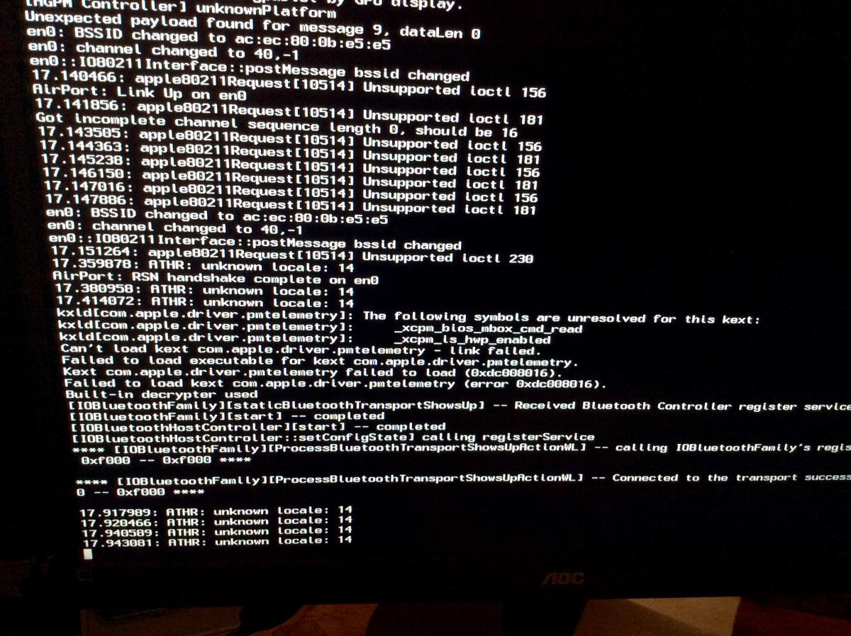

@Bronya, I found this the xcpm and HWP enabled message. Is this a normal FakeSMCKext loading or could we get this SkyLake/KabyLake feature working in chameleon? I know the latest clover allows use of this for power management for newer Intel CPUs. Does Ryzen have possible HWP or equivalent? It would be great if it worked for sidestepping and sleep states.

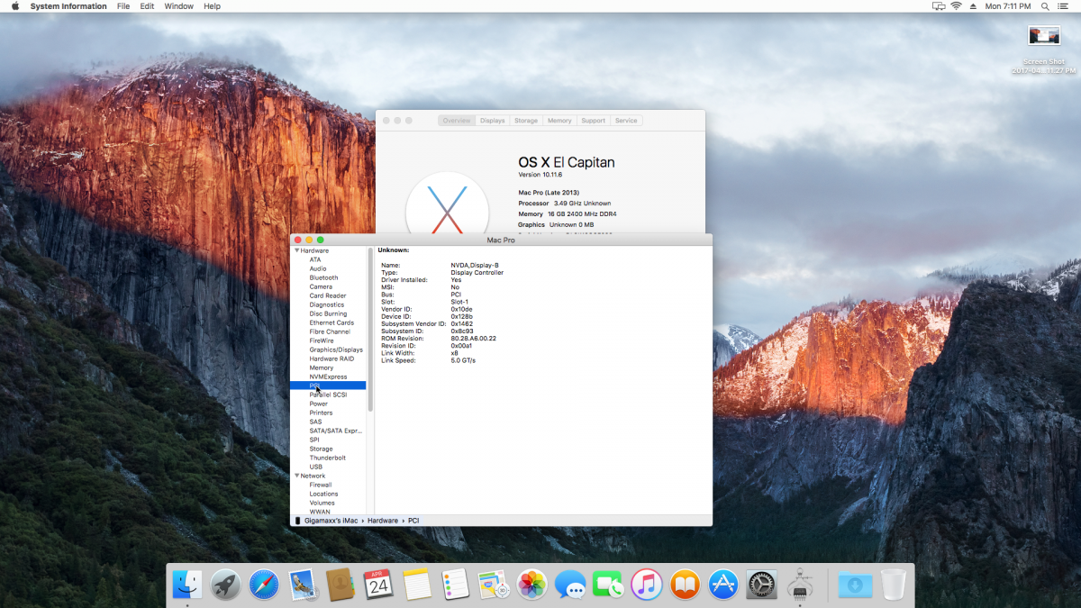

Nvidia gt710 1gb. $40 US.
Vendor 10de
Device 128b
The details you have made are the same with the details of the how-to
Rysen 5 1500X 4 cores 8 threads $189.00 US   El Capitan 11.6     Go Bronya!   You da Man!   This thing booted right up on my freshly cloned test disk and a new CHAMELEON 2667 boot loader and edits ( Thanks to Gils, Spakk, Shanee, and Aikimo?.
No msibase (like you said Bronya), basic boot flags dart=0 npc-0x2000 busratio=29 PCIRootUID=1 -nv_disable=1 -x  (first boot k panic second boot with -x added).    The majority of the work is in the kexts for support, and of course the boot and kernel provided by Bronya.    Thank you all, Gils thanks for the tips and config data this is cool!   Gifts coming for you too sir!

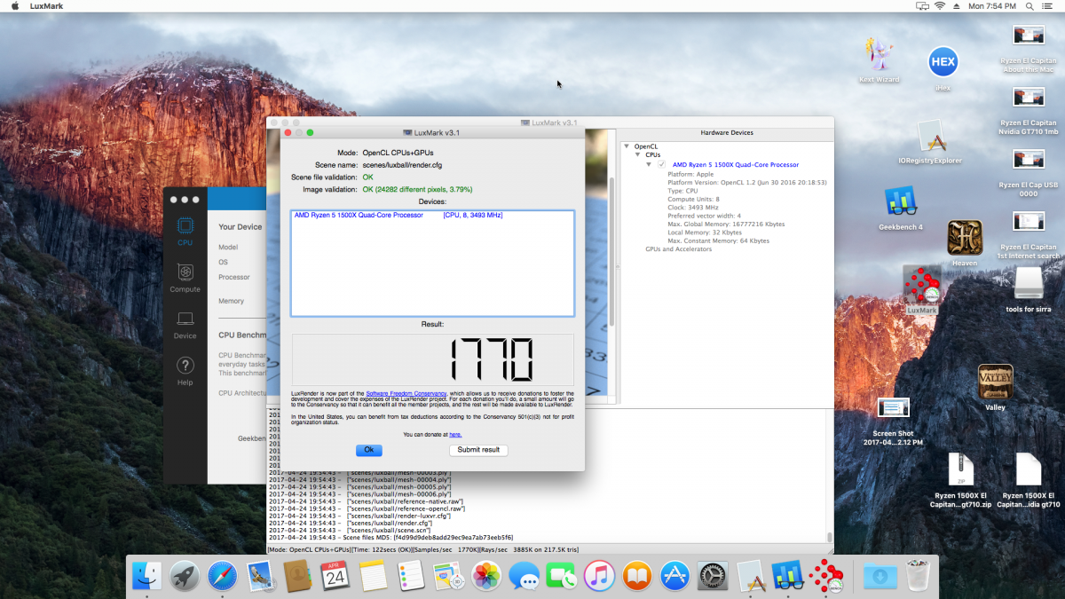

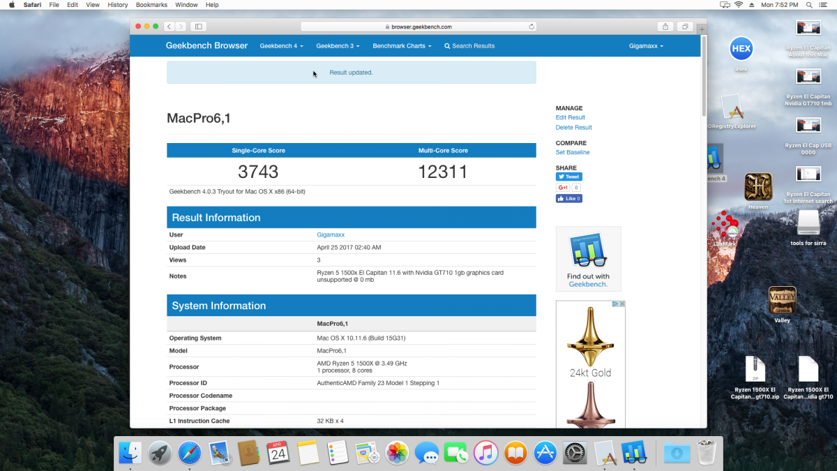

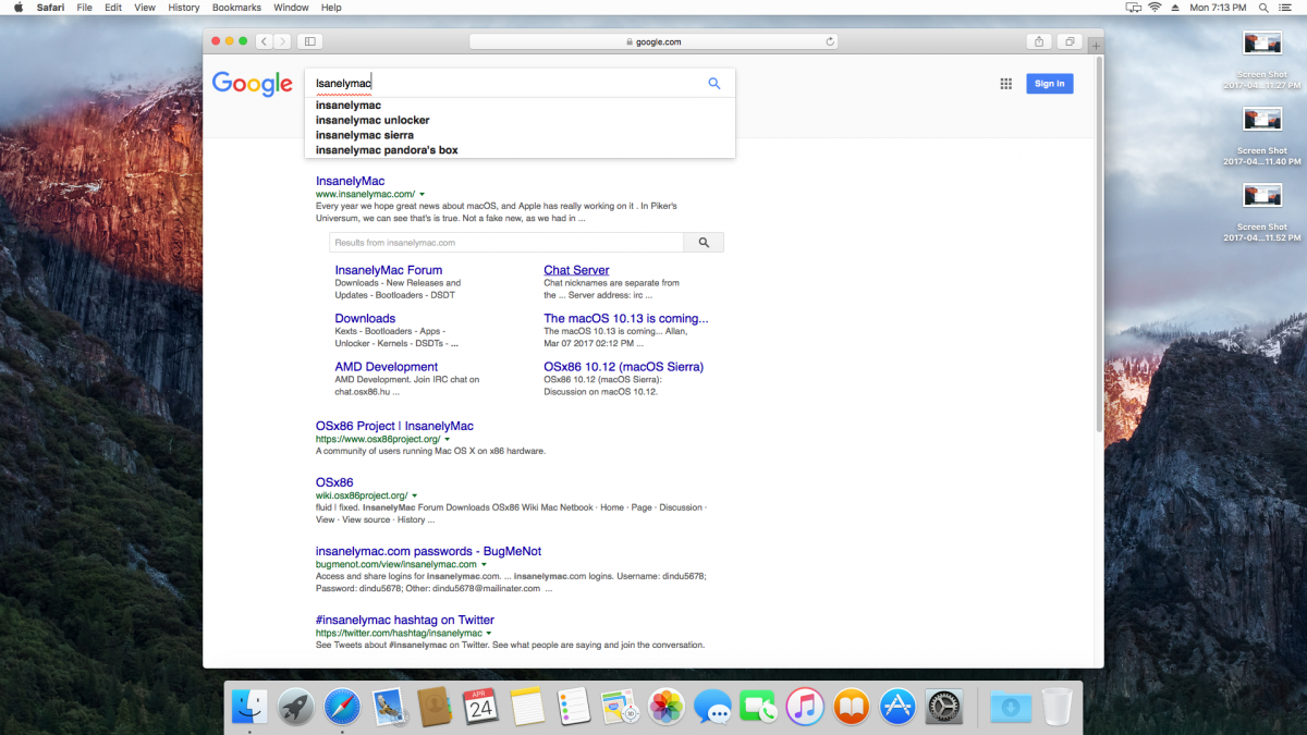

Thanks Dude!   There's no way I could've done it without you.    i figured out your USB fix, works great!   I'll check in there and report your greatness, thanks again.    I'll post more specs and screenshots of my config and bios settings.
I picked up a Nvidia GT 210, and 8400.   I'll test those as well as the AMD 5450 and R7 265 (R9 270X).     This little sub $200 4 core 8 thread is pretty smooth right now even with 0mb graphics.
post-1753549-0-29851200-1493088525_thumb.pngpost-1753549-0-68112000-1493088546_thumb.png
