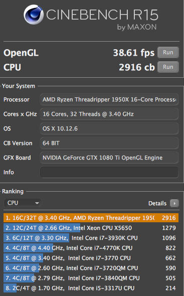

pulseOXE Posted October 2, 2017 Share Posted October 2, 2017 Threadripper... SUCCESS. My 1950X is officially booting. All of my issues were GPU related. Swapping to a GT 710 made everything work. I'm going to swap in an Ethernet controller that works unless there are drivers for BigFoot networking somewhere, and I should get some GeekBench results in the next day or so, and hopefully I can get my 1080Ti to work. EDIT: Adding Cinebench score... I'm using the Nvidia Web Drivers, and was able to get my 1080Ti working with Inject NVWeb. I have three monitors working, but the 3D performance is just bad, at least in Cinebench, but it's good enough for 1080p youtube. Great work on this Kernel!!! 4 Link to comment https://www.insanelymac.com/forum/topic/321626-ryzen-macos-1012x-sierra-kernel-researchdevelopment-thread/page/31/#findComment-2507324 Share on other sites More sharing options...

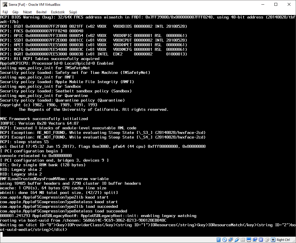

rio2 Posted October 5, 2017 Share Posted October 5, 2017 Trying to run Sierra VM on my R7 1700 system, but I keep getting at 'Waiting on.....' Screenshot included EDIT: I'm installing from a SPUD layout HFS+J dmg I created from the latest AppStore version of Sierra using Bronya's kernel and I rebuilt the kernelcache of the dmg on my macbook. Link to comment https://www.insanelymac.com/forum/topic/321626-ryzen-macos-1012x-sierra-kernel-researchdevelopment-thread/page/31/#findComment-2508832 Share on other sites More sharing options...
Bronya Posted October 6, 2017 Share Posted October 6, 2017 need install driver for VM . Link to comment https://www.insanelymac.com/forum/topic/321626-ryzen-macos-1012x-sierra-kernel-researchdevelopment-thread/page/31/#findComment-2510021 Share on other sites More sharing options...
rio2 Posted October 6, 2017 Share Posted October 6, 2017 need install driver for VM . What kexts should I put on the DMG? Link to comment https://www.insanelymac.com/forum/topic/321626-ryzen-macos-1012x-sierra-kernel-researchdevelopment-thread/page/31/#findComment-2510155 Share on other sites More sharing options...
Yutaro Posted October 7, 2017 Share Posted October 7, 2017 Threadripper... SUCCESS. My 1950X is officially booting. All of my issues were GPU related. Swapping to a GT 710 made everything work. I'm going to swap in an Ethernet controller that works unless there are drivers for BigFoot networking somewhere, and I should get some GeekBench results in the next day or so, and hopefully I can get my 1080Ti to work. EDIT: Adding Cinebench score... I'm using the Nvidia Web Drivers, and was able to get my 1080Ti working with Inject NVWeb. I have three monitors working, but the 3D performance is just bad, at least in Cinebench, but it's good enough for 1080p youtube. Great work on this Kernel!!! Fantastic news, please keep us updated on this build, I am planning on building one myself soon. 1 Link to comment https://www.insanelymac.com/forum/topic/321626-ryzen-macos-1012x-sierra-kernel-researchdevelopment-thread/page/31/#findComment-2510582 Share on other sites More sharing options...
Bronya Posted October 7, 2017 Share Posted October 7, 2017 What kexts should I put on the DMG? AppleIntelPIIXATA.kext Link to comment https://www.insanelymac.com/forum/topic/321626-ryzen-macos-1012x-sierra-kernel-researchdevelopment-thread/page/31/#findComment-2510665 Share on other sites More sharing options...

pulseOXE Posted October 9, 2017 Share Posted October 9, 2017 Fantastic news, please keep us updated on this build, I am planning on building one myself soon. It was not a bad build at all actually. I'm using the Gigabyte X399 board, and was able to get everything working. Networking, Sound and USB without issue. I have two remaining issues: 1.) Because I'm running in RAID for Windows, OS X can't see any of my drives. I've tried two different SATA cards with the motherboard to get OSX working internally. One doesn't show up in BIOS at all, but works fine in Windows, but I can't boot OSX from it or see it with Clover on USB, and the other card works great... if I reset my BIOS and disable RAID before boot or else the motherboard won't post. Issue 2.) is that my 1080Ti isn't running anywhere close to full speed with the Nvidia Web drivers, but it sounds like there isn't much I can do about it. Overall the system is stable (except for Sleep), and works well. Link to comment https://www.insanelymac.com/forum/topic/321626-ryzen-macos-1012x-sierra-kernel-researchdevelopment-thread/page/31/#findComment-2512483 Share on other sites More sharing options...
