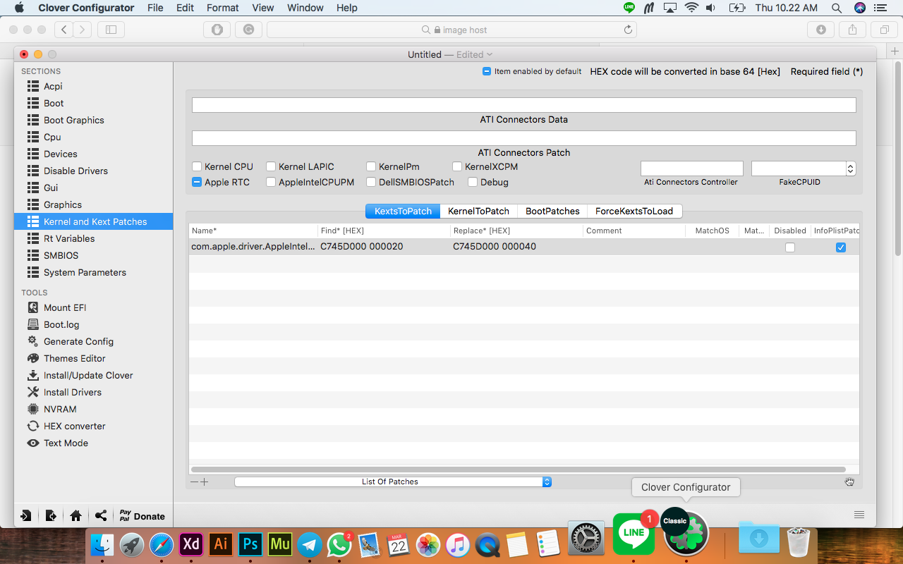

Sorry, I was late to join the party. Before I start to ask, I want to say sorry for my bad English.
I'm new for this mac's things, but I want to increase my MBP2011(8GB) VRAM to 1024MB too. I already disabled SIP, have Kext Utility, Hex Fiend, and Clover Configurator.
So where I start to tweak these things right now?
Thanks for your reply

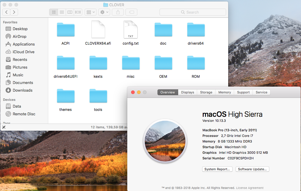

I already searched AppleIntelSNBGraphicsFB, back it up and then replaced
C7 45 D0 00 00 00
to
C7 45 D0 00 00 00
The system still says vram on 512MB. Am I missing something?
C7 45 D0 00 00 00
to
C7 45 D0 00 00 00
Sorry I mean replaced
C7 45 D0 00 00 00 20
to
C7 45 D0 00 00 00 40
You are using clover, you don t need to mess with kexts, you only need clover kext patches that will be applied on boot by clover, and you can find the links in OP

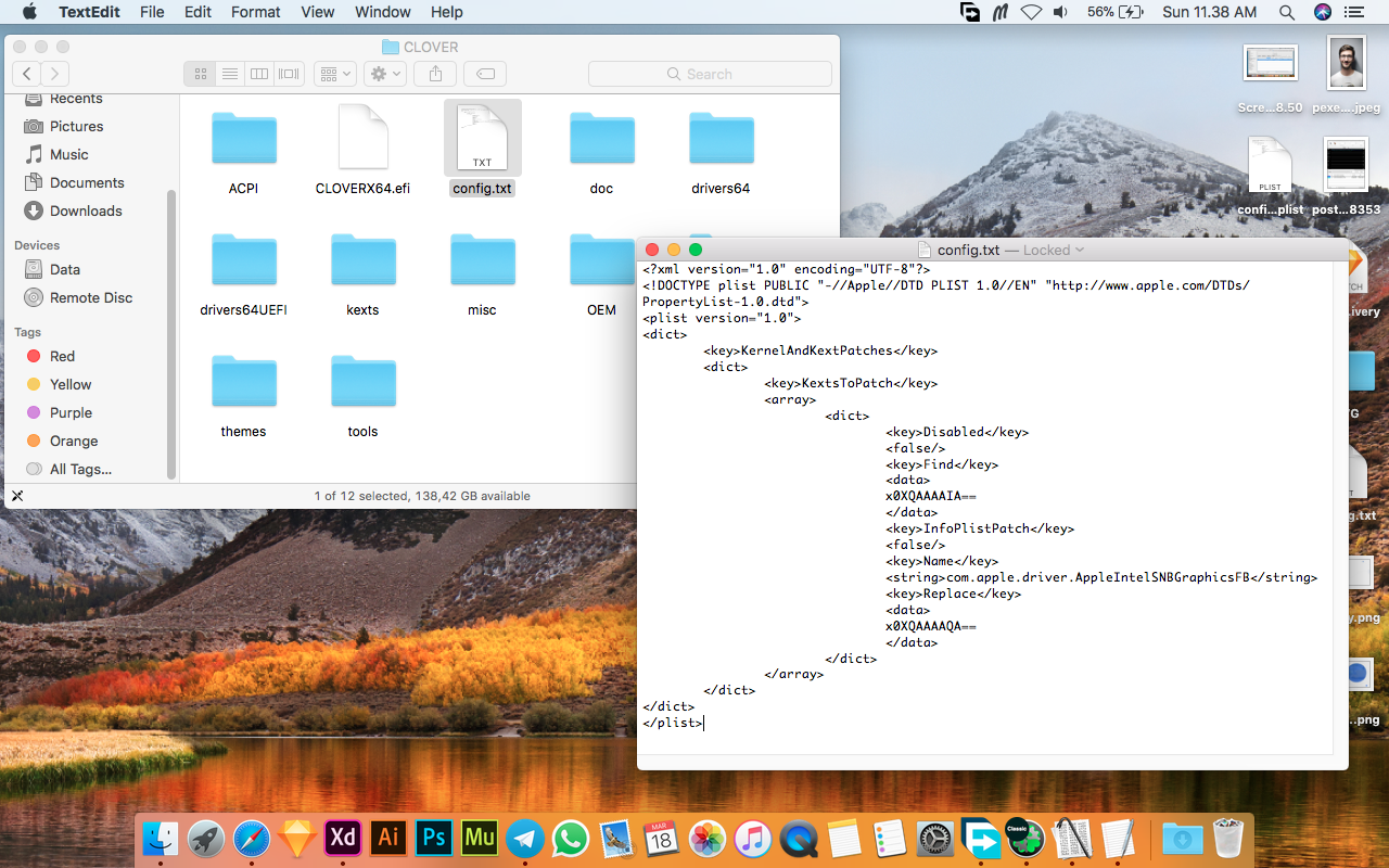

My txt is looks like this
Spoiler
<plist version="1.0">

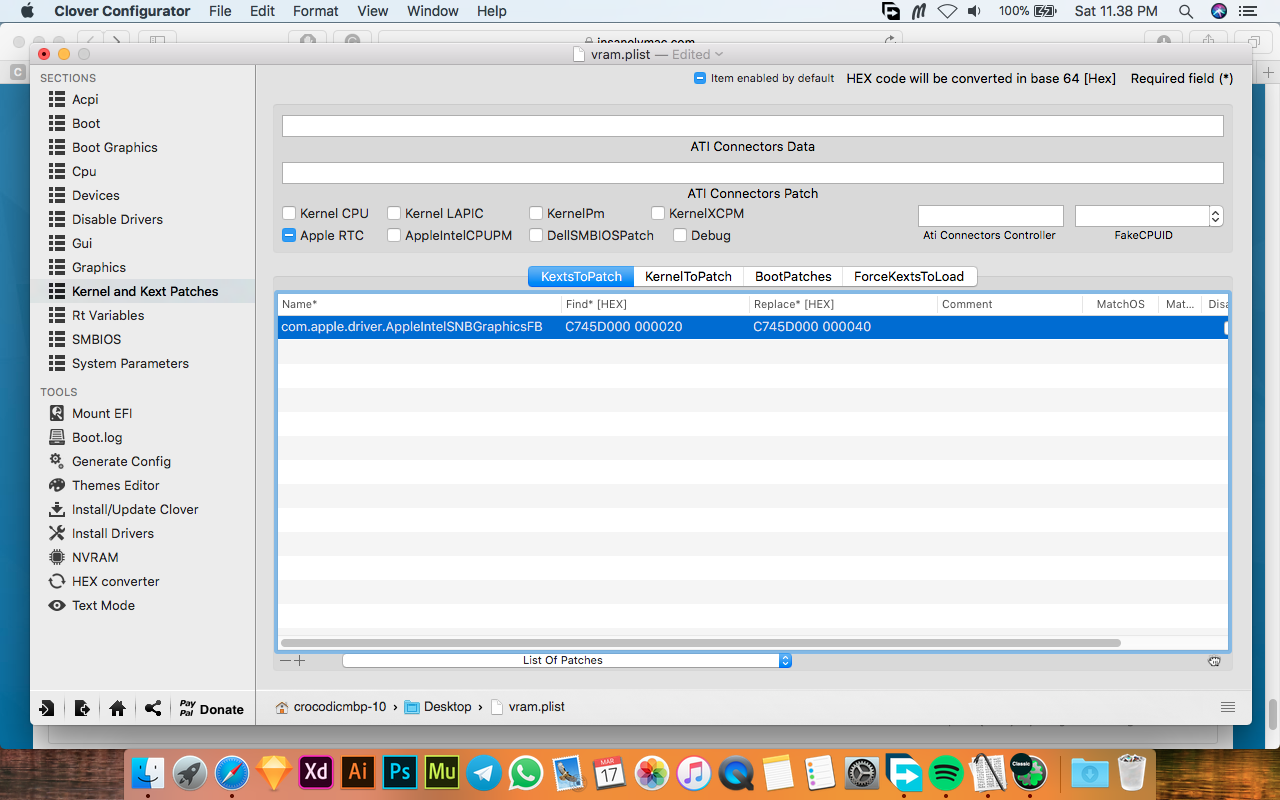

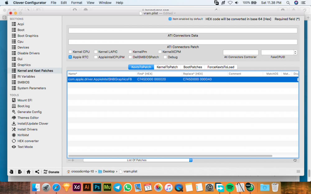

my values:
find: c745d000000020
replace: c745d000000060
1.5gb, this is working here.
are you using a vanilla AppleIntelSNBGraphicsFB?
You may also need to patch the infoPlist of the kext, there are more infos in this thread.

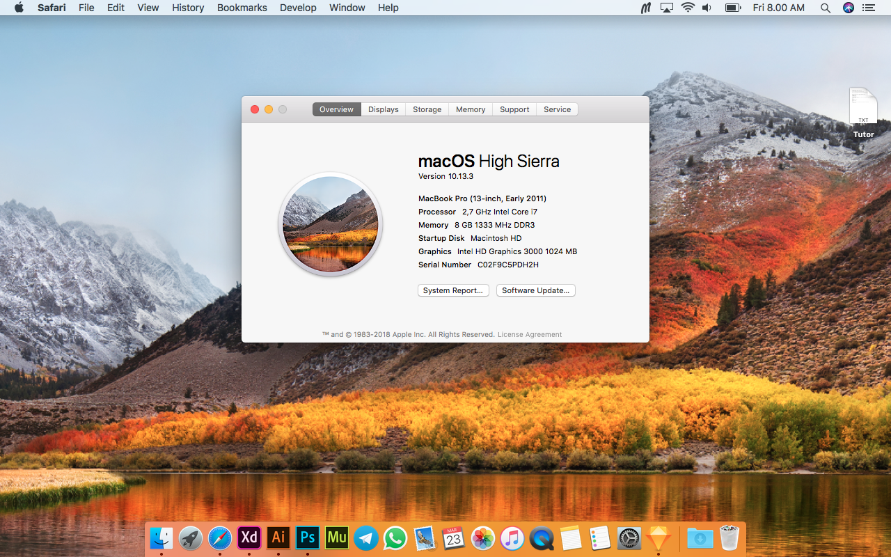

Hi guys, I'm so sorry for my late reply.
Sorry that I little confused about it. Depend on this post
On 3/19/2018 at 4:49 PM, Hervé said:
Depending on the Clover version you're using, you may or may not need the "com.apple.driver." syntax in front of the kext name. Rebuild your cache with the vanilla SNB framebuffer, reboot and, if you still do not obtain 1024MB VRAM, given that your binary patch appears Ok in your Clover config, I'd give the revised kext name a shot.
How do I do this? Is it my backup folder named "AppleIntelSNBGraphicsFB-orig.kext copy" necessary?
Hi, guys. Good morning/evening.
Sorry for my late reply, yesterday I have tried some method that made my VRAM became 3MB, luckily I could revert it. (that gave me some experience about tweaking this thing like rebuilding manual cache and repairing permission)
So I have restored it to the vanilla AppleIntelSNBGraphicsFB and AppleIntelHD3000Graphics.
based on this sentence "given that your binary patch appears Ok in your Clover config, I'd give the revised kext name a shot". which one in the attachment that I posted is the binary patch that I could send to you? I couldn't find any button OK in here. Sorry that I slow learner, I really really appreciate your response, guys.
This method use binary patch, so dont tick on InfoPlistPatch (InfoPlistPatch = false)
like what kylon's said to Save it config.plist -> rename it to config.txt -> place it to Macintosh HD/EFI/CLOVER -> clear caches -> reboot. Is that correct?
When i said "you may need to edit the info.plist" i also said that you can find more info in this thread.
This patch is not a plist patch, also the info.plist patch in clover is limited, so you can t use clover for the one i m referring to.
If you opened your current config click on save and you are done.
