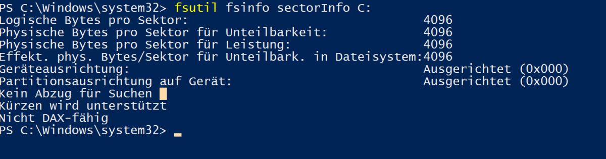

it is capable, i'm running it on 4k.
Tbh: i trust nvme-cli more than the windows tools. ;-)
THNSN5512GPU7 NVMe TOSHIBA 512GB:
  Capacity:	512,11 GB (512.110.190.592 Byte)
  TRIM-Support:	Yes
  Model:	THNSN5512GPU7 NVMe TOSHIBA 512GB
  Version:	57DA4103
$ diskutil info / | grep Block
   Device Block Size:        4096 Bytes
   Allocation Block Size:    4096 Bytes
however - did the windows tools with my already patched one and looks fine:

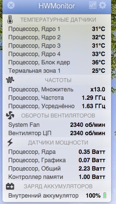

Coming back to my previous question about FAN revolution monitor, I found dependence in ACPI from temperature and fabricate small SSDT.
May be somebody has some ideas to improve or change my method.  :)

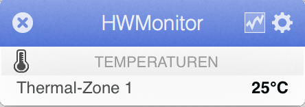

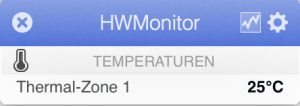

tried your SSDT, without any change. how did you get so much information in your hwmontior in the first place? i only get one thermal zone, which is pretty sure defunc.
your name is SSDT3a - has this sth to do with the SSDT3 or is it just random? Because my SSDT3 was defunc from day one (empty) - see https://github.com/wmchris/DellXPS15-9550-OSX/blob/10.11/10.11/DSDT-SSTL/SSDT-3.dsl
Need drop PTID table
<dict>
<key>Signature</key>
<string>SSDT</string>
<key>TableId</key>
<string>PtidDevc</string>
</dict>
SSDT3 table is different (empty table).
Also use FakeSMC_ACPISensors.kext; FakeSMC_CPUSensors.kext with HWmonitor 6.11 version (I don`t know why newest version are not working) B) .
HWSensors.6.11.1328.Binaries.dmg
