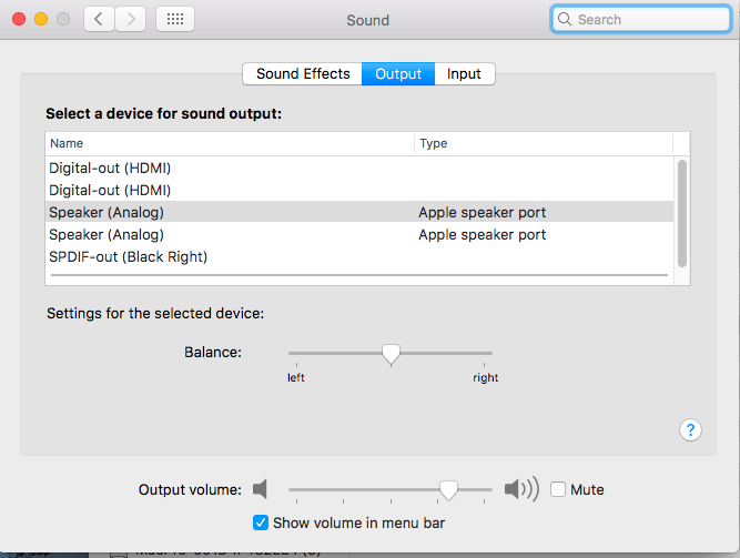

Attached is Dump and screenshot showing Sound Preferences.  I would also like to get SPDIFOut working as it does not in Voodoo nor my patched audio files link to it below.

It looks like you already have all of your speakers working.  Your problem, as you noted, is that they are not working together.  For that, you need to create a multi-output device.  That's the only way that Apple lets you use multiple outputs.  When you do that, you can preset the volume of each output so that you can boost your subwoofer.  (But be careful that you don't end up with a lot of buzzing from the vibration of the subwoofer if you're doing this on a laptop.). Also, you can change the frequency to enhance your audio with a multi-output device.  To do this, you need to create your multi-output device using Audio Midi Setup.  The one downside to this, and it happens to Mac users too, is that the volume slider in your menu bar will go gray as you cannot adjust volume of a multi-output device with the volume control. However, starting with Sierra, you can select your output device to adjust volume using the slider in the menu bar and that works great.  You just have to adjust the volume for each device separately.  For my laptop, I have the volume of my tweeters set at 100% and my subwoofer and midranges at 67%.  I also have all my speakers set up with 192 MHz sample rate.  That gives my laptop optimal audio.  You may need to experiment with yours.

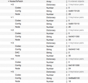

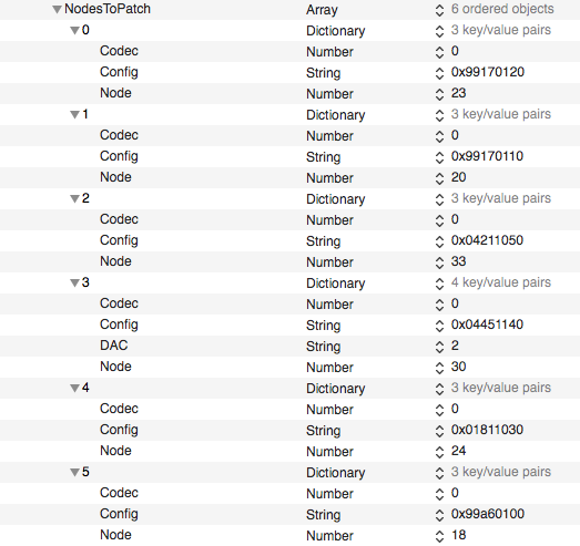

I have screen shots of the sections I used to patch Nodes to Patch section.  I added DAC to it did not help.  Is there another node I need to add in this section, possible the output node which is 6?

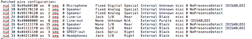

This line from your dump file appears to be problematic.  What do you think is the issue?
 nid 30 0x04451130 as  3 seq  0 SPDIF-out     Jack  Optic   Right   External Black   misc 0 NoPresenceDetect
First of all, your patch for this changes the last two digits (30) to 40.  Why?  I would put it back as 30 and change your other patch that uses 30 to 40.  See if that helps.

I see, I was using the Patched Pins Configuration Table that is from the GetDump file.  I should get the values elsewhere in the table?  What value do we use for "Codec" 0,1,2 etc, does that come from the dump file somewhere?  If everything is working or showing up in the sound preferences do I still need to add entries into the Nodes to patch or only the nodes that are not showing up or not working correctly?
I see now before Patched Pins Configuration table above is a table with the values I should use.  Still unsure about if I need to enter only devices not working or showing up in Sound Preferences and which Codec value to use that section.

I had another look at the Nodes to Patch on the XMP M1530, the additional Key "DAC".   That was actually entered under the Headphone node which shares the same jack with the SPIDFout jack just as mine is.  I am going to give that a try to see what happens.

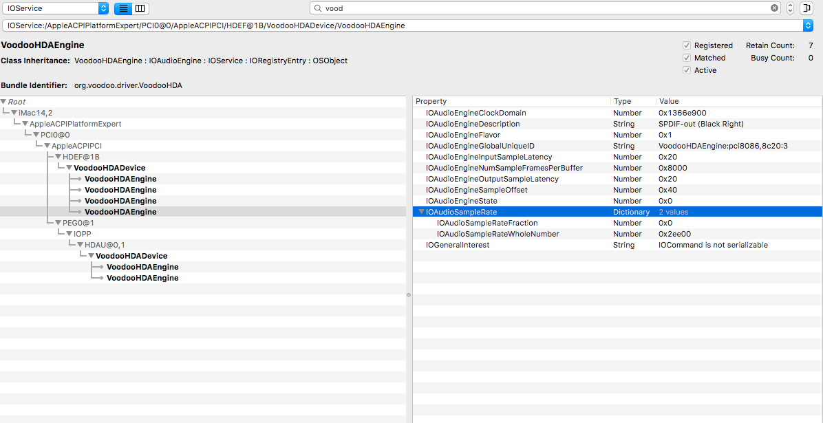

OMG I got SPDIFOut working it sounds Lush!!!   Thanks for all the help.  I was using the wrong cable. The sound is spectacular!!
Couple cool sounds starting to get into Dinka.
