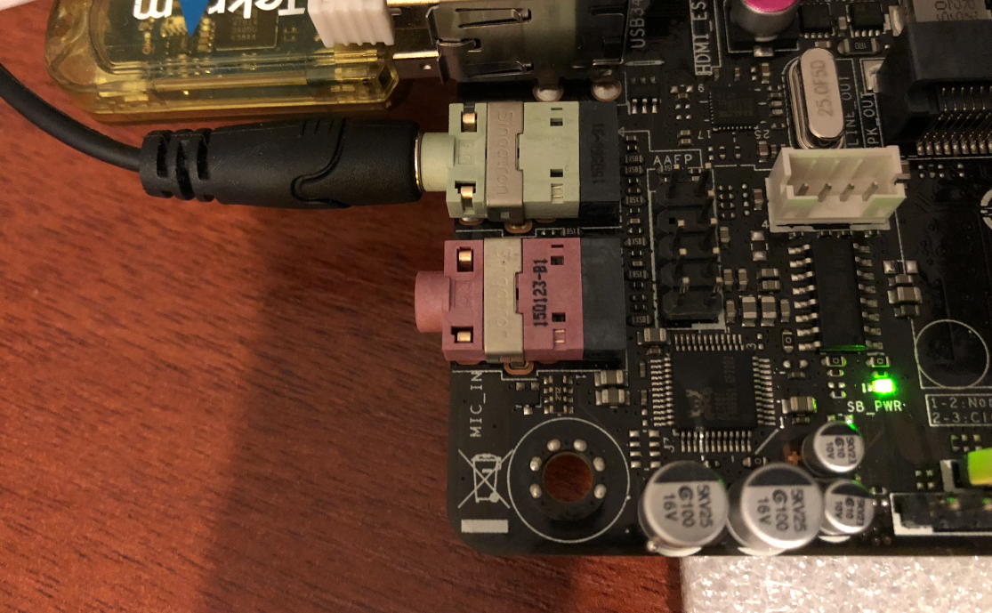

NEOSoftWare Posted December 5, 2019 Share Posted December 5, 2019 15 hours ago, Slice said: Provide the dump with getdump utility to see what is working and why. It turns out the sound works, it perfectly transmits from the AAFP connector and also the strong sound from the white connector that is nearby, but there is no sound from the green connector, there is probably a mechanical malfunction of the connector itself. thank you Link to comment Share on other sites More sharing options...
Slice Posted December 5, 2019 Author Share Posted December 5, 2019 13 hours ago, NEOSoftWare said: It turns out the sound works, it perfectly transmits from the AAFP connector and also the strong sound from the white connector that is nearby, but there is no sound from the green connector, there is probably a mechanical malfunction of the connector itself. thank you No, there is a configuration problem. Dump shows Tracing association 1 (2) Tracing pin 20 with min nid 0 nid 12 busy by association 0 Unable to trace pin 20 seq 0 with min nid 0 It looks like the mixer 12 is busy with association 1 and can not be used for association 2. (0x01014020) So my proposition is to change config for node 20 to be in association 1. <key>NodesToPatch</key> <array> <dict> <key>Comment</key> <string>Change LineOut to be in group 1</string> <key>Codec</key> <integer>0</integer> <key>Config</key> <string>0x0101401f</string> <key>Node</key> <integer>20</integer> Be careful about other lines in the info.plist Link to comment Share on other sites More sharing options...

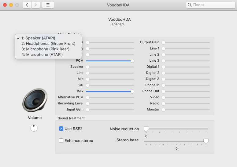

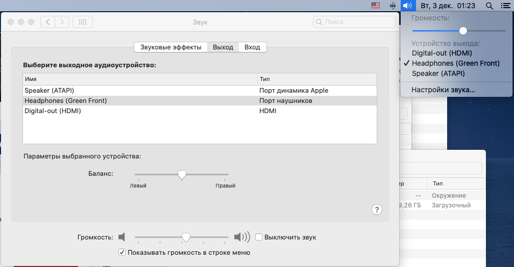

NEOSoftWare Posted December 5, 2019 Share Posted December 5, 2019 10 hours ago, Slice said: No, there is a configuration problem. Dump shows Tracing association 1 (2) Tracing pin 20 with min nid 0 nid 12 busy by association 0 Unable to trace pin 20 seq 0 with min nid 0 It looks like the mixer 12 is busy with association 1 and can not be used for association 2. (0x01014020) So my proposition is to change config for node 20 to be in association 1. <key>NodesToPatch</key> <array> <dict> <key>Comment</key> <string>Change LineOut to be in group 1</string> <key>Codec</key> <integer>0</integer> <key>Config</key> <string>0x0101401f</string> <key>Node</key> <integer>20</integer> Be careful about other lines in the info.plist added, another device appeared in the list, but the sound still does not work dump2.txt Link to comment Share on other sites More sharing options...
Slice Posted December 6, 2019 Author Share Posted December 6, 2019 Install prefPane and make the sound louder. https://sourceforge.net/projects/voodoohda/files/VoodooHDA.prefPane.zip/download Link to comment Share on other sites More sharing options...

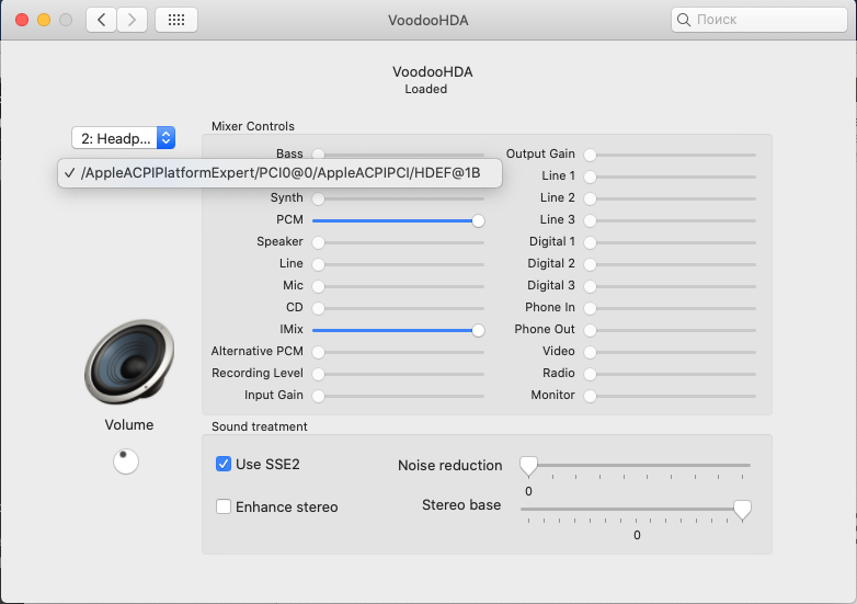

NEOSoftWare Posted December 6, 2019 Share Posted December 6, 2019 14 hours ago, Slice said: Install prefPane and make the sound louder. https://sourceforge.net/projects/voodoohda/files/VoodooHDA.prefPane.zip/download only 2 sliders move, no result Link to comment Share on other sites More sharing options...
Slice Posted December 7, 2019 Author Share Posted December 7, 2019 Switch to Headphone. It is other device. Link to comment Share on other sites More sharing options...
NEOSoftWare Posted December 8, 2019 Share Posted December 8, 2019 On 12/7/2019 at 8:40 AM, Slice said: Switch to Headphone. It is other device. same result doesn't work Link to comment Share on other sites More sharing options...
Slice Posted December 9, 2019 Author Share Posted December 9, 2019 Make node 26 to be in group 3 0x99130130 and Headphone node 27 0x0221403f It is more common when Speaker+Headphone are in one group and Line-out is in another group then Lineout node 20 to be 0x01014010 1 Link to comment Share on other sites More sharing options...
