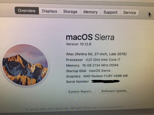

Succes AMD Asus 390X Strix on Sierra 10.12.5.
My configuration is Inject Intel and let IGPU as primary. No patches. Sleep works!
I decided this card because FCPX (Open CL)  is my principal use and color in Davinci Resolve sometimes. I tried RX 480 but was ver problematic in each update and run slowly for my work.
At the moment I don´t see any GPU faster for work in FCPX.
Specs important for me over 480/580x:
- Bus 512 Bits
6,026 GFLOPS
188.3 GTexel/s
2816 Stream Processor
- Bandwith 384 GB/s
- Computes Units 44
- GDDR5 8192 MB

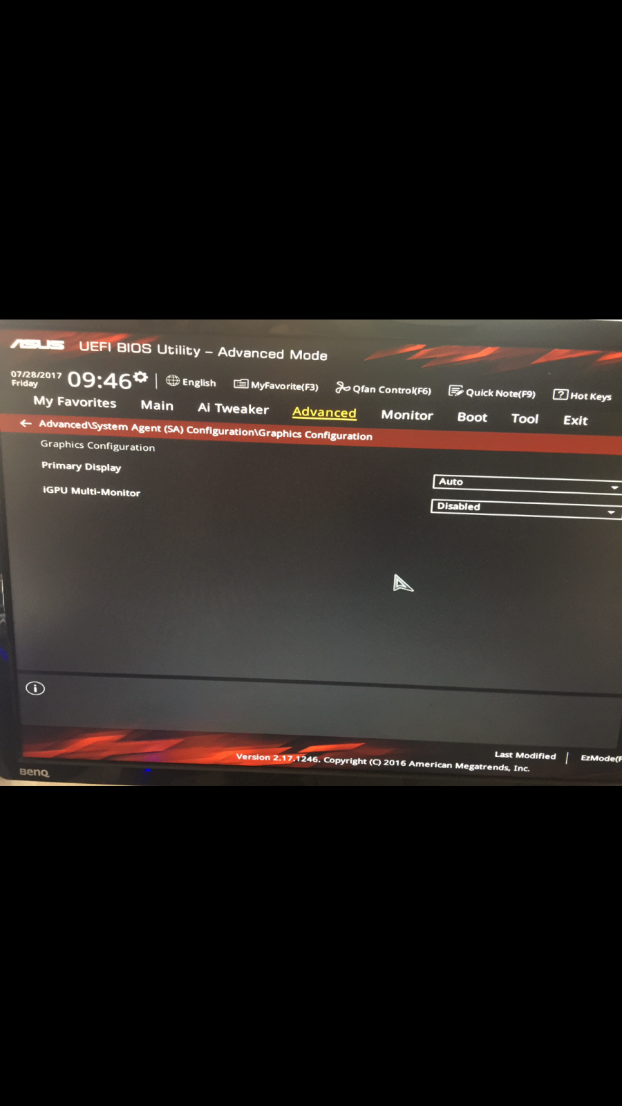

Important:

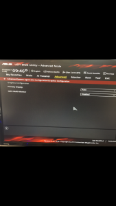

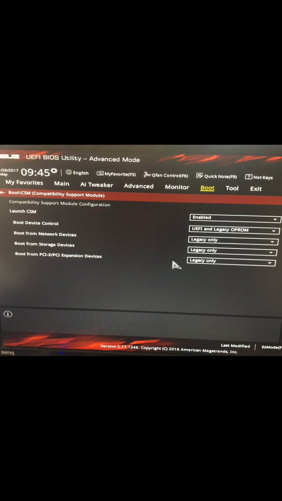

- Mobo Maximus VIII need to disable CSM compatibility in order to boot only with IGPU and no auto recognize the GPU.
- Fake ID 0x67b01002 - Clover
- Fix display 0100 -  Clover
- Inject Intel - Clover
Thanks to @Slice for NO INJECT Ati , @Matthew82, for links and info, @maldon and always @Rampagedev for all my systems.

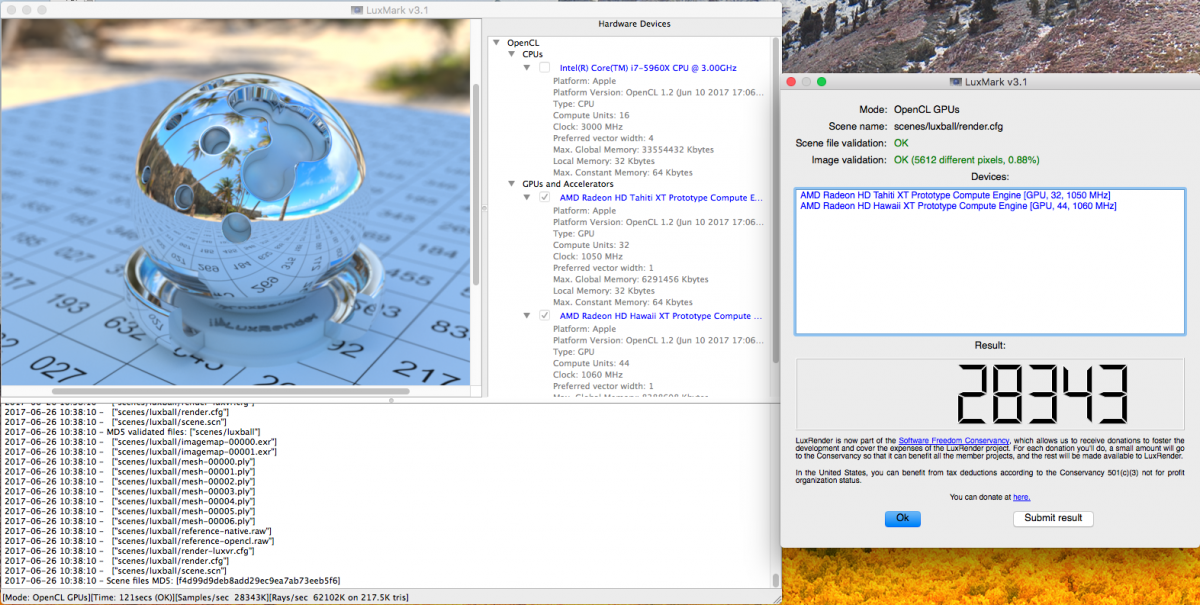

I let some test attached:
Bruce FCPX: 11 Seg.
Davinci Candle Test:
66 blur Nodes: 7 fps
30 BN:14
18 BN: 24
9 BN: 24
cinebench.tiff
luxmark.tiff
screen 390x.tiff
unigine.tiff

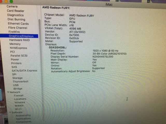

I've got 10.13 beta working, everything except graphics acceleration. Was pretty easy really and now no nvme patches.
There's native support for fury / nano in it, but for some reason the X4500HW kext isn't loading. The AMD9500 kext is loading fine.

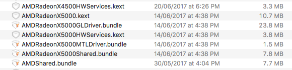

So, I finally got the new Sierra installed. The X4500HWLibs kext isn't what we need to get Fiji running. It's something else...
I guess the Baffin way will work, I'm just testing it.
I'm not great at this, but the baffin way crashed it, so I deleted the X4500HWlibs which made it work again,
So the X4100 kext is now loading after adding 73001002, but still no acceleration.

I put it back in the other computer and it's running cool now. The helper card (7970) is hot - 50 at idle.
I'm a bit confused with the behaviour of gpus and helper cards in Sierra so I'll spend some time investigating.
edit: the helper card hit 75deg with Luxmark. But both working together gave me almost 30,000 :)
The other computer is the same - helper card is running hot. It seems to think it's the main card in some way.

Screenshot below is why the Fiji isn't working yet.
You can see the suite of kexts they've made for the vega cards and the fiji is missing quite a few!

Just awesome!
macOS Sierra 10.12.6 fully working Amd Fury! Without iGPU helper....No more black screen issue :yes:
Put WhateverGreen.kext and Lilu.kext (1.1.6) to EFI/Clover/Kext/Other folder, and you ready to GO!
Boot arguments -liludbg -raddbg -radbeta
Bios settings at my Asus B150I Pro: Advanced/Primary Dispaly= Auto and iGPU Multi-Monitor=Disable
I also tested sleep mode and fully working so far....
Absolutely fantastic!
Have made some 'stress' test with sleep mode and tested for some time now! And everything WORKS awesome after sleep mode although background apps than Logic Pro X, iMovie, GarageBand etc.. have been active! F Yeah
Big hand to Vandroiy2013 and vit9696
