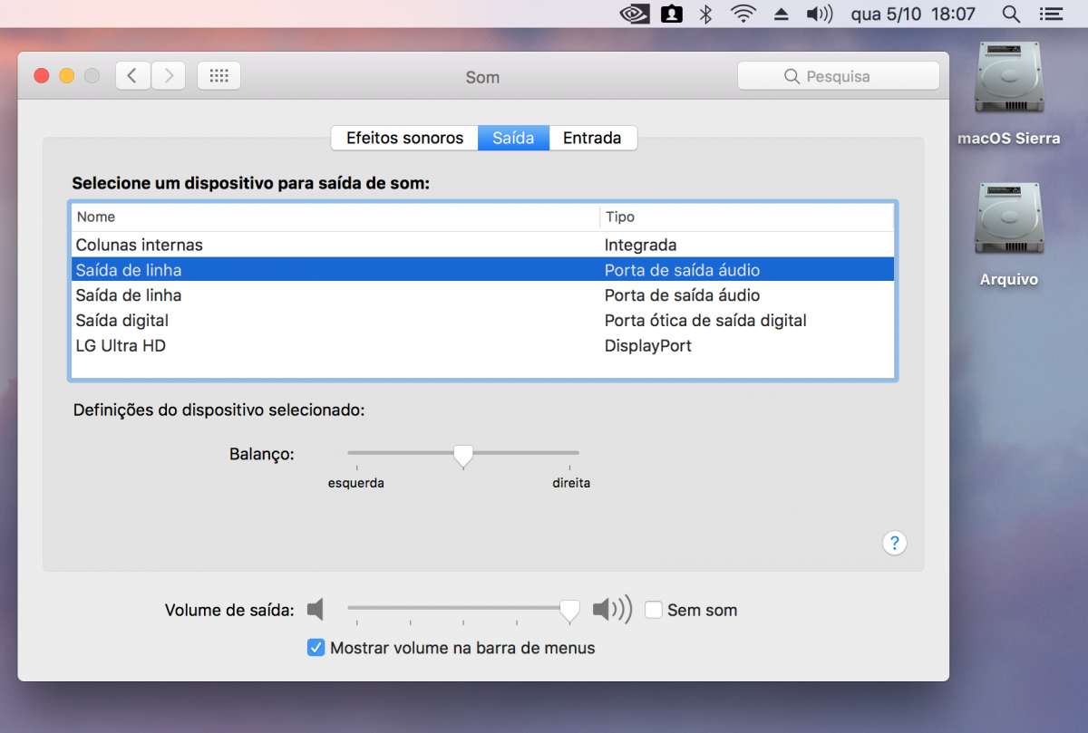

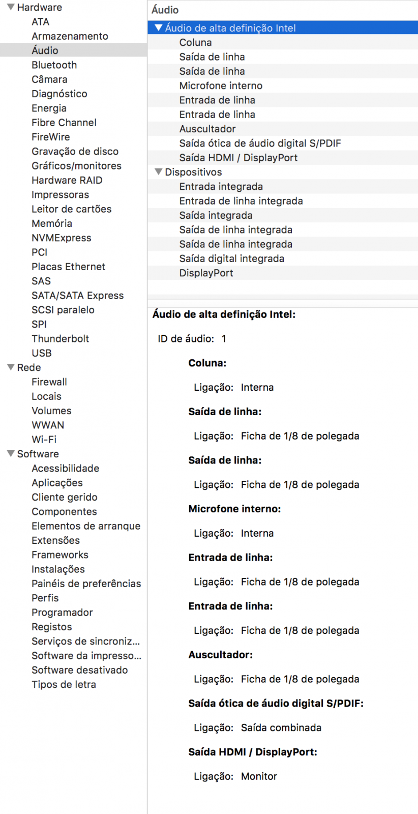

Fergarth Posted October 5, 2016 Share Posted October 5, 2016 Hi nmano, I had to leave the Betas and return to the official version of Sierra 10.12 because there is no support for Nvidia Beta versions that followed. I took and did a fresh install with your XCPM 10.12 Haswell-E config.plist and your patchs, that works very well in my new installation. I always used the voodooHDA for ALC1150 and always worked without stress, but this time i wanted to try AppleHDA. I tried audio_cloverALC-120 script, but despite the system to recognize the audio, to be able to control the volume and select the various outputs and inputs, cannot hear any sound. Basing me in your wisdom, will you can give me a help again? Is something missing in my DSDT? It will be something I can do or change?Thanks and greetings nmano. 1 Link to comment Share on other sites More sharing options...
scottlh Posted October 5, 2016 Share Posted October 5, 2016 Hi nmano, I have working sound now but for some reason i have a slight hissing background noise. I had a custom ssdt with fakecpuid for OC but it looks like it's not OC'ing anymore max speed is showing 3.68ghz. Other than that looks everything fine for my noob eye. Thank you very much. I had hiss in the output as well - try turning down the INPUT level Go to System Preferences -> Sound -> Input And turn down the input volume Worked for me on the Asus X99 Deluxe 1 Link to comment Share on other sites More sharing options...
Fergarth Posted October 6, 2016 Share Posted October 6, 2016 I had hiss in the output as well - try turning down the INPUT level Go to System Preferences -> Sound -> Input And turn down the input volume Worked for me on the Asus X99 Deluxe It was precisely what I did to eliminate background noise when i used voodooHDA 2.88, edited the values in info.plist kext Link to comment Share on other sites More sharing options...

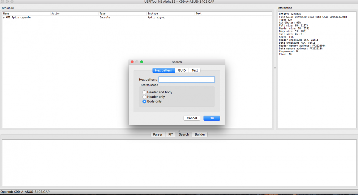

SammlerG Posted October 6, 2016 Share Posted October 6, 2016 with El Capitan you can use Clover patches, then xcpm doesn´t write to msr 0xE2. With msr 0xE2 you can set C-States, if your Bios is locked, C-States can only set from your Bios settings. With an unlocked msr 0xE2, xcpm can write direct to msr 0xE2 and sets C-States. You can patch your Bios with UEFI Tool to unlock msr 0xE2, or test some other Bios files. Link to comment Share on other sites More sharing options...
Fljagd Posted October 6, 2016 Share Posted October 6, 2016 with El Capitan you can use Clover patches, then xcpm doesn´t write to msr 0xE2. With msr 0xE2 you can set C-States, if your Bios is locked, C-States can only set from your Bios settings. With an unlocked msr 0xE2, xcpm can write direct to msr 0xE2 and sets C-States. You can patch your Bios with UEFI Tool to unlock msr 0xE2, or test some other Bios files. Thank I will test uefitool Link to comment Share on other sites More sharing options...
Fljagd Posted October 6, 2016 Share Posted October 6, 2016 What should I look for, and replace it with what? Thanks X99-A-ASUS-3402.CAP.zip Link to comment Share on other sites More sharing options...
SammlerG Posted October 6, 2016 Share Posted October 6, 2016 with newest ASUS Bios,i would search for 0FBA6C24400F and replace with 0FBA7424400F Link to comment Share on other sites More sharing options...
Fljagd Posted October 6, 2016 Share Posted October 6, 2016 Thank I will test now Link to comment Share on other sites More sharing options...
SammlerG Posted October 6, 2016 Share Posted October 6, 2016 yes, 200W is set manually. So i get 4.6 GHz with 6 core 100& load, and 4.7 with 3 core, 4.8 with 1 core.My system is water-cooled, max. temp is 67°C Link to comment Share on other sites More sharing options...
Fljagd Posted October 6, 2016 Share Posted October 6, 2016 @Fijagd Use uefipatch with patches.txt it is an automatic process that you can do via terminal Then you have to flash with flashback button because bios has not a valid checksum This is your patched Bios with MSR 0xE2 unlocked But you should try to build by yourself it does not work Explain the procedure me because I'm lost Link to comment Share on other sites More sharing options...
