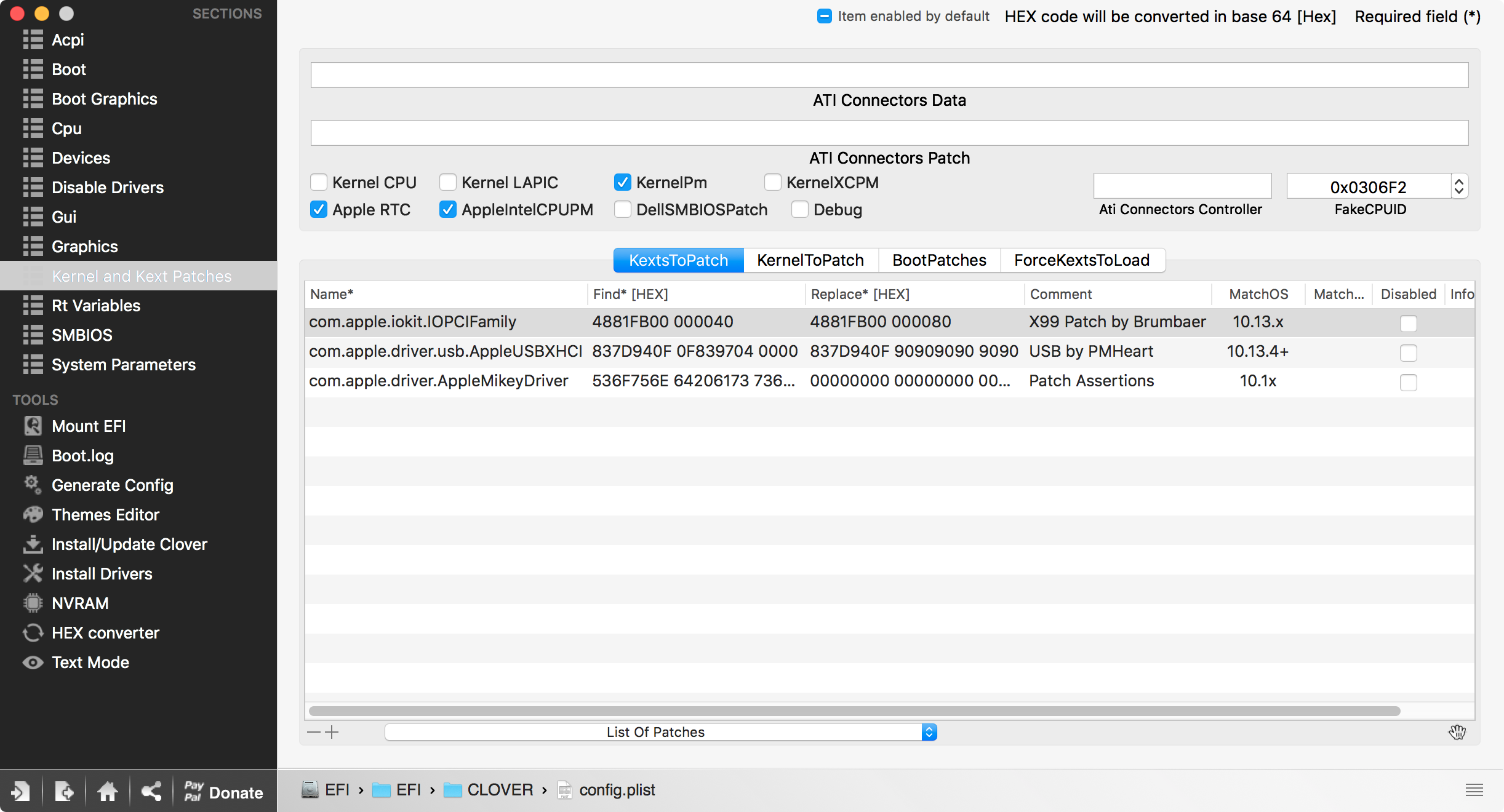

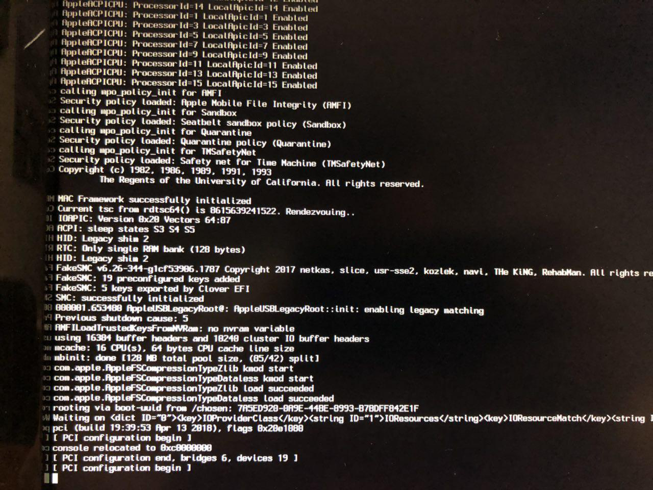

Hi all, It won't let me install the Update on a x99, it's stuck in PCI Configuration Begin.
Any new parameters for IOPCIFamily?
I think this parameter are the same from Sierra... at least I am 100% sure I not make any changed from HighSierra install
try Fix Darwin in ACPI section... and try USB2 port
If your CPU 5960X ?
If Yes you have to add 5960X clover config patch.
The same result :/
On 5/2/2018 at 10:54 AM, nmano said:
If your CPU 5960X ?
I have this fix:
Thanks both ;)

On 5/2/2018 at 1:34 PM, WeBeRiO said:
The same result :/
I have this fix:
Thanks both ;)
EDIT:
:w00t:

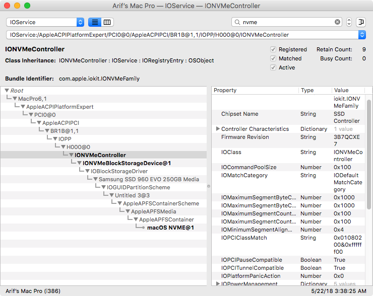

21 hours ago, adamshahcatalys said:
Well, I recently installed a Nvme drive in my hackintosh and the speed is lacking as compared to Windows. Do we need a proper ssdt or dsdt patch for it ?

@MaLd0n I am referring to this post of yours. These are the steps I did
1-Copied your text and pasted in MagiASL.
2-Hit Compile
3-Saved as ACPI Machine Language Binary File
4-Copied the saved file in Clover/ACPI/Patched
2-Hit Compile
not my post, nmano post a patch
u need check in ioreg what device u need apply a patch
