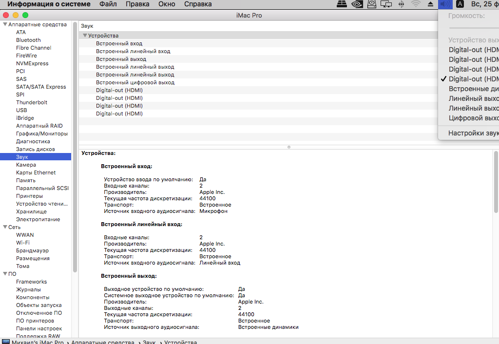

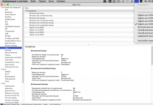

pitrysha Posted February 25, 2018 Share Posted February 25, 2018 MaLdon. The sleep mode is working. USB all work. HDMI no. Thanks. Архив.zip 1 Link to comment Share on other sites More sharing options...
MaLd0n Posted February 25, 2018 Share Posted February 25, 2018 MaLdon. The sleep mode is working. USB all work. HDMI no. Thanks. use it for usb 10.13 <dict> <key>Comment</key> <string>Change 15 port limit</string> <key>Disabled</key> <false/> <key>Find</key> <data> g32MEA== </data> <key>InfoPlistPatch</key> <false/> <key>MatchOS</key> <string>10.13.x</string> <key>Name</key> <string>com.apple.driver.usb.AppleUSBXHCIPCI</string> <key>Replace</key> <data> g32Mfw== </data> </dict> 10.13.4+ <dict> <key>Comment</key> <string>USB 10.13.4+ by PMHeart</string> <key>Disabled</key> <true/> <key>Find</key> <data> g32UDw+DlwQAAA== </data> <key>InfoPlistPatch</key> <false/> <key>MatchOS</key> <string>10.13.x</string> <key>Name</key> <string>com.apple.driver.usb.AppleUSBXHCI</string> <key>Replace</key> <data> g32UD5CQkJCQkA== </data> </dict> HDMI use it, voodoohda mod, work only with ur HDMI Audio VoodooHDA.kext.zip Link to comment Share on other sites More sharing options...
pitrysha Posted February 25, 2018 Share Posted February 25, 2018 MaLd0n. Thank you, you're a genius. Everything is working. Thank you very much. 2 Link to comment Share on other sites More sharing options...

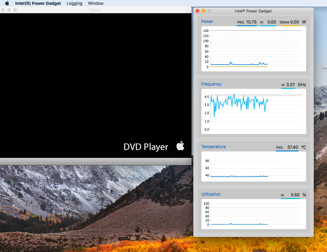

nmano Posted April 8, 2018 Author Share Posted April 8, 2018 (edited) there was an initialization error 70014-Fixed I'd love to have my 4.3 overclock, but I'll setting in clover config CPU FrequencyMHz is 4200 If I enter over 4200 is not work DVD player. FrequencyMHz 4200 IOAHCIBlockStorageInjector.kext.zip Edited April 8, 2018 by nmano 1 Link to comment Share on other sites More sharing options...

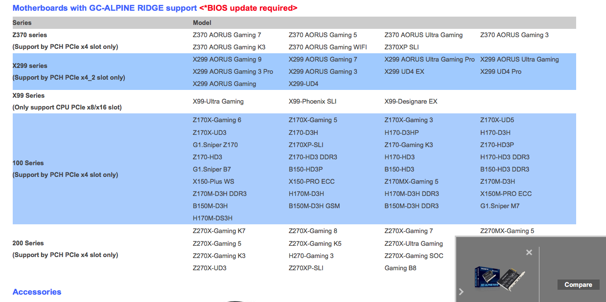

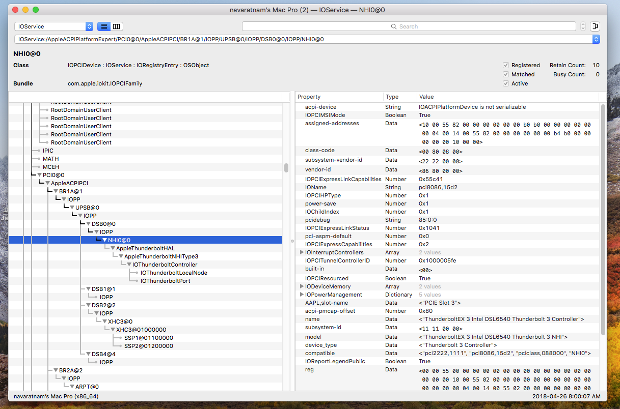

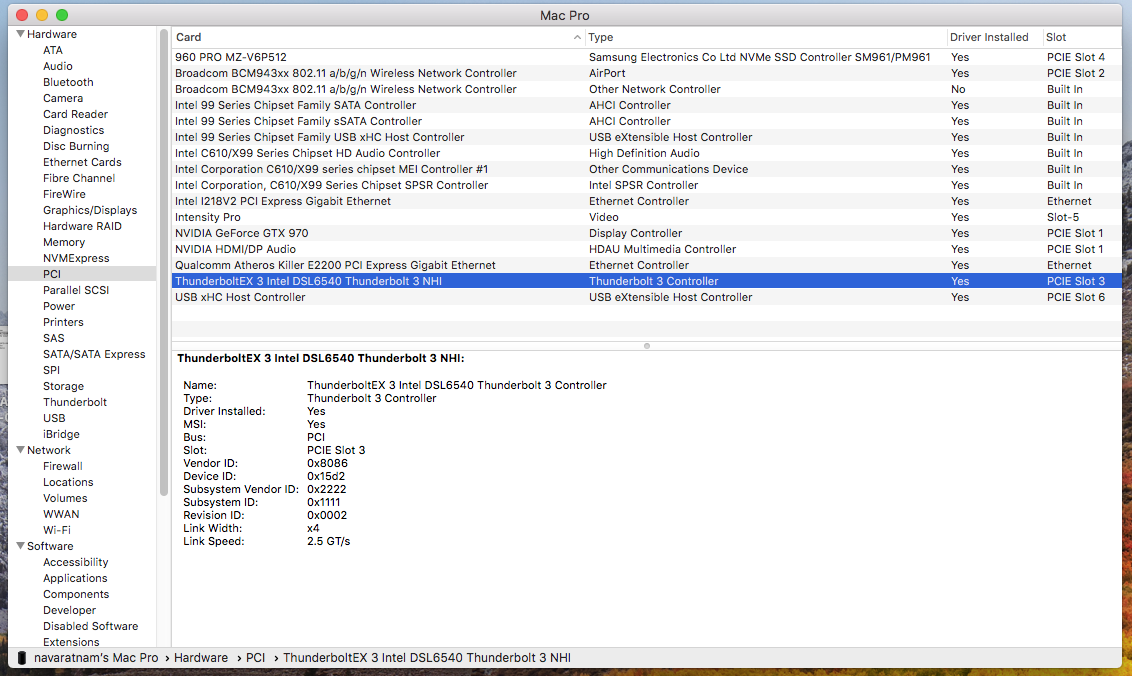

nmano Posted April 26, 2018 Author Share Posted April 26, 2018 X99 Series with GC-ALPINE RIDGE rev 2.0 My motherboard is not in this list.(X99 Gaming G1) but Its worked.I thing Mac driver its supported. I just install SSDT. https://www.insanelymac.com/applications/core/interface/file/attachment.php?id=297769 1 Link to comment Share on other sites More sharing options...
