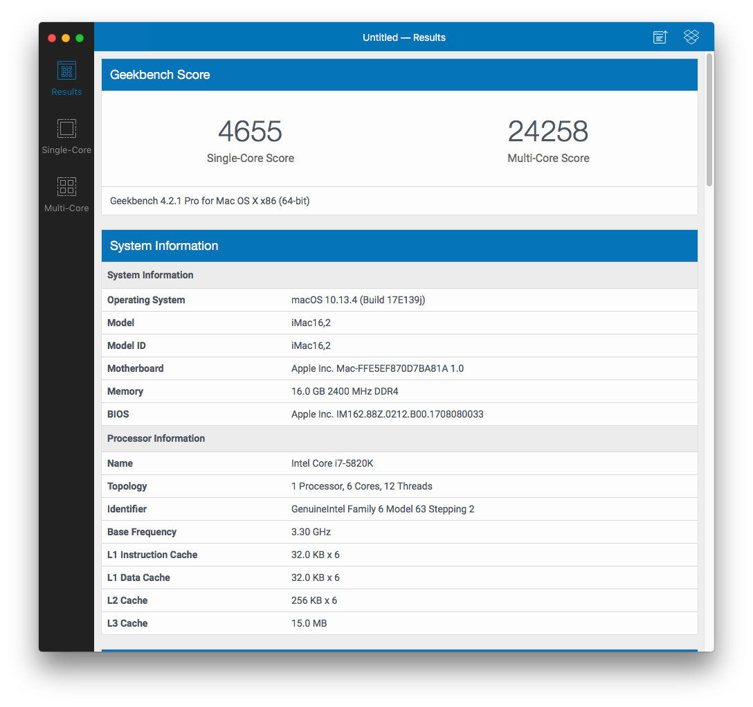

maxx7650 Posted January 27, 2018 Share Posted January 27, 2018 Following your thread about the geekbench score guys here I also get 36000 GB while I saw others with 41000 with same cpu xeons can t be overclocked that much so mine shold be there too. For XCPM loaded via cpu SSDT which option of frequency should i use of freqVectorsedit.sh? the cpu goes up to 3.8 but i never saw it hitting more then 3.6 Link to comment Share on other sites More sharing options...
adam_leve Posted January 27, 2018 Share Posted January 27, 2018 Yes, I am facing the same issue. 5820k's base clock is 3.3 and boost clock to 3.6 but it never reaches 3.6 even stress testing with Prime95. I may remind you that I am not using generated cpu SSDT. Is this the cause ? But, using the generated SSDt results in AE_not found, failing to load table found in Clover log. Link to comment Share on other sites More sharing options...

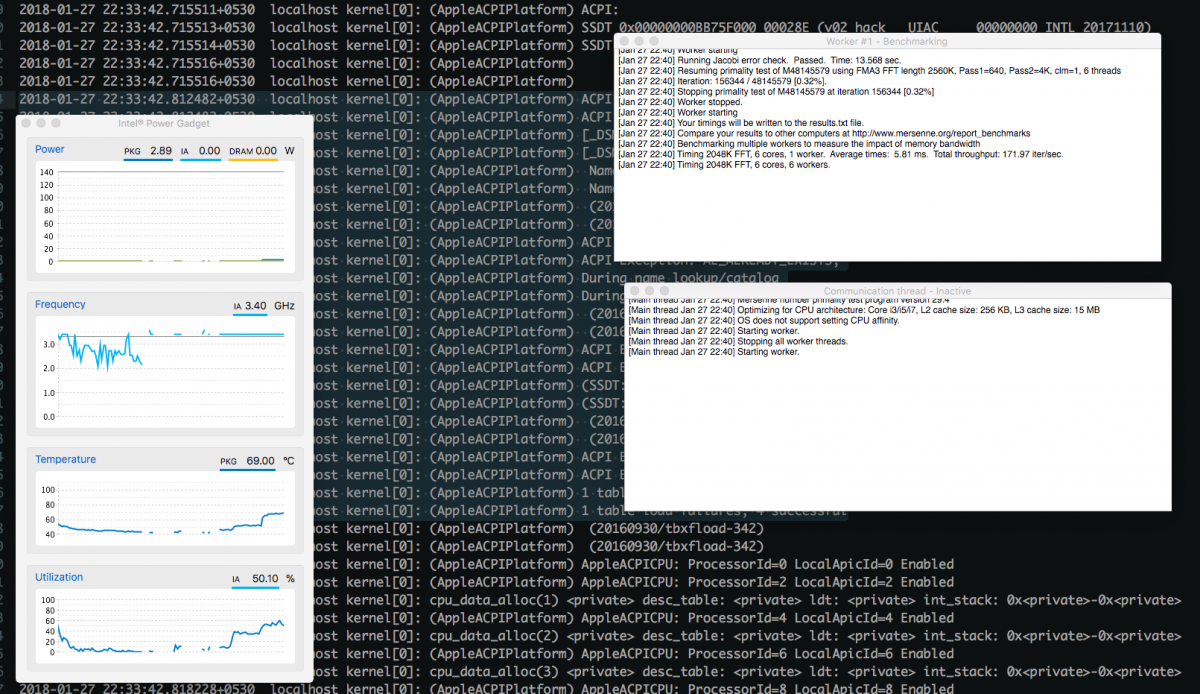

adam_leve Posted January 27, 2018 Share Posted January 27, 2018 use it for generate SSDT_Automator.zip With the generated SSDT above, I still can't reach turbo frequency. Here is the log error which says 2018-01-27 22:33:42.812482+0530 localhost kernel[0]: (AppleACPIPlatform) ACPI Error: 2018-01-27 22:33:42.812483+0530 localhost kernel[0]: (AppleACPIPlatform) ACPI Error: 2018-01-27 22:33:42.812485+0530 localhost kernel[0]: (AppleACPIPlatform) [_DSM] 2018-01-27 22:33:42.812485+0530 localhost kernel[0]: (AppleACPIPlatform) [_DSM] 2018-01-27 22:33:42.812487+0530 localhost kernel[0]: (AppleACPIPlatform) Namespace lookup failure, AE_ALREADY_EXISTS 2018-01-27 22:33:42.812487+0530 localhost kernel[0]: (AppleACPIPlatform) Namespace lookup failure, AE_ALREADY_EXISTS 2018-01-27 22:33:42.812490+0530 localhost kernel[0]: (AppleACPIPlatform) (20160930/dswload-462) 2018-01-27 22:33:42.812490+0530 localhost kernel[0]: (AppleACPIPlatform) (20160930/dswload-462) 2018-01-27 22:33:42.812492+0530 localhost kernel[0]: (AppleACPIPlatform) ACPI Exception: AE_ALREADY_EXISTS, 2018-01-27 22:33:42.812493+0530 localhost kernel[0]: (AppleACPIPlatform) ACPI Exception: AE_ALREADY_EXISTS, 2018-01-27 22:33:42.812494+0530 localhost kernel[0]: (AppleACPIPlatform) During name lookup/catalog 2018-01-27 22:33:42.812495+0530 localhost kernel[0]: (AppleACPIPlatform) During name lookup/catalog 2018-01-27 22:33:42.812496+0530 localhost kernel[0]: (AppleACPIPlatform) (20160930/psobject-310) 2018-01-27 22:33:42.812497+0530 localhost kernel[0]: (AppleACPIPlatform) (20160930/psobject-310) 2018-01-27 22:33:42.812573+0530 localhost kernel[0]: (AppleACPIPlatform) ACPI Exception: AE_ALREADY_EXISTS, 2018-01-27 22:33:42.812574+0530 localhost kernel[0]: (AppleACPIPlatform) ACPI Exception: AE_ALREADY_EXISTS, 2018-01-27 22:33:42.812577+0530 localhost kernel[0]: (AppleACPIPlatform) (SSDT: CpuPm) while loading table 2018-01-27 22:33:42.812578+0530 localhost kernel[0]: (AppleACPIPlatform) (SSDT: CpuPm) while loading table 2018-01-27 22:33:42.812580+0530 localhost kernel[0]: (AppleACPIPlatform) (20160930/tbxfload-319) 2018-01-27 22:33:42.812580+0530 localhost kernel[0]: (AppleACPIPlatform) (20160930/tbxfload-319) 2018-01-27 22:33:42.813974+0530 localhost kernel[0]: (AppleACPIPlatform) ACPI Error: 2018-01-27 22:33:42.813975+0530 localhost kernel[0]: (AppleACPIPlatform) ACPI Error: 2018-01-27 22:33:42.813976+0530 localhost kernel[0]: (AppleACPIPlatform) 1 table load failures, 4 successful 2018-01-27 22:33:42.813977+0530 localhost kernel[0]: (AppleACPIPlatform) 1 table load failures, 4 successful And the screenshot running Prime95 torture test. Link to comment Share on other sites More sharing options...

adam_leve Posted January 27, 2018 Share Posted January 27, 2018 DSDT.aml.zip Should I remove the SSDT and the plugin type option in config.plist ? DSDT.aml.zip Booted with the above DSDT, still the frequency doesn't reach 3.6 and results in the same error in boot. 2018-01-27 22:52:23.837254+0530 localhost kernel[0]: (AppleACPIPlatform) ACPI Exception: AE_ALREADY_EXISTS, 2018-01-27 22:52:23.837254+0530 localhost kernel[0]: (AppleACPIPlatform) ACPI Exception: AE_ALREADY_EXISTS, 2018-01-27 22:52:23.837257+0530 localhost kernel[0]: (AppleACPIPlatform) (SSDT: CpuPm) while loading table 2018-01-27 22:52:23.837258+0530 localhost kernel[0]: (AppleACPIPlatform) (SSDT: CpuPm) while loading table 2018-01-27 22:52:23.837260+0530 localhost kernel[0]: (AppleACPIPlatform) (20160930/tbxfload-319) 2018-01-27 22:52:23.837261+0530 localhost kernel[0]: (AppleACPIPlatform) (20160930/tbxfload-319) 2018-01-27 22:52:23.838652+0530 localhost kernel[0]: (AppleACPIPlatform) ACPI Error: 2018-01-27 22:52:23.838653+0530 localhost kernel[0]: (AppleACPIPlatform) ACPI Error: 2018-01-27 22:52:23.838654+0530 localhost kernel[0]: (AppleACPIPlatform) 1 table load failures, 4 successful 2018-01-27 22:52:23.838655+0530 localhost kernel[0]: (AppleACPIPlatform) 1 table load failures, 4 successful Link to comment Share on other sites More sharing options...

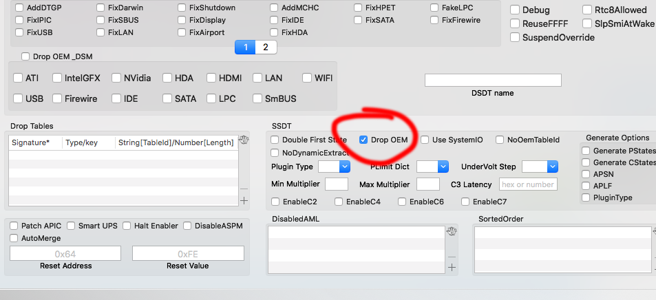

adam_leve Posted January 27, 2018 Share Posted January 27, 2018 u drop all oem tables? MaLd0n 2018-01-27 às 15.29.31.png u need check if ur mobo have MSR locked about errors, u can ignore Why drop all OEM tables if I am not patching all the SSDT of OEM ? I have flashed a modded firmware to unlock the MSR, but how to verify that ? Link to comment Share on other sites More sharing options...
MaLd0n Posted January 27, 2018 Share Posted January 27, 2018 x99 u can use only DSDT, dont have and dependency from other OEM table Link to comment Share on other sites More sharing options...
