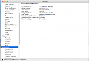

X99 Mac osx 10.13

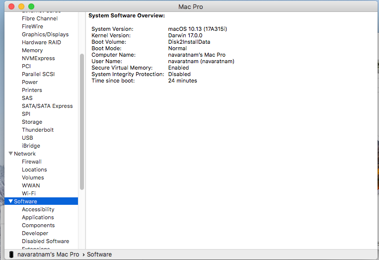

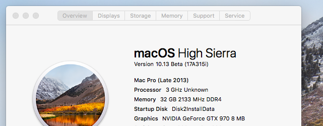

First of all you'll need to have Install macOS 10.13 Beta.app in your Applications folder.
Then, you'll need to right click it and then go to Show Package Contents/Contents/Shared Support and from there mount InstallESD.dmg.
Once mounted there you'll find Packages folder and inside Core.pkg.
Double click Core.pkg and this will install macOS to desired partition, SSD or HDD.
Once done, mount BaseSystem.dmg and then copy System/Library/CoreServices/boot.efi and paste it to the same location System/Library/CoreServices/boot.efi   on the installed drive.
 Boot it with your existing Clover and in few seconds you'll reach desktop screen.
Thank you. Clover team and Apple ALC and others naveedamad,

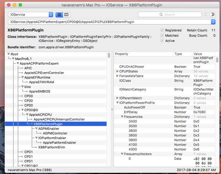

Last login: Thu Jul 27 14:38:58 on console
navaratnams-Pro:~ navaratnam$ sudo chown -R root:wheel /Users/navaratnam/Desktop/AppleIntelInfo.kext
Password:
navaratnams-Pro:~ navaratnam$ sudo chmod -R 755 /Users/navaratnam/Desktop/AppleIntelInfo.kext
navaratnams-Pro:~ navaratnam$ sudo kextload /Users/navaratnam/Desktop/AppleIntelInfo.kext

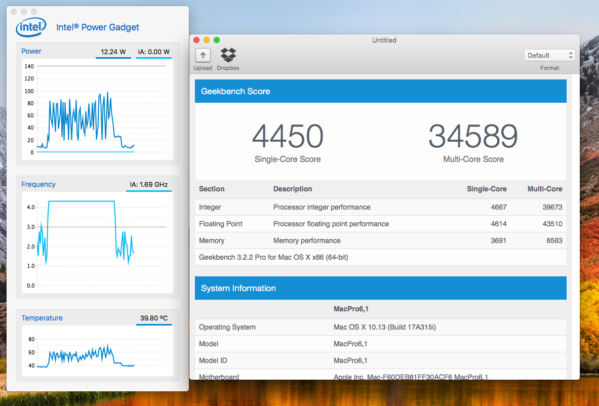

navaratnams-Pro:~ navaratnam$ sudo cat /tmp/AppleIntelInfo.dat
AppleIntelInfo.kext v2.0 Copyright © 2012-2016 Pike R. Alpha. All rights reserved
enableHWP................................: 0
Settings:
logMSRs..................................: 1
logIGPU..................................: 0
logCStates...............................: 1
logIPGStyle..............................: 1
InitialTSC...............................: 0xe512306e128e (8395 MHz)
MWAIT C-States...........................: 8480
Processor Brandstring....................: Intel(R) Core(TM) i7-5960X CPU @ 3.00GHz
Processor Signature..................... : 0x306F2
 - Family............................... : 6
 - Stepping............................. : 2
 - Model................................ : 0x3F (63)
Model Specific Registers (MSRs)
MSR_CORE_THREAD_COUNT............(0x35)  : 0x1E
 - Core Count........................... : 8
 - Thread Count......................... : 16
MSR_PLATFORM_INFO................(0xCE)  : 0x80C3BF3811E00
 - Maximum Non-Turbo Ratio.............. : 0x1E (3000 MHz)
 - Ratio Limit for Turbo Mode........... : 1 (programmable)
 - TDP Limit for Turbo Mode............. : 1 (programmable)
 - Low Power Mode Support............... : 1 (LPM supported)
 - Number of ConfigTDP Levels........... : 1 (additional TDP level(s) available)
 - Maximum Efficiency Ratio............. : 12
 - Minimum Operating Ratio.............. : 8
MSR_PMG_CST_CONFIG_CONTROL.......(0xE2)  : 0x7E000403
 - I/O MWAIT Redirection Enable......... : 1 (enabled, IO read of MSR(0xE4) mapped to MWAIT)
 - CFG Lock............................. : 0 (MSR not locked)
 - C3 State Auto Demotion............... : 1 (enabled)
 - C1 State Auto Demotion............... : 1 (enabled)
 - C3 State Undemotion.................. : 1 (enabled)
 - C1 State Undemotion.................. : 1 (enabled)
 - Package C-State Auto Demotion........ : 1 (enabled)
 - Package C-State Undemotion........... : 1 (enabled)
MSR_PMG_IO_CAPTURE_BASE..........(0xE4)  : 0x10414
 - LVL_2 Base Address................... : 0x414
 - C-state Range........................ : 1 (C6 is the max C-State to include)
IA32_MPERF.......................(0xE7)  : 0x2308028639
IA32_APERF.......................(0xE8)  : 0x26137394DB
MSR_FLEX_RATIO...................(0x194) : 0xE0000
MSR_IA32_PERF_STATUS.............(0x198) : 0x280400000C00
 - Current Performance State Value...... : 0xC00 (1200 MHz)
MSR_IA32_PERF_CONTROL............(0x199) : 0xFF00
 - Target performance State Value....... : 0xFF00 (25500 MHz)
 - Intel Dynamic Acceleration........... : 0 (IDA engaged)
IA32_CLOCK_MODULATION............(0x19A) : 0x0
IA32_THERM_INTERRUPT.............(0x19B) : 0x0
IA32_THERM_STATUS................(0x19C) : 0x883C0000
 - Thermal Status....................... : 0
 - Thermal Log.......................... : 0
 - PROCHOT # or FORCEPR# event.......... : 0
 - PROCHOT # or FORCEPR# log............ : 0
 - Critical Temperature Status.......... : 0
 - Critical Temperature log............. : 0
 - Thermal Threshold #1 Status.......... : 0
 - Thermal Threshold #1 log............. : 0
 - Thermal Threshold #2 Status.......... : 0
 - Thermal Threshold #2 log............. : 0
 - Power Limitation Status.............. : 0
 - Power Limitation log................. : 0
 - Current Limit Status................. : 0
 - Current Limit log.................... : 0
 - Cross Domain Limit Status............ : 0
 - Cross Domain Limit log............... : 0
 - Digital Readout...................... : 60
 - Resolution in Degrees Celsius........ : 1
 - Reading Valid........................ : 1 (valid)
MSR_THERM2_CTL...................(0x19D) : 0x0
IA32_MISC_ENABLES................(0x1A0) : 0x850089
 - Fast-Strings......................... : 1 (enabled)
 - FOPCODE compatibility mode Enable.... : 0
 - Automatic Thermal Control Circuit.... : 1 (enabled)
 - Split-lock Disable................... : 0
 - Performance Monitoring............... : 1 (available)
 - Bus Lock On Cache Line Splits Disable : 0
 - Hardware prefetch Disable............ : 0
 - Processor Event Based Sampling....... : 0 (PEBS supported)
 - GV1/2 legacy Enable.................. : 0
 - Enhanced Intel SpeedStep Technology.. : 1 (enabled)
 - MONITOR FSM.......................... : 1 (MONITOR/MWAIT supported)
 - Adjacent sector prefetch Disable..... : 0
 - xTPR Message Disable................. : 1 (disabled)
MSR_TEMPERATURE_TARGET...........(0x1A2) : 0x591200
 - Turbo Attenuation Units.............. : 0
 - Temperature Target................... : 89
 - TCC Activation Offset................ : 0
MSR_MISC_PWR_MGMT................(0x1AA) : 0x400000
 - EIST Hardware Coordination........... : 0 (hardware coordination enabled)
 - Energy/Performance Bias support...... : 1
 - Energy/Performance Bias.............. : 0 (disabled/MSR not visible to software)
 - Thermal Interrupt Coordination Enable : 1 (thermal interrupt routed to all cores)
MSR_TURBO_RATIO_LIMIT............(0x1AD) : 0x2B2B2B2B2B2B2B2B
 - Maximum Ratio Limit for C01.......... : 2B (4300 MHz)
 - Maximum Ratio Limit for C02.......... : 2B (4300 MHz)
 - Maximum Ratio Limit for C03.......... : 2B (4300 MHz)
 - Maximum Ratio Limit for C04.......... : 2B (4300 MHz)
 - Maximum Ratio Limit for C05.......... : 2B (4300 MHz)
 - Maximum Ratio Limit for C06.......... : 2B (4300 MHz)
 - Maximum Ratio Limit for C07.......... : 2B (4300 MHz)
 - Maximum Ratio Limit for C08.......... : 2B (4300 MHz)
IA32_ENERGY_PERF_BIAS............(0x1B0) : 0x1
 - Power Policy Preference...............: 1 (highest performance)
MSR_POWER_CTL....................(0x1FC) : 0x21040059
 - Bi-Directional Processor Hot..........: 1 (enabled)
 - C1E Enable............................: 0 (disabled)
MSR_RAPL_POWER_UNIT..............(0x606) : 0xA0E03
 - Power Units.......................... : 3 (1/8 Watt)
 - Energy Status Units.................. : 14 (61 micro-Joules)
 - Time Units .......................... : 10 (976.6 micro-Seconds)
MSR_PKG_POWER_LIMIT..............(0x610) : 0x7FFD00014EA82
 - Package Power Limit #1............... : 3408 Watt
 - Enable Power Limit #1................ : 1 (enabled)
 - Package Clamping Limitation #1....... : 0 (disabled)
 - Time Window for Power Limit #1....... : 10 (2560 milli-Seconds)
 - Package Power Limit #2............... : 4090 Watt
 - Enable Power Limit #2................ : 1 (enabled)
 - Package Clamping Limitation #2....... : 1 (allow going below OS-requested P/T state setting Time Window for Power Limit #2)
 - Time Window for Power Limit #2....... : 3 (20 milli-Seconds)
 - Lock................................. : 0 (MSR not locked)
MSR_PKG_ENERGY_STATUS............(0x611) : 0x628157E
 - Total Energy Consumed................ : 6304 Joules (Watt = Joules / seconds)
MSR_PKG_POWER_INFO...............(0x614) : 0x1280460
 - Thermal Spec Power................... : 140 Watt
 - Minimum Power........................ : 0
 - Maximum Power........................ : 0
 - Maximum Time Window.................. : 0
MSR_PP0_POWER_LIMIT..............(0x638) : 0x14FFD0
 - Power Limit.......................... : 4090 Watt
 - Enable Power Limit................... : 1 (enabled)
 - Clamping Limitation.................. : 0 (disabled)
 - Time Window for Power Limit.......... : 10 (10240 milli-Seconds)
MSR_PP0_ENERGY_STATUS............(0x639) : 0x0
MSR_TURBO_ACTIVATION_RATIO.......(0x64C) : 0x0
MSR_CONFIG_TDP_NOMINAL...........(0x648) : 0x1E
MSR_CONFIG_TDP_LEVEL1............(0x649) : 0x940000001B0460
MSR_CONFIG_TDP_LEVEL2............(0x64a) : 0x94000000000000
MSR_CONFIG_TDP_CONTROL...........(0x64b) : 0x0
MSR_TURBO_ACTIVATION_RATIO.......(0x64c) : 0x0
MSR_PKGC6_IRTL...................(0x60b) : 0x0
MSR_PKG_C2_RESIDENCY.............(0x60d) : 0x1F5349EC84
MSR_PKG_C3_RESIDENCY.............(0x3f8) : 0x1FB600C
MSR_PKG_C6_RESIDENCY.............(0x3f9) : 0x8157003B82
IA32_TSC_DEADLINE................(0x6E0) : 0xE5123B05752C
CPU Ratio Info:
Base Clock Frequency (BLCK)............. : 100 MHz
Maximum Efficiency Ratio/Frequency.......: 12 (1200 MHz)
Maximum non-Turbo Ratio/Frequency........: 30 (3000 MHz)
Maximum Turbo Ratio/Frequency............: 43 (4300 MHz)
P-State ratio * 100 = Frequency in MHz
CPU P-States [ (12) 35 ]
CPU C3-Cores [ 0 4 6 9 11 14 ]
CPU C6-Cores [ 0 2 4 6 8 10 12 14 ]
CPU P-States [ (12) 23 35 ]
CPU C3-Cores [ 0 1 4 6 8 9 11 14 ]
CPU C6-Cores [ 0 2 4 6 8 9 10 12 14 ]
CPU P-States [ (12) 23 32 35 ]
CPU C3-Cores [ 0 1 4 6 8 9 11 14 15 ]
CPU P-States [ 12 23 26 32 35 (43) ]
CPU C3-Cores [ 0 1 4 6 8 9 10 11 14 15 ]
CPU P-States [ (12) 20 23 26 32 35 43 ]
CPU P-States [ (12) 20 23 26 32 35 39 43 ]
CPU P-States [ (12) 20 23 24 26 32 35 39 43 ]
CPU C3-Cores [ 0 1 4 6 7 8 9 10 11 14 15 ]
CPU P-States [ 12 20 23 24 (25) 26 32 35 39 43 ]
CPU P-States [ (12) 20 23 24 25 26 27 32 35 39 43 ]
CPU C6-Cores [ 0 1 2 4 6 8 9 10 12 14 ]
CPU P-States [ (12) 20 23 24 25 26 27 32 34 35 39 43 ]
CPU C6-Cores [ 0 1 2 4 6 8 9 10 12 14 15 ]
CPU C3-Cores [ 0 1 4 5 6 7 8 9 10 11 14 15 ]
CPU P-States [ (12) 20 23 24 25 26 27 31 32 34 35 39 43 ]
CPU P-States [ (12) 20 23 24 25 26 27 28 31 32 34 35 39 43 ]
CPU P-States [ 12 18 20 (21) 23 24 25 26 27 28 31 32 34 35 39 43 ]
CPU P-States [ (12) 18 20 21 23 24 25 26 27 28 30 31 32 34 35 39 43 ]
CPU P-States [ (12) 16 18 20 21 23 24 25 26 27 28 30 31 32 34 35 39 43 ]
CPU P-States [ (12) 16 18 20 21 22 23 24 25 26 27 28 30 31 32 34 35 39 43 ]

Can I know how to fix unknown CPU
I try with clover type 2561 not work
Unknown CPU Fixed
About this Mac unknown cpu error fixed.
Thius patched worked Haswell-E CPU and  Broadwell CPU
1-Enable in config xcpm_bootstrap_Broadwell or Haswell
2-Enable in config xcpm_cpuid_set_infoBroadwell or Haswell
3-FakeCPUID is Broadwell 0x040674
4.CPU Type is Broadwell 0x0a02
5-FakeCPUID is Haswell 0x0306F2
6.CPU Type is Haswell 0x0a01
XCPM Brodwell and Haswell.zip

I edit freqVectors 3400 to 4300
X86PlatformPlugin.kext/Contents/Resources/
Replace: /System/Library/Extensions/IOPlatformPluginFamily.kext/Contents/PlugIns//Resources
The target plist (example: Mac-F60DEB81FF30ACF6.plist for the MacPro6,1) is selected based on the used board-id.
Try Pike R. Alpha /freqVectorsEdit.sh then replace this file.
Thanks pike.
Mac-F60DEB81FF30ACF6.plist.zip
  • Like 3
Could you explain better what this modify plist can do?
This below I mean...
Thank you
<key>Frequencies</key>
		<dict>
			<key>3400</key>
			<integer>0</integer>
			<key>3500</key>
			<integer>1</integer>
			<key>3600</key>
			<integer>2</integer>
			<key>3800</key>
			<integer>3</integer>
			<key>3900</key>
			<integer>4</integer>
			<key>4100</key>
			<integer>5</integer>
			<key>4300</key>
			<integer>6</integer>
		</dict>
Apple FrequencyVectors only supported Frequencies High is 4100
Still they don’t support FrequencyVectors 4300
My system I overclock to 4300
Thats why we need edit.
