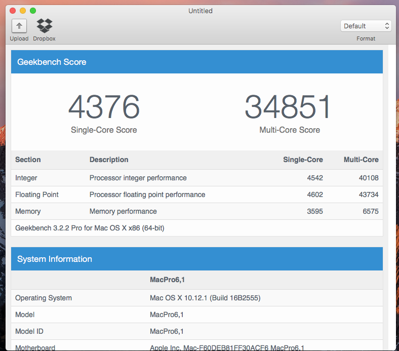

X99_with Gigabyte
BIOS Configuration for XCPM
CPU Clock Ratio: 43x
XMP: profile 1
Uncore Ratio: 40x or 43x
C1E: Disabled
C6/C7: Enabled
CPU Thermal Monitor: Auto
C3: auto
EIST: Enabled

Also CPU-S only recognizes lowest multiplier and turbo (without the XCPM patch mentioned above, I get base 3500Mhz as well):

No congratulations. I'm still having CPU PM problems (missing power stepping)!!!
AppleALC. I'll switch over to your dummy kext tomorrow. Just want to be 100% sure it's the XCPM patch causing the freezes.
As far as performance, with the patch, it's relatively the same (as shown above). However, I noticed that it doesn't really idle (frequency spiking between 1.70ghz-2.95ghz || power hovers around 15W-17W //// without the patch, frequency stays between 1.45ghz-1.90ghz and power hovers around 12w-13w -- in other words, missing a base stepping frequency of 3.5hz):
Oops I'm a little confused...  :(
So.
With the patch. You can't idle.
Without the patch. You can. But. You will got popping sound etc and you cannot get a high performance.
Is above right?

The problem isn't so much the popping sound, but the fact that it locks up the entire computer and I have to hard reset it.
Got a loud popping sound, then my computer froze (no KP). No crash reports in console.  :(
Yes. However, I recommend not to use EIST in BIOS. I tested with it and found that it only achieved slightly above low scores (~15k for my CPU).
I have EIST enabled in bios with that patch in config and i've high scores too, but maybe it's because i've a different CPU i don't need to overclock.
Yep that's also what I mean  :P
Anyway, potential issues... Need further testing and.. waiting for it!
As I suspected, it was the missing XCPM patch (without it, not stable). No more popping/freezing. Also, switched over to AppleHDA dummy kext.

Can you do me a favor and run a Geekbench 4.04 test. I'm curious if you're getting full CPU PM.
