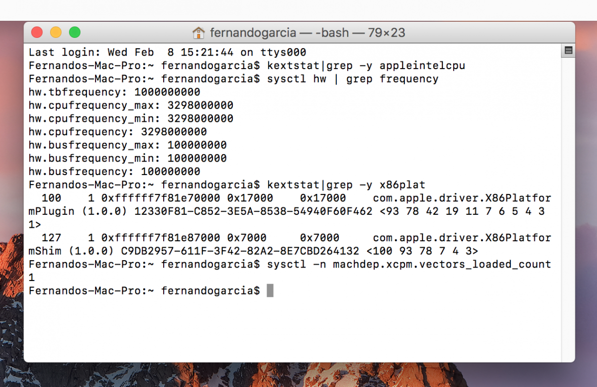

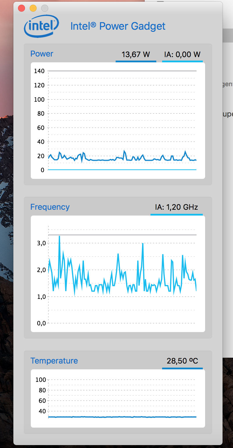

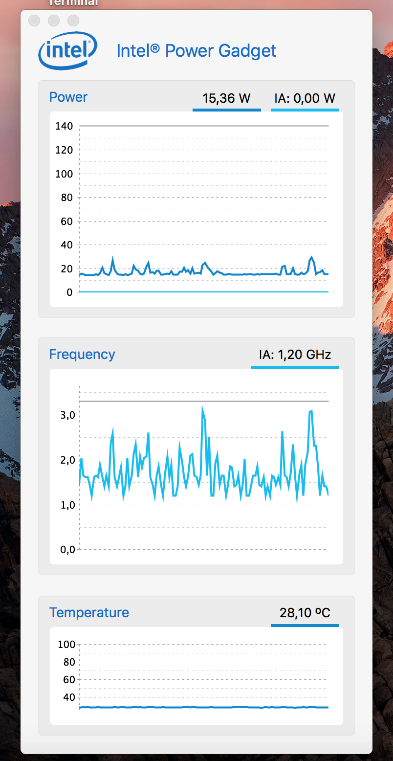

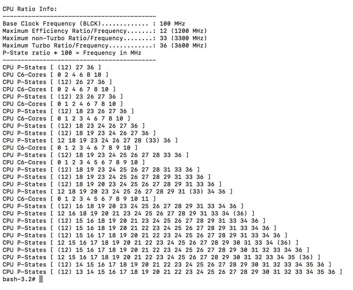

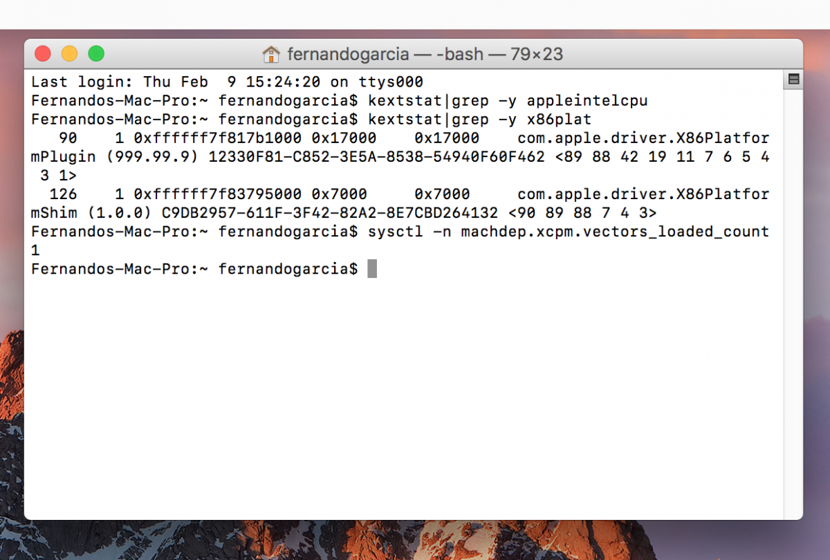

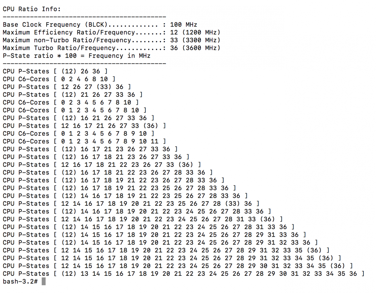

PMheart Posted February 9, 2017 Share Posted February 9, 2017 MP61_freqV_w_iMac171.kext ^^^ Is this injecting frequency vectors? Peaking at the code... it looks like it... so I'm assuming this is mainly to persist across updates? Yes. The injector mainly targets at injecting FrequencyVectors on-the-fly. Does this require a minimum clover efi v2 version (currently running r3859). No 1 Link to comment Share on other sites More sharing options...

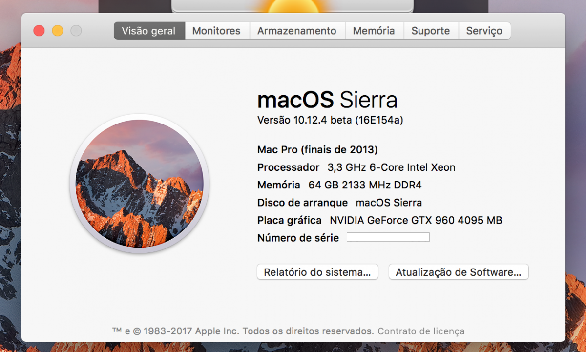

Fergarth Posted February 9, 2017 Share Posted February 9, 2017 Finished the update for Sierra 12.4 beta 2 (16E154a) and Clover r4003.Everything works fine and stable except for NvidiaWebDrive. With the plist edited for 16E it recognizes the graphic card and has some resolutions, but without full acceleration...PMheart, as you suggested, I installed your MP61_freqV_w_iMac171.kext on SLE and erased it on Clover. And now it seems to me that it's your kext that's running the FreqVectors. I installed it before the OS update and yes, it survived Thanks friend 2 Link to comment Share on other sites More sharing options...

PMheart Posted February 10, 2017 Share Posted February 10, 2017 Finished the update for Sierra 12.4 beta 2 (16E154a) and Clover r4003. Everything works fine and stable except for NvidiaWebDrive. With the plist edited for 16E it recognizes the graphic card and has some resolutions, but without full acceleration... PMheart, as you suggested, I installed your MP61_freqV_w_iMac171.kext on SLE and erased it on Clover. And now it seems to me that it's your kext that's running the FreqVectors. I installed it before the OS update and yes, it survived Thanks friend Congratulations Fergarth! 1 Link to comment Share on other sites More sharing options...
