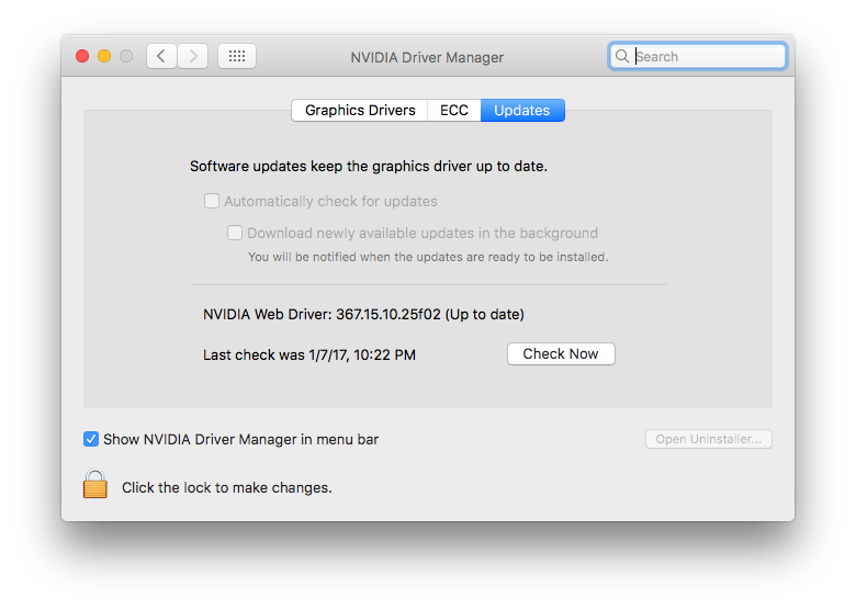

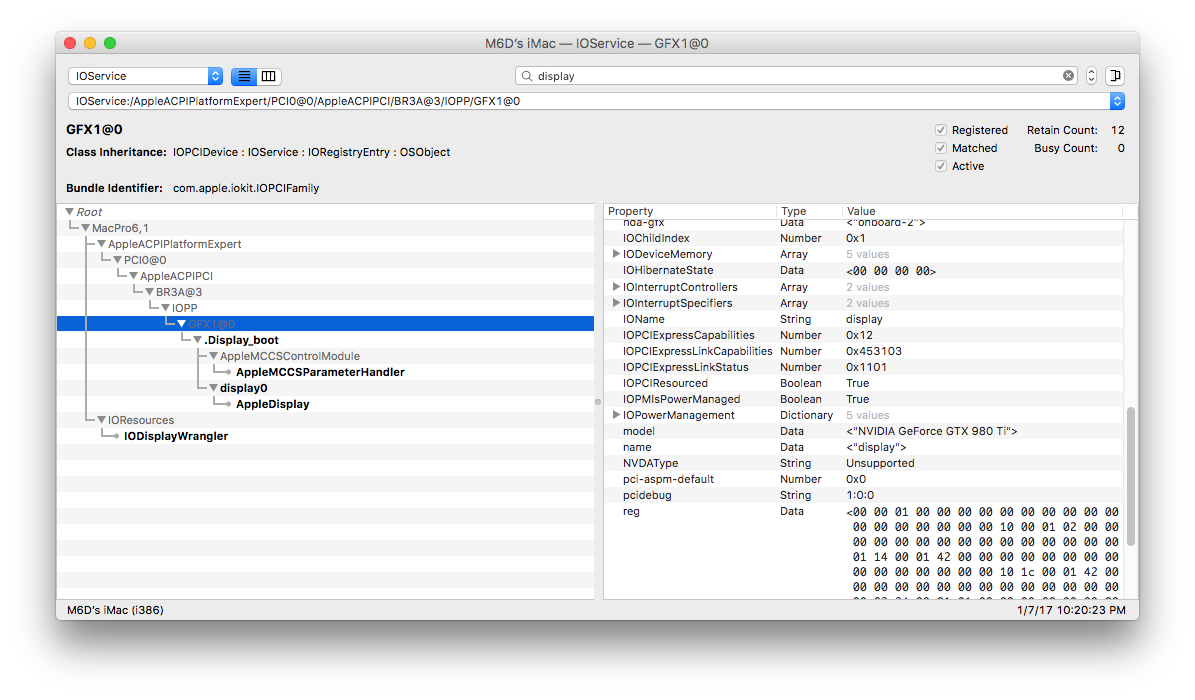

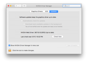

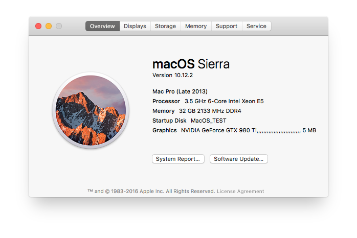

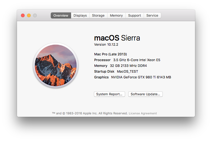

Injected my 980 TI into the DSDT, renamed GX0 to GFX1, then recompiled. Running 367.15.10.25f02 and... Unfortunately, it looks like the 980 TI isn't supported by the current 10.12.2 nvidia driver.
Getting terrible GFX performance and screen resolution is locked at 1280x1024
