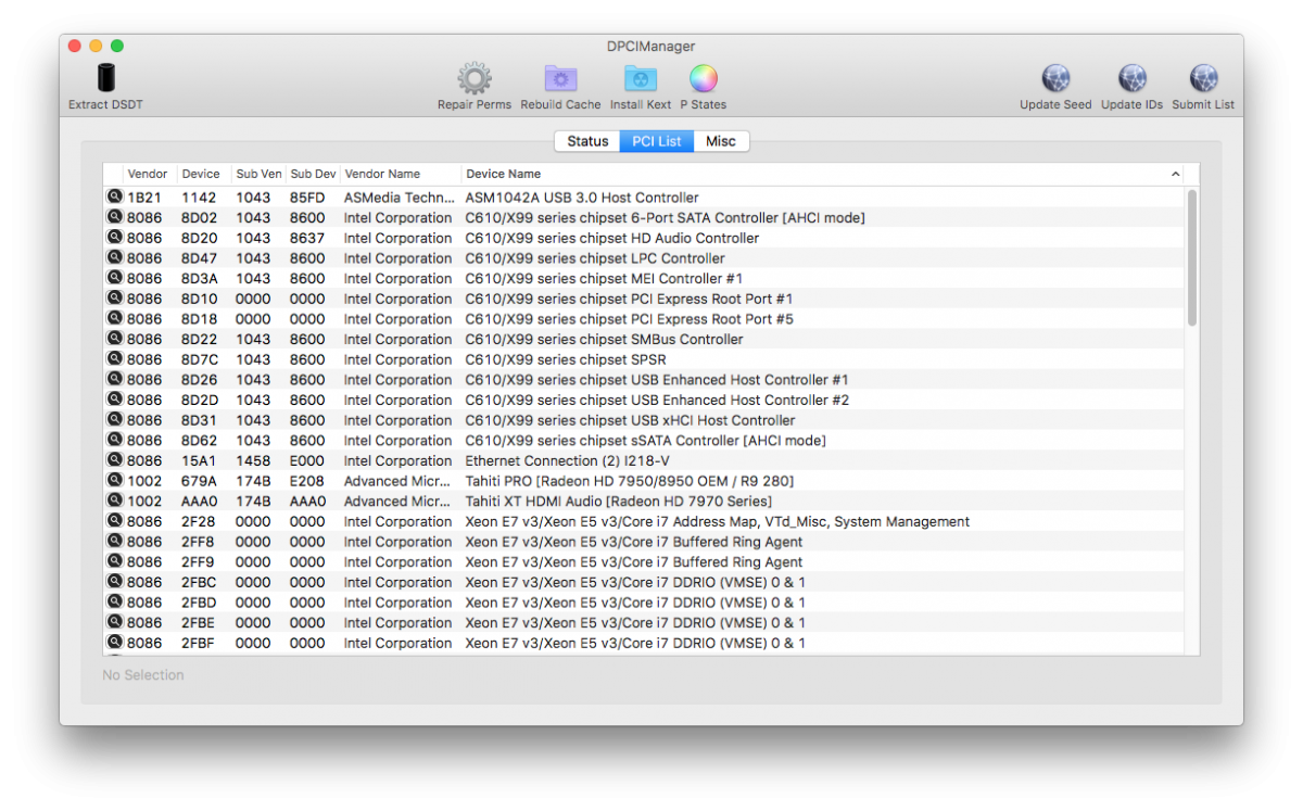

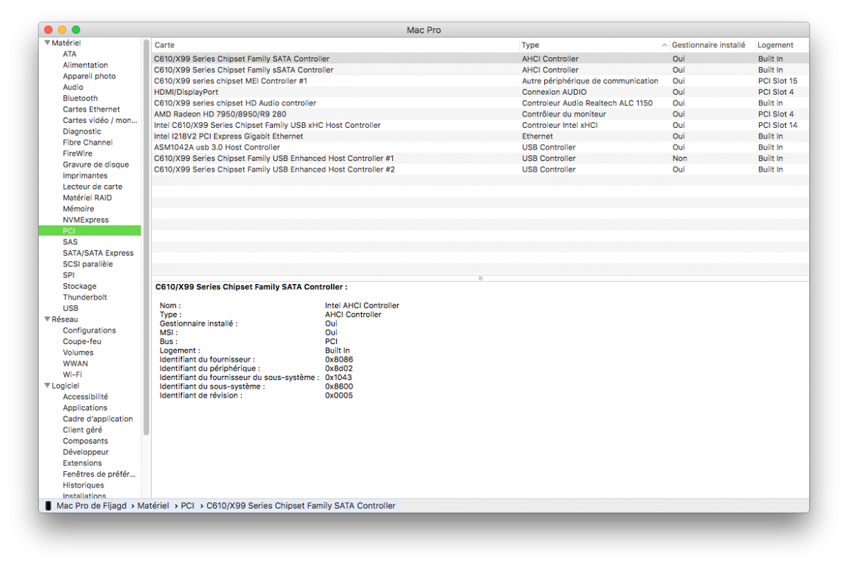

Fljagd Posted December 30, 2016 Share Posted December 30, 2016 I wanted to thank for the patches (@nmano, @SammlerG, And all others)I, through you, finished my DSDT as I wished Wishing you all a happy New Year Mac Pro de Fljagd.zip DSDTori.aml.zip DSDT.aml.zip 2 Link to comment Share on other sites More sharing options...

Fljagd Posted December 31, 2016 Share Posted December 31, 2016 Here are the patches with adaptation, which I used for my Asus X99-A Edit :The GFXanddHDMI patch is not good Here is the patch rectifier GFXandHDAU(HDMI).zip 1 Link to comment Share on other sites More sharing options...

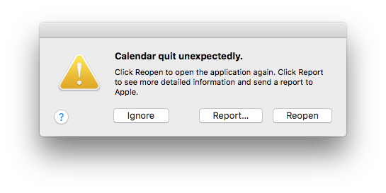

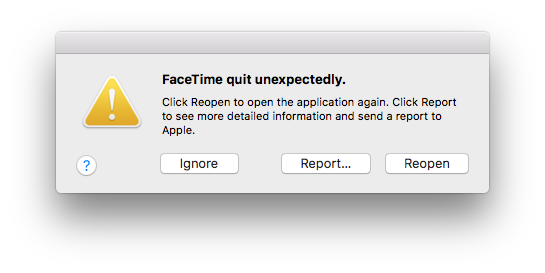

mfc88 Posted January 1, 2017 Share Posted January 1, 2017 Got 10.12.2... SOMEWHAT working. Unfortunately, all these system apps won't load and continually crash... Tried: - repairing permissions - no change - disk utility first aid - no change Did a fresh install: - Used AGDP fix and nmano patch, but it fake loaded the nvidia driver - Removed nmano's patch, got into desktop, changed refresh rate from 60hz to 75hz and the screen lost signal and I couldn't get it back after multiple reboots/iGPU starts Link to comment Share on other sites More sharing options...

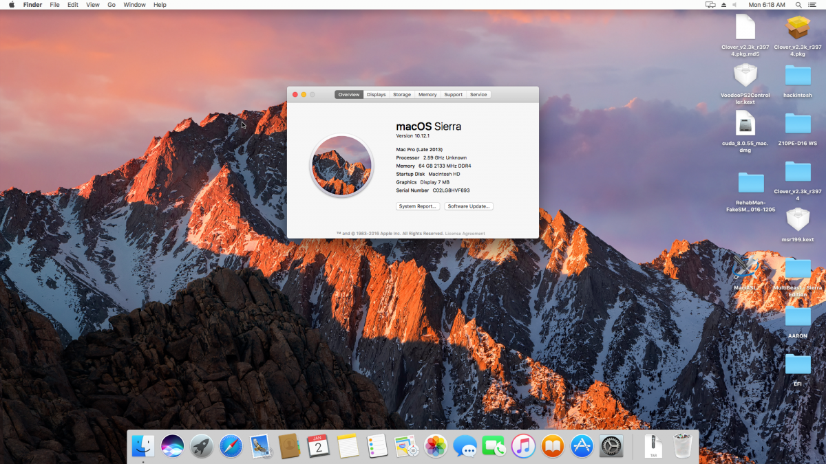

c4n001 Posted January 2, 2017 Share Posted January 2, 2017 (edited) @favlex you are in the right place! everyone with x99 seems to be accomplishing installations and stability. @fabiosun @okrasit I finally managed to install 10.12.1!, seems like all the nvram problem was a missmatch from clover and osx versions (noob guess), thank you so much for your guidance, it was such a pain, i had to use 2 different efi/clover/kext combinations for usb system installing and post-install system boot (USB EFI attached, System's EFI @fabiosun's with just msr199.kext patched to match E5 2690 V4's max OC frequency)) @fabiosun one last thing, how u managed to get the cpu name and the pci tables recognized? cant find a working dsdt and i dont know if i can do the heavy (seems very heavy) lifting of building one, also have u got the built-in audio working? have an excellent 2017 start forgot: installed macOS 10.12.1 (16B2659) EFI (USB Installer) Clover v2.3k 3961.zip Edited January 2, 2017 by c4n001 1 Link to comment Share on other sites More sharing options...
