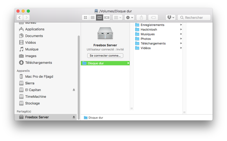

it's possible to connect Apple TV to X99 system?
Hi, nmano
I think it's possible by RJ45 and enable Server connected in prefs Finder

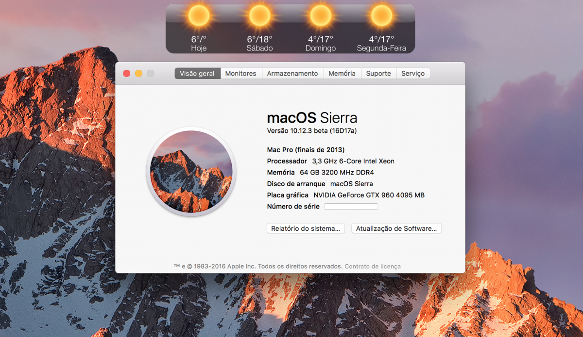

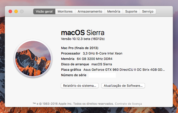

Hi friend nmano, I have the GTX 960 connected through DP, but it should be the same thing.
I'm using the latest NVIDIA Alternate Graphics Drivers.
For macOS 10.12.2 (16C68)
https://images.nvidi...15.10.25f02.pkg
or macOS 10.12.2 (16C67)
http://www.nvidia.co...px/113889/en-us
They work well too in versions 12.3 Beta (16D12b) and 12.3 Beta (16D17a).
But you have to change the NVDAStartupWeb.kext Info.plist from 16C to 16D and the previous Web Driver 12.2 works perfectly with 12.3 Betas.
When I had Sierra 12.2 installed, with the MacAISL, I changed in DSDT all names GFX0 to GFX1 and I already did two updates after that without black screens and no need to apply patches to AppleGraphicsControl.kext or use nv_disable=1
I do not use any patches in config.plist (Kernel / KextToPatch) for graphics.​
In “Boot Arguments” I just only use this darkwake=0 npci=0x3000 and in “System Parameters” InjectSystemID NvidiaWeb.
This was what I did and in my case/on my hardware it turned out perfectly! (Thanks PMheart)
