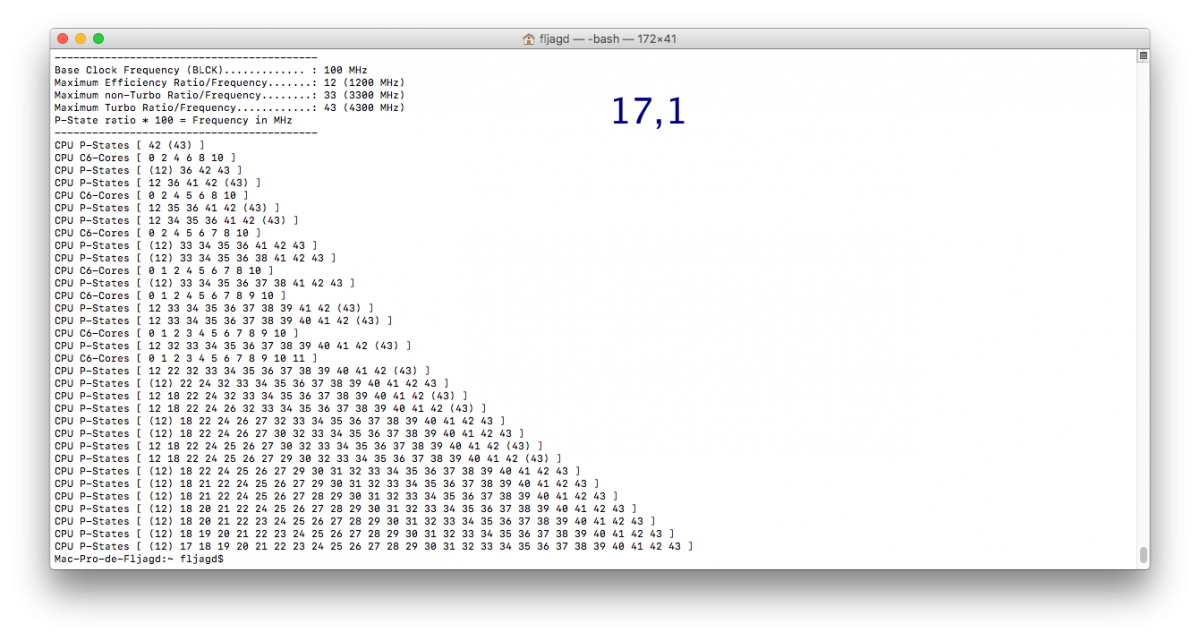

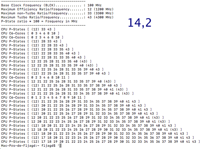

where I'm wrong?
in the bios:
EIST - Disabled
Turbo - Enabled
manual overclock 4200MHz
DDR4-2400MHz

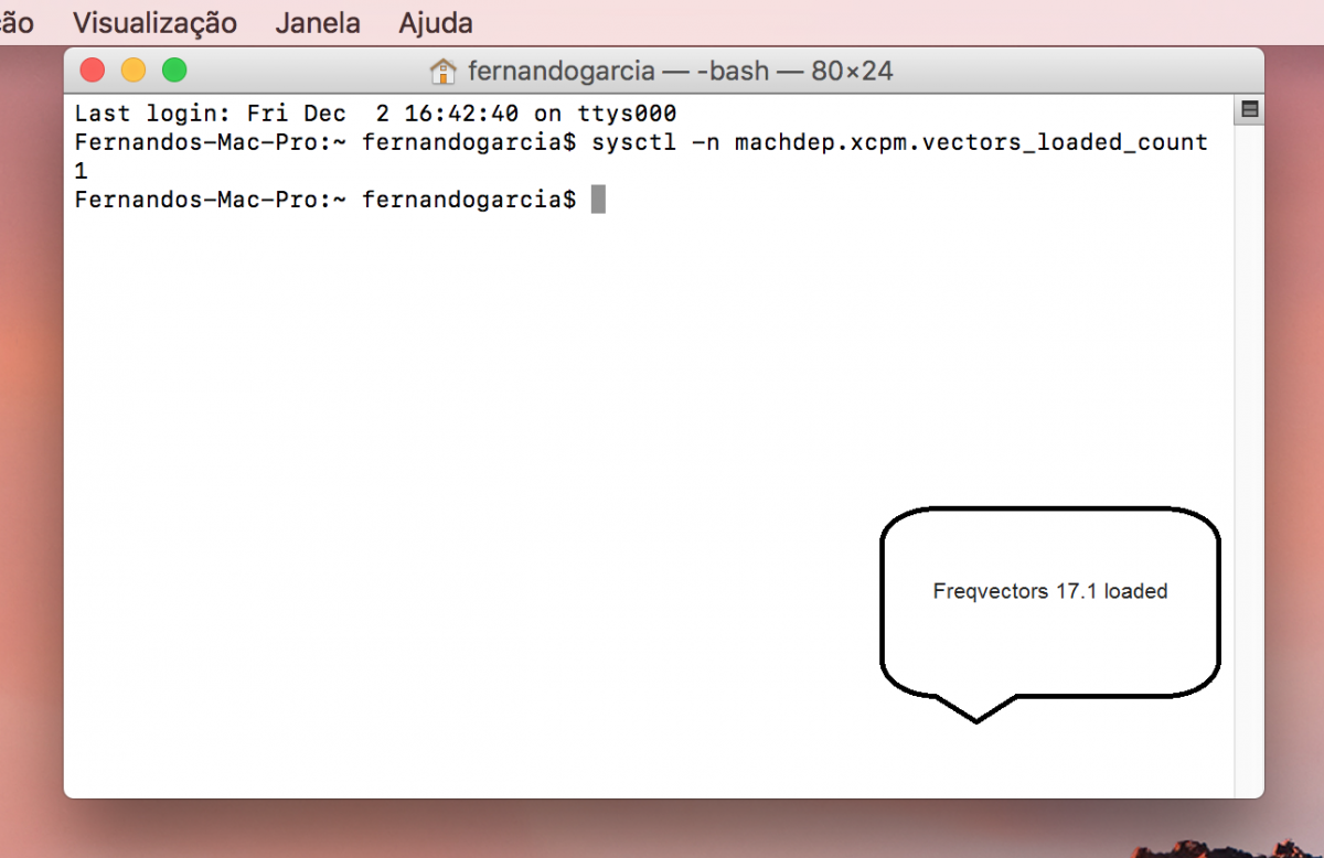

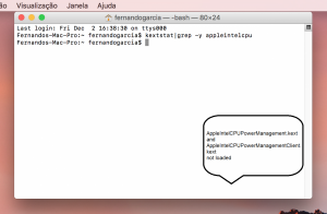

I can not properly configure the system.
I removed the AppleIntelCPUPowerManagement to activate the xcpm
where I'm wrong?
in the bios:
EIST - Disabled
Turbo - Enabled
DDR4-2400MHz
You shouldn't need to remove AppleIntelCPUPowerManagement in order to get proper stepping. Look at my config.plist in my posted EFI folder for the XCPM patches you'll need for your set up. Also, try switching your boot args to mine as well.
I'm also using Mac Pro 6,1 SMBIOS. You should do the same as well.
Also, make sure you're not getting any WARNINGS when generating the SSDT.
And, lastly, make sure you can get proper stepping with STOCK speeds before you decide to overclock.
Ok, I try immediately.
The strangest thing that happens is that the PC goes into kernel panic when I load the kext AppleIntelInfo and if I try to install Intel Power Gadget the program tells me that the CPU is not supported ... then there are all the read-write errors sandbox
If you do not have xCode yet, you have to download it from the Appstore and install it. After that you'll have to compile AppleInfoIntelKext.sh to your OS via xCode. And it's only after you do that that you can run the kext without KP. That was the way it was with me too. To install Intel Power Gadget without stress, you need to do it through Pacifist.app

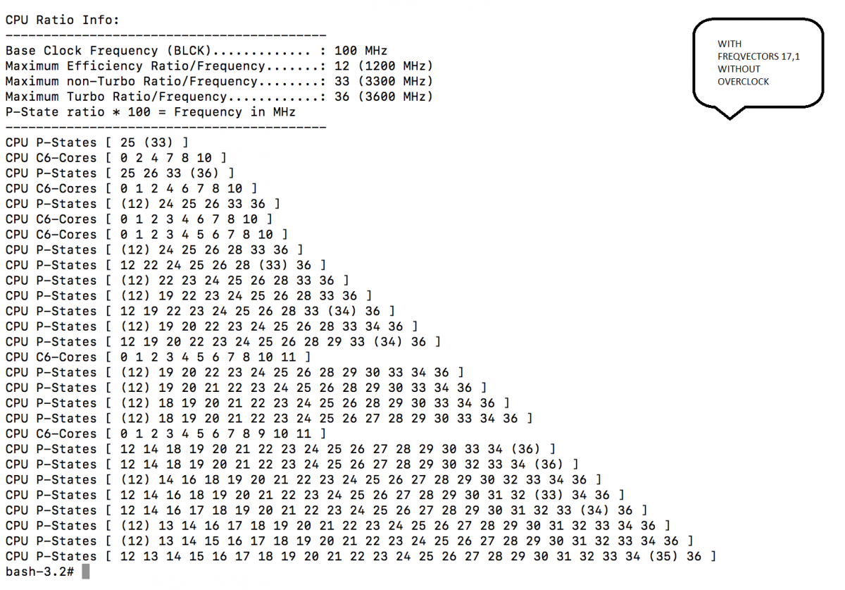

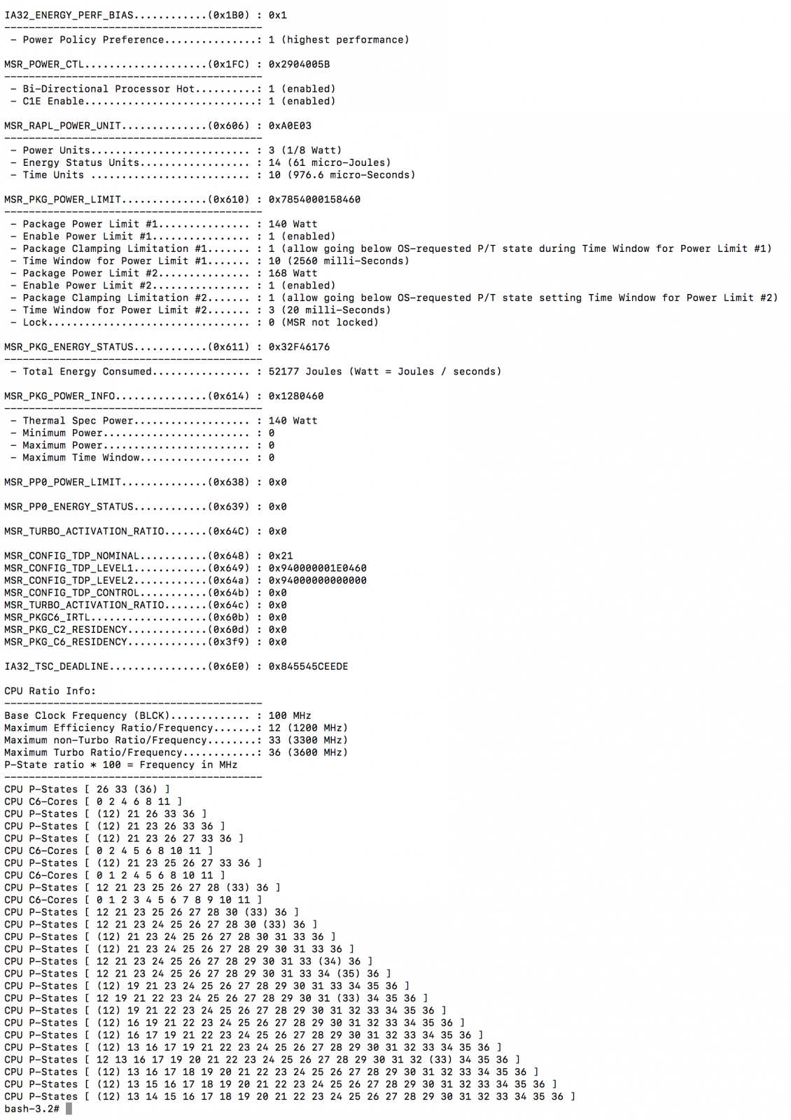

AppleIntelInfo log:
MSR_TURBO_RATIO_LIMIT............(0x1AD) : 0x2222222222222424
 - Maximum Ratio Limit for C01.......... : 24 (3600 MHz)
 - Maximum Ratio Limit for C02.......... : 24 (3600 MHz)
 - Maximum Ratio Limit for C03.......... : 22 (3400 MHz)
 - Maximum Ratio Limit for C04.......... : 22 (3400 MHz)
 - Maximum Ratio Limit for C05.......... : 22 (3400 MHz)
 - Maximum Ratio Limit for C06.......... : 22 (3400 MHz)
You'll want to set your AI Tuner Overclocker to Manual (so that you'll have "sync all cores," instead of some cores being @ 3.6 and @ 3.4), otherwise, it looks like you'll get proper stepping.
Next step would be to generate an overclocked SSDT and make sure it has the same amount of frequency steppings.

ACPI_SMC_PlatformPlugin::start - waitForService(resourceMatching(AppleIntelCPUPowerManagement) timed out
WARNING: IOPlatformPluginUtil : getCPUIDInfo: this is an unknown CPU model 0x3f
  -- power management may be incomplete or unsupported

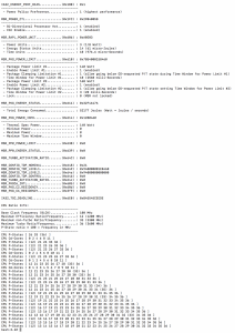

CPU Ratio Info:
Base Clock Frequency (BLCK)............. : 100 MHz
Maximum Efficiency Ratio/Frequency.......: 12 (1200 MHz)
Maximum non-Turbo Ratio/Frequency........: 33 (3300 MHz)
Maximum Turbo Ratio/Frequency............: 46 (4600 MHz)
P-State ratio * 100 = Frequency in MHz
CPU P-States [ 43 (46) ]
CPU C6-Cores [ 1 2 4 6 8 10 ]
CPU C6-Cores [ 0 1 2 3 4 6 8 10 ]
CPU P-States [ 43 44 (46) ]
CPU C6-Cores [ 0 1 2 3 4 6 8 10 11 ]
CPU P-States [ 41 43 44 (46) ]
CPU C6-Cores [ 0 1 2 3 4 6 7 8 10 11 ]
CPU C6-Cores [ 0 1 2 3 4 6 7 8 9 10 11 ]
CPU C6-Cores [ 0 1 2 3 4 5 6 7 8 9 10 11 ]
CPU P-States [ 40 41 43 44 (46) ]
CPU P-States [ (12) 40 41 43 44 45 46 ]
CPU P-States [ 12 37 40 41 43 44 45 (46) ]
CPU P-States [ (12) 37 38 40 41 43 44 45 46 ]
CPU P-States [ 12 30 37 38 40 41 43 44 45 (46) ]
CPU P-States [ (12) 30 36 37 38 40 41 43 44 45 46 ]
CPU P-States [ (12) 30 35 36 37 38 40 41 43 44 45 46 ]
CPU P-States [ (12) 30 35 36 37 38 40 41 42 43 44 45 46 ]
CPU P-States [ 12 30 35 36 37 38 39 40 41 42 43 44 45 (46) ]
CPU P-States [ 12 30 34 35 36 37 38 39 40 41 42 43 44 45 (46) ]
CPU P-States [ (12) 30 32 34 35 36 37 38 39 40 41 42 43 44 45 46 ]
CPU P-States [ (12) 30 32 33 34 35 36 37 38 39 40 41 42 43 44 45 46 ]
CPU P-States [ (12) 28 30 32 33 34 35 36 37 38 39 40 41 42 43 44 45 46 ]
CPU P-States [ (12) 26 28 30 32 33 34 35 36 37 38 39 40 41 42 43 44 45 46 ]
CPU P-States [ (12) 26 28 30 31 32 33 34 35 36 37 38 39 40 41 42 43 44 45 46 ]
CPU P-States [ (12) 26 27 28 30 31 32 33 34 35 36 37 38 39 40 41 42 43 44 45 46 ]
CPU P-States [ (12) 24 26 27 28 30 31 32 33 34 35 36 37 38 39 40 41 42 43 44 45 46 ]
CPU P-States [ (12) 24 25 26 27 28 30 31 32 33 34 35 36 37 38 39 40 41 42 43 44 45 46 ]
CPU P-States [ 12 22 24 25 26 27 28 30 31 32 33 34 35 36 37 38 39 40 41 42 43 44 45 (46) ]
CPU P-States [ (12) 22 23 24 25 26 27 28 30 31 32 33 34 35 36 37 38 39 40 41 42 43 44 45 46 ]
CPU P-States [ 12 21 22 23 24 25 26 27 28 30 31 32 33 34 35 36 37 38 39 40 41 42 43 44 45 (46) ]
CPU P-States [ (12) 20 21 22 23 24 25 26 27 28 30 31 32 33 34 35 36 37 38 39 40 41 42 43 44 45 46 ]
CPU P-States [ 12 19 20 21 22 23 24 25 26 27 28 30 31 32 33 34 35 36 37 38 39 40 41 42 43 44 45 (46) ]
CPU P-States [ (12) 19 20 21 22 23 24 25 26 27 28 29 30 31 32 33 34 35 36 37 38 39 40 41 42 43 44 45 46 ]
CPU P-States [ (12) 18 19 20 21 22 23 24 25 26 27 28 29 30 31 32 33 34 35 36 37 38 39 40 41 42 43 44 45 46 ]
CPU P-States [ (12) 16 18 19 20 21 22 23 24 25 26 27 28 29 30 31 32 33 34 35 36 37 38 39 40 41 42 43 44 45 46 ]
CPU P-States [ (12) 16 17 18 19 20 21 22 23 24 25 26 27 28 29 30 31 32 33 34 35 36 37 38 39 40 41 42 43 44 45 46 ]

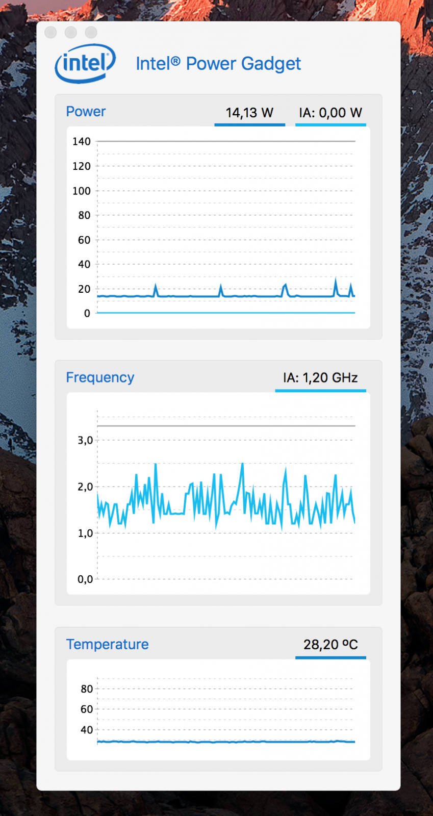

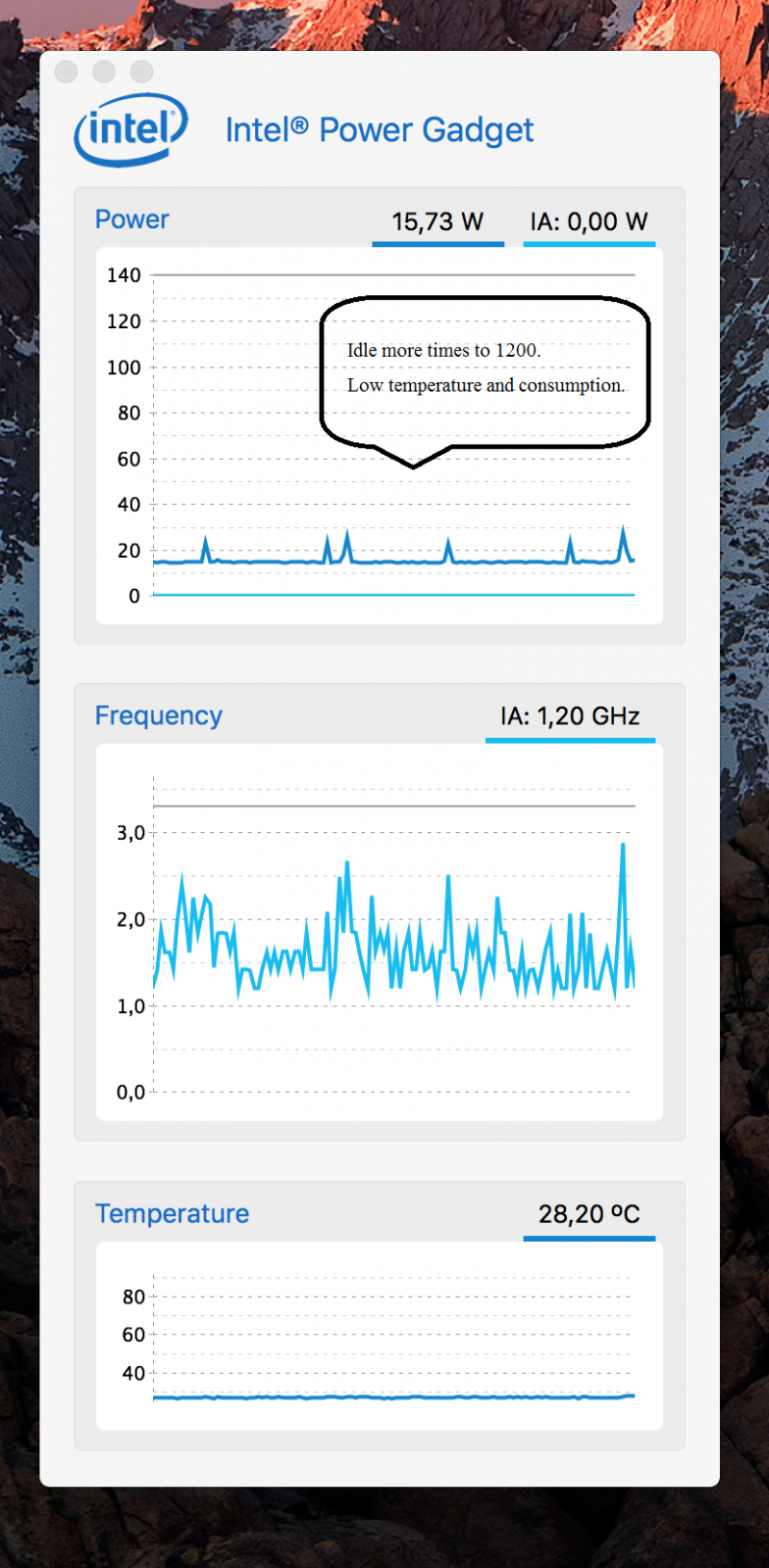

Looks about right. How's the stability? Any issues down-clocking/up-clocking and what's your average CPU temps (idle vs load)?
seem to work properly, even sleep, idle temp: 45°C - load temp: 75°C max 80°C.

Just a note, I checked to see whether or not my Vectors were loaded and it turns out they weren't! Apparently 17,1 isn't supported for my CPU...
sysctl -n machdep.xcpm.vectors_loaded_count
0
Loaded in 14,2 vectors, and...
sysctl machdep.xcpm
machdep.xcpm.io_filtered_reads: 0
machdep.xcpm.io_control_disengages: 1
machdep.xcpm.io_control_engages: 0
machdep.xcpm.io_thermal_level: 0
machdep.xcpm.gpu_thermal_level: 0
machdep.xcpm.cpu_thermal_level: 0
machdep.xcpm.deep_idle_total_stats: n/a
machdep.xcpm.deep_idle_last_stats: n/a
machdep.xcpm.deep_idle_count: 0
machdep.xcpm.qos_txfr: 1
machdep.xcpm.deep_idle_log: 0
machdep.xcpm.forced_idle_period: 30000000
machdep.xcpm.forced_idle_ratio: 100
machdep.xcpm.mbd_relaxations: 0
machdep.xcpm.mbd_applications: 1
machdep.xcpm.mbd_mode: 1
machdep.xcpm.maxintdelay: 0
machdep.xcpm.maxbusdelay: 71680
machdep.xcpm.ratio_changes_total: 27774
machdep.xcpm.ratio_change_ratelimit_ns: 500000
************************************ machdep.xcpm.vectors_loaded_count: 1 *************************************
machdep.xcpm.tuib_ns: 0
machdep.xcpm.bootpst: 37
machdep.xcpm.bootplim: 0
machdep.xcpm.power_source: 0
machdep.xcpm.tuib_enabled: 0
machdep.xcpm.tuib_plimit_min_100mhz_ratio: 8
machdep.xcpm.tuib_plimit_max_100mhz_ratio: 37
machdep.xcpm.soft_plimit_min_100mhz_ratio: 8
machdep.xcpm.soft_plimit_max_100mhz_ratio: 37
machdep.xcpm.hard_plimit_min_100mhz_ratio: 8
machdep.xcpm.hard_plimit_max_100mhz_ratio: 37
machdep.xcpm.mode: 1
Much better!
1
I followed another guide and injected 17,1 vectors and didn't do my DD and check for errors... *smack on hand*
Anywho, I updated my EFI folder on post 690 to reflect the new changes.

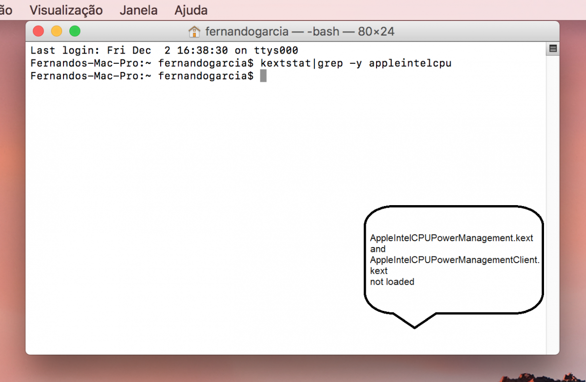

AppleIntelCPUPowerManagement.kext and AppleIntelCPUPowerManagementClient.kext
kextstat|grep -y appleintelcpu. If output is blank you are good, if not you need to remove them from S/L/E. In my case it was not necessary to delete anything.

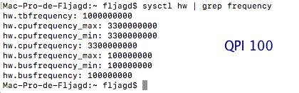

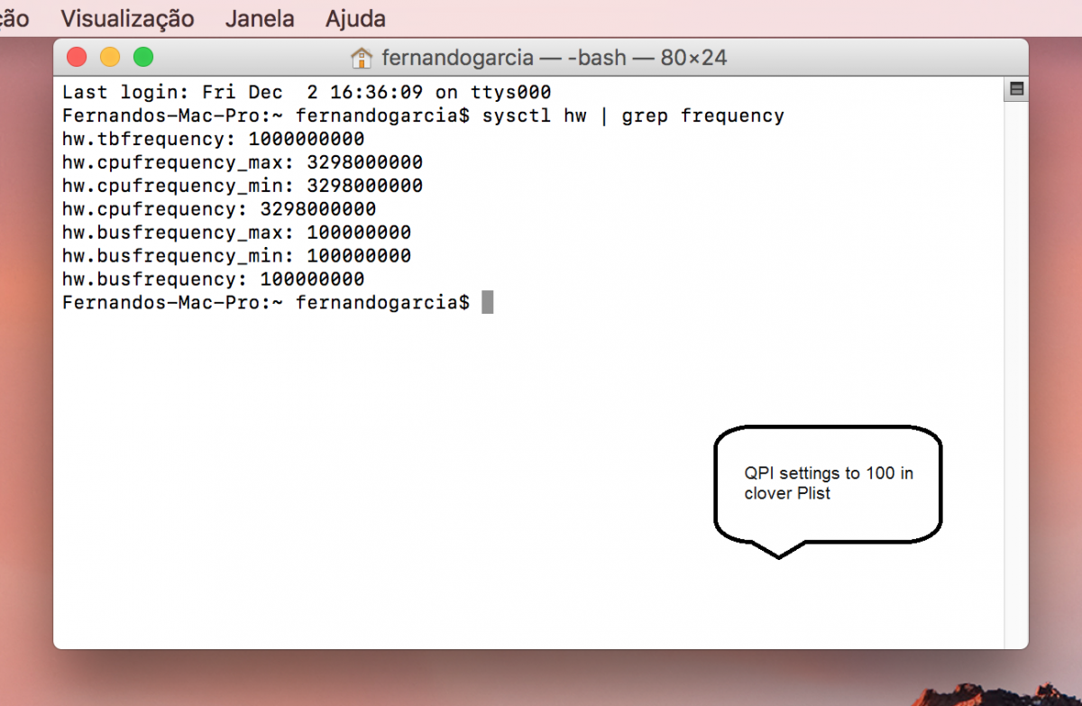

One thing to mention is that I also changed QPI settings to 100 in clover Plist. In the blogs from Piker (SSDT Script Generator and Vector Script Creator, which i both used for PM) he states that the output the bios is generating (400000000) for my specific cpu (I7 5820K) is wrong and should be (100000000). Check your output in terminal by: sysctl hw | grep frequency. Piker has a nice calculating method for using values with your own processor. just search his blogs.

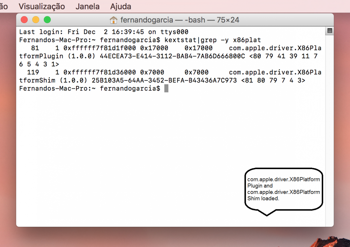

Also you might need com.apple.driver.X86PlatformPlugin and com.apple.driver.X86PlatformShim loaded.
Check in terminal: kextstat|grep -y x86plat. If it generates a line (or more) of output your fine.

If you have a well-known, single cpu like I7 5820K, you just need add -x 1 for xcpm and nothing else.
sudo ./ssdtPRGen.sh -x 1
After that I added the freqvectors 17.1 and it seems that everything is fine, with some addition of speedsteps and states.
Looks like my CPU bus speed was incorrect (40000000), fixed it by setting QPI to 10.

As far sleep goes, by injecting the correct frequency vectors as well as setting the CPU type to 0x0a02, it appears... for now... to have fixed the reboot tear-down issues.
Looks like my CPU Sensor is no longer reporting correct wattage... AHHHH!:
When I changed the Ai Overclock Tuner to manual, it happened the same to me in the Power Gadjet.
I have to test the Total CPU Package app...
That fixed it! To be sure I was still getting proper CPU management, I ran AppleIntelInfo... and it appears that all cores are still synced with all the steppings. I think I was getting unsync'd cores due to an improper SSDT (with the injected 17,1 vectors). Will update my post 690 to reflect new info:
MSR_TURBO_RATIO_LIMIT............(0x1AD) : 0x2424252525252525
 - Maximum Ratio Limit for C01.......... : 25 (3700 MHz)
 - Maximum Ratio Limit for C02.......... : 25 (3700 MHz)
 - Maximum Ratio Limit for C03.......... : 25 (3700 MHz)
 - Maximum Ratio Limit for C04.......... : 25 (3700 MHz)
 - Maximum Ratio Limit for C05.......... : 25 (3700 MHz)
 - Maximum Ratio Limit for C06.......... : 25 (3700 MHz)
CPU Ratio Info:
Maximum non-Turbo Ratio/Frequency........: 35 (3500 MHz)
Maximum Turbo Ratio/Frequency............: 37 (3700 MHz)
CPU P-States [ (12) 30 37 ]
CPU C6-Cores [ 0 2 4 6 8 10 ]
CPU P-States [ (12) 30 34 37 ]
CPU P-States [ (12) 27 30 34 37 ]
CPU P-States [ (12) 27 30 34 35 37 ]
CPU P-States [ 12 27 30 31 34 35 (37) ]
CPU P-States [ (12) 24 27 30 31 34 35 37 ]
CPU P-States [ (12) 24 27 30 31 32 34 35 37 ]
CPU P-States [ (12) 24 27 30 31 32 34 35 36 37 ]
CPU P-States [ 12 14 24 27 30 31 32 34 35 36 (37) ]
CPU P-States [ 12 14 24 26 27 30 31 32 34 35 36 (37) ]
CPU P-States [ 12 14 19 24 26 27 30 31 32 34 35 36 (37) ]
CPU P-States [ (12) 14 19 21 24 26 27 30 31 32 34 35 36 37 ]
CPU P-States [ (12) 14 19 21 24 26 27 29 30 31 32 34 35 36 37 ]
CPU P-States [ (12) 14 18 19 21 24 26 27 29 30 31 32 34 35 36 37 ]
CPU P-States [ 12 14 18 19 21 24 26 27 28 29 30 31 32 34 35 36 (37) ]
CPU P-States [ (12) 14 18 19 21 24 26 27 28 29 30 31 32 33 34 35 36 37 ]
CPU P-States [ 12 14 18 19 20 21 24 26 27 28 29 30 31 32 33 34 35 36 (37) ]
CPU P-States [ (12) 14 18 19 20 21 24 25 26 27 28 29 30 31 32 33 34 35 36 37 ]
CPU P-States [ (12) 14 17 18 19 20 21 24 25 26 27 28 29 30 31 32 33 34 35 36 37 ]
CPU P-States [ (12) 14 16 17 18 19 20 21 24 25 26 27 28 29 30 31 32 33 34 35 36 37 ]
CPU P-States [ (12) 14 15 16 17 18 19 20 21 24 25 26 27 28 29 30 31 32 33 34 35 36 37 ]
CPU P-States [ (12) 14 15 16 17 18 19 20 21 22 24 25 26 27 28 29 30 31 32 33 34 35 36 37 ]
CPU P-States [ 12 14 15 16 17 18 19 20 21 22 23 24 25 26 27 28 29 30 31 32 33 34 35 36 (37) ]

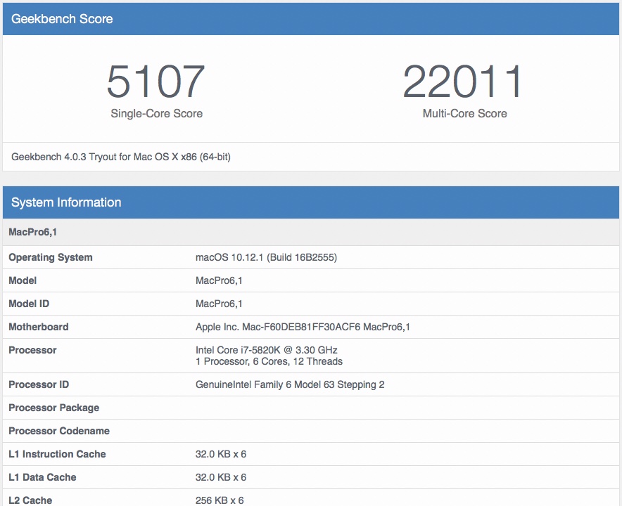

Tried updating my main rig to 10.12.1... and I don't recommend it. Too unstable and WIFI didn't work. Best to stick to 10.12 for now.
My rig with 10.12.1 works is stable and wifi and bluetooth work great....maybe you should check your kext patches!

First of all, a big thank you to everyone who has contributed to this.
There are too many to list all the names, but all of you know who they are!
With stability worthy of a real Mac Pro :yes:
Now it's time to have a lot of hope and wait for Nvidia's Pascal support and if it ever comes up, buy a 1070 or 1080...
