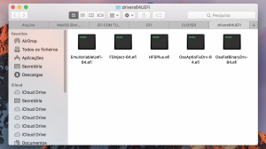

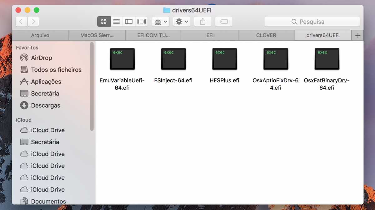

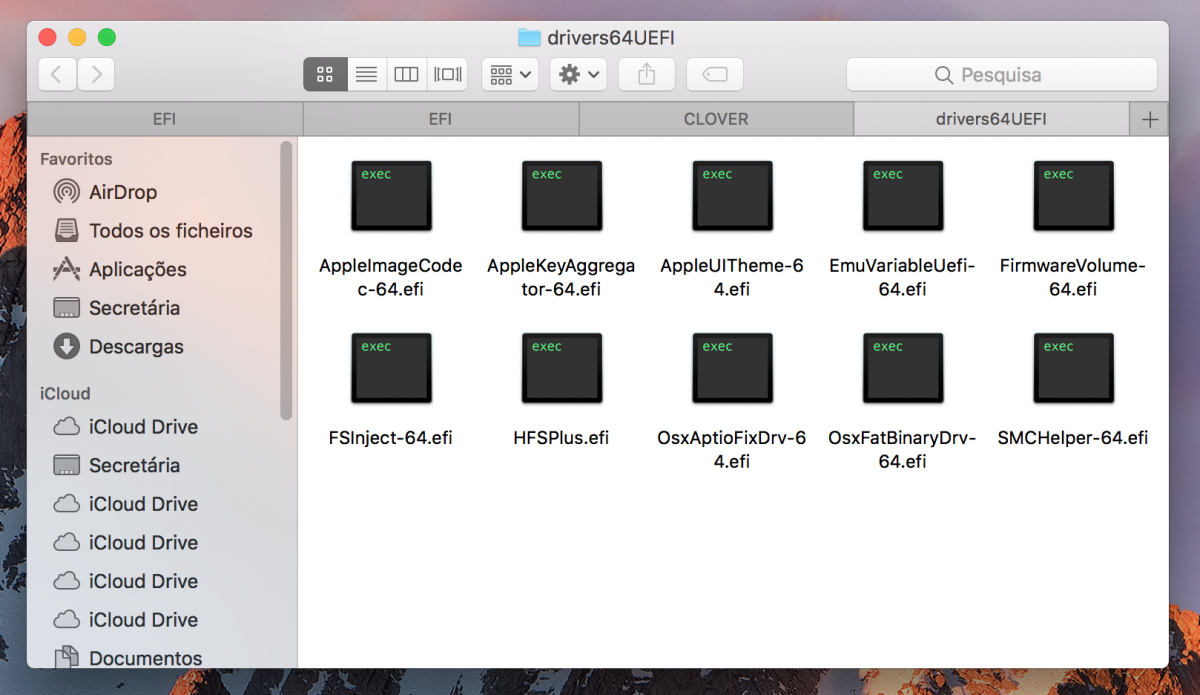

Very funny! The last Clover r3923, without i having asked, deleted all the drivers32 folder, and added a dose of new drivers64 and I do not even know what they are for.
But that's it, everything is still stable.
By the way, can anyone tell me what the additional drivers are for?
​Thanks :)
​Thanks :)
There is no need to keep *32 folders and files inside....as there is no need you keep those new files in driver64 folder.
​Thanks :)

That's it, I've never used or needed these drivers before and I do not think I'm going to use them now. The truth is that with or without them, the system works just as well, but I prefer the EFI folder as thinner as possible :)
Thanks
Thanks

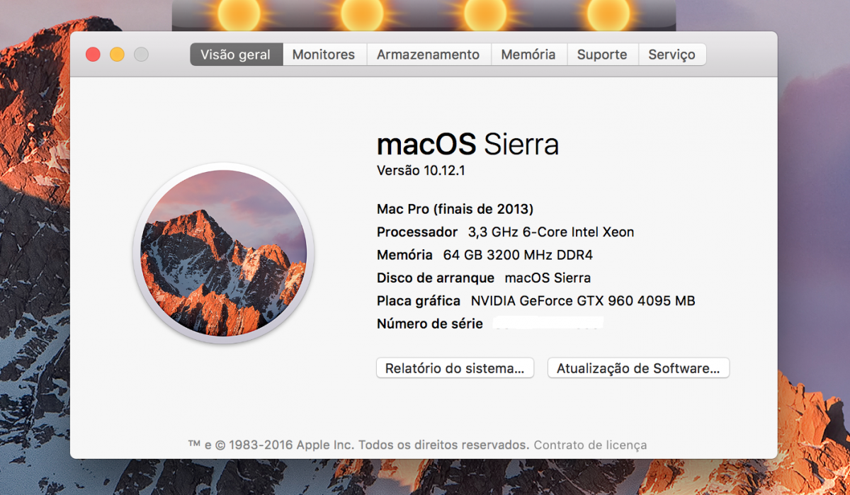

Just out of curiosity, are you currently running Sierra 10.12 or Sierra 10.12.1?
Since my other test bench is stable (Samsung SSD 830), I've cloned it over to my Samsung NVMe 950 drive. So far getting good results, but only time will tell if it's 100% stable:
Currently the Sierra 12.1 but I've tried all the Sierra, including the betas. I just went back to 12.1 because of the nvidia web drivers.

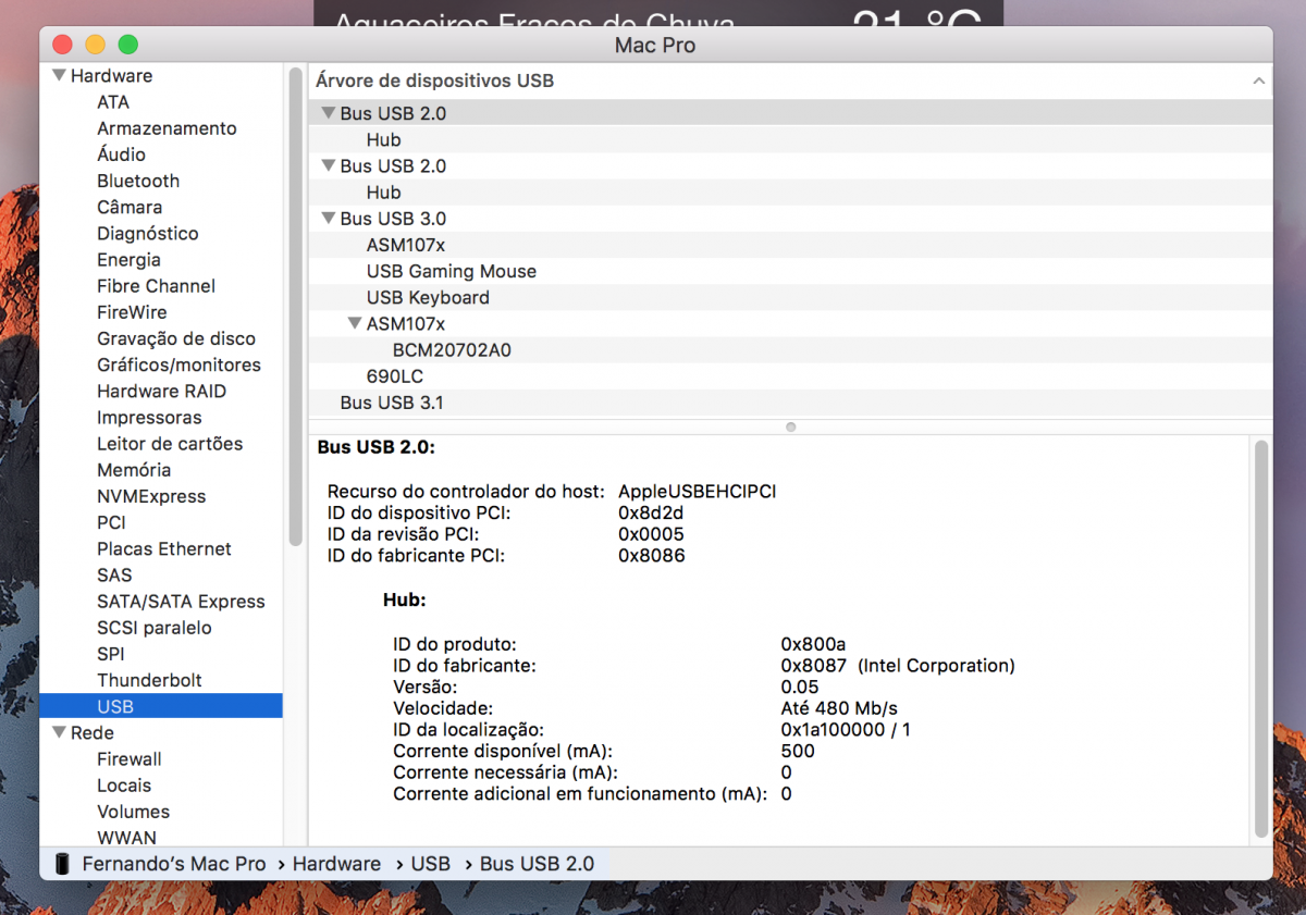

I patched the bios but now the bluetooth does not work if I do not install the kext BrcmBluetoothInjector.kext.
The USB 2.0 and USB 3.0 ports are not fully recognized.
in the PCI section I do not find any data.
The system does not store the kernel.log because it can not write access to /private/...

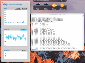

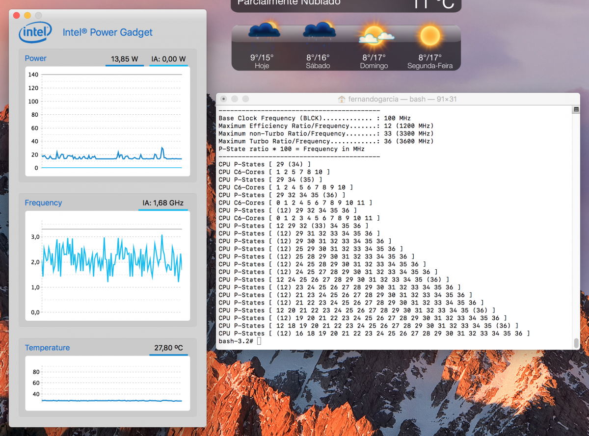

if I try to load AppleIntelInfo.kext the system crashes
what should I do?
EFI Folder: EFI.zip
what should I do?
EFI Folder: attachicon.gifEFI.zip

done, but not all USB ports are recognized
these are the "not apple" kext loaded
22    0 0xffffff7f82b9a000 0xc1000    0xc1000    as.vit9696.AppleALC (1.0.17) E1F82918-216E-389A-A096-BDDF4F27A8CC <7 5 4 3 2 1>
   23    3 0xffffff7f82c6b000 0x19000    0x19000    org.netkas.driver.FakeSMC (1394) 2DBA2F88-A115-386A-85D0-F88021A4D2E3 <11 7 5 4 3 1>
   24    0 0xffffff7f82c84000 0x4000     0x4000     com.rehabman.driver.USBInjectAll (0.5.14) 1B366826-5657-354C-9618-E69EFDB01D41 <12 11 4 3>
   25    0 0xffffff7f82c89000 0x5000     0x5000     org.hwsensors.driver.CPUSensors (1406) D0D2C74A-C63A-3F0C-95D1-018E3518E59C <23 7 5 4 3>
   51    0 0xffffff7f82c91000 0x1b000    0x1b000    com.insanelymac.driver.AppleIntelE1000e (3.1.0) 89207809-F285-FD56-82D2-2FA4D5C68C9C <50 12 5 4 3 1>
   53    0 0xffffff7f82cbc000 0x13000    0x13000    org.hwsensors.driver.LPCSensors (1406) DBA9834F-5B21-366F-AC3E-40527756E51D <23 12 11 7 5 4 3>
   57    0 0xffffff7f82ccf000 0x15000    0x15000    org.hwsensors.driver.GPUSensors (1406) 76C85832-9834-3F7D-AA51-15AD05C0CC24 <23 12 11 7 5 4 3>
Put the first one (Intel xHCI) to smart auto, check your USB patch and try
- Generated SSDT (speed step/power management) for a Mac Pro 6,1 SMBIOS with injected 17,1
My BIOS Setup:
- Under Advanced:
/USB Configuration:
[*]Intel XHCI Mode - Enable (Note: Smart Auto gave me some USB issues)
Hi mfc,
On your usb configuration, can you put a "About this Mac" print that shows the complete usb tree?
And if you can also the result of the AppleIntelinfo speedsteps. It's just curious because you have one or two different configurations of mine, and the board being the same.
Thanks
And today is Black Friday :D
Hi mfc,
Thanks
Here ya go!
AppleIntelInfo.kext v2.0 Copyright © 2012-2016 Pike R. Alpha. All rights reserved
enableHWP................................: 0
Settings:
logMSRs..................................: 1
logIGPU..................................: 0
logCStates...............................: 1
logIPGStyle..............................: 1
Warning: Clover hw.busfrequency error detected : 17d78400
InitialTSC...............................: 0x2eb9ef99119 (91 MHz)
MWAIT C-States...........................: 8480
Processor Brandstring....................: Intel(R) Core(TM) i7-5930K CPU @ 3.50GHz
Processor Signature..................... : 0x306F2
 - Family............................... : 6
 - Stepping............................. : 2
 - Model................................ : 0x3F (63)
Model Specific Registers (MSRs)
MSR_CORE_THREAD_COUNT............(0x35)  : 0xFFFFFF805AD26300
 - Core Count........................... : 6
 - Thread Count......................... : 12
MSR_PLATFORM_INFO................(0xCE)  : 0x20080C3BF3812300
 - Maximum Non-Turbo Ratio.............. : 0x23 (3500 MHz)
 - Ratio Limit for Turbo Mode........... : 1 (programmable)
 - TDP Limit for Turbo Mode............. : 1 (programmable)
 - Low Power Mode Support............... : 1 (LPM supported)
 - Number of ConfigTDP Levels........... : 1 (additional TDP level(s) available)
 - Maximum Efficiency Ratio............. : 12
 - Minimum Operating Ratio.............. : 8
MSR_PMG_CST_CONFIG_CONTROL.......(0xE2)  : 0x400
 - I/O MWAIT Redirection Enable......... : 1 (enabled, IO read of MSR(0xE4) mapped to MWAIT)
 - CFG Lock............................. : 0 (MSR not locked)
 - C3 State Auto Demotion............... : 0 (disabled/unsupported)
 - C1 State Auto Demotion............... : 0 (disabled/unsupported)
 - C3 State Undemotion.................. : 0 (disabled/unsupported)
 - C1 State Undemotion.................. : 0 (disabled/unsupported)
 - Package C-State Auto Demotion........ : 0 (disabled/unsupported)
 - Package C-State Undemotion........... : 0 (disabled/unsupported)
MSR_PMG_IO_CAPTURE_BASE..........(0xE4)  : 0x10414
 - LVL_2 Base Address................... : 0x414
 - C-state Range........................ : 1 (C6 is the max C-State to include)
IA32_MPERF.......................(0xE7)  : 0x2FA0AFD410
IA32_APERF.......................(0xE8)  : 0x2FA66F7234
MSR_FLEX_RATIO...................(0x194) : 0xE0000
MSR_IA32_PERF_STATUS.............(0x198) : 0x230D00002400
 - Current Performance State Value...... : 0x2400 (3600 MHz)
MSR_IA32_PERF_CONTROL............(0x199) : 0xFF00
 - Target performance State Value....... : 0xFF00 (25500 MHz)
 - Intel Dynamic Acceleration........... : 0 (IDA engaged)
IA32_CLOCK_MODULATION............(0x19A) : 0x0
IA32_THERM_INTERRUPT.............(0x19B) : 0x0
IA32_THERM_STATUS................(0x19C) : 0x88450000
 - Thermal Status....................... : 0
 - Thermal Log.......................... : 0
 - PROCHOT # or FORCEPR# event.......... : 0
 - PROCHOT # or FORCEPR# log............ : 0
 - Critical Temperature Status.......... : 0
 - Critical Temperature log............. : 0
 - Thermal Threshold #1 Status.......... : 0
 - Thermal Threshold #1 log............. : 0
 - Thermal Threshold #2 Status.......... : 0
 - Thermal Threshold #2 log............. : 0
 - Power Limitation Status.............. : 0
 - Power Limitation log................. : 0
 - Current Limit Status................. : 0
 - Current Limit log.................... : 0
 - Cross Domain Limit Status............ : 0
 - Cross Domain Limit log............... : 0
 - Digital Readout...................... : 69
 - Resolution in Degrees Celsius........ : 1
 - Reading Valid........................ : 1 (valid)
MSR_THERM2_CTL...................(0x19D) : 0x0
IA32_MISC_ENABLES................(0x1A0) : 0x840089
 - Fast-Strings......................... : 1 (enabled)
 - FOPCODE compatibility mode Enable.... : 0
 - Automatic Thermal Control Circuit.... : 1 (enabled)
 - Split-lock Disable................... : 0
 - Performance Monitoring............... : 1 (available)
 - Bus Lock On Cache Line Splits Disable : 0
 - Hardware prefetch Disable............ : 0
 - Processor Event Based Sampling....... : 0 (PEBS supported)
 - GV1/2 legacy Enable.................. : 0
 - Enhanced Intel SpeedStep Technology.. : 0 (disabled)
 - MONITOR FSM.......................... : 1 (MONITOR/MWAIT supported)
 - Adjacent sector prefetch Disable..... : 0
 - xTPR Message Disable................. : 1 (disabled)
MSR_TEMPERATURE_TARGET...........(0x1A2) : 0x5F0A00
 - Turbo Attenuation Units.............. : 0
 - Temperature Target................... : 95
 - TCC Activation Offset................ : 0
MSR_MISC_PWR_MGMT................(0x1AA) : 0x400000
 - EIST Hardware Coordination........... : 0 (hardware coordination enabled)
 - Energy/Performance Bias support...... : 1
 - Energy/Performance Bias.............. : 0 (disabled/MSR not visible to software)
 - Thermal Interrupt Coordination Enable : 1 (thermal interrupt routed to all cores)
MSR_TURBO_RATIO_LIMIT............(0x1AD) : 0x2424242424242525
 - Maximum Ratio Limit for C01.......... : 25 (3700 MHz)
 - Maximum Ratio Limit for C02.......... : 25 (3700 MHz)
 - Maximum Ratio Limit for C03.......... : 24 (3600 MHz)
 - Maximum Ratio Limit for C04.......... : 24 (3600 MHz)
 - Maximum Ratio Limit for C05.......... : 24 (3600 MHz)
 - Maximum Ratio Limit for C06.......... : 24 (3600 MHz)
IA32_ENERGY_PERF_BIAS............(0x1B0) : 0x0
MSR_POWER_CTL....................(0x1FC) : 0x2904005B
 - Bi-Directional Processor Hot..........: 1 (enabled)
 - C1E Enable............................: 1 (enabled)
MSR_RAPL_POWER_UNIT..............(0x606) : 0xA0E03
 - Power Units.......................... : 3 (1/8 Watt)
 - Energy Status Units.................. : 14 (61 micro-Joules)
 - Time Units .......................... : 10 (976.6 micro-Seconds)
MSR_PKG_POWER_LIMIT..............(0x610) : 0x7854000158460
 - Package Power Limit #1............... : 140 Watt
 - Enable Power Limit #1................ : 1 (enabled)
 - Package Clamping Limitation #1....... : 1 (allow going below OS-requested P/T state during Time Window for Power Limit #1)
 - Time Window for Power Limit #1....... : 10 (2560 milli-Seconds)
 - Package Power Limit #2............... : 168 Watt
 - Enable Power Limit #2................ : 1 (enabled)
 - Package Clamping Limitation #2....... : 1 (allow going below OS-requested P/T state setting Time Window for Power Limit #2)
 - Time Window for Power Limit #2....... : 3 (20 milli-Seconds)
 - Lock................................. : 0 (MSR not locked)
MSR_PKG_ENERGY_STATUS............(0x611) : 0x11522AFA
 - Total Energy Consumed................ : 17736 Joules (Watt = Joules / seconds)
MSR_PKG_POWER_INFO...............(0x614) : 0x1280460
 - Thermal Spec Power................... : 140 Watt
 - Minimum Power........................ : 0
 - Maximum Power........................ : 0
 - Maximum Time Window.................. : 0
MSR_PP0_POWER_LIMIT..............(0x638) : 0x0
MSR_PP0_ENERGY_STATUS............(0x639) : 0x0
MSR_TURBO_ACTIVATION_RATIO.......(0x64C) : 0x0
MSR_CONFIG_TDP_NOMINAL...........(0x648) : 0x23
MSR_CONFIG_TDP_LEVEL1............(0x649) : 0x94000000200460
MSR_CONFIG_TDP_LEVEL2............(0x64a) : 0x94000000000000
MSR_CONFIG_TDP_CONTROL...........(0x64b) : 0x0
MSR_TURBO_ACTIVATION_RATIO.......(0x64c) : 0x0
MSR_PKGC6_IRTL...................(0x60b) : 0x0
MSR_PKG_C2_RESIDENCY.............(0x60d) : 0x0
MSR_PKG_C6_RESIDENCY.............(0x3f9) : 0x0
IA32_TSC_DEADLINE................(0x6E0) : 0x2EBA2C83935
CPU Ratio Info:
Base Clock Frequency (BLCK)............. : 100 MHz
Maximum Efficiency Ratio/Frequency.......: 12 (1200 MHz)

Thank you friend!
In terms of USB, although I use a different setting in Bios, the result seems to be the same. But I have to test with Intel XHCI Mode Enabled, to see if it gets any difference.
My Bios USB config:
Intel XHCI Mode - Smart Auto
EHCI Legacy Support - Enable
XHCI Hand-off - Enable
EHCI Hand-off - Enable
The difference I'm seeing is the speedsteps. There are quite a few. In mine they appear quite a few more.
Now I have no chance, but sooner I run AIntelinfo and show you my results.
Thank you friend!
My Bios USB config:
XHCI Legacy Support - Enable
Switched to Smart Auto and set Asus Overclocker to Manual (for sync all cores), now the USB device tree looks organized and the cores are all 3.7ghz (versus 3.7 for two and 3.6 for the rest)...
Last time I used Smart Auto I had problems where my USB devices wouldn't be recognized, so I'll have to test a bit more using this option.
Also, my board only has EHCI legacy support (no XHCI legacy support found in BIOS).

Before I was getting ~18250-18500 GeekBench, now, I'm getting...
Yes, for me, your usb tree looks better this way. But I keep saying the speedsteps are not good. You're probably not running AppleIinfokext until the end. You have to run the "cat /tmp/AppleIntelInfo.dat" command several times until there are no more visible changes in the number of speedsteps.
In the end, you should have something similar to my print and if it is not so it is because something is wrong!
If you have the kext on the desktop, the sequence to copy/paste to the terminal is this:
sudo -s
chown -R 0:0 ~/Desktop/AppleIntelInfo.kext
chmod -R 755 ~/Desktop/AppleIntelInfo.kext
kextload ~/Desktop/AppleIntelInfo.kext
cat /tmp/AppleIntelInfo.dat       (RUN THIS COMMAND SEVERAL TIMES, until there are no more visible changes in the number of speedsteps)
kextunload ~/Desktop/AppleIntelInfo.kext
Although I think my speedsteps are not perfect either, they are more than what you showed, and without overclocking and with a lower processor, I have the same or higher score on GB4.
I also think you have too many patches on the plist. In my plist, neither half I have and it works out perfectly, including the sleep/wake that still a moment ago came into action and woke up perfectly.
Ran it several times instead... much better  :D
