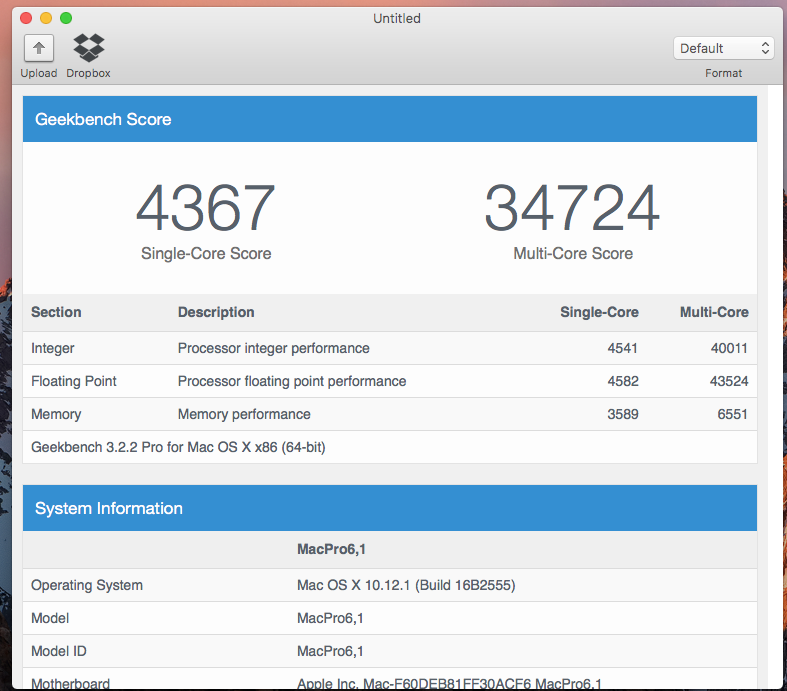

SammlerG Posted November 6, 2016 Share Posted November 6, 2016 my GB score are the same after sleep. 4 Link to comment Share on other sites More sharing options...
ekwipt Posted November 6, 2016 Share Posted November 6, 2016 Yeah, with CPUID you give me it works well, thanks I just doing some kernel patch testing, but my machine works really good. Even sleep works (without voodooTSC.kext) This is my Geekbench 4 result i have now - https://browser.primatelabs.com/v4/cpu/964067 ekwipt, is your RAM frequency detected correctly via Clover? My 3000MHz RAM is detected as 2133MHz, so i need to correct it manually. Its just cosmetic think, but I'm perfectionist I have only one problem here - slow read on Intel 750 SSD... Well your score kills my 6800k, I wish maybe a saved up a little more I haven't tried overlocking my RAM as of yet and it also reports as 2133mhz Link to comment Share on other sites More sharing options...

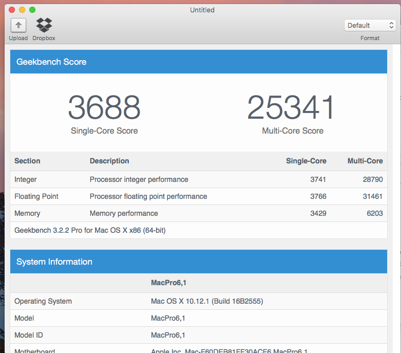

nmano Posted November 6, 2016 Author Share Posted November 6, 2016 my GB score are the same after sleep. Hi SammlerG If you try with over clock and sleep. Link to comment Share on other sites More sharing options...
SammlerG Posted November 6, 2016 Share Posted November 6, 2016 Tested with stock and overclocked. Scores are the same after sleep. 1 Link to comment Share on other sites More sharing options...
AsusFreak Posted November 6, 2016 Share Posted November 6, 2016 Tested with stock and overclocked. Scores are the same after sleep. Same here. 1 Link to comment Share on other sites More sharing options...

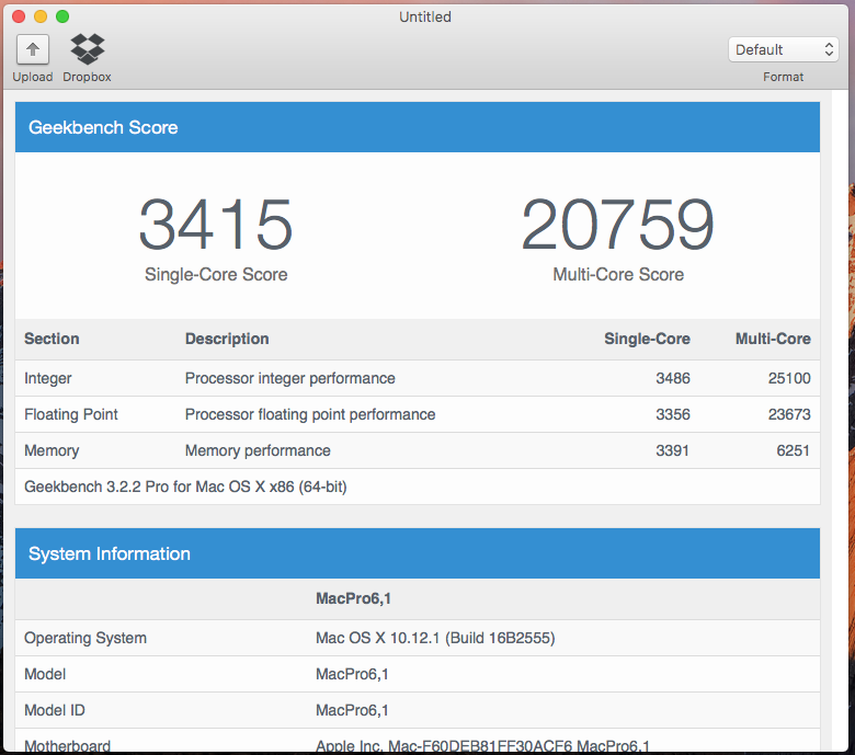

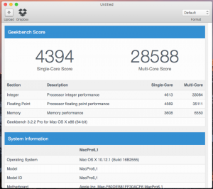

nmano Posted November 6, 2016 Author Share Posted November 6, 2016 Tested with stock and overclocked. Scores are the same after sleep. Hi G Can you upload your EFI folder I will check what different.I update fakesmc still low score after sleep. see this image just one bar Thanks. Link to comment Share on other sites More sharing options...

nmano Posted November 7, 2016 Author Share Posted November 7, 2016 I dont know why I have High and low score before and after sleep.May be 5960X? 1 Link to comment Share on other sites More sharing options...

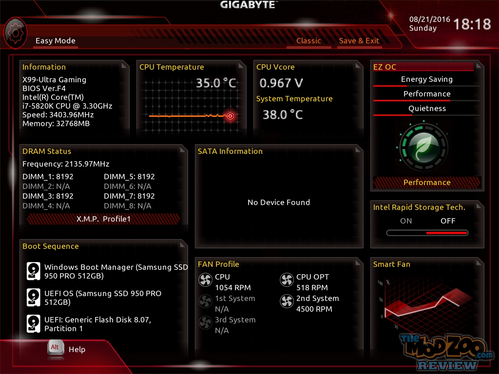

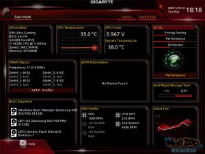

nmano Posted November 10, 2016 Author Share Posted November 10, 2016 I found now why Geek score down after sleep. I was change in bios EZ OC something else. Now I change to performance. So now before and after same score. Thank you guys. 4 Link to comment Share on other sites More sharing options...
