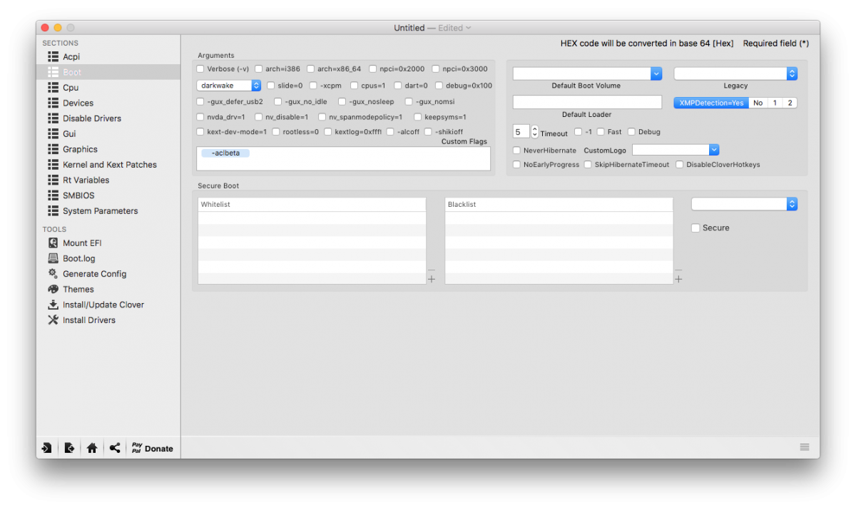

mfc88 Posted November 2, 2016 Share Posted November 2, 2016 yes So close! I got it to stay asleep... but upon waking it up, it never woke up my monitor (just got a blank screen/no signal)! Any ideas!? Maybe use MacPro 6,1 SMBIOS? Currently using 14,2. Update 2: GOT IT TO WORK!!!! Wooo! Thanks man! For anyone wondering, I set darkwake=0 Update 3: Sleep works, but now nearly all my USB devices have been disabled and my USB DAC has been disabled as well (so no sound... at all ) . Seems like if I set the BIOS XHCI -> Smart Auto, I can sleep, but I don't get any USB functionality, however if I set it to Enabled, then I get USB functionality, but no ability to sleep... Update 4: Now it's not sleeping. Instantly waking up... Update 5: Sleep works again, but when testing all USB ports: Only 2 in the back work. The rest are disabled. Link to comment Share on other sites More sharing options...
Fljagd Posted November 2, 2016 Share Posted November 2, 2016 Were you using the bootflag -alcbeta for 10.12? That is mandatory for AppleALC.kext. in principle to the first boot, I put. But after nothing in the boot arg here Link to comment Share on other sites More sharing options...

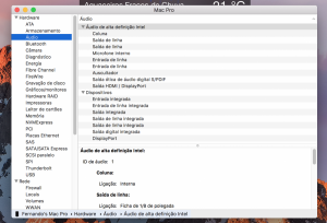

Fergarth Posted November 2, 2016 Share Posted November 2, 2016 Does anyone have/know of any patches for the Asus X99 Pro/USB 3.1 to fix the following...? What I have working: - CPU Stepping - Frequency Vectors - Shutdown/restart - GTX 980TI graphics - USB audio - Ethernet What doesn't work: - Sleep - Some front USB ports - Any sort of onboard Realtek 1150 Audio (using a monitor over HDMI cable connected to 980TI) Specifically, I'm trying to get my computer to sleep, but it awakes instantly (with no signal to monitor): Hi mfc88, I update my Asus X99-PRO/USB 3.1 BIOS to last 3402 You can find this version already "unlocked" here #262 Posted 07 October 2016 - 04:08 PM by fabiosun I installed without any problem, but you should read the manual board, because the file must be renamed according to the manual says. Important: I also chose to do a new installation of Sierra. In my case, it helped solve some conflicts and problems. Upgrades on upgrades sometimes creates conflict and this happened to me. Enter your board UEFI Bios and press F5 to load default values and OK. Press F7 In Advanced: USB Configuration and set: Intel XHCI Mode - Smart Auto XHCI Legacy Support - Enable EHCI Legacy Support - Enable XHCI Hand-off - Enable EHCI Hand-off - Enable In Ai Tweaker: Internal CPU Power Management (EIST) - Disable In Boot / Secure Boot: Os Type - Other OS Press F10 to Save and Exit Try using my complete EFI attached. But it is preferable to generate an DSDT for PM for your CPU. Mine was generated for 5820K. They are different processors with diferente names. With Clover Configurator, generate or copy/paste your serial number for plist (this one obviously don´t have) If have, remove other older kexts that you use for USB in S/L/E. I don´t use nothing in S/L/E, only in clover. Reboot and the USB 2, 3 and 3.1 should work, like working for me. The Bluetooth must be working. For WIFI, uses kext have edited by me, which is in wifizip folder attached. Remove the original and install this with Kext Wizard. Rebuild caches and restart the system. If wifi works, apply the 5Ghz patch that is in the folder. For sound onboard ALC1150 work with the original AppleHDA, you must MOUNT your EFI and run the Toleda script here on this link. https://github.com/toleda/audio_CloverALC/blob/master/audio_cloverALC-120.command.zip After installing the script, confirms that in the Clover config.plist still are these paches in "Kext To Patch". If anything is missing, You have to manually apply or you will not have sound. AppleHDAController Find A08C -> 208D 10.10-10.11+x99-ALC-Onboard-Audio AppleHDA 8A19D411 to 00000000 t1-10.12-AppleHDA/Realtek ALC1150 AppleHDA 8B19D411 to 0009EC10 t1-10.9-10.12-AppleHDA/Realtek ALC1150 AppleHDA 786D6C2E7A6C to 7A6D6C2E7A6C t1-AppleHDA/Resources/xml>zml If all goes well, your system should be like mine. Any questions, say anything… Boa Sorte! EFI.zip WIFI.rar 1 Link to comment Share on other sites More sharing options...
mfc88 Posted November 2, 2016 Share Posted November 2, 2016 Does anyone have/know of any patches for the Asus X99 Pro/USB 3.1 to fix the following...? What I have working: - CPU Stepping - Frequency Vectors - Shutdown/restart - GTX 980TI graphics - USB audio - Ethernet What doesn't work: - Sleep - Some front USB ports - Any sort of onboard Realtek 1150 Audio (using a monitor over HDMI cable connected to 980TI) Specifically, I'm trying to get my computer to sleep, but it awakes instantly (with no signal to monitor): Hi mfc88, I update my Asus X99-PRO/USB 3.1 BIOS to last 3402 You can find this version already "unlocked" here #262 Posted 07 October 2016 - 04:08 PM by fabiosun I installed without any problem, but you should read the manual board, because the file must be renamed according to the manual says. Important: I also chose to do a new installation of Sierra. In my case, it helped solve some conflicts and problems. Upgrades on upgrades sometimes creates conflict and this happened to me. Enter your board UEFI Bios and press F5 to load default values and OK. Press F7 In Advanced: USB Configuration and set: Intel XHCI Mode - Smart Auto XHCI Legacy Support - Enable EHCI Legacy Support - Enable XHCI Hand-off - Enable EHCI Hand-off - Enable In Ai Tweaker: Internal CPU Power Management (EIST) - Disable In Boot / Secure Boot: Os Type - Other OS Press F10 to Save and Exit Try using my complete EFI attached. But it is preferable to generate an DSDT for PM for your CPU. Mine was generated for 5820K. They are different processors with diferente names. With Clover Configurator, generate or copy/paste your serial number for plist (this one obviously don´t have) If have, remove other older kexts that you use for USB in S/L/E. I don´t use nothing in S/L/E, only in clover. Reboot and the USB 2, 3 and 3.1 should work, like working for me. The Bluetooth must be working. For WIFI, uses kext have edited by me, which is in wifizip folder attached. Remove the original and install this with Kext Wizard. Rebuild caches and restart the system. If wifi works, apply the 5Ghz patch that is in the folder. For sound onboard ALC1150 work with the original AppleHDA, you must MOUNT your EFI and run the Toleda script here on this link. https://github.com/toleda/audio_CloverALC/blob/master/audio_cloverALC-120.command.zip After installing the script, confirms that in the Clover config.plist still are these paches in "Kext To Patch". If anything is missing, You have to manually apply or you will not have sound. AppleHDAController Find A08C -> 208D 10.10-10.11+x99-ALC-Onboard-Audio AppleHDA 8A19D411 to 00000000 t1-10.12-AppleHDA/Realtek ALC1150 AppleHDA 8B19D411 to 0009EC10 t1-10.9-10.12-AppleHDA/Realtek ALC1150 AppleHDA 786D6C2E7A6C to 7A6D6C2E7A6C t1-AppleHDA/Resources/xml>zml If all goes well, your system should be like mine. Any questions, say anything… Boa Sorte! Wow! Muito obrigado! I have a "Test" harddrive that'll I'll try this on... will report back soon! Quick question: What system definition are you using? MacPro6,1? Or something else? 1 Link to comment Share on other sites More sharing options...

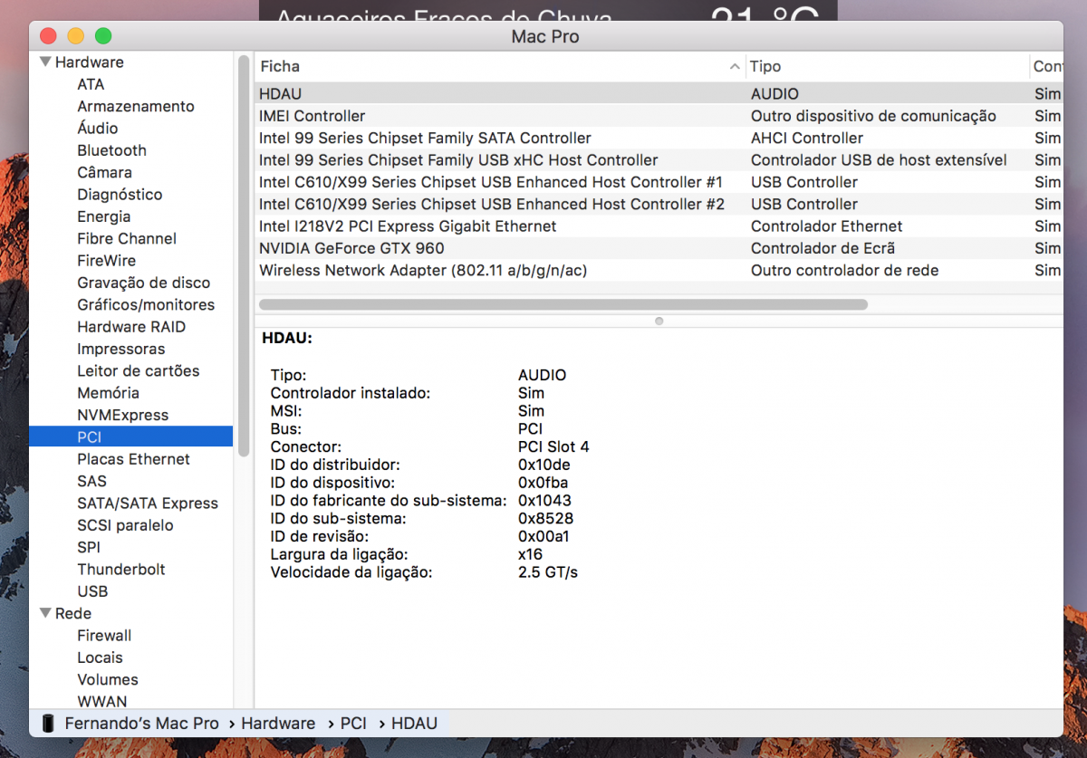

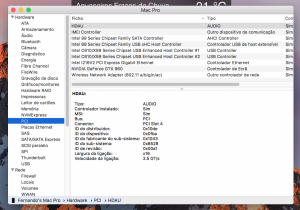

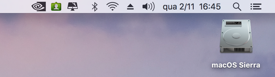

Fergarth Posted November 2, 2016 Share Posted November 2, 2016 Wow! Muito obrigado! I have a "Test" harddrive that'll I'll try this on... will report back soon! Do not move anything, as is the XCPM works and you can test with the Intel Power Gadget and/or run in the Terminal the AppleIntelInfo.kext v1.8e. I tested other plists with different patches available, but sometimes caused freezing. With this plist my system does not have freeze and reboots. It is stable and PM works well. Link to comment Share on other sites More sharing options...
mfc88 Posted November 2, 2016 Share Posted November 2, 2016 Do not move anything, as is the XCPM works and you can test with the Intel Power Gadget and/or run in the Terminal the AppleIntelInfo.kext v1.8e. I tested other plists with different patches available, but sometimes caused freezing. With this plist my system does not have freeze and reboots. It is stable and PM works well. Okay, I replaced them back into the S/L/E (all my Ktext's were in Clover EFI, but in order for PM to work I had remove some Ktexts from the S/L/E folder, but I just them back in). Another question: What system definition are you using? MacPro6,1? Or something else? Link to comment Share on other sites More sharing options...
Fergarth Posted November 2, 2016 Share Posted November 2, 2016 Okay, I replaced them back into the S/L/E. Another question: What system definition are you using? MacPro6,1? Or something else? For our system must be Macpro6,1 and is already set in my plist. If you do new installation (preferable), do not forget to use the boot flag nv_disable=1 until you have installed the NvidiaWebDriver and patch the AppleGraphicsControl kext. Procedure necessary if using SMBios Macpro6,1 or iMac17,1 Link to comment Share on other sites More sharing options...

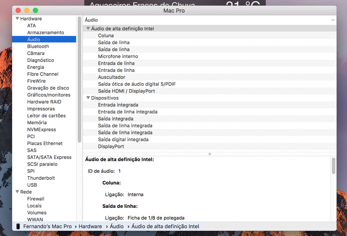

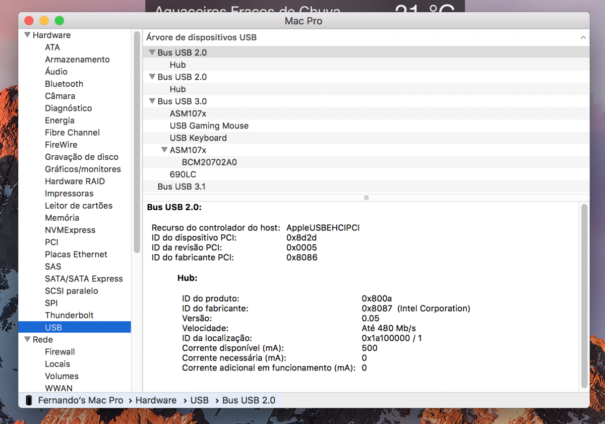

mfc88 Posted November 3, 2016 Share Posted November 3, 2016 All right! A bit of an update... I managed to get my test bench stable (for now, will do more extensive testing on the weekend) with Fergarth's EFI folder, but I needed to use OsxAptioFix2Drv-free2000 as well as this KernelToPatch: Find: 3C0E9 Replace: 83C0E6 Cmment: Haswell-E CPUID Patch MatchOS: 10.12 What works:- Ethernet - WIFI (2.4ghz/5ghz)!!!! - All USB 2.0, 3.0, 3.1 Ports!!!! - USB DAC Sound - Realtek 1150 sound (over HDMI)!!! - CPU PM/Stepping What doesn't work: - Sleep (unfortunately, I get instant wake followed by a kernel panic) - Bluetooth (don't really use this anyway) 1 Link to comment Share on other sites More sharing options...
