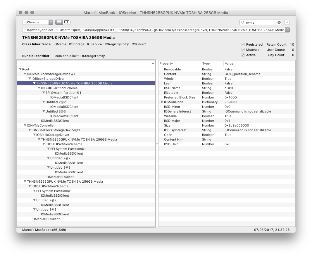

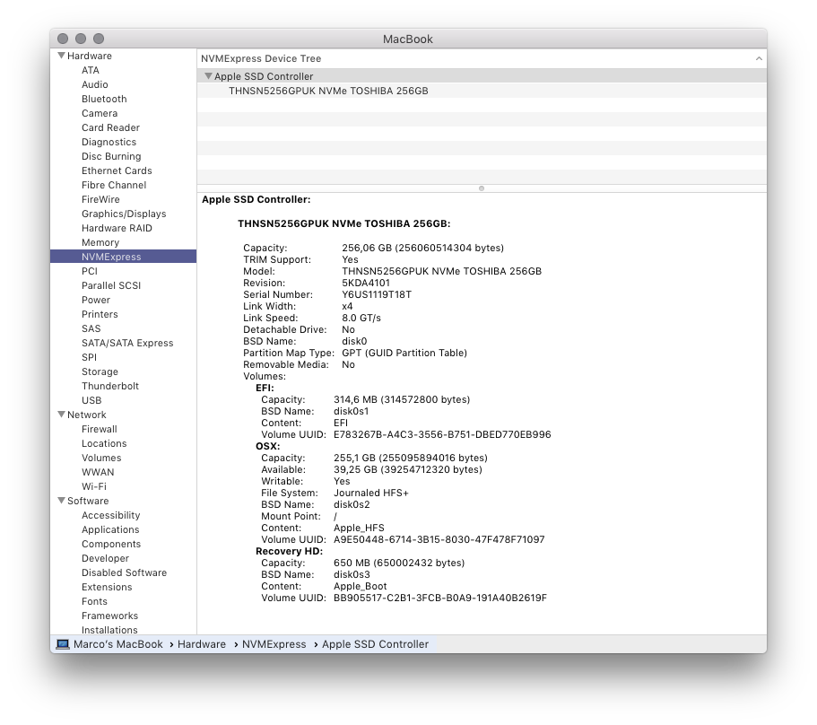

bozma88 Posted March 7, 2017 Share Posted March 7, 2017 I confirm that on my XPS 13 9360 with 256GB Toshiba NVME THNSN5256GPUK SSD I can change the LBA to 4K and then run 100% vanilla IOBlockStorageDriver. Supported LBA Sizes (NSID 0x1) Id Fmt Data Metadt Rel_Perf 0 + 512 0 2 1 - 4096 0 1 The XPS 13 line is plagued with data corruption when using NVME drives and - supposedly - enabling HWP. I'll report whether using vanilla storage drivers will fix this serious issue. 1 Link to comment Share on other sites More sharing options...
