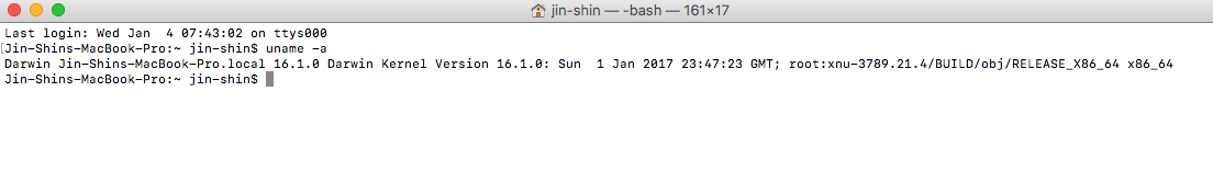

Thanks carlo_67 at least I now know my source is working :)
Can you build the prelinkedkernel again it please. That's still Bronya's kernel showing in your sysctl output,
kern.version: Darwin Kernel Version 16.1.0: Thu Dec 29 02:05:06 MSK 2016; root:xnu-3789.21.4/BUILD/obj/RELEASE_X86_64

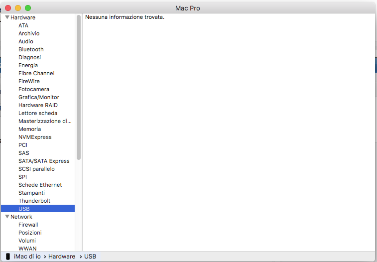

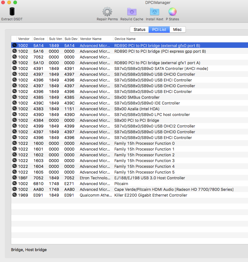

used with clover and FakeSMC NullCpu .. S / L / E. I'm also testing USB, attach kext,
you do not see in the system information but they work all USB 2 and USB 3 Etron and Asmedia Hub

your USB fix for Sierra works better that v3 fix, but system doesn't see USB, aka my sound card isn't working yet.

I have FX 8350 on 10.12.2, and it's working with Bronya's kernel. was able to install from USB and is stable, but USB ports are not shown in system proporties.
If you use GenericUSBXHCI.kext for non-Intel USB 3.0 ports, even it works but it may not be shown in About this Mac/System Information/USB at 10.12.x
Asmedia and VL805 ( http://forums.macrumors.com/threads/usb-3-x-pcie-cards-for-classic-mac-pro.1501482/page-69) chips are supported OOB.  If you disable USB2 and plug everything to USB3, no need of any fixes.
Then you will see USB in system report.
