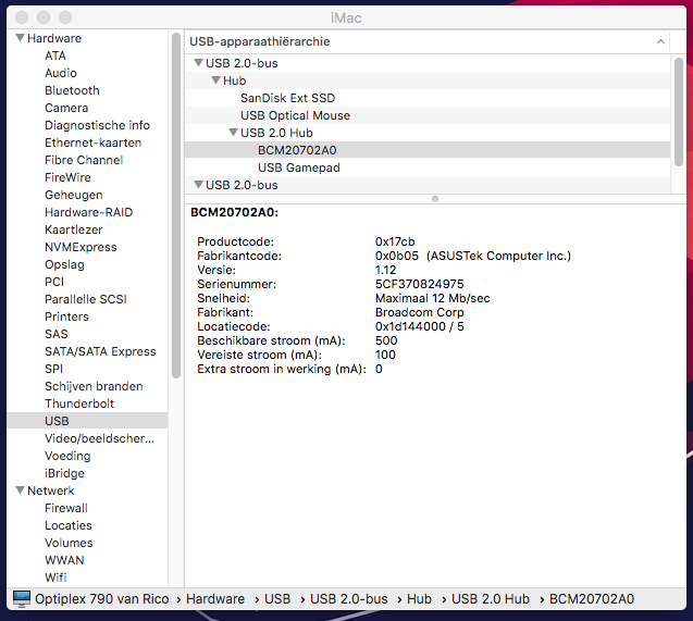

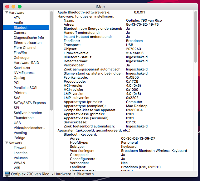

window Posted October 30, 2017 Share Posted October 30, 2017 @ricoc90 kexts did not work. what should I do to check what is wrong Link to comment Share on other sites More sharing options...
Guest ricoc90 Posted October 30, 2017 Share Posted October 30, 2017 @ricoc90 kexts did not work. what should I do to check what is wrong What does system profiler > Bluetooth say? Link to comment Share on other sites More sharing options...
window Posted October 30, 2017 Share Posted October 30, 2017 @ricoc90 no information found Link to comment Share on other sites More sharing options...
Guest ricoc90 Posted October 30, 2017 Share Posted October 30, 2017 I'm not sure. My ASUS BT400 (BCM20702A) works OOB BCM20702A should work. What's your device ID? Or the exact model of the dongle? Link to comment Share on other sites More sharing options...
window Posted October 30, 2017 Share Posted October 30, 2017 ORICO BT-408 Link to comment Share on other sites More sharing options...
twingolover Posted October 30, 2017 Share Posted October 30, 2017 HD 3450 won't work I'm afraid. thanks for reply me.... so if understand correctly i can install however using instead integrated GPU intel, but i haven't graphical acceleration? in alternative rx260 can be compatible just in case, maintain hardware of dell 755 in a new case to allow this double slot graphic card. Link to comment Share on other sites More sharing options...
Guest ricoc90 Posted October 30, 2017 Share Posted October 30, 2017 thanks for reply me.... so if understand correctly i can install however using instead integrated GPU intel, but i haven't graphical acceleration? in alternative rx260 can be compatible just in case, maintain hardware of dell 755 in a new case to allow this double slot graphic card. Not sure if you can install with the onboard graphics. if so it'll indeed only be VESA. Assuming you're on the SFF version: Putting your Optiplex Dell 755 hardware into a new case won't be easy. The motherboard is *BTX, while PC cases are *ATX. The IO of an BTX board is placed right, as where ATX's IO is placed left. It might be possible to use the Optiplex DT (also requires low profile cards but more PCI expansion slots) or MT (accepts regular sized pci/pci-e cards) case. However, I'm not sure of this. ORICO BT-408 It should work. The adapter is not showing up under System profiler -> Bluetooth? Your device id is also listed in the kexts I showed you, so I don't know why it's not working. Link to comment Share on other sites More sharing options...
