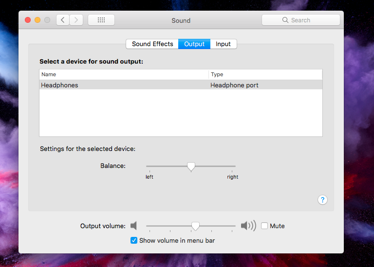

Quinzie XO Posted September 30, 2017 Share Posted September 30, 2017 No issues here on my 790 SFF with 10.13.1. Explain "never gets past the initial reboot". Edit: nevermind, just replied to your post in High Sierra release thread. Hey! So I did manage to get High Sierra Installed but seems like audio is broken! it sees only "internal speakers" as output! Ivd tried using my kexts from Sierra but those don't work either... EFI Folder is at this link : https://ufile.io/inu0f Thanks Link to comment Share on other sites More sharing options...
HazemTarek Posted September 30, 2017 Share Posted September 30, 2017 That's because you probably using USB_Injector.kext, which is configured for imac10,1. Either revert back to imac10,1 or change all references to imac10,1 to imac13,1 in USB_Injector.kext's info,plist Try https://sourceforge.net/projects/nvidiagraphicsfixup/and https://github.com/vit9696/Lilu/releases Alternatively try nvidia's webdrivers i tried all of that but still black screen, i can boot with nv_disable=1 but the resolution is low Link to comment Share on other sites More sharing options...
Guest ricoc90 Posted September 30, 2017 Share Posted September 30, 2017 Hey! So I did manage to get High Sierra Installed but seems like audio is broken! it sees only "internal speakers" as output! Ivd tried using my kexts from Sierra but those don't work either... Really strange thing. It should work... Link to comment Share on other sites More sharing options...
Quinzie XO Posted October 1, 2017 Share Posted October 1, 2017 Really strange thing. It should work... Upon further testing, auto switching works, I plugged in headphones to the front port and voila audio through front port! But nothing through the back port seems to work! Also the auto switch is detected! If no headphones then it shows "internal speakers" but if I plug in headphones then it showing headphone! EDIT: Fixed! Rolled back appleHDA.kext to Sierra vanilla and it works for some reason! Thanks :0 Link to comment Share on other sites More sharing options...
Guest ricoc90 Posted October 1, 2017 Share Posted October 1, 2017 Upon further testing, auto switching works, I plugged in headphones to the front port and voila audio through front port! But nothing through the back port seems to work! Also the auto switch is detected! If no headphones then it shows "internal speakers" but if I plug in headphones then it showing headphone! EDIT: Fixed! Rolled back appleHDA.kext to Sierra vanilla and it works for some reason! Thanks :0 There shouldn't be no need to roll back any kexts, so you didn't really fix it I'm afraid. You just worked around the actual problem For me it works fine on High Sierra. Link to comment Share on other sites More sharing options...

MacPeet Posted October 3, 2017 Author Share Posted October 3, 2017 @Quinzie XO For the new Codec LayoutID 13 for Optiplex780/760 and LayoutID 16 for Optiplex790 is "internal speakers = back green". @gpatpandp "AppleACPICPU" -Error -> FakeSMC has not been loaded. All your Kext's to EFI/Clover/kexts/others/ In the second install phase, you can not be loaded by ... /10.13/ Rollback HD5450, HD6570, HD5770 or other AMD graphics: Optiplex790 with i7, i5, ..., with iGPU as an injector does not need a rollback. Only Optiplex with Core2Duo, Core2Quad have no Injector-iGPU. Only these require the rollback. Unfortunately, WhatEverGreen + Lilu only works with EFI-Bios, therefore no solution. Link to comment Share on other sites More sharing options...

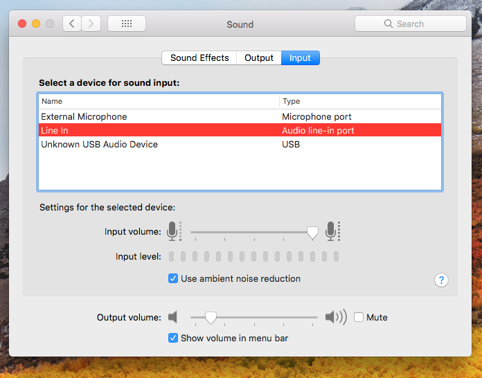

Deanor30 Posted October 4, 2017 Share Posted October 4, 2017 Hi People, Has anyone got the mic inputs working on a dell760 sff. I use the AppleALC kext method with the Lilu Kext and my DSDT layout edited. I can see the inputs in system preferences but the do not work yet the desktop mic I use works on the same pc in windows. DSDT.aml.zip Link to comment Share on other sites More sharing options...
MacPeet Posted October 4, 2017 Author Share Posted October 4, 2017 @ernani Solution for High Sierra -> red login screen after rollback Kext's from the Sierra: replace com.apple.desktop.admin.png in /Library/Caches/ @Deanor30 Line In (back port) presumably only pre-amplified mic's try external mic at the front or try this: DSDT, I have changed to LayoutID 13 (0D): DSDT.aml.zip and... trial AppleALC: AppleALC.kext.zip output's: internal speaker is the rear port (green) Automatic changeover to headphones when connected to front input's: internal mic is the front mic port LineIn is the rear input Link to comment Share on other sites More sharing options...
